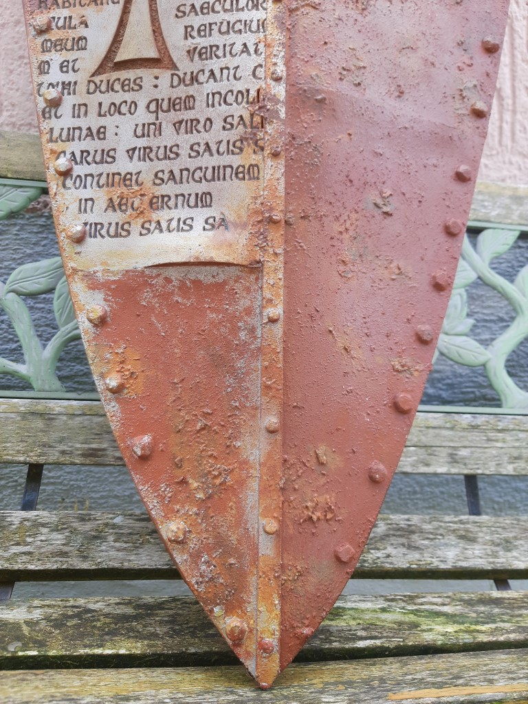

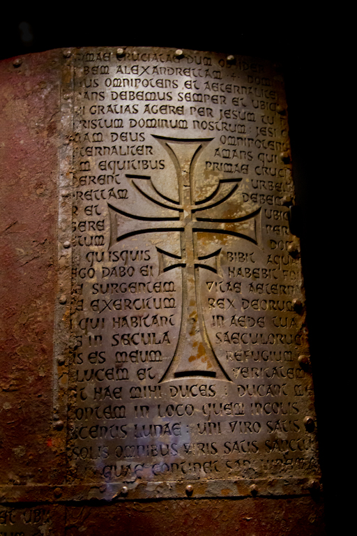

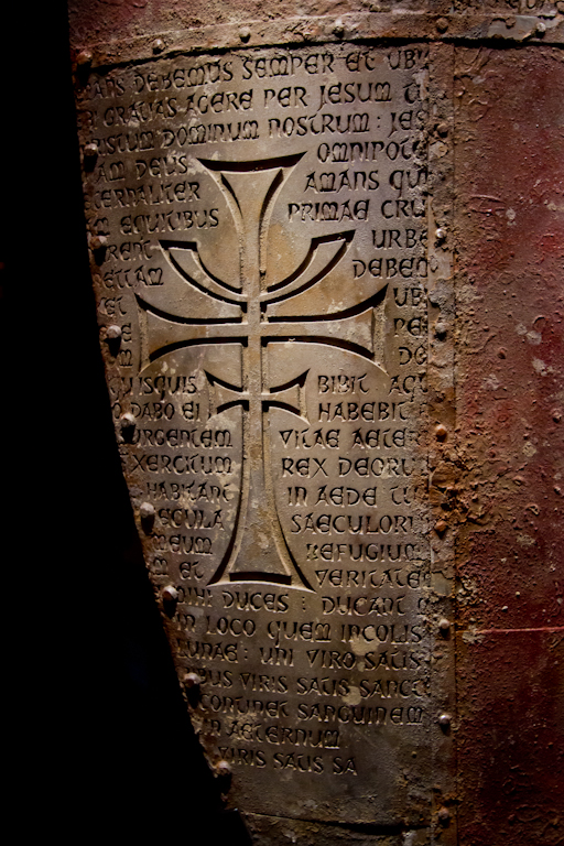

Sir Richards Shield (picture)
Like the tablet it is made of wood. The writing was trandsfered to the wood with charcoal paper and then dremeled out.
To be able to better hang it on the wall I thought I made a flat version to mount it like a picture. The ratio of the engraving is therefore a bit smaller than on the tablet and the movies as it is smaller without the curve.
The separation(cross) or how you call it is made of steel and then painted.
The panting is done with sparypaint and acrylic colors. No weathering done yet.

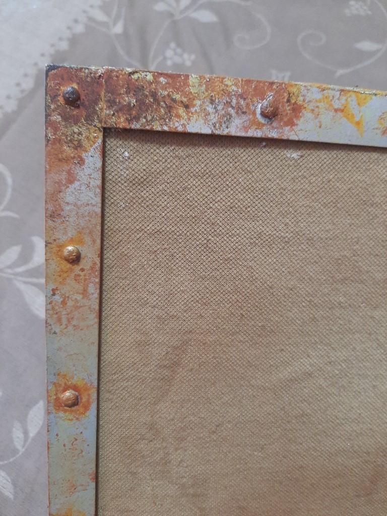

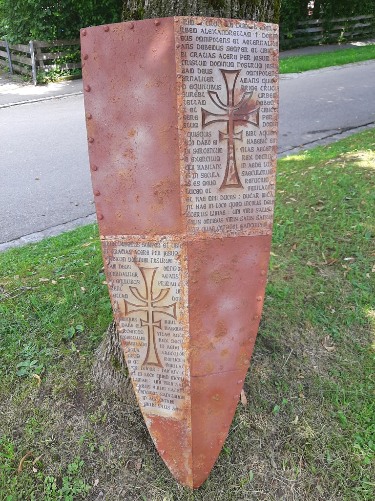

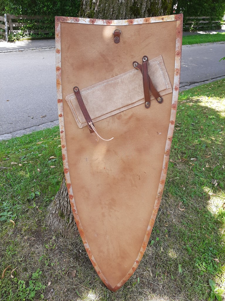

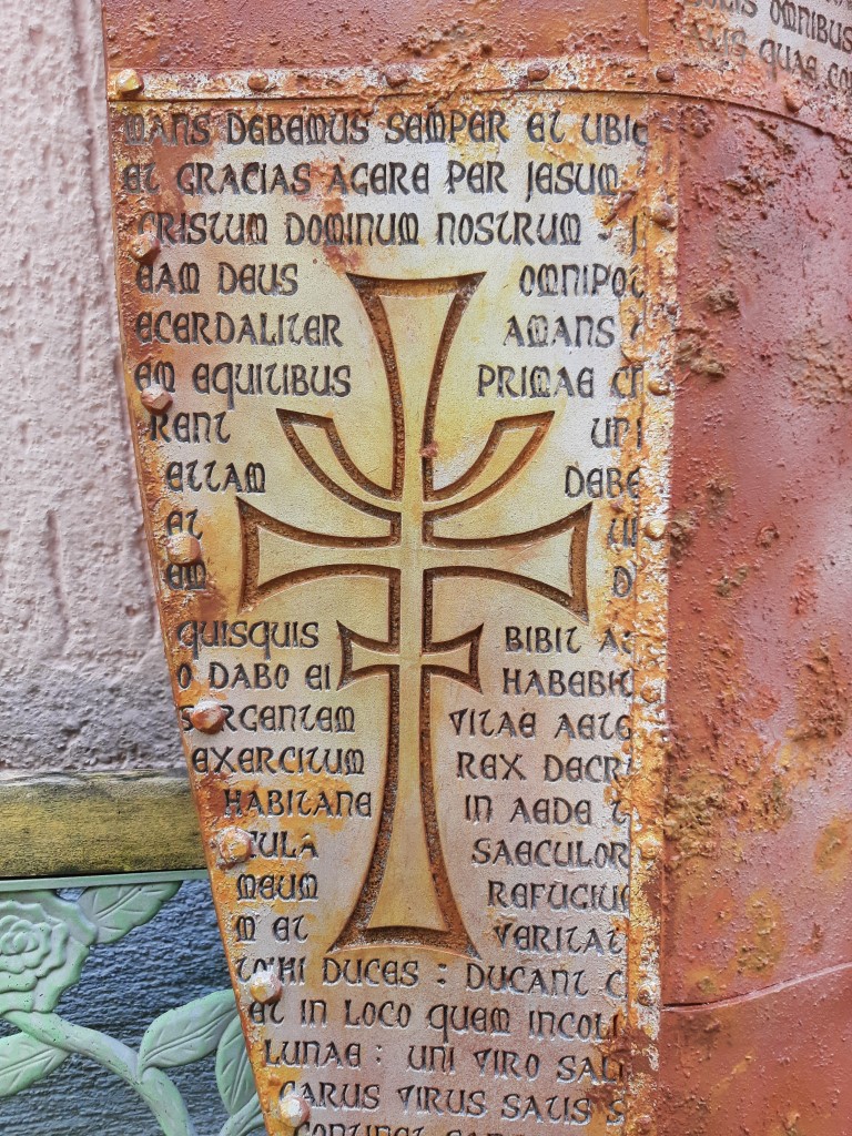

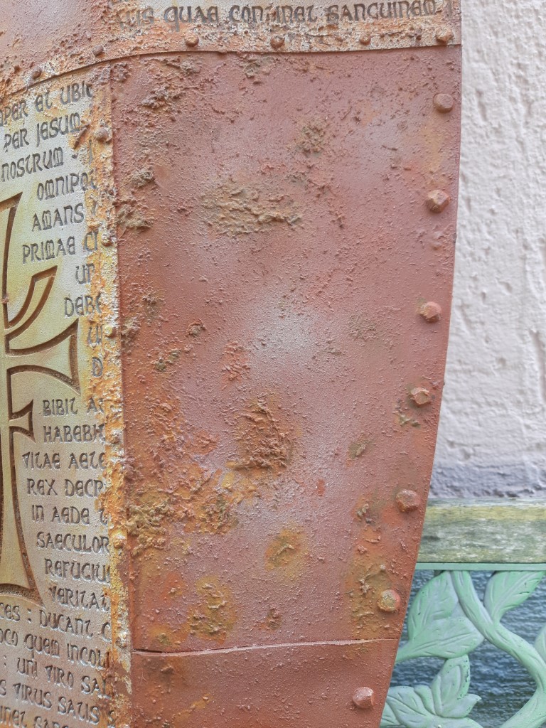

Finally I could finish my own Sir Richard`s Shield.
I wanted get finished on easter already, but it took a little more time.
Made with pre-casted engraved plates and a thin wooden back first.
A mould made and with monsterclay filled, then.
Giving all the weathering on that monsterclay mold and made a new mould of that shield, then.
Moulded in resin and expoxy then. The backside made with acrylic glass/plexiglass, with a linen cloth glued on it.
In addition, plastic strips were attached, which were bent and screwed on.
The leather straps are fixed with book screws and the screw heads made look like old rivets.
Most work was the weathering paint job and I always find new spots to change a little.

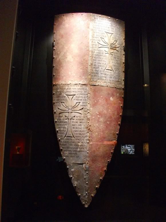

On one of the pictures you can compare the original shield prop and my finished prop.

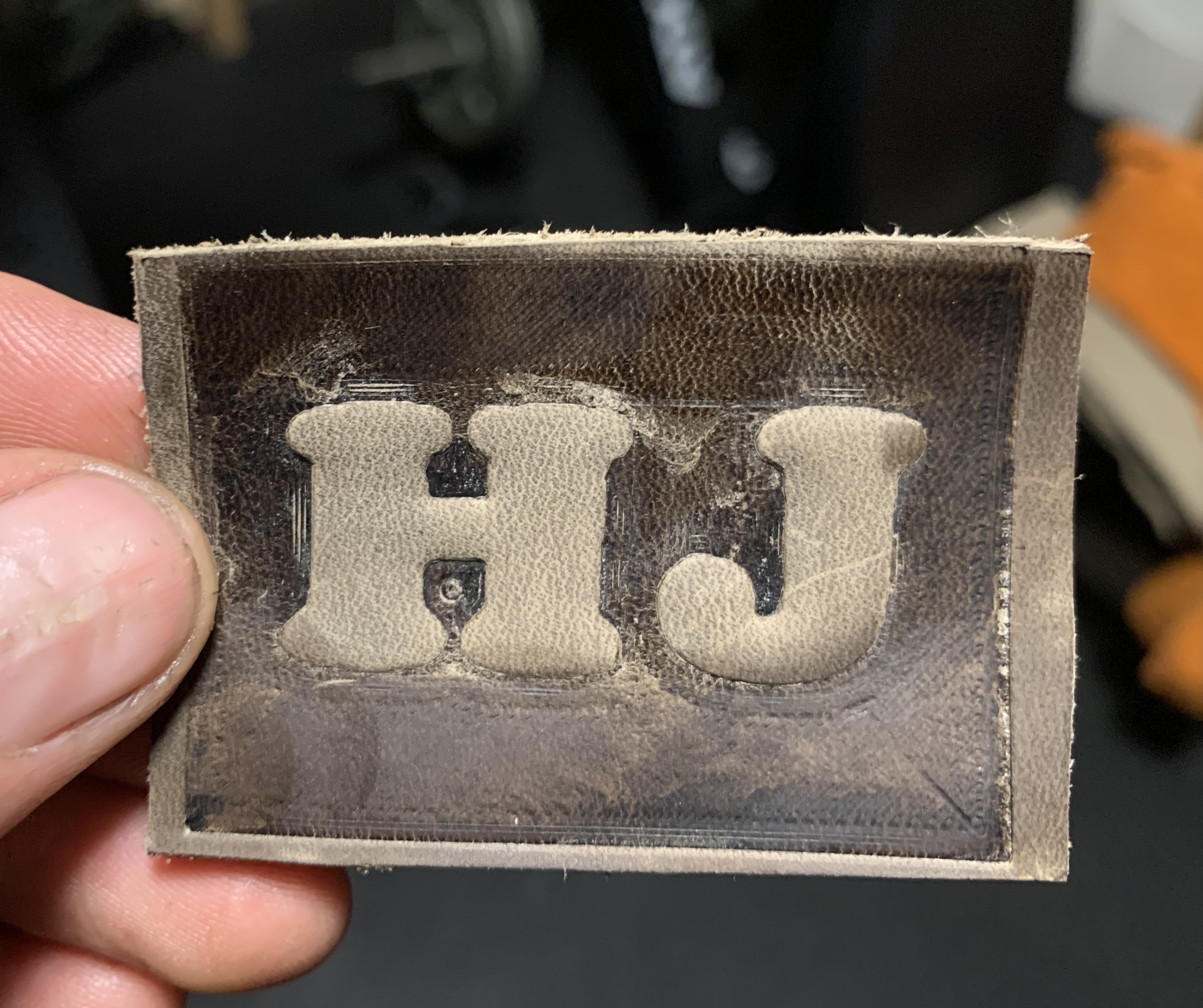

That stamp looks sweet, do you just wet the leather and whack at it with a hammer? Or do you use a press? I've only ever used tiny leather stamps when I was a child, nothing large like this.
Thanks :)
I wet the leather to burnish the area around the letters. Then I put it in a vice over night to really elevate them.
