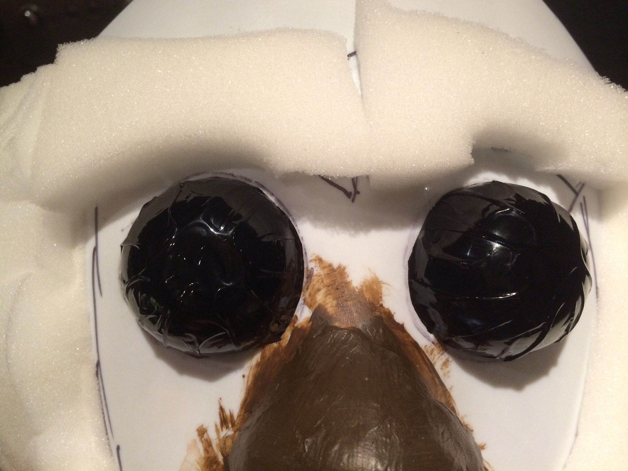

Made this for an 8 yr old who wanted to move up from his Jawa costume. I based it off of a build I found here. I got the fur at a fabric store, the eyes are the caps from $1 baby bottle at the dollar store. They get covered with the static sticker tint you can buy at an autoparts store. Toes are made form EVA foam with styrene nails, the fingers are L200. The nose and the mouth are oven bake clay. Built the whole thing for roughly $350. Weathering is done with leather dye through an airbrush.

one other question on your eyes. I got some tint from the local auto supply but it is not flexible at all. Even when I heated it it gave me lots of wrinkles in the film. Did you use a specific product that is more flexible than regular tint?

Yes on the seams. On the tint, you're buying a removable tint that sticks the glass, should have some stretch to it. I heated mine slightly to soften it a touch more and stretch nicely.

Thanks for your reply. I am still having trouble finding the right tint for the eyes. The stuff I have folds all over the place. Canadian tire just has regular non flexible tint Do you know the exact product you used and where you got it? Any help would be appreciated!
