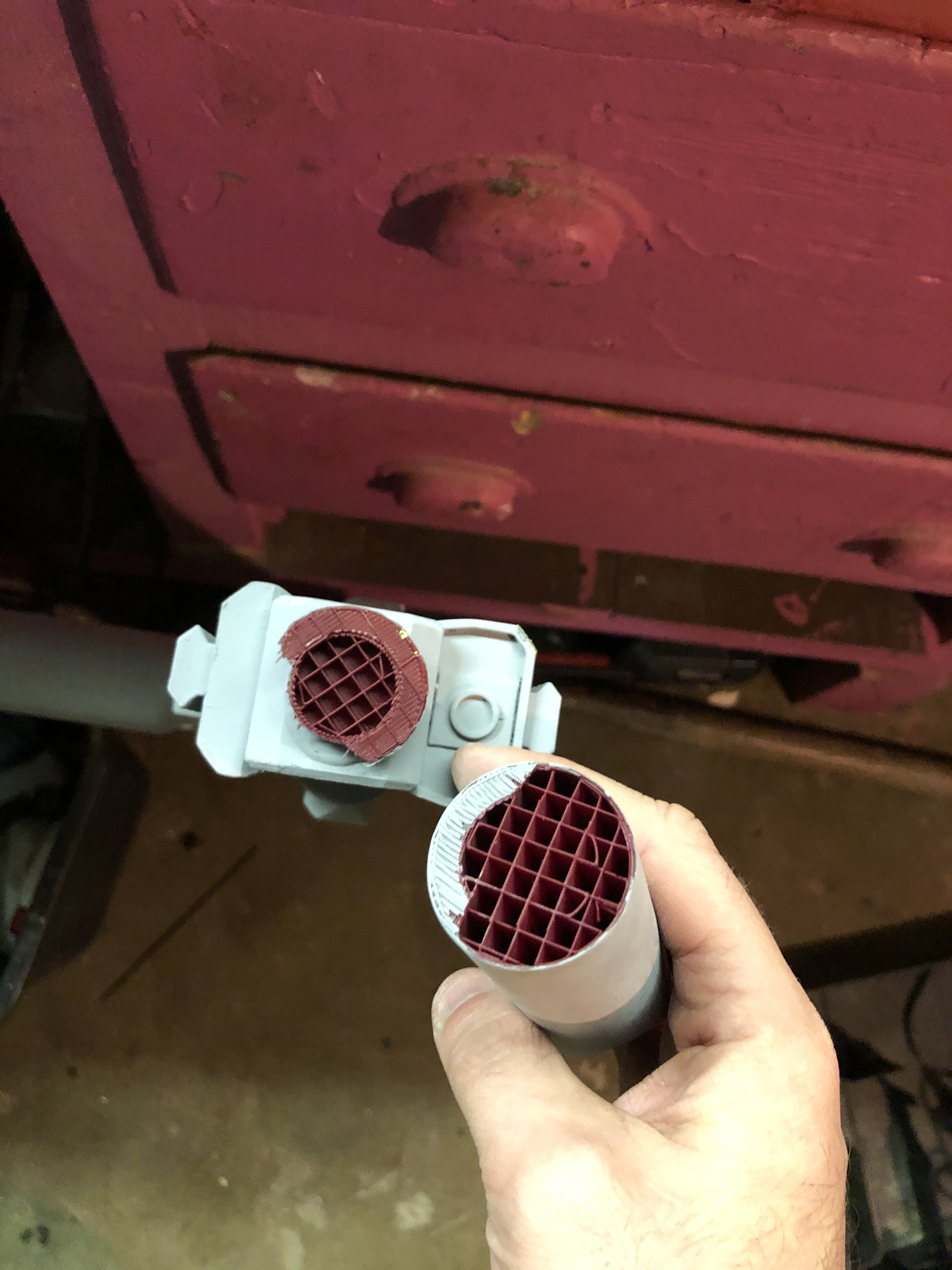

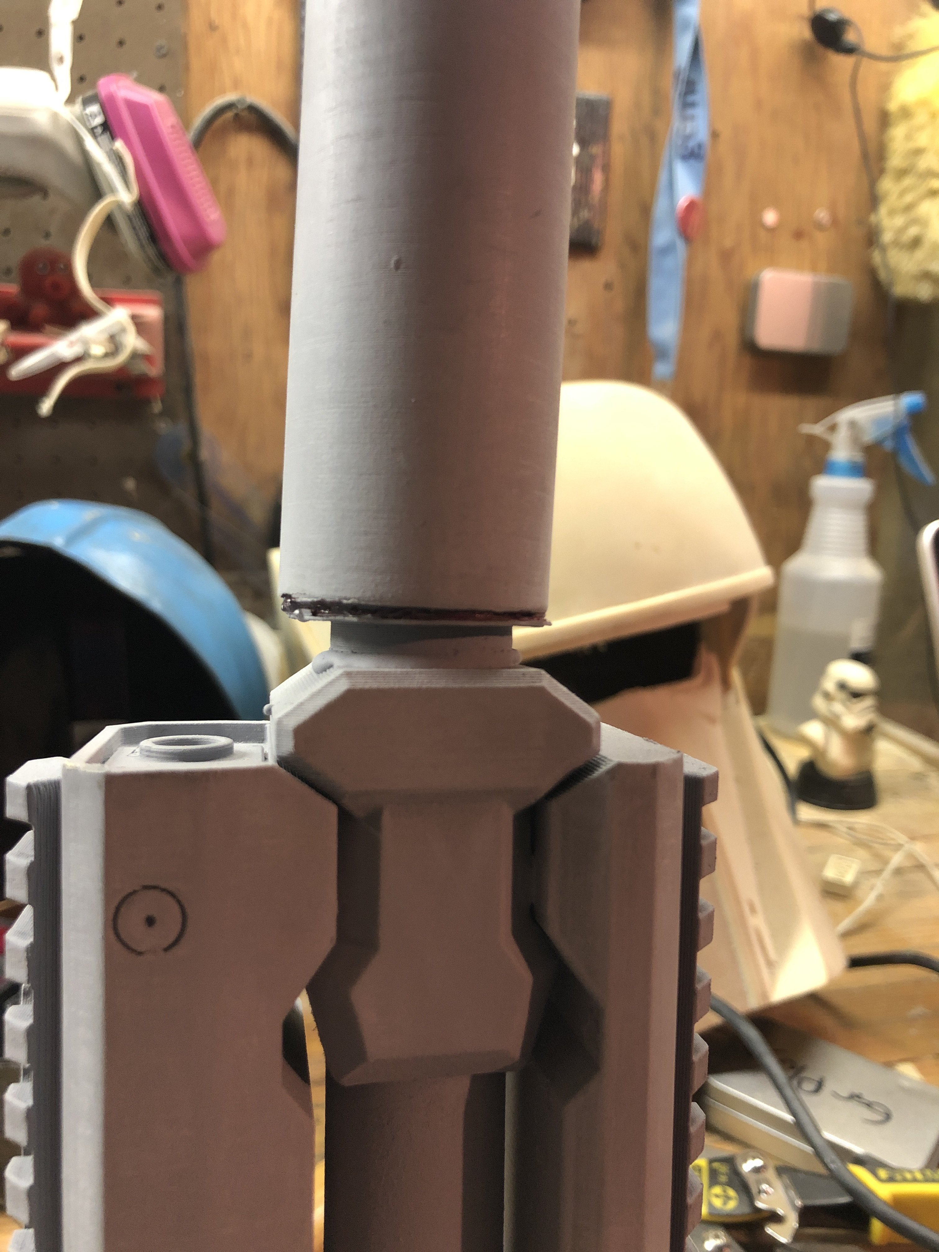

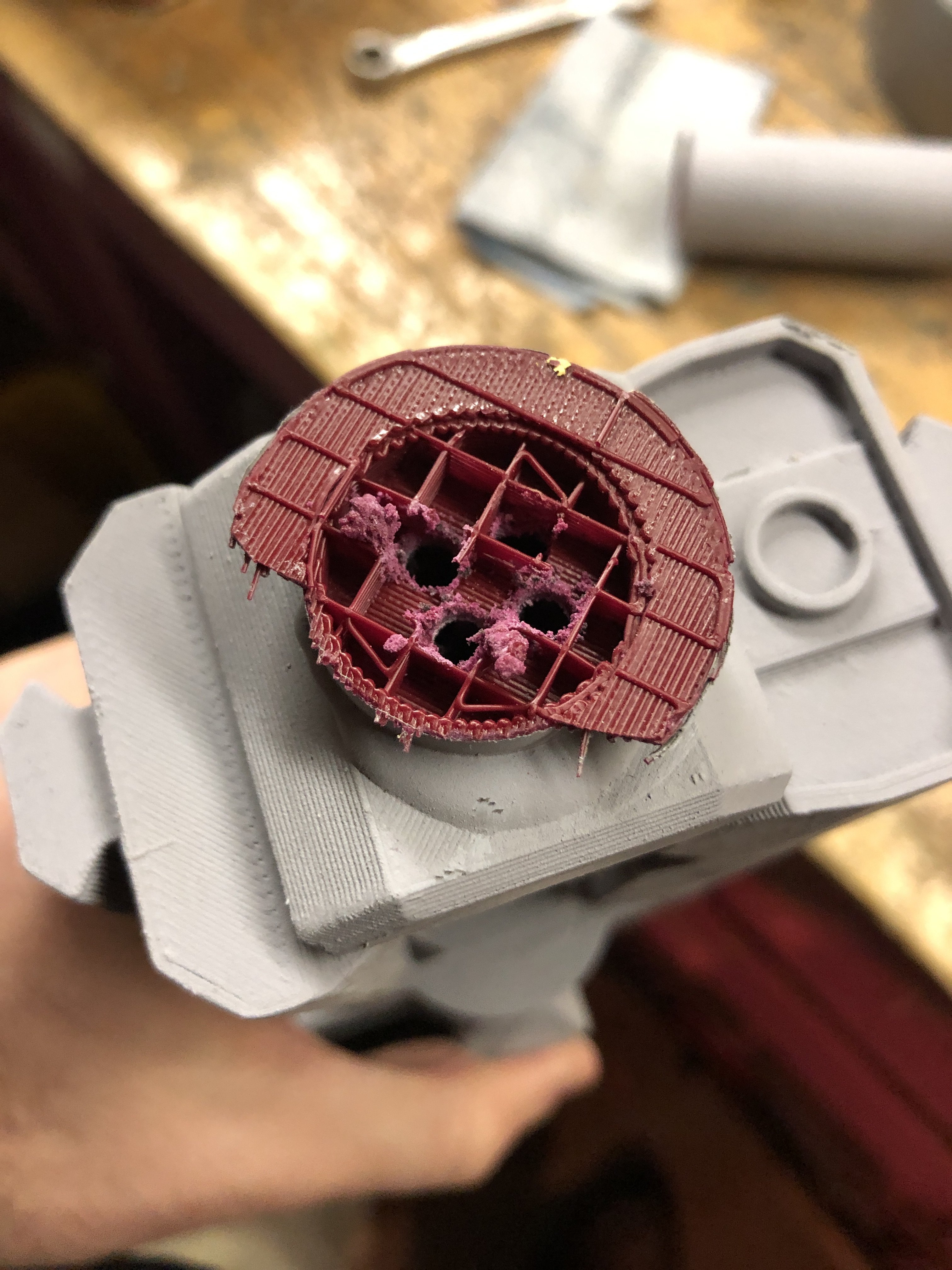

Arg, had a mishap last night: I had the gun propped up after I took it in from sanding it: one of my cats knocked it over: the end of the barrel snapped off.
Looking at the printing patten, I figured that a good way to reconnect it wasn't to just glue it back on — I took four heavy nails and cut the heads off, then drilled a couple of holes into the base where it connects. The tip is hollow, so the nails slid right in.
I slathered some glue all over the nails and in the holes, and slid it all back together — I think with a little spot-work, it'll look okay once it's primed and painted again.
tmax — might be worth a modification if you're still messing with this — put a hole in both ends, so you can stick a rod in there to connect the two pieces. It might help strengthen that up a bit.
