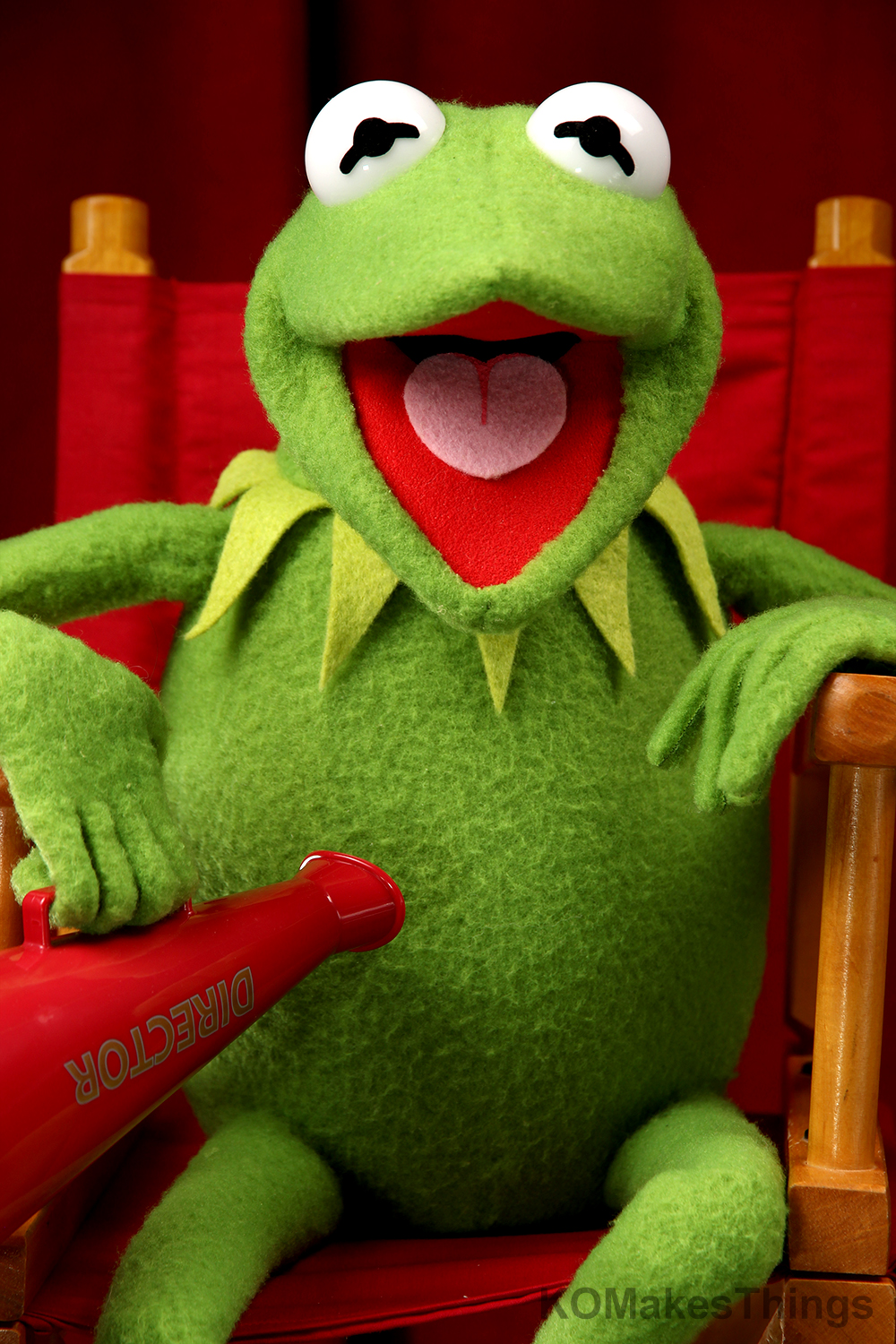

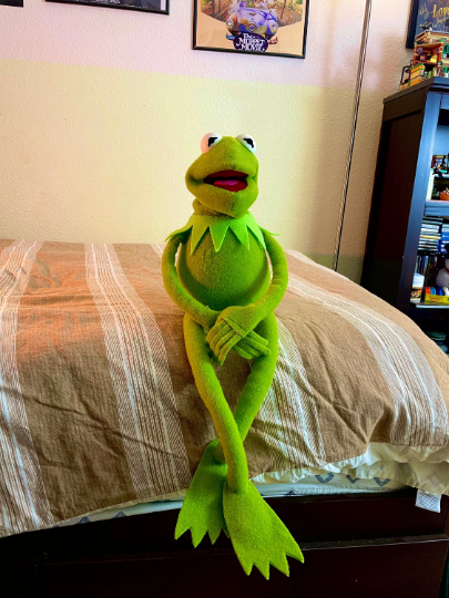

My finished Kermit build! Heavy thanks to ECL for the amazingly thorough measurements and instructions, and also shout out to KOMakesThings. His bible made this project SO much more tolerable to track the progress of and work on.

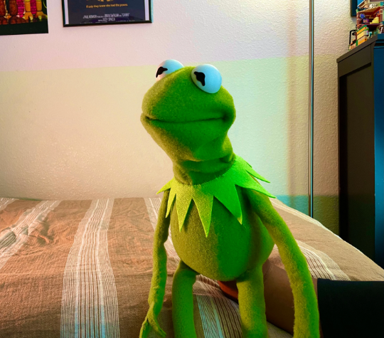

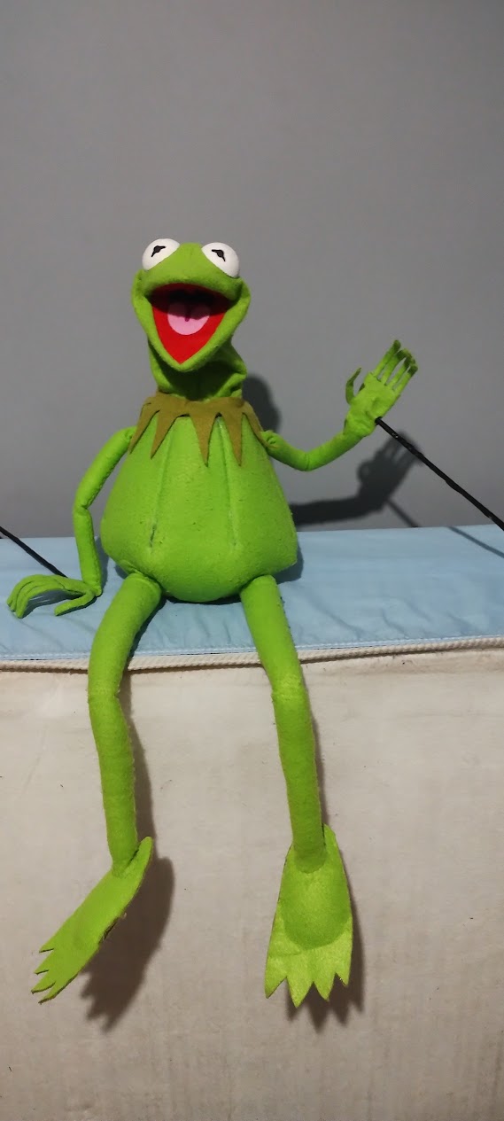

Hi ho! Finally I finished my replica, I change some patterns and made them based on photos that I've seem. Thanks ELC to inspire me, I'm 13 year old guy and you were my inspiration. At my childhood I've watched Sesame Street a lot, and now I realize this dream. Thank you a lot ELC!!
So here it is!

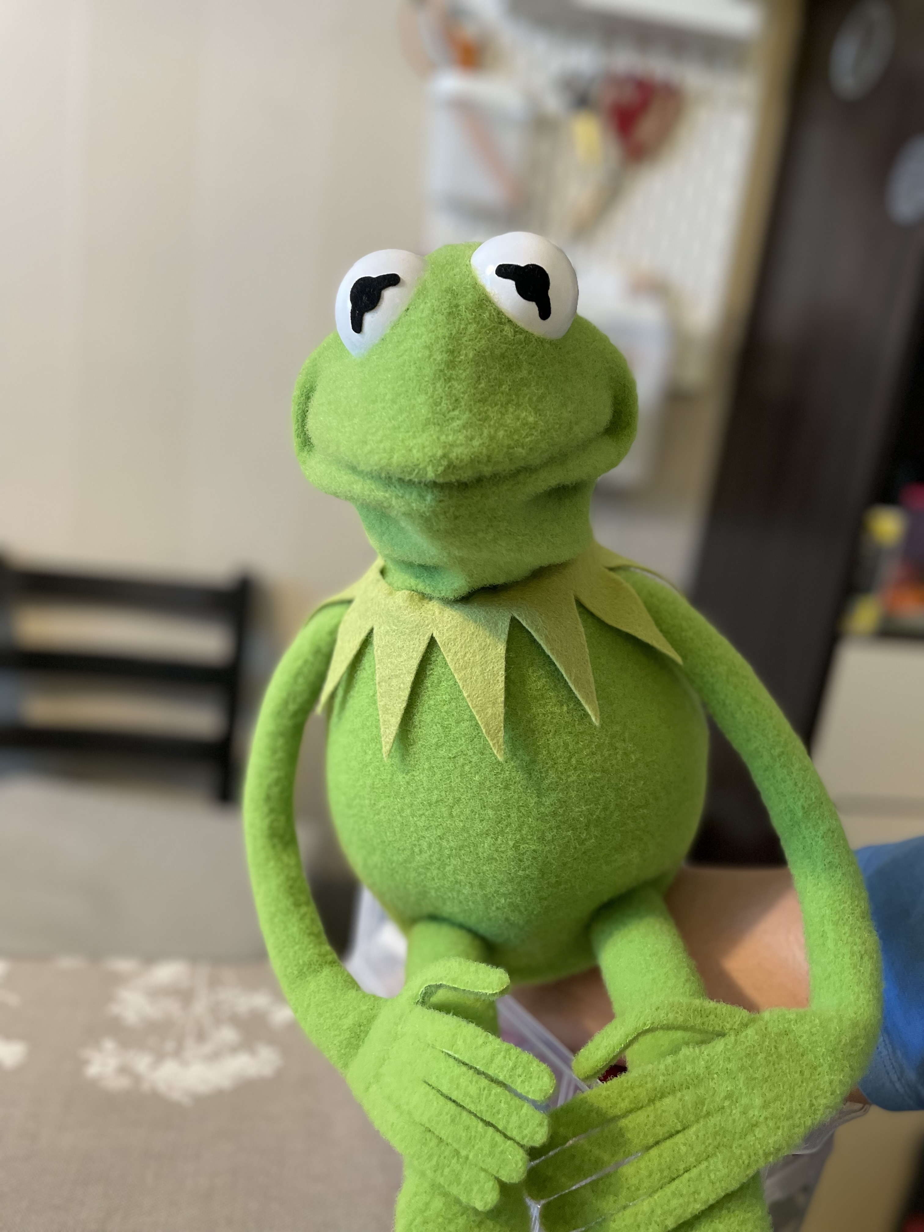

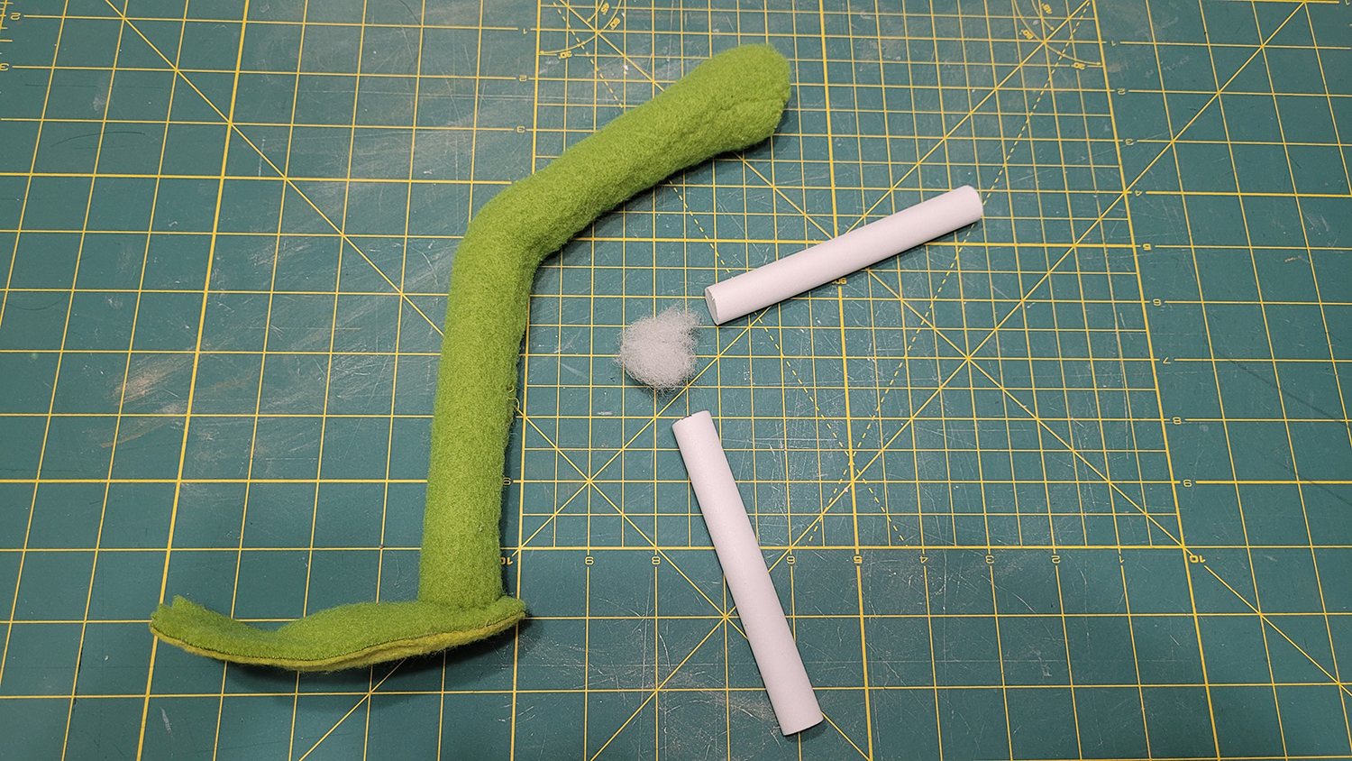

I did a few updates to my Kermit and Robin (built using ECL's notes) and thought they were worth resharing here:
I ended up replacing the stuffing in Kermit/Robin's limbs for foam dowel I got from the craft store. I just cut it in two sections for each limb, with a ball of stuffing to pad out the knee/elbow joint. Highly recommend this, I think it gives the illusion of a skeletal structure and makes Kermit look more 'real'.

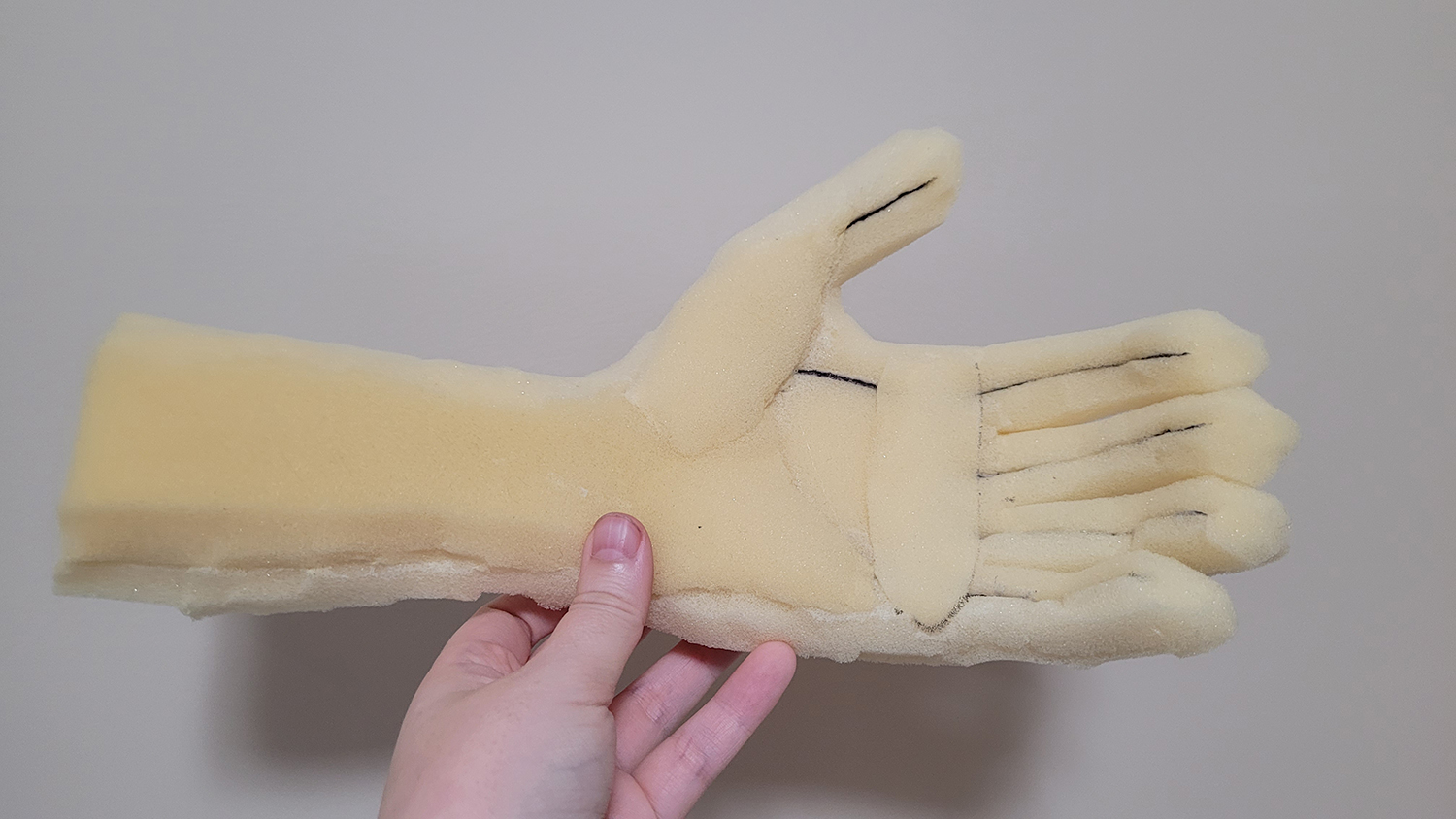

This is also a kinda goofy upgrade, but I ended up making myself a foam hand to use as an insert for Kermit's head. I got fixated on the idea that maybe my Kermit would look more accurate if he had an actual man-sized hand shape inside of him, so I traced the shape of a man's hand I found on google, cut slits into, inserted loops of wire into the slits to make it poseable, layered on some additional foam for shaping, and sealed the slits with contact glue. Eventually I'll make a stretchy glove to go over the hand, but for now it's just the bare foam hand shoved up Kermit.
I also ended up doing some smaller refinements, like shaving down my Kermit's lower lip a bit more. I was finding the fleece wanted to bunch up around the lower mouth plate, giving Kermit a big jaw... so to compensate I cut a bit off the lower mouth plate (Possibly too much in hindsight), and then re-glued the fleece onto the mouth plate, making sure to glue the fleece onto the edge of the mouth plate as well (Which I felt helped control the jaw shape and helped define the cheeks a bit better). I kinda wish I had reglued the entire mouth, my Kermit has a pronounced upward curve to his upper lip that I'd like to get rid of. I might try dabbling with my Kermit pattern in the future to try and get rid of that, but otherwise I'm really happy with how my Kermit and Robin are looking.
(FYI, the chair was an old Seasame Street toddler chair I found on eBay and sewed a new seat/backing for, and the megaphone I stole from an American Girl doll).

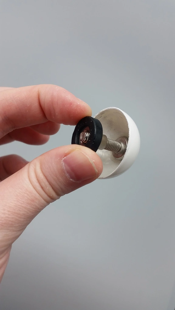

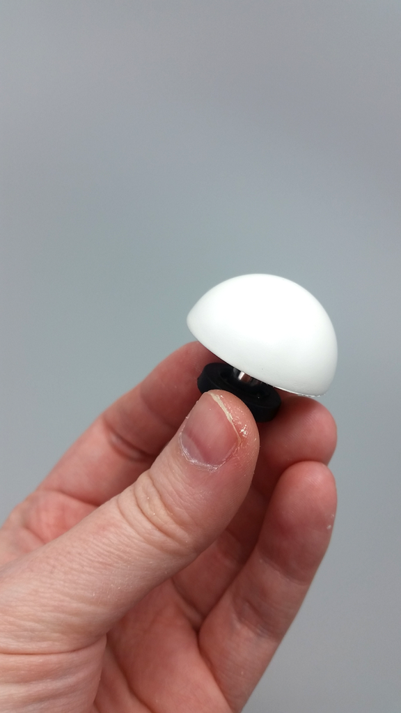

Seems like it's been ages since Puppet Pelts stocked their 35mm eyes, maybe once the new owners are up and running they'll get them back in stock?
When I made my Robin build I used some of those fillable christmas ornaments and some screws to make half dome eyes, maybe you can find a pair in the right size for Kermit?
