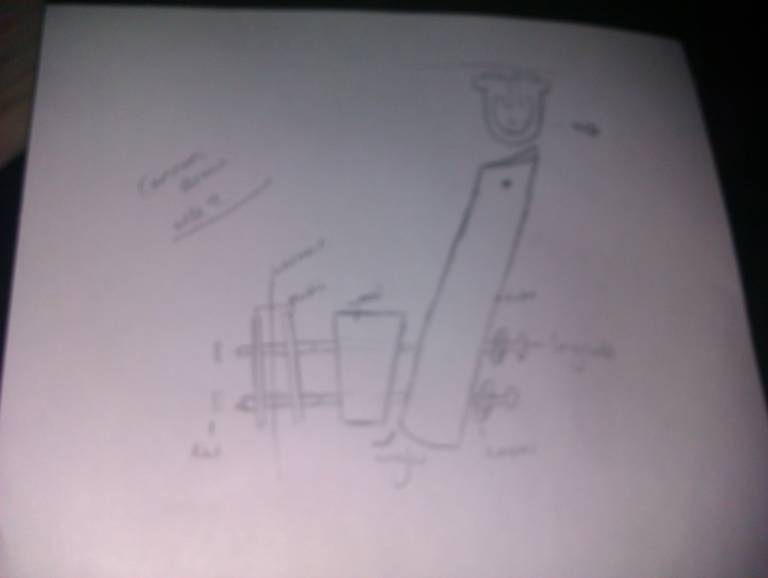

Ok, I think I may have come up with an idea.

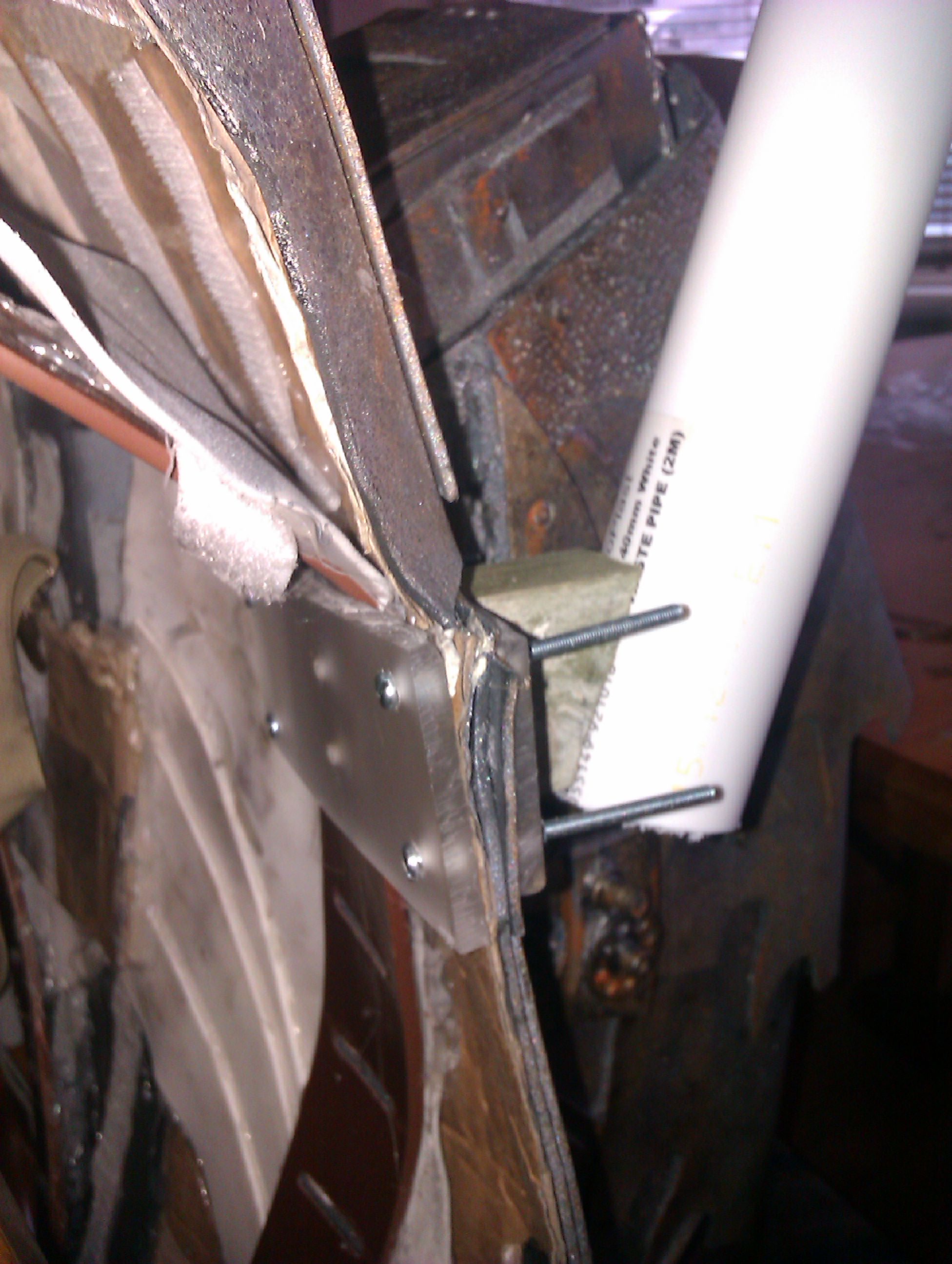

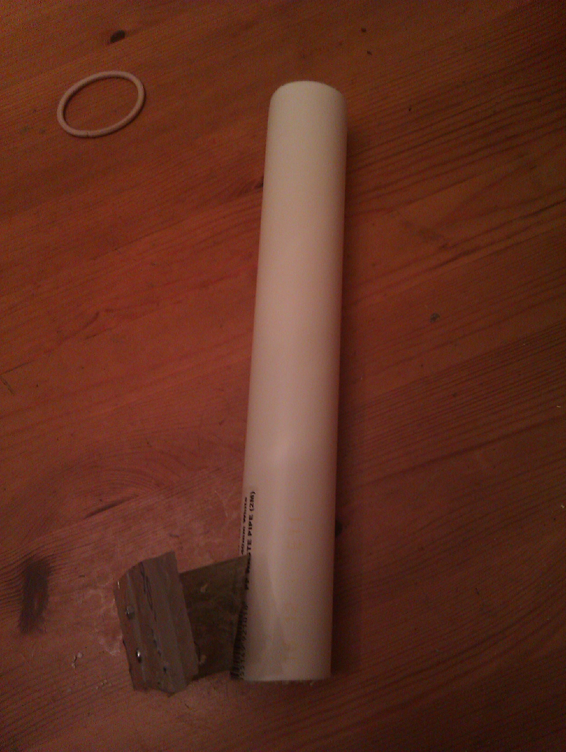

Basically, two pieces of pile or in my case Plexi-glass, one piece on either side of the armour (underneath and one on top). Then a block of wood cut to an angle and a piece of PVC pipe (40mm in this case - thanks Tony) bolted together using 2 long bolts. The two pieces of plastic will be held together using the 2 bolts, and then a further 2 bolts either side of the rig.
Then I started to contruct the rig. Once perfected etc, the whole thing will be decorated out and disguised.
What you think?

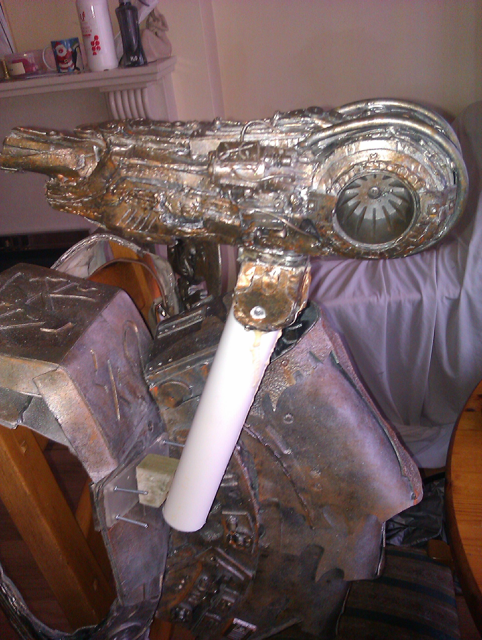

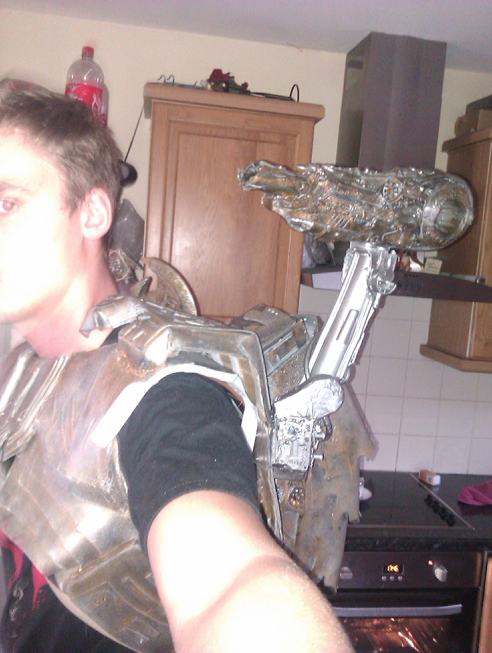

Ok had a test of the arm and attached it to the armour and cannon mounted

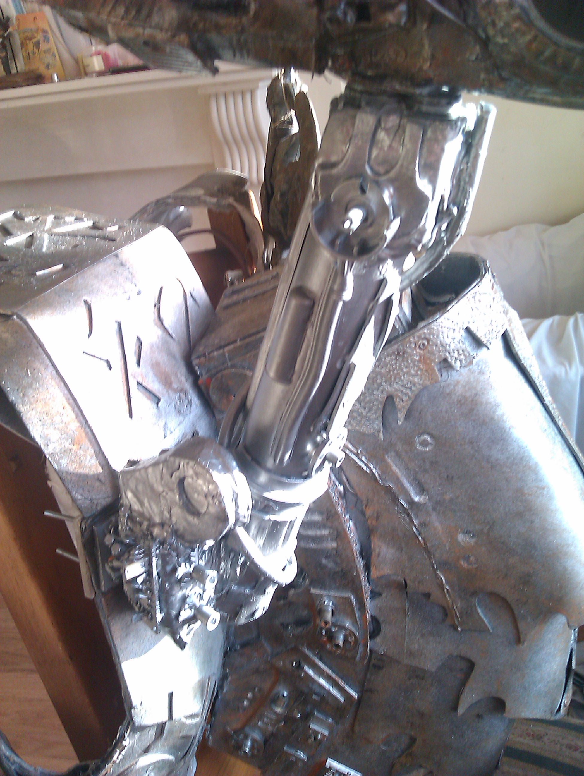

Next I added the details, primer'd and painted up. Still needs weathering, ageing and my patented rust up lol
What do you guys think

Weight is still pretty much the same, maybe a little lighter than before but the straps that I added under the armour have been tightened and now hold all the armour in place so no movement lol Thanks for the pipe man, came in really handy.
Also, the cannon now stays upright and doesn't wobble around all the time lol
