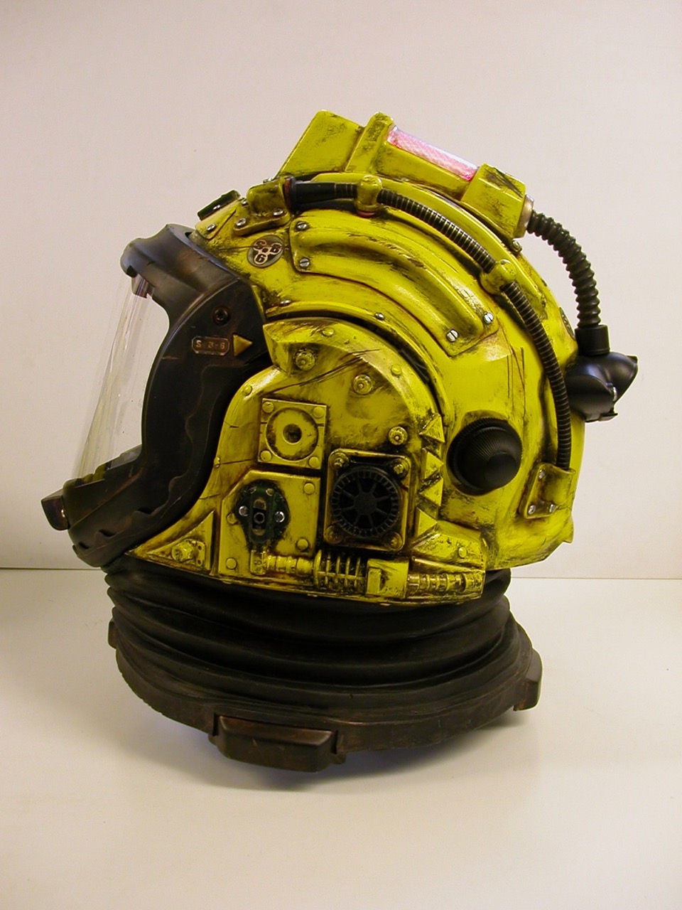

Fantastic! You’ve done great on this project. Your attention to the details and shapes of your 3D prints is truly top shelf.

The helmet held up well at Comicon Stockholm this weekend. Not even scuffs and scrapes even though I hadn't had time for any laquer for the paint.
People say 3D print props are brittle but the solid print ABS seems actually fairly sturdy. Some small parts would shatter if I dropped the helmet so these I aim to make spares of to bring along to cons.
The air system is flawless, well I forgot to charge the big 8 hour battery for day 3 so I quick charged it on site and still got half a con day out of it.
I'll say this about the Scott Tornado respirator system, it's really good. I have both the simpler variant from before and now the black one with power and charge led indicators and alarm. When you learn how it works it's pretty great.
Before using it I attach the tester that comes with it to indicate safe airflow. It's pretty great, gives a physical indication and gives confidence in the resoirator.
When you build the helmet you will need the tornado respirator, it's an airtight helmet with a minute worth of air inside so you need the professional airflow system to wear it for any lengt of time.
All the wiring I put in the helmet is standard sections of 12v extension and fork cables using 5.5 / 2.1 mm connectors so they are glitch free (most other small and handy plugs aren't) and easily replaced.
One thing I want to fix is I just taped the wiring to the roof of the helmet from lack of time before the Con and I want to replace the tape with stripe points or even better velcro points.
I could add these to existing screw & nut points, I'll figure something out with that.
I also need a velcro strap to hold the 9v pack and lights dimmer.

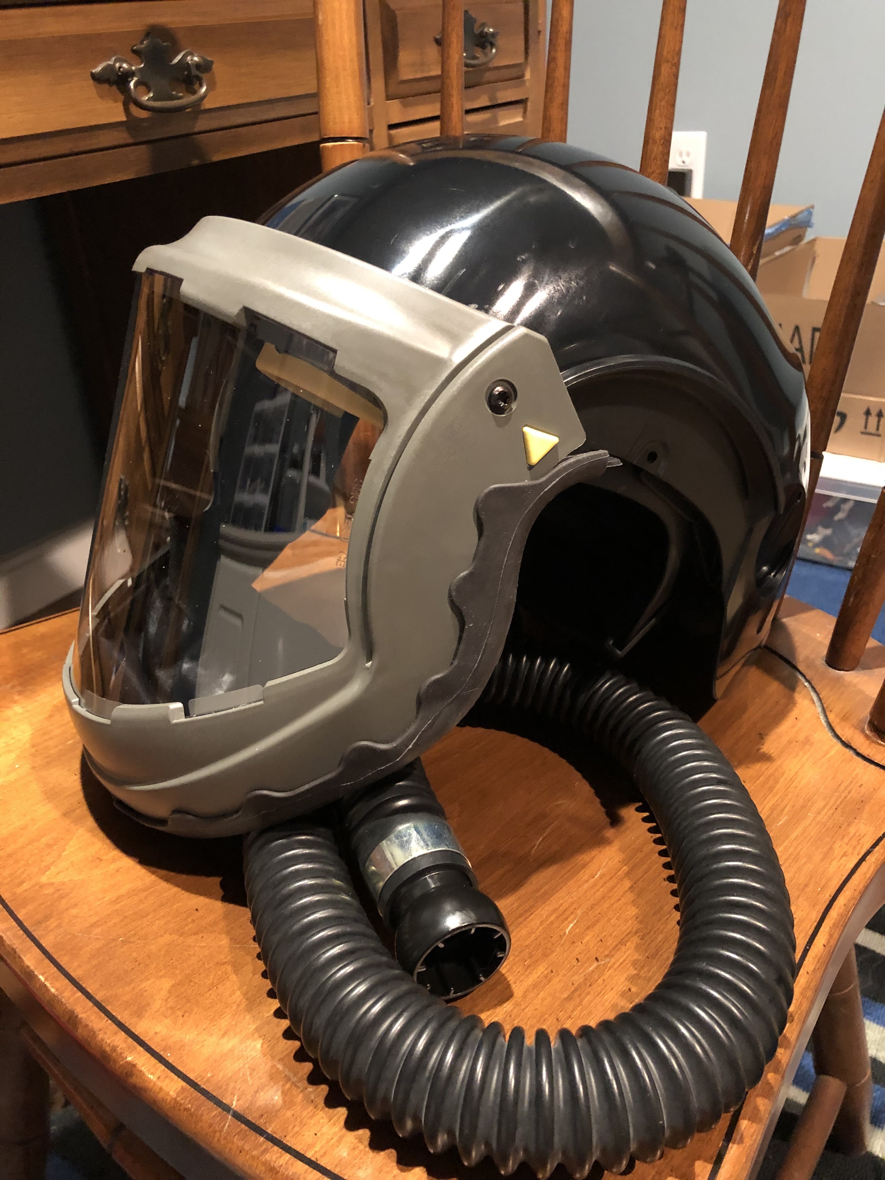

Well, I’ve done it. A little spontaneously, but a good deal came along on the welding helmet.
I’ve just got to clear some projects off the bench, find some time, and figure out how I’ll build the parts. Easy, right?:eek:
(What have I done? :))

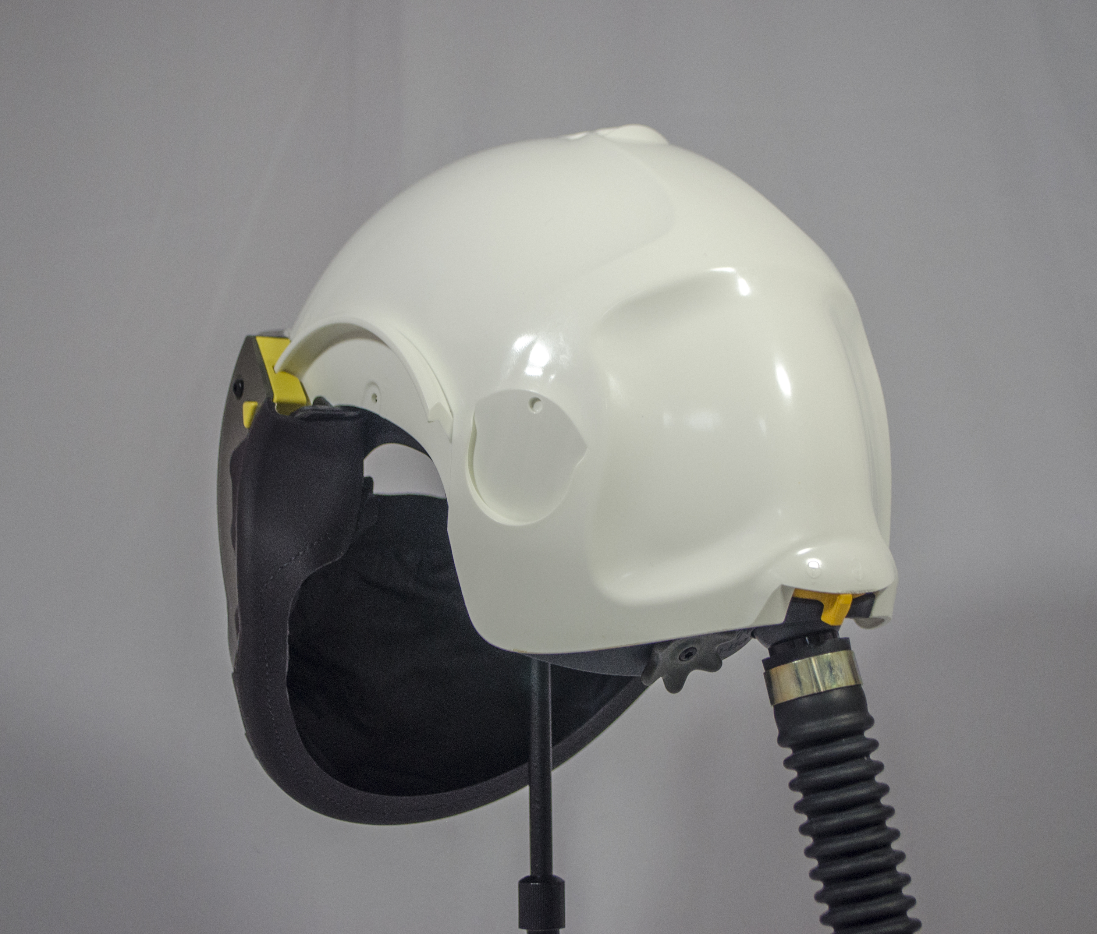

Wow. Amazing work on the helmet!
I have the white ProCap helmet but the modifications are very daunting!

Hi JKRIB,
the 3d printed parts mounting was easy. The hole for the moved hose connector and addition of the bellows are a little complicated. But not that much. The plastic of the helmet lends itself well to drilling (not brittle) and I drilled corners then used a woodcarving knife to carefully enlarge the hole for the moved connector.
For the wiring I just used pre-made wires with connectors you plug in and glue or tape to the roof of the helmet.
None of it is all that demanding compared to some prop builds.
I suggest printing the parts, getting the screws and nuts (I'll post a list here), place the printed parts with dual sided tape for a mockup and then figure out the rest.
I'll be happy to give more detailed help as you go along. :)
As I was thinking of re-fastening the wiring and repair a broken printed part I could disassemble and re-assemble the helmet and make a video of how to mount parts.
Or maybe make instructions with photos. That might be even better...

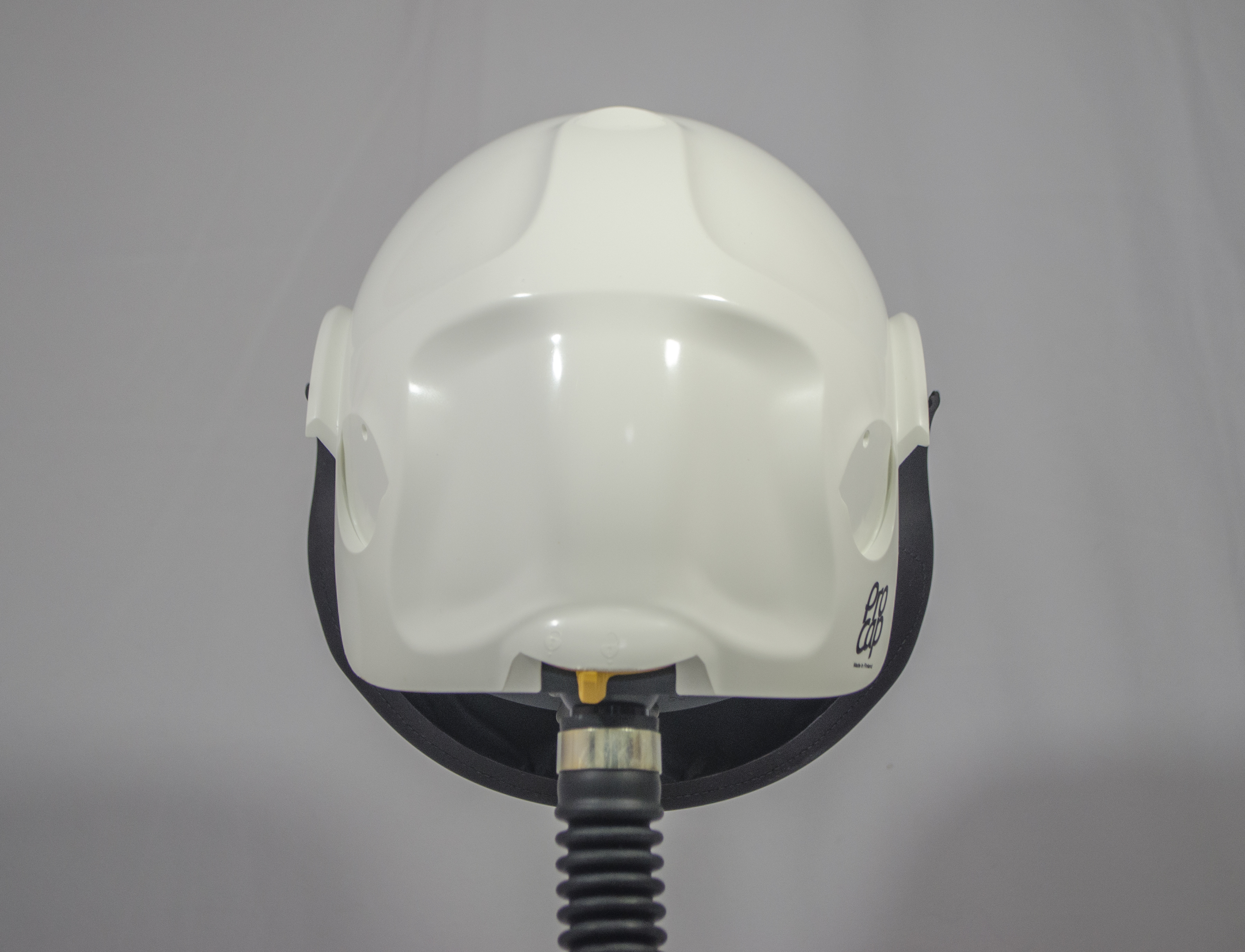

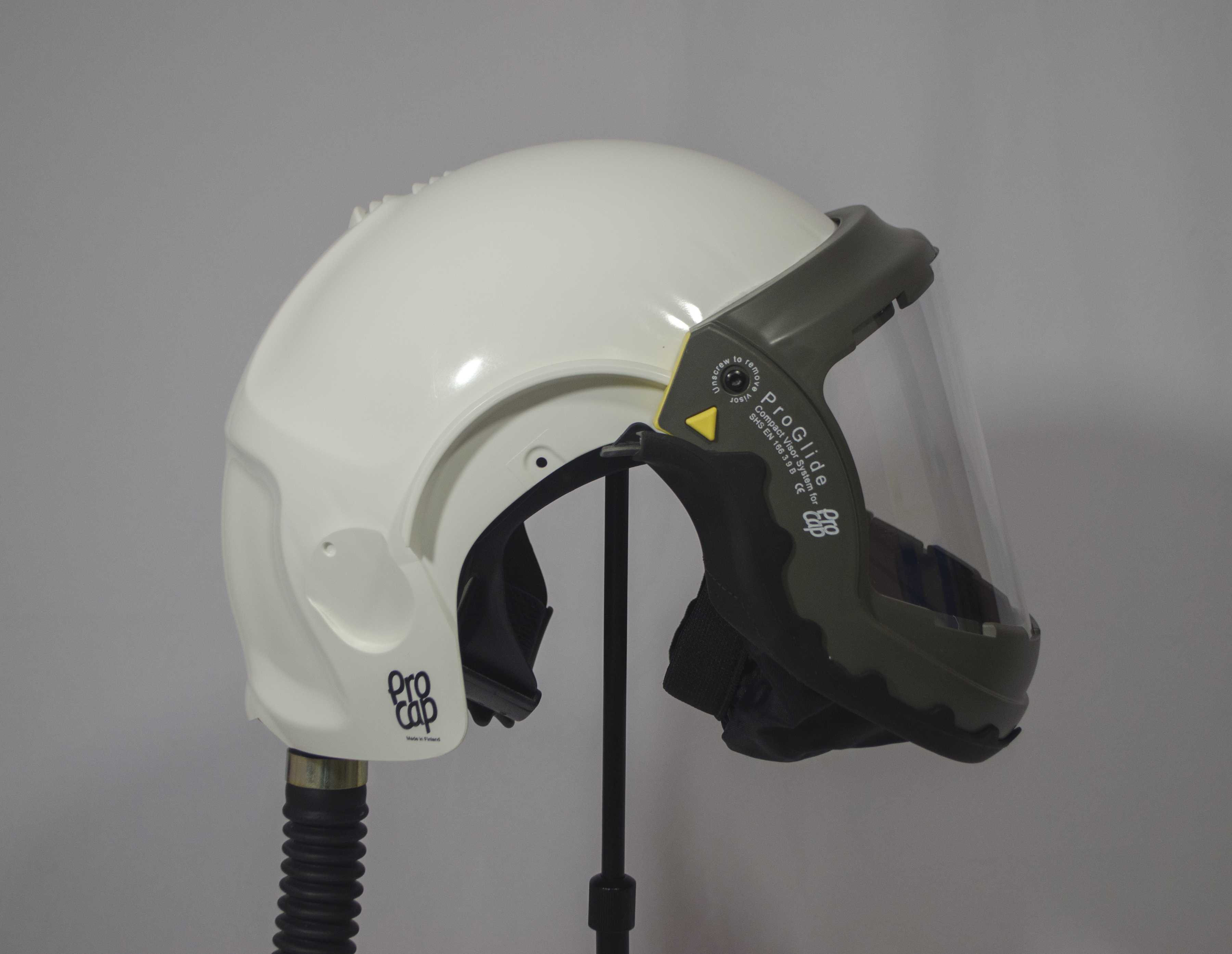

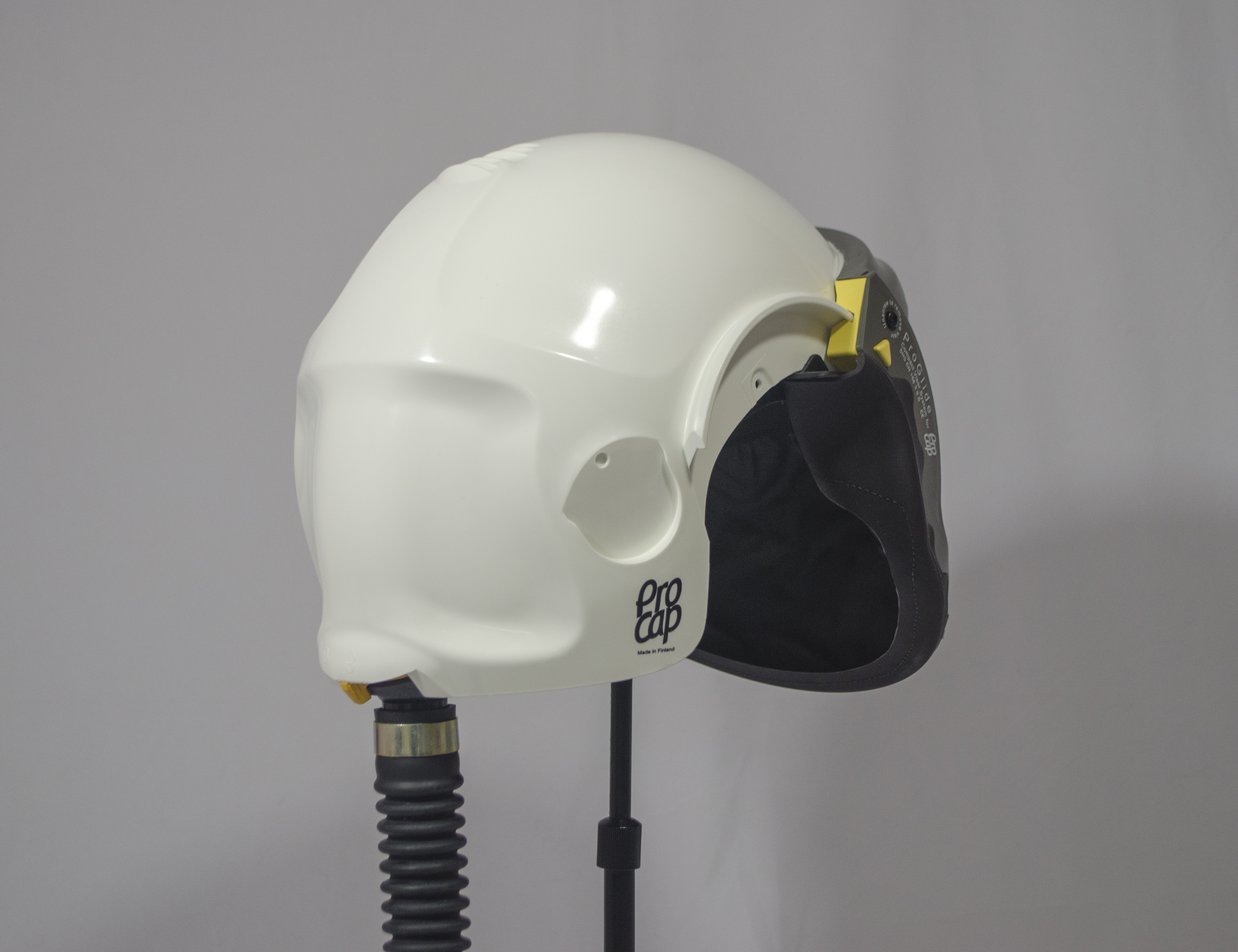

Here are some photos of the production helmet from Mark Cordory, who worked on the props.

Thank you for the list and excellent photos! :)
I think you can still find the gloves on ebay.
"Extremities Ice Gauntlets"
The Arctic boots are still being sold, so is the old version climbing harness. Well they used the newer version too (clara has the padded belt version in kill the moon)
I think the list is complete.
The same procap base helmet was used with the welding visor on in one ep also (if I recall correctly) but used for a different build, and a variant for the orange suit was used for diving gear.
But for the real orange space suit I think the list is complete.
The photos show things I didn't have clear images of. I think it's time I updated the models to get these details right. :)
Mostly it's the chin light and the bent sparkplug thingee at the back bottom of the ear piece. I see it's also the connector ring for the ribbed hose going into the back of the lantern housing. That last one just takes a minute to update.
The rest take longer. I've been meaning to do these updates but seeing clearer photos help to understand the sometimes mysterious geometries better.
