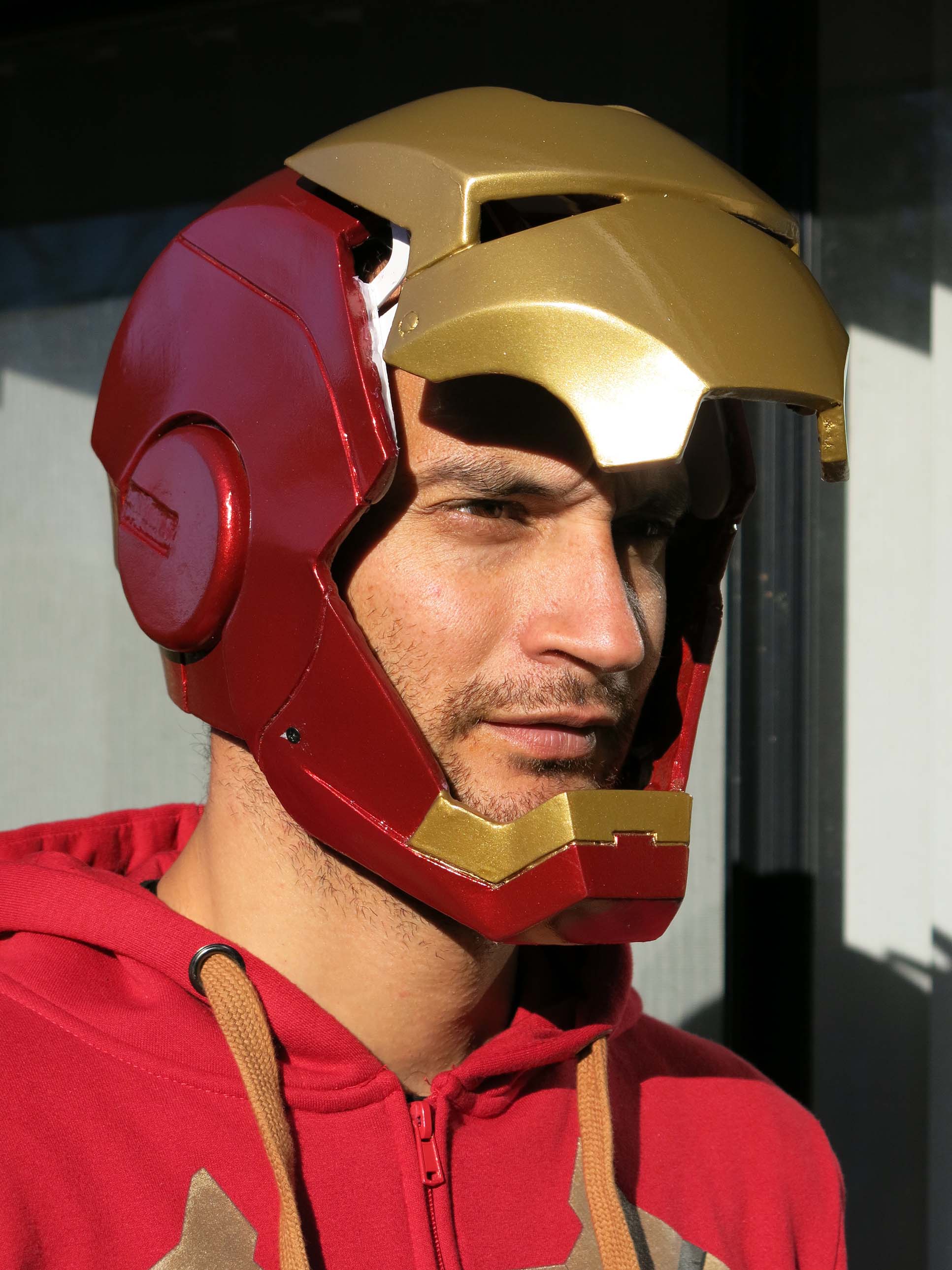

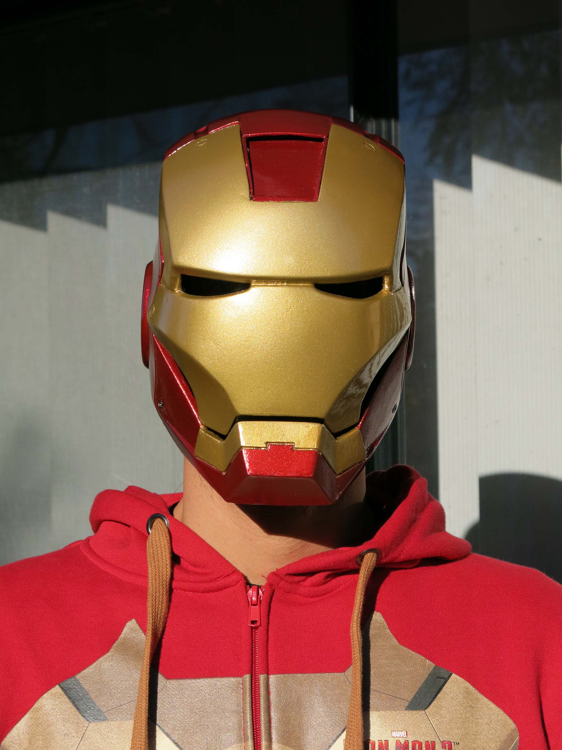

ok so this is my eva foam helmet using Doc's rondo method... was a lot of work in the end to get it right, well close to right...
Re: Doc's foam work + The last foam painting method you will ever need.
thanks guys :D thanks Doc for giving it a go and showing us all it can be done...
Holy smokes!!! That turned out great. Really great.

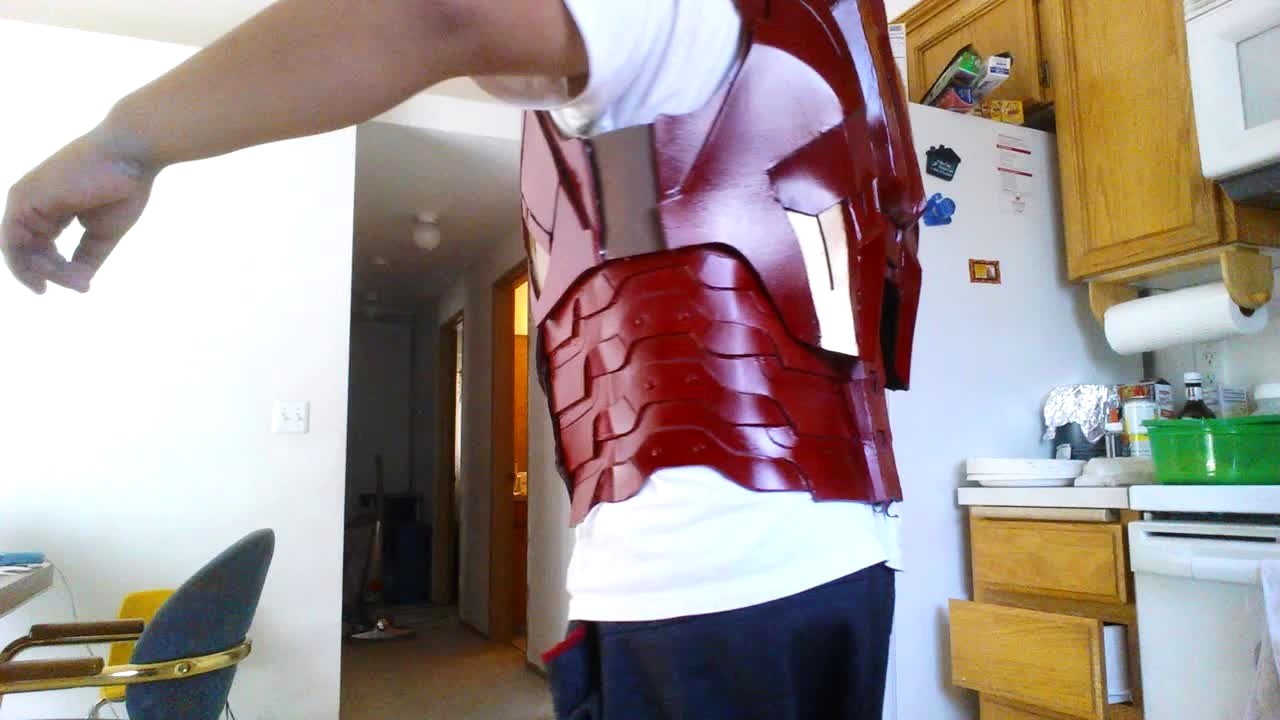

Re: Doc's foam Ironman, warmachine and Mark 6 leg mobility example vid
Finally after so many failures I got a functional inner thigh piece that is as close as I could get it to the real thing. I just need to widen it alittle but its attached with velcro so it can be removed. I couldnt stand the huge gap there and now it looks awesome. The customers gnna flip:D I hope this vid isnt upside down too:lol Enjoy:cool

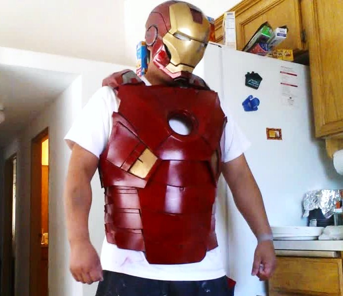

hey bro you got any pics of you suited up in any new builds?
If your good with a brush then yes you can. Cuzcif your not it will leave brush strokes. Once dry you can wet sand smooth if ya have to.
thanks man, appreciate that. And yr right I never been asked that hmm that a tough one lol:)
thanks doc! i took off the plastic bristles to avoid brush strokes and use the flat side to paint. I guess I would use the spray can but wanted something I can work inside the house. plus weather here sucks anyways.
Sure here are some pics of freehanded abs for mark 7 just no gold detail ,ill load vid later:)
