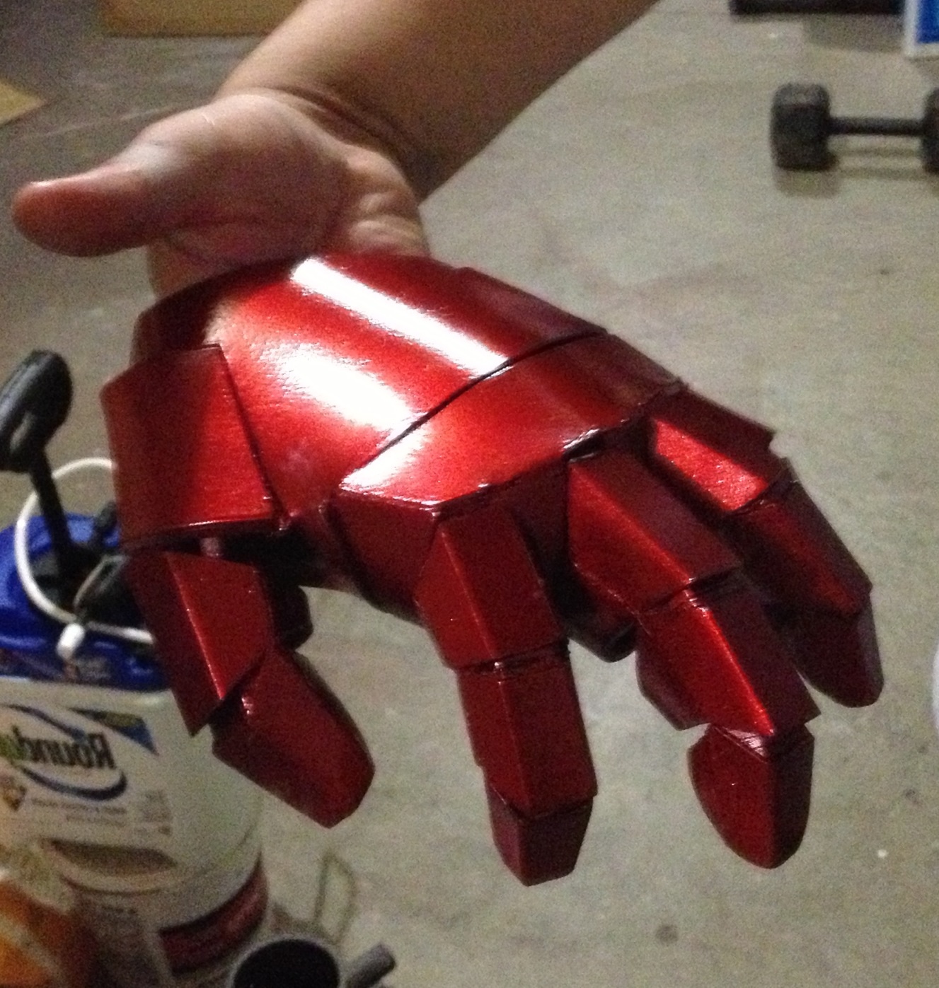

I have a few seconds of free time lol but as promised. My last method I will post cuz after this you guys will not need another one. The most simple, foolproof method that will give ya shiny, durable that can flex.
Lets begin....
1. heatseal,just few passes if ya dont have heatgun just skip
2. 2-3 coats of pva, elmers or what I use modpodge
3. 2-3 of liquid electrical tape
4. before it was adhesion promoter but doesnt need it with this product. Its an elastometric coating.
2 -3 coats. It has adhesion promoter mixed in.
5. top coat any color but try to only put 2 coats 3 at the most. The less coats the more flexibility it will have.
6. the last step, this is also an elastometric coating
2-3 coats of This high gloss flexible clearcoat, stuff is awesome.
and thats it pretty simple huh? if ya follow steps you should have awesome results that flex. So if ya have questions I may not answer for awhile cuz swamped just refer back to here. I was working to find an easier way for everyone and this method is the easiest you'll get to achieve this and posted vids already. Good luck peps
