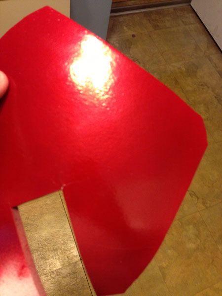

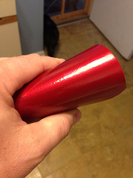

Ok, did some testing and the method does work. I tried it on some 12mm and 6mm foam with both Duplicolor and some cheap Krylon paint. The photos show the amount of bending that it can take. The paint did eventually crack, but it took alot of punishment before it did. Also, on a side note, the Krylon outperformed the Duplicolor paint and was much more flexible.
As always Doc, fabulous work!
