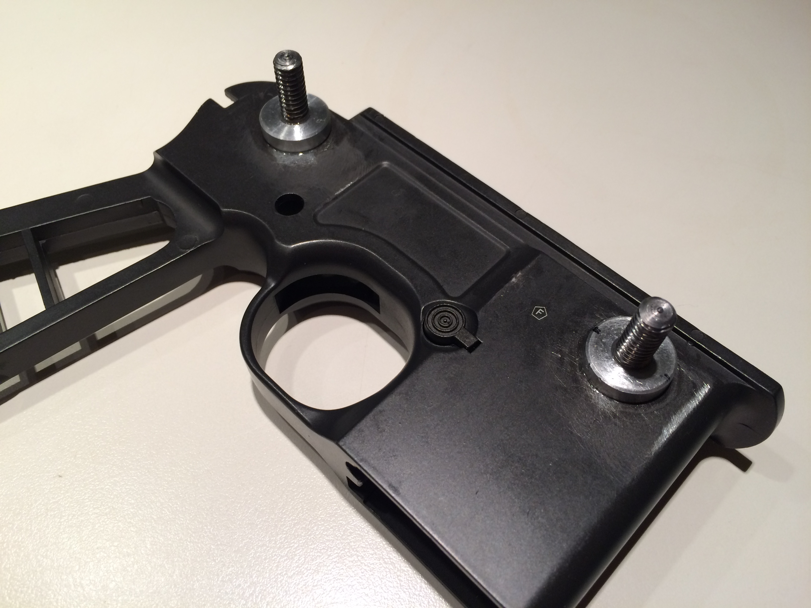

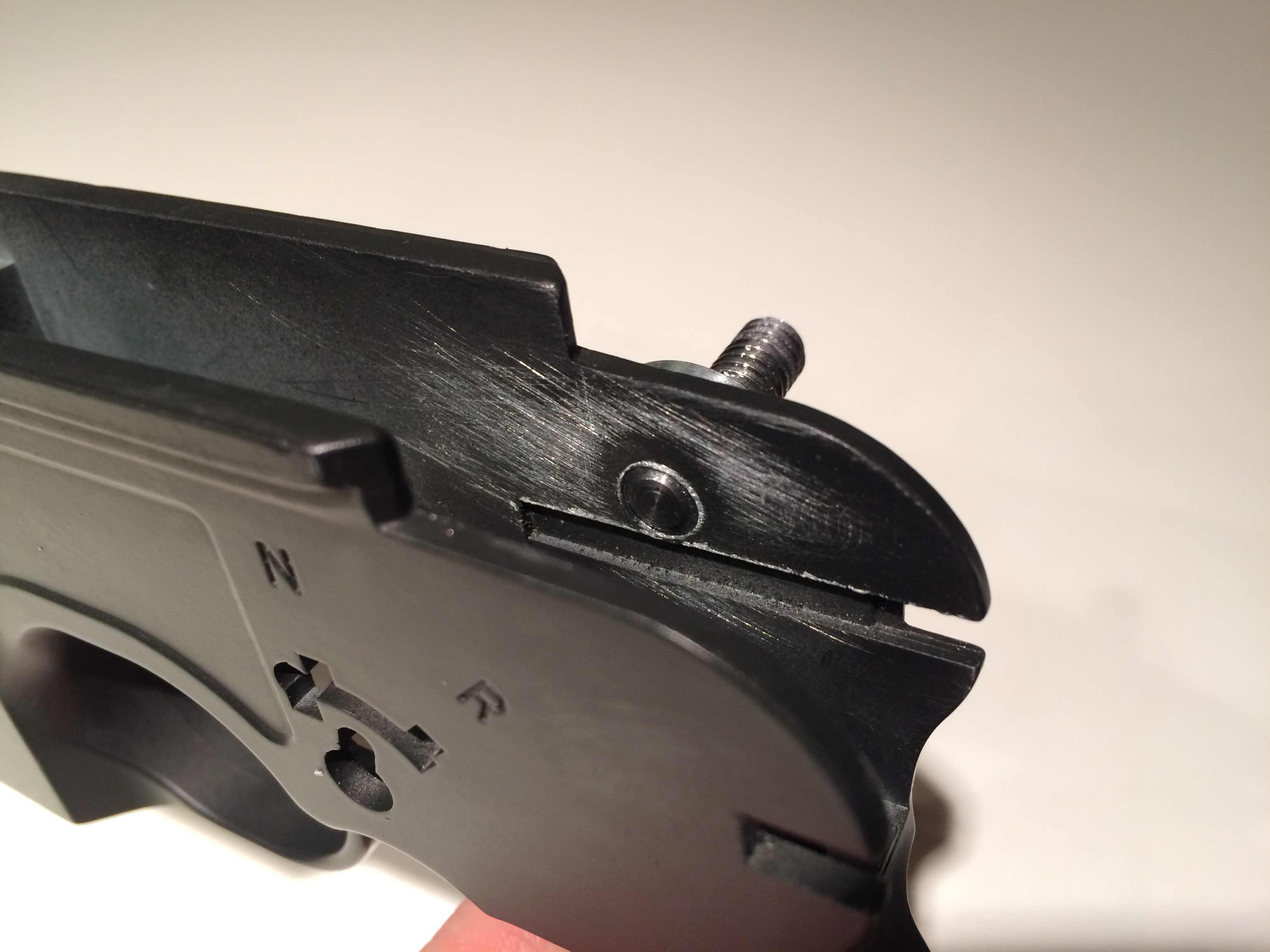

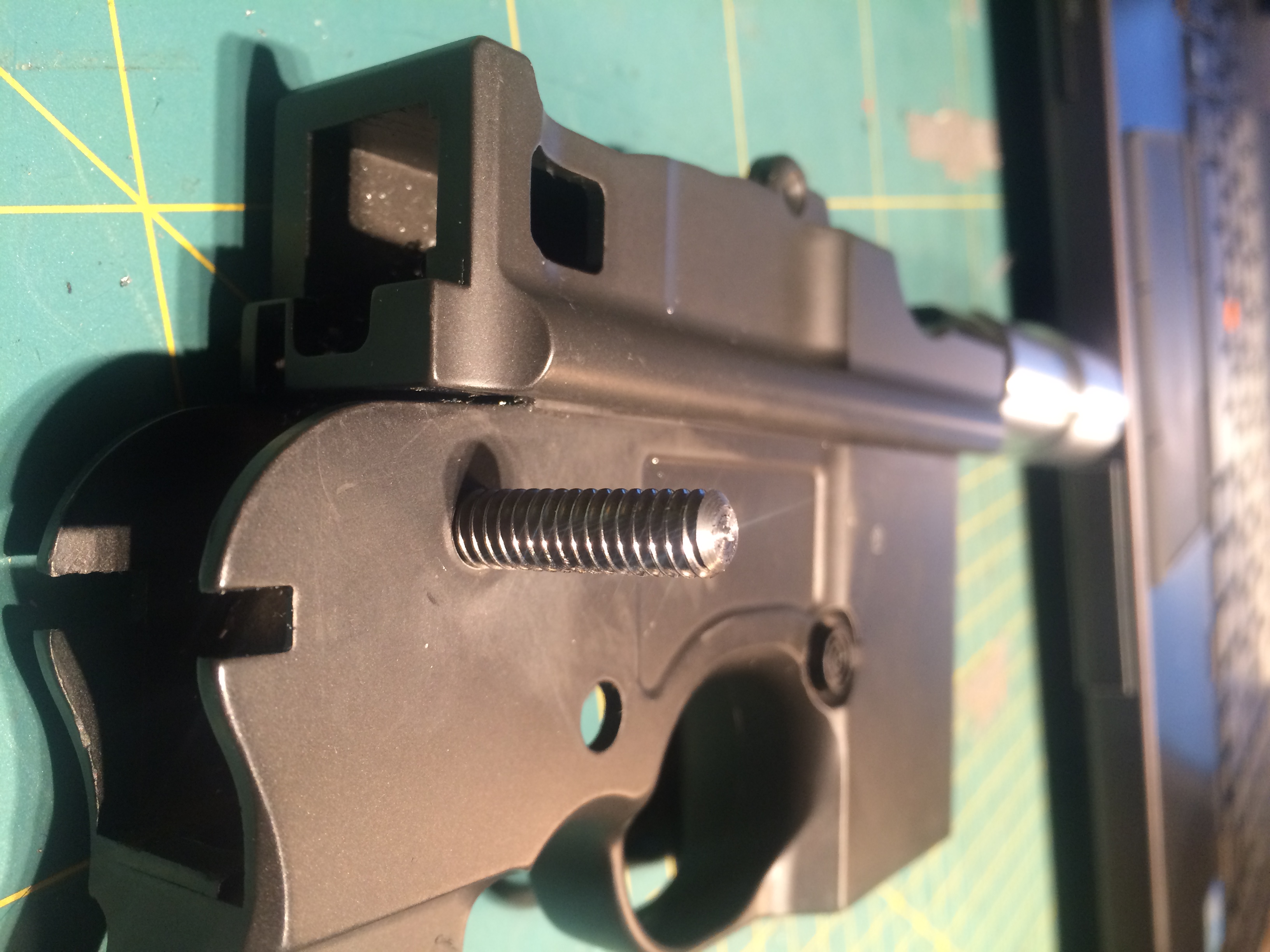

I got the ANH DL44 set from Dark Energy before seeing the TFA prop. So I will just try to make the best of this set and my HFC mauser. Sorry if i'm hijacking this thread - perhaps it's more of an exploring the TFA blaster, than working with the HFC gun thread. I would just like to share how I attached the scope, without killing the inner gun mechanism.
1. Dismaltle the gun totally and remove all of the inner stuff
2. Drill the two holes for the scope bar
3. Use a thread cutter in the holes. The metal is 2mm thick, so there is enough to turn the screws about 3 times.
4. In the hole in the back of the gun you can turn the screw 1/2 mm into the gun, but not anymore. The magazine well has no room at all, so do not turn the screw into the inner.
5. Put epoxy on the screws and turn them into place. Put epoxy on the back of the two caps and the lower part of the screws. This glues the caps to the gun and the screws for extra strenght.
If you use the ANH kit from Dark Energy, the front cap needs to be filed, so the scope bar can run paralell to the gun. This is because the mag well on this gun is wider and has an angle compared to the denix. I just used a file and some patience.
It has cured for 30 hours now, and it seems to be very, very strong, and it does not disturb the inner gun mechanism at all. So I think this might Work. It was strong even without the epoxy. I wanted to avoid silver welding, because my chance of getting it right would be 0%. I have no experience working with epoxy or metal - so any comments would be nice. If it breaks off i'll let you know:) Im considering if i should insert another screw in the middle, just for extra support - there are three caps on the scope bar, so this should be doable.
Edit: I should mention that I wasnt able to get a hold of the 1/4-20 thread cutter that the assembly guidelines from Dark Energy Creations advised, so I used an "M6" cutter. This does not have a perfect fit for the supplied screws, helping them to Lock into the hole - but making alignment a bit tricky.
Edit: The HFC gun is a bit "oily". Clean the screws, caps and gun carefully. I used isopropyl alcohol, and I also sanded the gun and caps where the epoxy where to stick.

I have cut the screws after making the tutorial - they are indeed to long. I used a two component slow curing epoxy (this one: http://www.harald-nyborg.dk/p2358/danalim-epoxy-universal-24ml). Its thick and sticky and a pain to work with. But its extremely strong - together with the few threads the screws can turn into, it seems more than strong enough to hold the scope in place.
