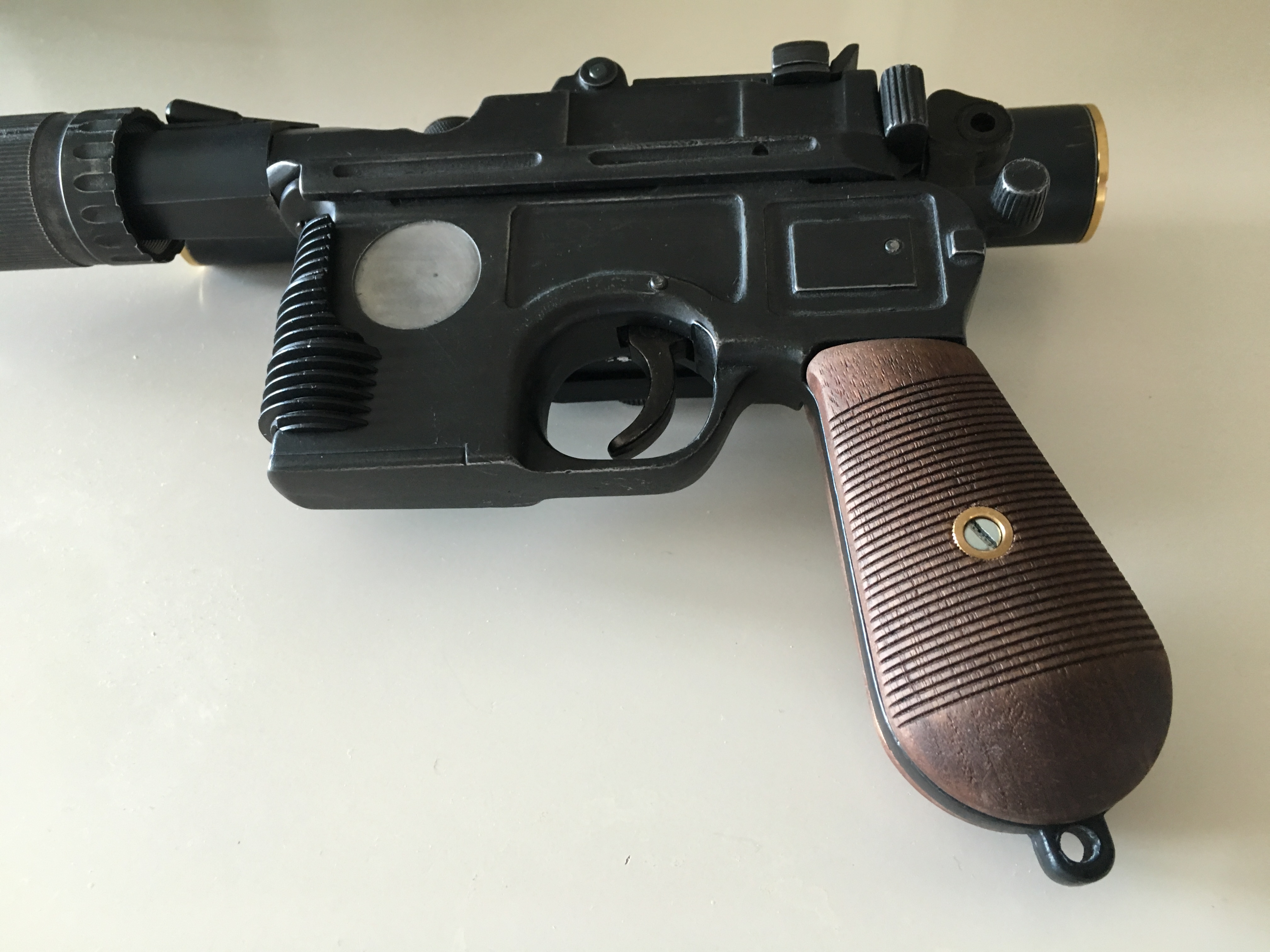

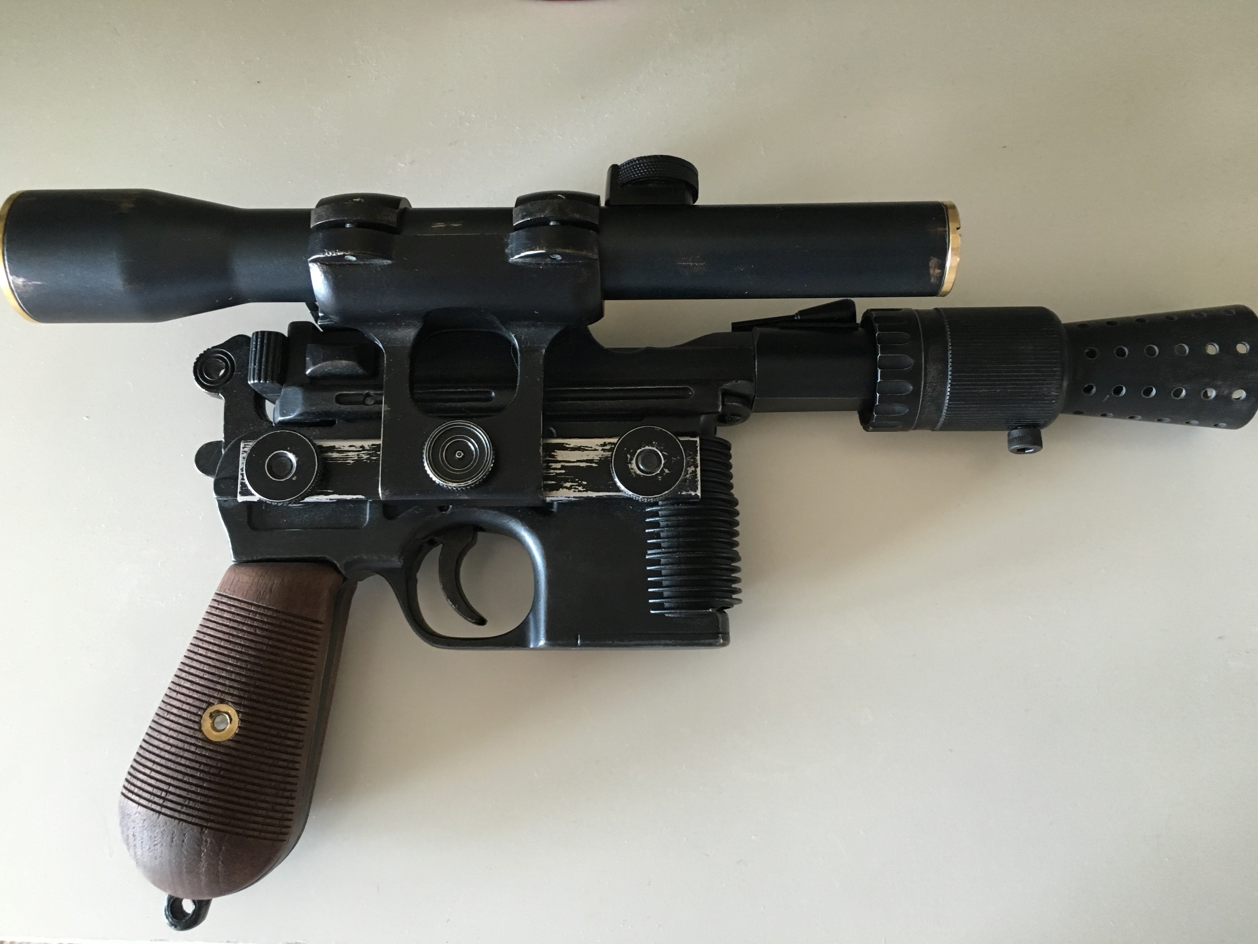

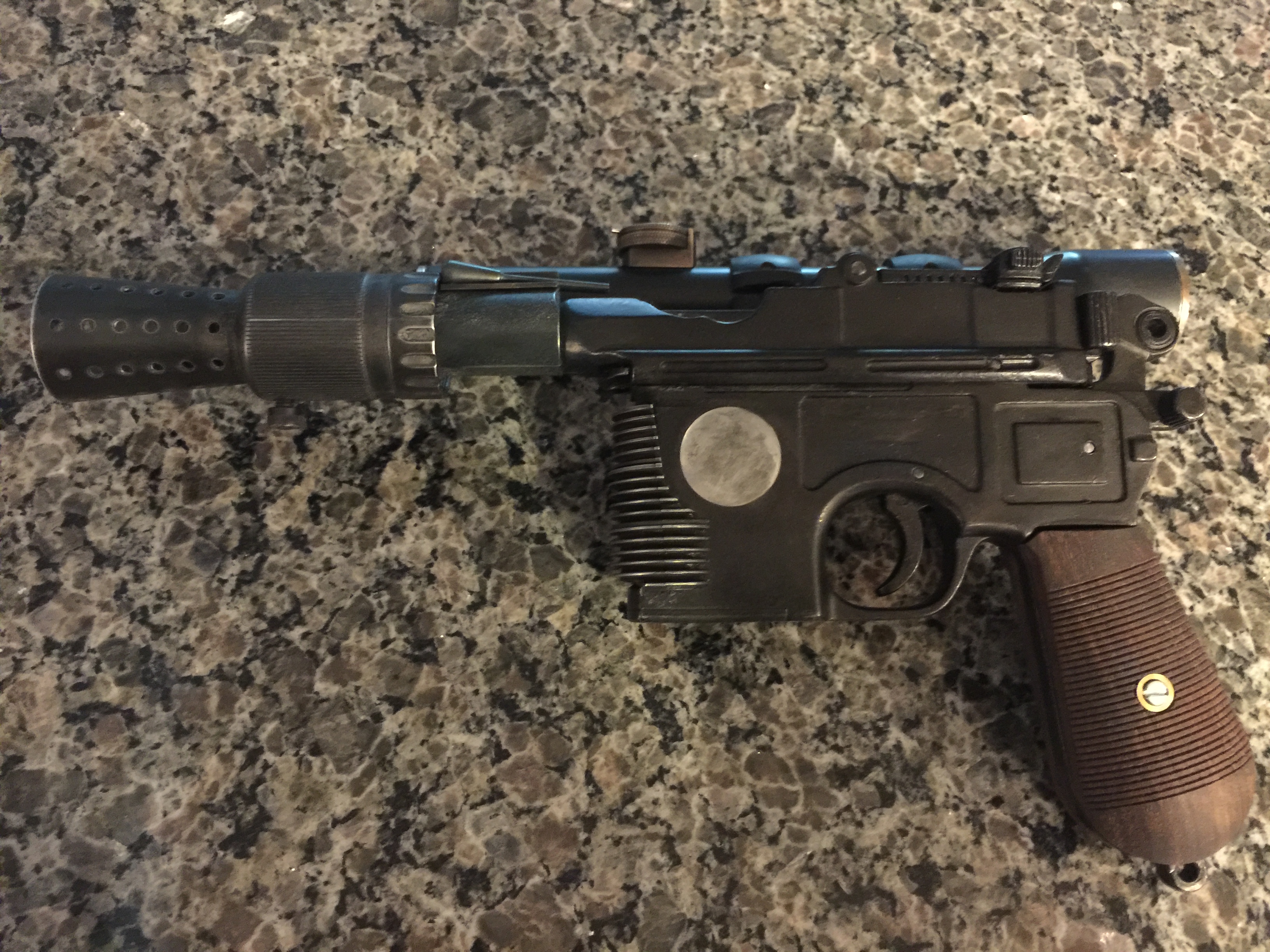

So I didn't use paint on the brass since I didn't have any on hand. I used JAX pewter black on the brass and this is how it all came out. All parts have been blued. Forgot to grind the track down but I can live with it.

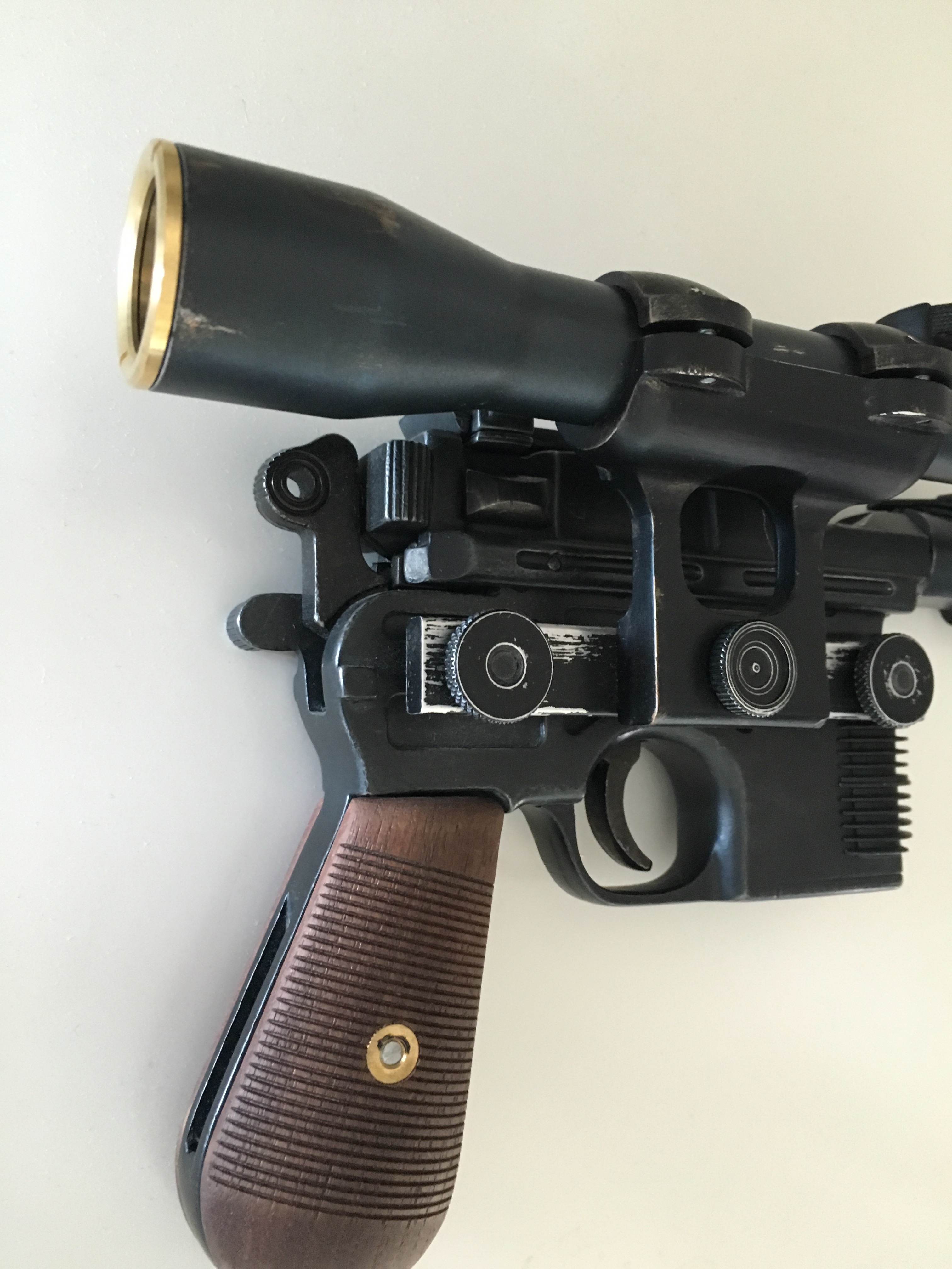

Here's a question. I too purchased a scope knob. Is the whole thing supposed to turn or just the very top disc? I'm assuming the whole assembly is supposed to turn, however mine is not. Any help would be appreciated.

My top and lower dial turns. Have you taken it completely apart and put it back together?
Both dials should turn, if it is tight just take the bottom knob and lightly rub it on sandpaper to make the fit looser,

Yes, I have. I may have gotten paint in between. I can sand the paint. I just wasn't sure if both knobs were supposed to turn and you answered that for me. Thanks
Mine was actually too loose! Had to add a little strip of tape to increase the friction.
It's lovely work, by the way!

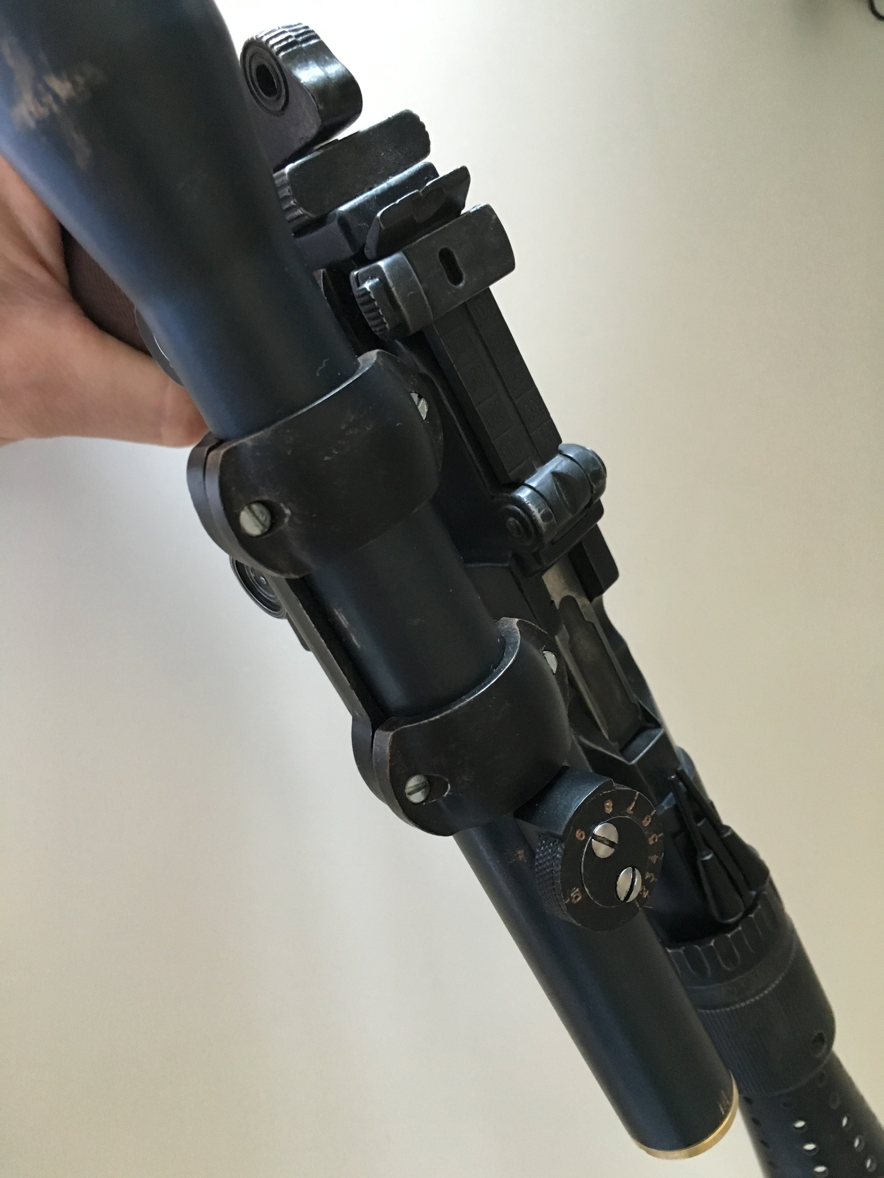

What are people doing with the scope mounting rings? Are they supposed to meet or is there supposed to be a little gap after mounting the scope?
