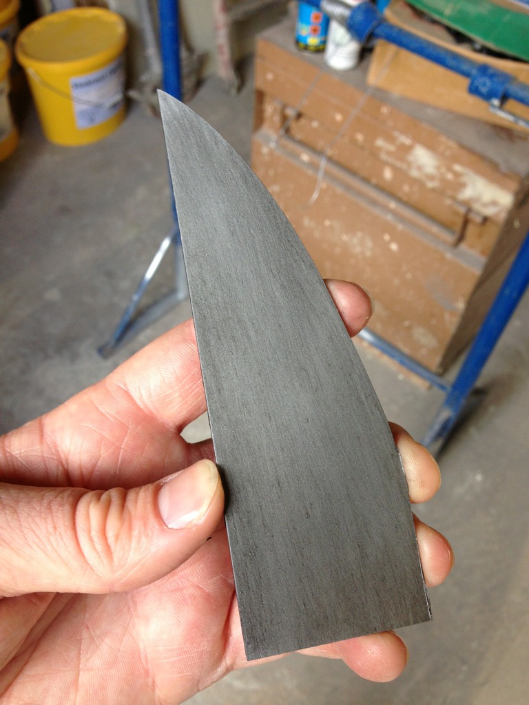

My hammer is all sprayed silver ready to try this, so I had a test on a piece of perspex before I cover Mjolnir. I found that when handling it the polish still wiped off a little so I used some clear matt lacquer to seal it in. Here is the test piece...
Yea, the paste is water based, so you can clean it off easily if needed. On a really smooth surface it cab be rubbed off.
Are you getting much shine with it during the rubbing/buffing? Did the clear take some of the reflection away?
Your test piece looks more like what I did on my Iron Man faceplate to mimic a brushed metallic surface.
Yeah its got a decent shine, but I want to try seal the surface so the anyone picking it up doesn't mess with the way it looks (sweaty hands etc on water based product). The lacquer hasn't taken away to much sheen to be fair.
On a side note, did you apply the same stuff on a gold painted iron man faceplate? how does that look?
I used it just to get a brushed metal/streaking effect on the faceplate, didn't try to polish with it. It is over dupli-color sunburst gold.

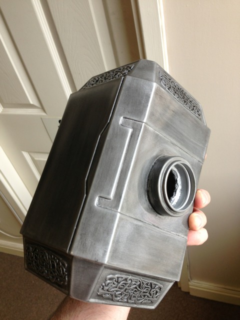

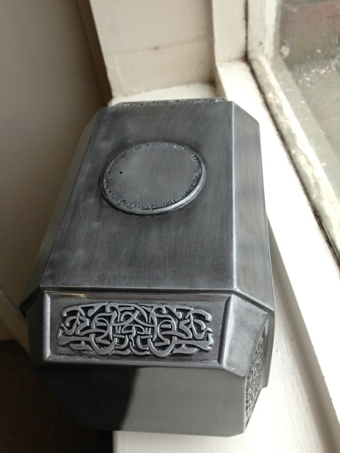

I just thought I'd share the final paint job on my hammer. The handle isn't attached yet as I'm in the process of laying leather on it. I used Luke's method of stove polish then added a laquer gloss coat to protect the effect.ImageUploadedByTapatalk1371928301.152353.jpgImageUploadedByTapatalk1371928310.309567.jpgImageUploadedByTapatalk1371928319.493790.jpgImageUploadedByTapatalk1371928330.327265.jpg

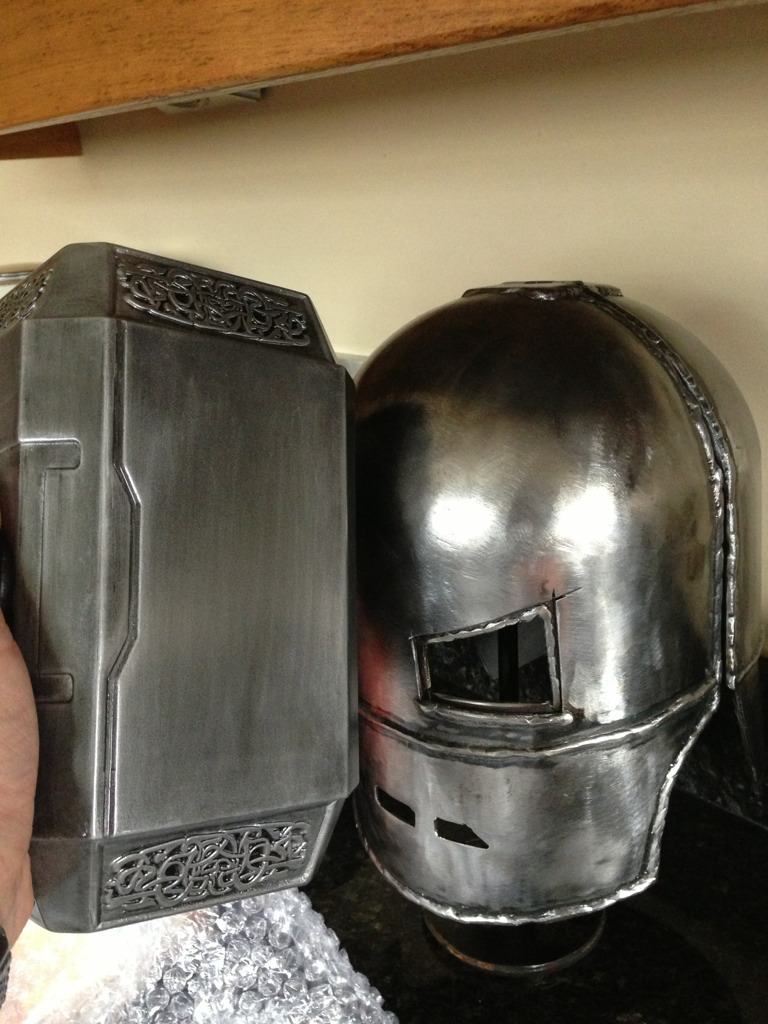

And this is a comparison with my steel mark one helmet. It's not too far off! I hope...
Looks great, nice work. :thumbsup

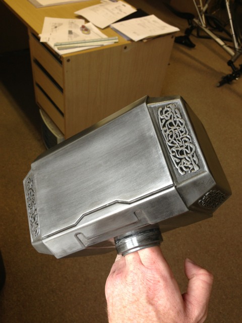

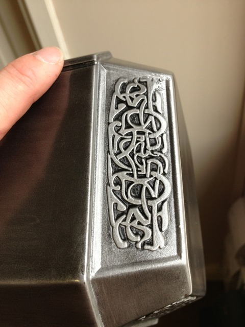

Was able to get everything finished up today.
Here's the results, pretty pleased with it.
