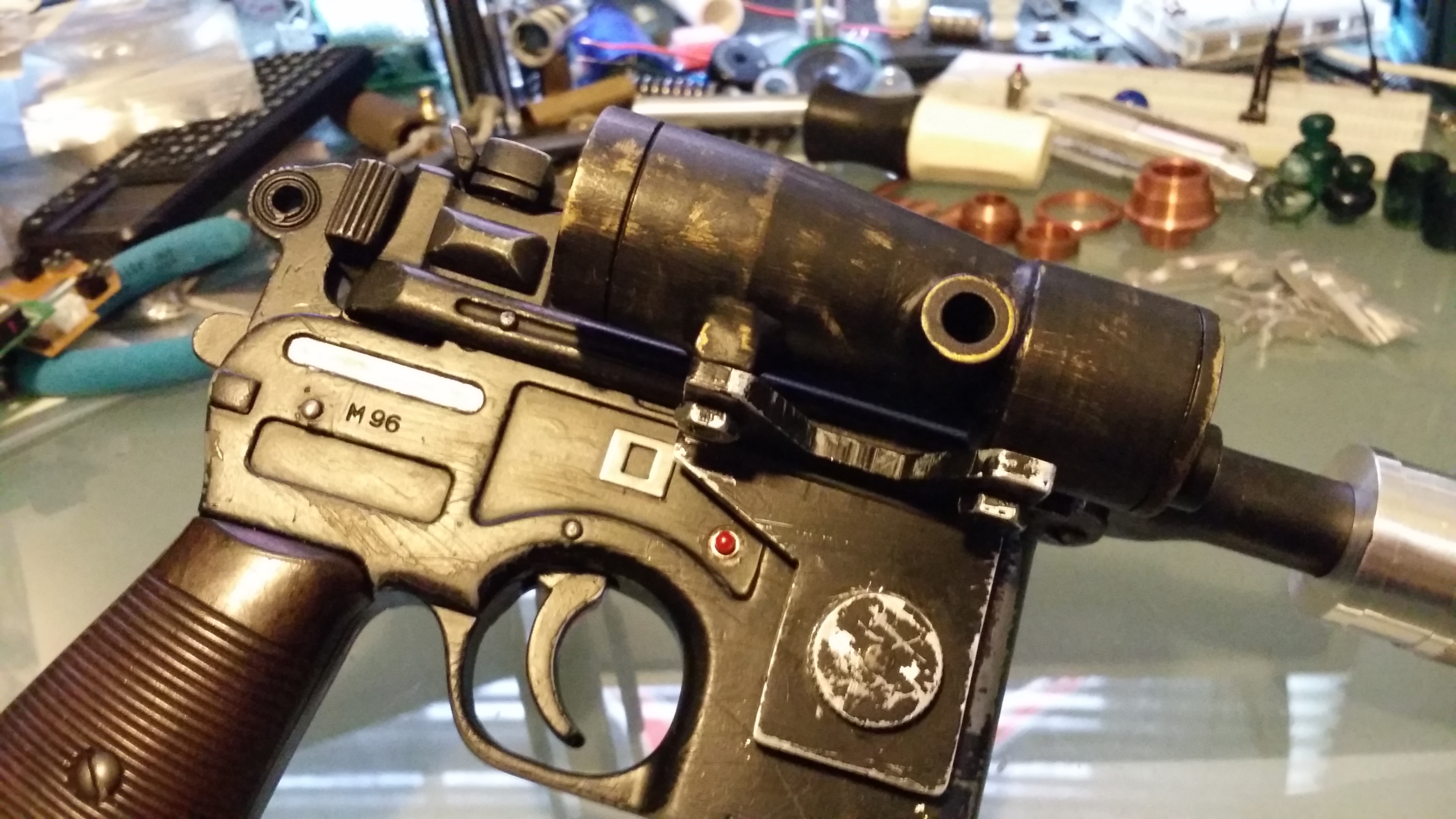

Thanks man. My arm did cramp up pretty bad at one point from all the filing, lol. It hasn't been too bad though.
The old Blast-Tech scope mount is good, but the hole was too low.
I filled it and made a new hole just above. Looks great now. I'm going to clean up the rough edges before I paint it.
What is the Blast-Tech mount made of? How did you go about filling it?
It's aluminum. I use an epoxy putty for stuff like this. It comes in a stick and you cut a piece off and knead it between your fingers. Way harder than something like JB Weld.
STOP....what version are you trying to build?
Th short BT bracket was intended for the Han ESB/ Hoth afaik, but should sit way higher, with its upper edge resting against the upper receivers lower edge.
If you´re intending to do a Luke/ Han Bespin, this mount is not what you should proceed with (too small!)
Would be a shame to invest so much time and efforts into a Denix conversion and not go the extra mile IMHO

I am doing a Han/Luke Bespin. According to the latest info from Boba Debt's thread, the old Blast Tech mount is right on in it's general size. 1.75" high and 1.25" inches wide. The Hoth bracket should be a little shorter. When John made these brackets the Hoth mounting system was unknown so he based it on the Bespin version. Obviously you know your blasters and I'm not trying to argue, but this is how I understand it. When I put the scope on, everything looks ok to me.
so the mount you attached features the correct height of 1,75"? Must be the dimensions/ taper of the mount that´s irritating me in this case, plus the hole that´s still slightly off IMHO.
hmmmm....
Markus
Yes, the height is correct. I think there are a number of things at play here. I don't think the angle on the back of the bracket is quite right and there may be some distortion in that photo with the mount on the gun. It even looks weird to me. Looks much better in person. Also, the whole bracket probably is a little small because the Denix is gigantic compared to a real Mauser, but oh well. I'll take some better photos later.
In the meantime Markus, I want you to take a deep breath, relax, and sit back with a beer. Everything's going to work out fine. :D:cheers
