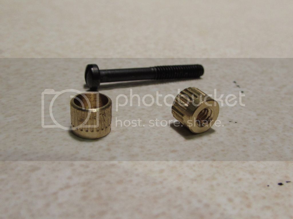

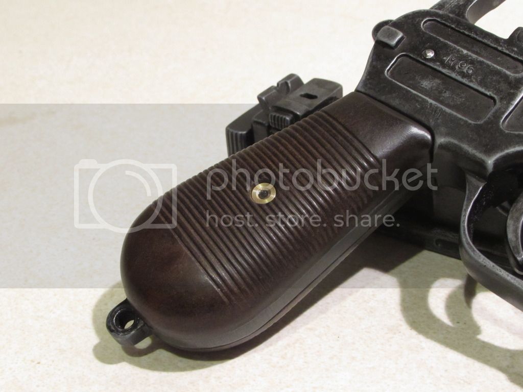

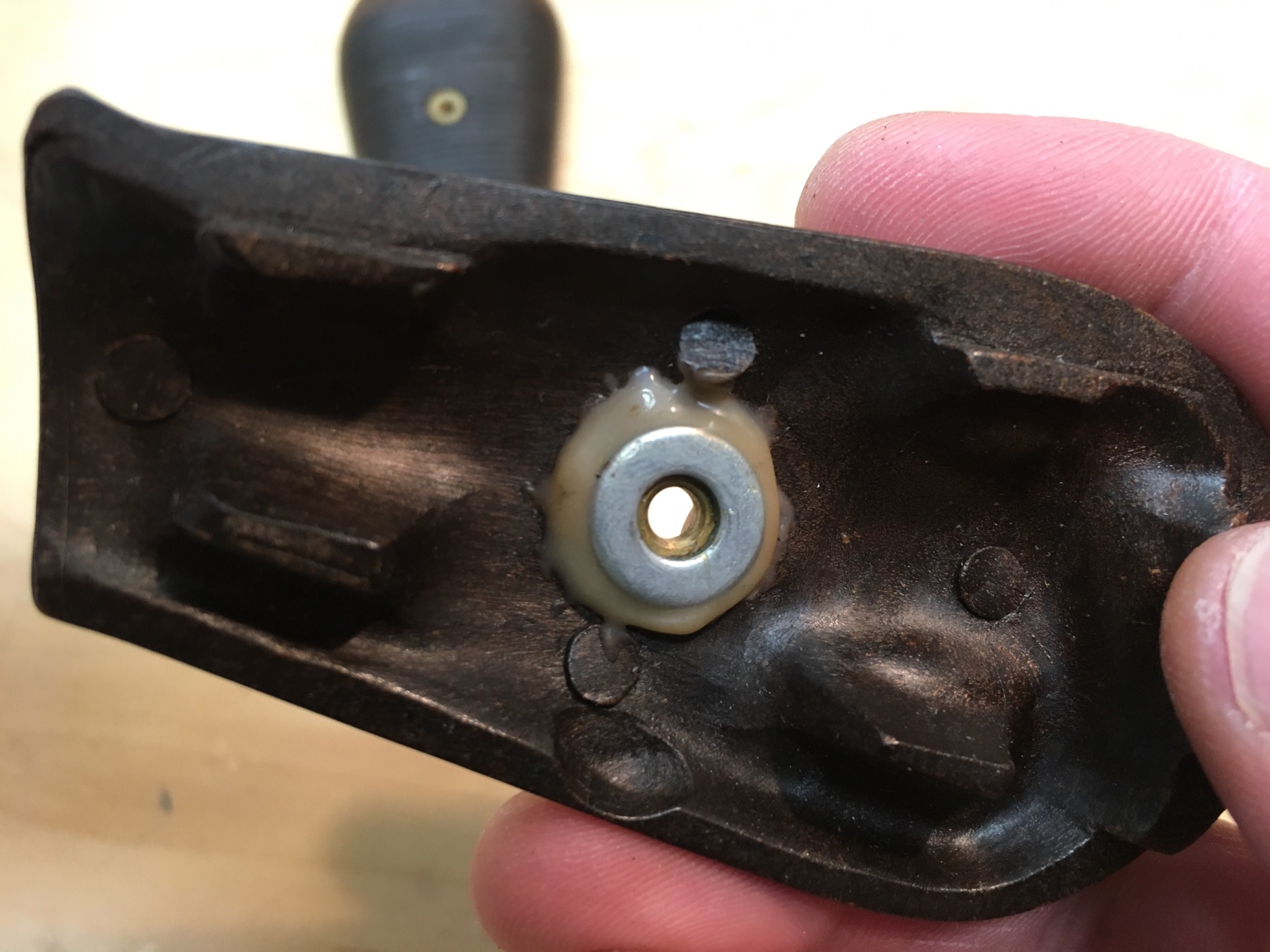

Quick question. How did you install the brass grip hardware? On the Denix I have with the wood grips, they are held on with two screws. The brass doesn't work at all.
Did you have to modify them?
Thanks.
Yeah, that took a little work. The plastic grips were so thin the brass parts would pull right through when you tightened the screw. I imagine the wood grips are similar. I epoxied small washers inside to butt up against the metal post inside the handle. I also drilled all the way through the post to put the single long screw through. I think that was all I did. I ended up not using any of this stuff anyway.

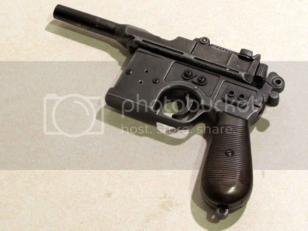

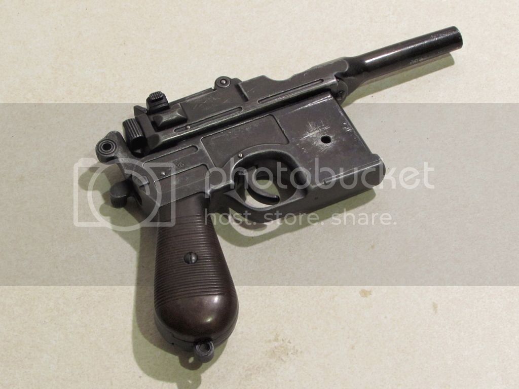

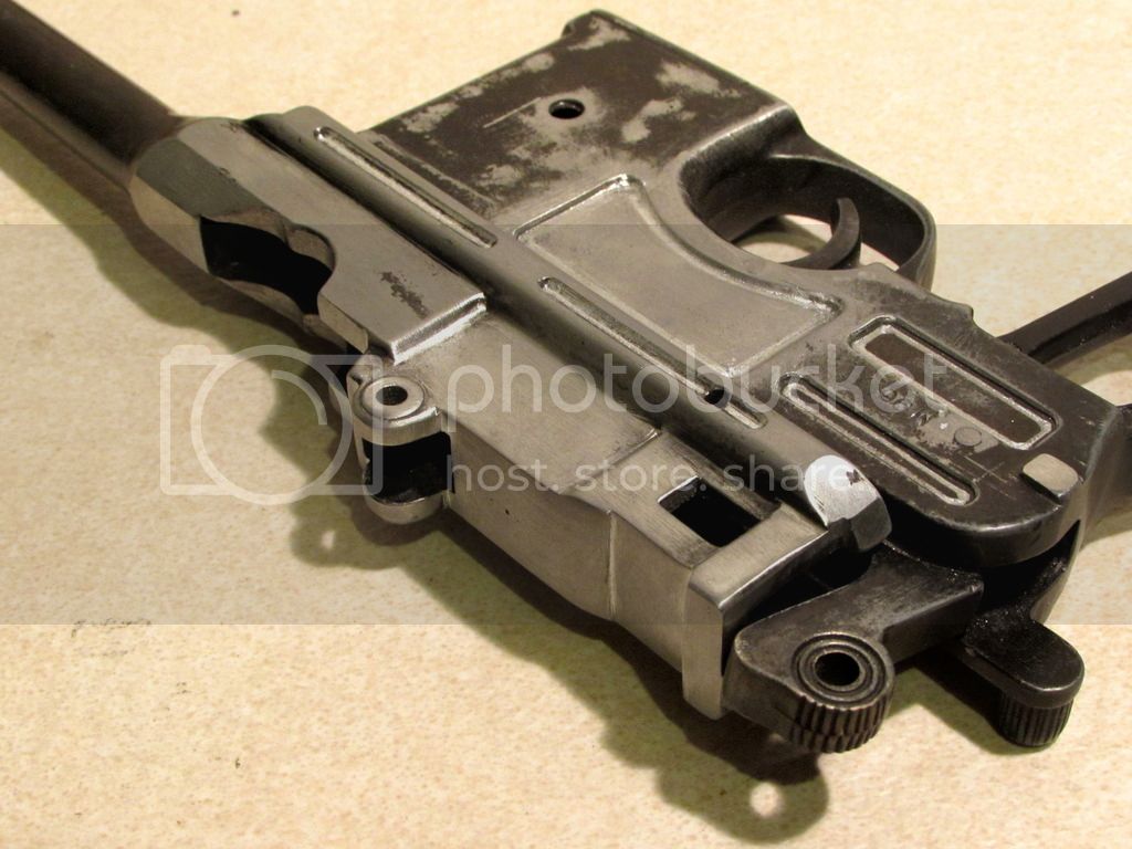

I've had this Denix for a long time, and it's way overdue for an overhaul. You guys know how bad these are. All the edges are extremely soft, pitting everywhere, etc. I've going to strip it down and sharpen all the edges, clean things up, and add some detail. I've got some old Blast-Tech parts I can reuse and a new knurled disk coming from Boba Debt's run.
Before pics. Typical Denix. I'm getting rid of the left side greeblies.
I got a set of the brass grip hardware on ebay for $5. I'll be sticking with the plastic grips for the time being since they fit correctly.

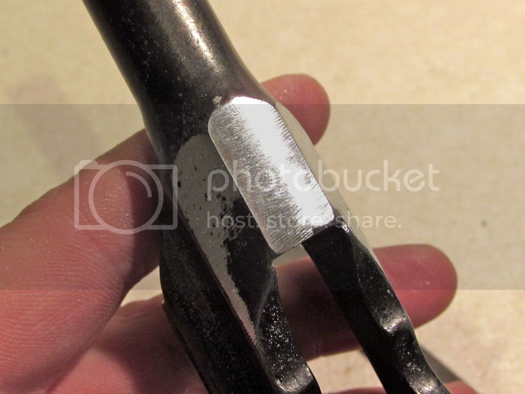

I took everything apart and started to sharpen angles and clean things up. I'm filing everything by hand.
Things are shaping up.
Lots more work to do, but the results are pretty good so far.
