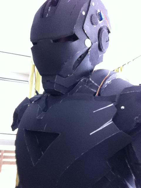

Here is my first build. Certain parts have been challenging ie neck, thighs, abs...those darn abs....you can see in the images that they are too wide. Should be an easy fix hopefully. Really weird too, because I haven't adjusted anything in the templates when printing and everything else fits and is proportional. Anyways hope you like 'em. BlackDynamo2 costumes gave me inspiration so I thank him!

http://i1295.photobucket.com/albums/b639/macersosimo/Screenshot2013-10-08at42447PM_zpsb58aaa0f.png
http://i1295.photobucket.com/albums/b639/macersosimo/Screenshot2013-10-08at42512PM_zps89998e9f.png
http://i1295.photobucket.com/albums/b639/macersosimo/Screenshot2013-10-08at42458PM_zps8b0bd880.png
Looks good. The abs, those side bands should connect about a quarter of the way from the outer edge. Refer to the model in pepekura.

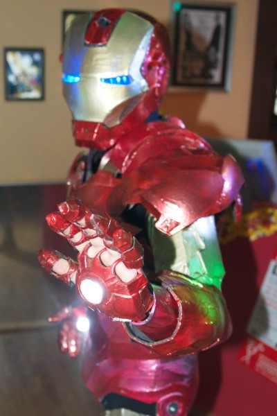

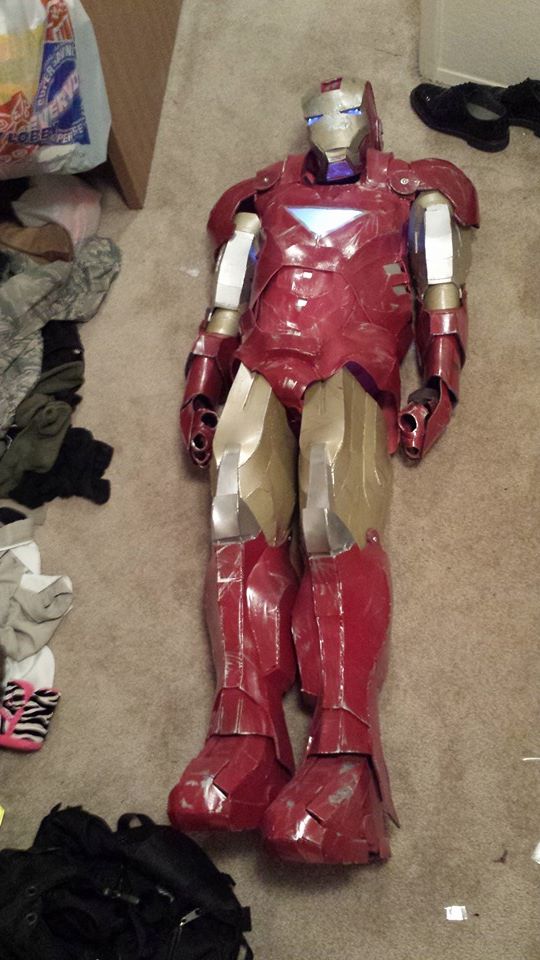

Hy there.
I just wanan show you guys my Final Build.
I am proud about the uncollored Version.
[url]http://i1295.photobucket.com/albums/b639/macersosimo/Screenshot2013-10-08at42447PM_zpsb58aaa0f.png[/URL]
[url]http://i1295.photobucket.com/albums/b639/macersosimo/Screenshot2013-10-08at42512PM_zps89998e9f.png[/URL]
[url]http://i1295.photobucket.com/albums/b639/macersosimo/Screenshot2013-10-08at42458PM_zps8b0bd880.png[/URL]

Thank you both. Cardboard is WAAAAAY easier. Especially if it's your first build ever. I tried foam first. 2 kinds too: eva mats and 6mm (which was easier). The whole thing with the thicker foam like the EVA mats is that you need the 45 degree angle hobby-knife tool other wise you need to make everything at 45 degree angles by hand which is ridiculous.
Downside to anything with paper or cardboard is the finishing. To get it to look decent I'm going to have to do 2 coats resin to outside, fiberglass mat to inside, bondo, sand, primer, than paint. SO many steps.
Foam has the advantage here because you can build the suit than just coat it in glue, plasti-dip, prime, paint.
I guess bottom line its whatever you're comfortable with. Cardboard definitely is my strength over foam.
