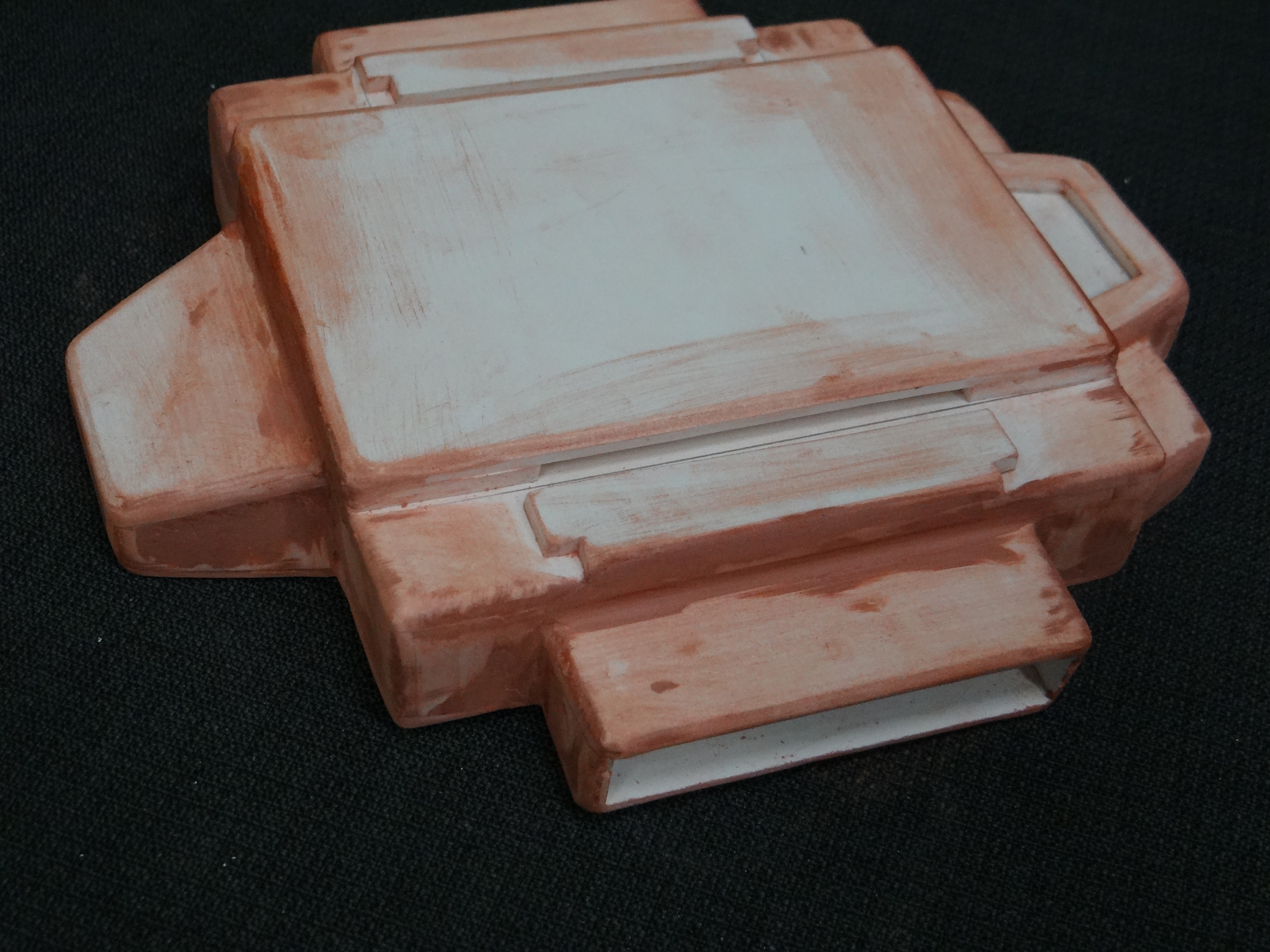

Here is the Pym particle container boxes on the side of the belt. They still need a coat of glazing before any painting

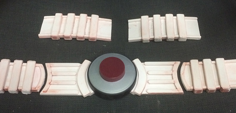

Here are all the front of the belt pieces. They still need sanding and glazing etc. disregard the center parts they are just place holders till I make a center disc that is lit
There are come small connectors to the back of the side boxes I still need to make. Once everything is painted I think the best approach is to attach everything to a piece of
2 inch web strapping and figure out some sort of system to hook it closed

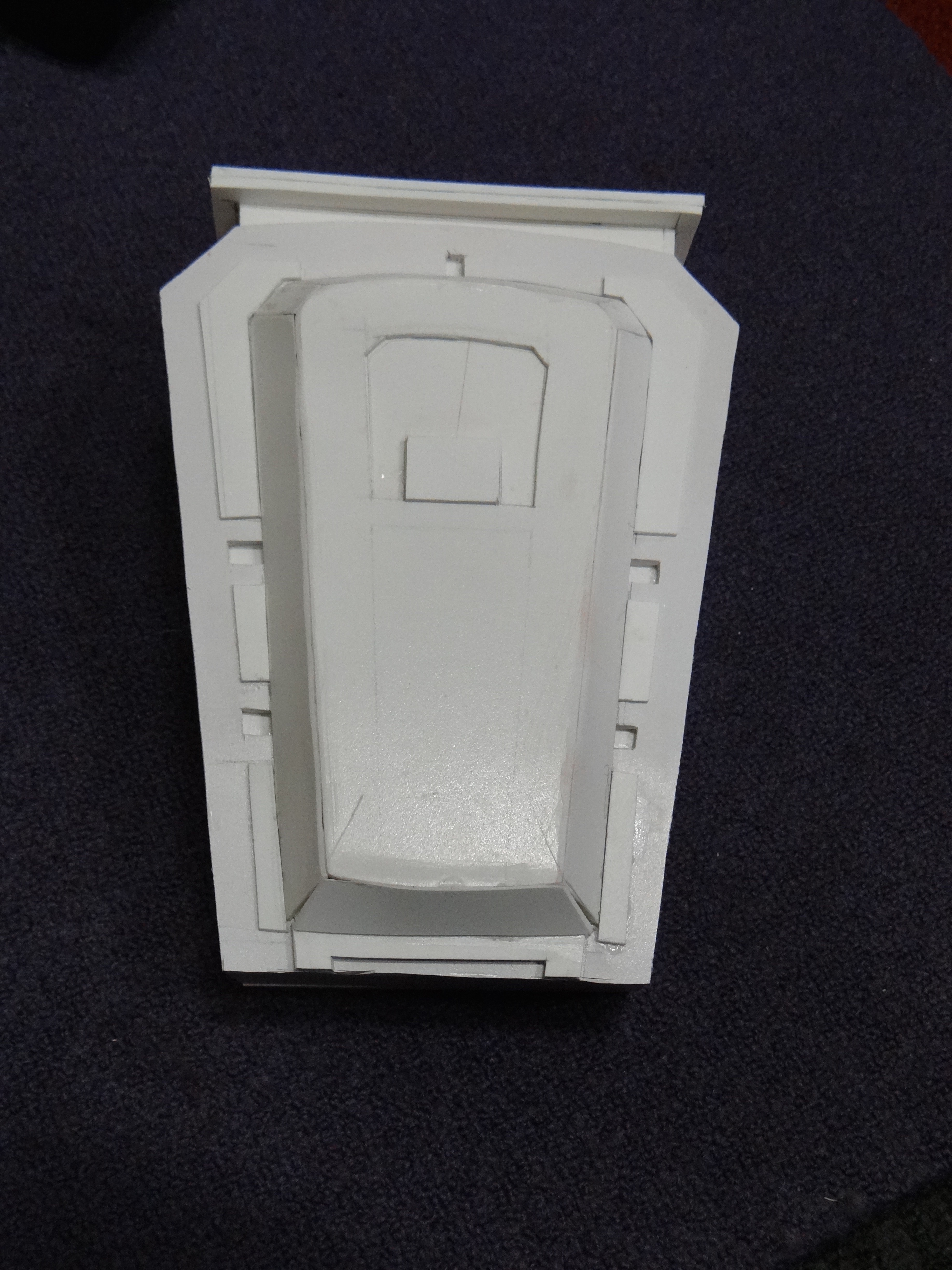

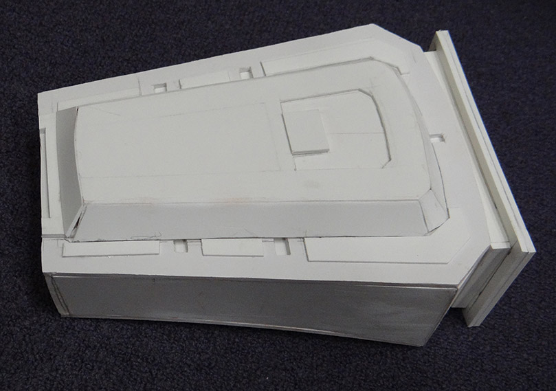

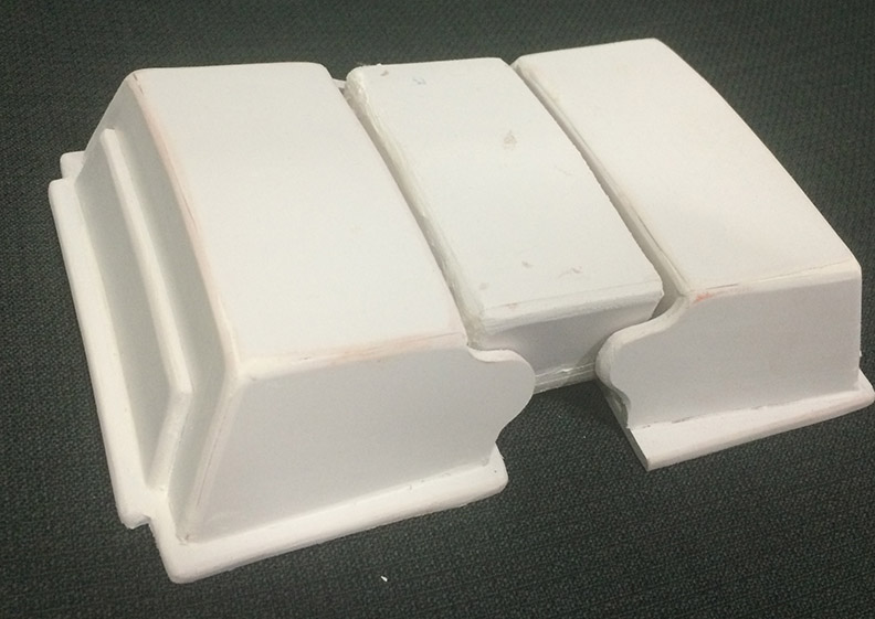

Here is the start of the device at the top of the back. All the angles were a bear to figure out. Still have to add the hose connector to the bottom and the plate at the top that holds the cylinder that the helmet hoses are attached to. this needs lots of finish work

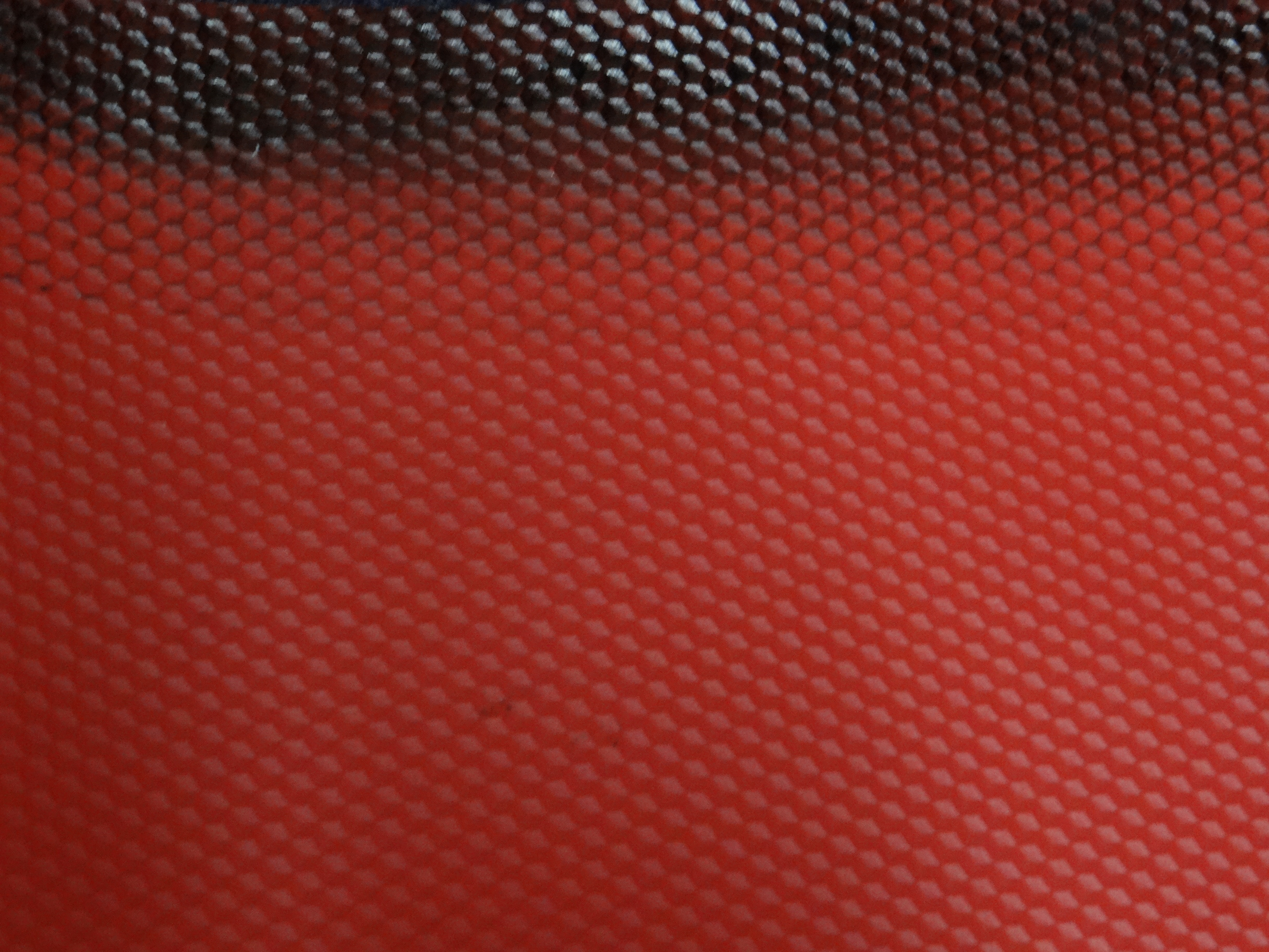

Here is a swatch of marine vinyl fabric I found that will be perfect for the red portions of the body suit
