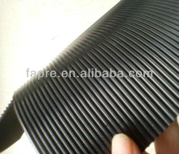

That said, we sure the ribbed material wouldn't be some kind of rubbery material?
I'd've assumed it'd've been a fine ribbed non-slip floormat kind of material.
The Prop Lord
Like View attachment 431708
Man, I literally lol'd.
Ok, it's quite possible they used something like that. It would have to be extremely soft/stretchy though. I couldn't imagine having something like that on the joint areas being that close to my skin. I would image that it would pinch the daylights out of wherever it was on the suit.

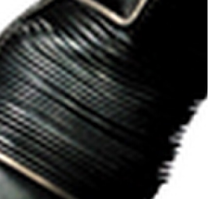

As for the ribbed areas, I can't speak to this costume, but but for X-Men Last Stand there were similar ribbed areas. Those were created by stretching something like jumbo spandex, then laying a thin rubbery material on top and stitching in rows about 1" apart. Then, when released, the stretch fabric retracts and pulls the thin rubbery fabric into ribs. This allows for the rib effect, a lightweight and flexible piece and a minimum of restriction to mobility.

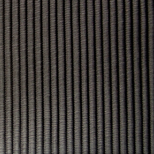

So far as the ribbed section, I found this:
http://www.habermanfabrics.com/fashion-fabrics/faux-leather?product_id=7281
I have no idea what the "line count" per inch is though. There is also a "mini rib" version on their website.
A positive aspect of this particular fabric is that the company says it is "slightly stretchy."
