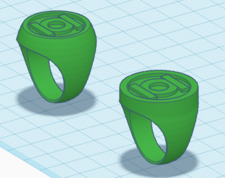

...and on the right is another signet-type Neal Adams ring, but with a more on-model, cylindrical/straight-sides symbol-bowl, rather than the proper signet ring I initially modeled. Gonna work on some of the symbol variants, next.

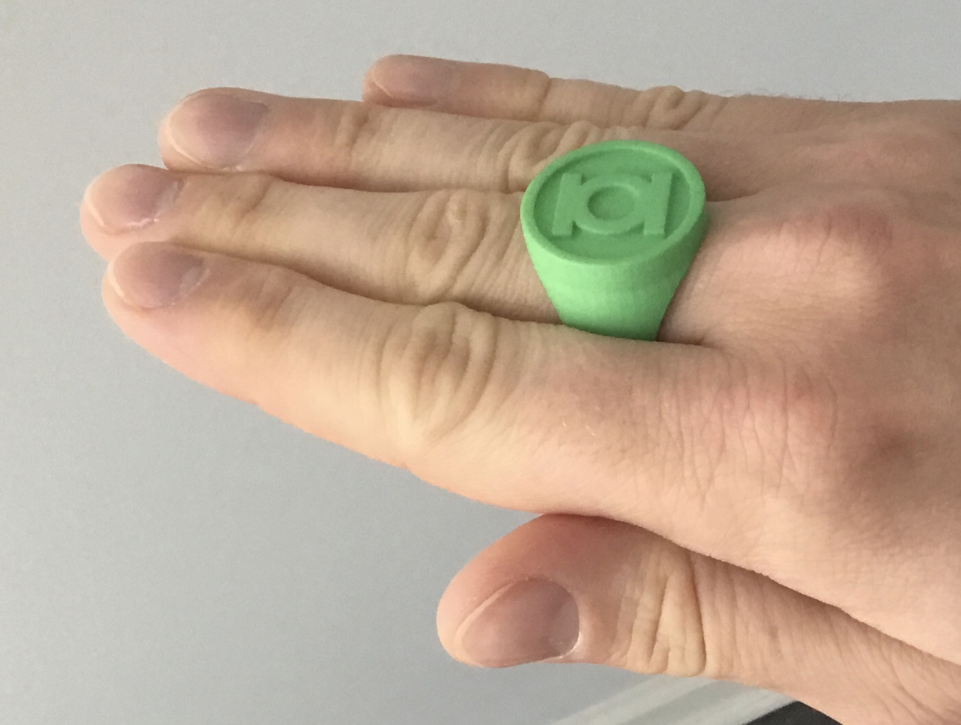

Just for funzies, and since I’ve been pushing more and more toward modeling specific artists’ styles, I decided to throw together a Dave Gibbons-style V2 ring, using the alternate official GL symbol from the 80s and 90s (with thicker sidebars, a smaller central ring, and a smaller central ring hole, which is pretty darn close to Gibbons’ version), as shown upthread. Gibbons’ version of the GL ring does not have a gem, and the ring-band is (usually) rather thin, being just a bit wider than the central hole in the GL symbol. As noted, I personally prefer the ring-band to be the same width as the central ring section of the GL symbol, but I’ve made an exception for accuracy, in this case.
My various V2 designs up until now have mainly been inspired by the artwork of Joe Staton, in terms of size and detailing. However, whereas most of my ring designs have used the official GL symbol employed for licensing (...for the sake of unity among the bulk of my designs, and as a result of my making the somewhat-illogical leap that the symbol variations from all of the artists over the decades were “really” just artistic interpretations of that official version of the symbol...which ain’t the truth, but there it is.), Staton’s version actually looks closer to this symbol variant, usually.
My previous straight-band V2 (with the Style Guide symbol) on left, and the new Gibbons-inspired version on right.

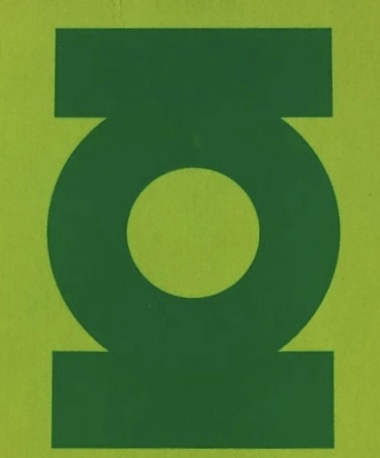

Refining the symbol as seen in the last few issues of Adams’ run. The inherent problem is that it was in flux from panel to panel, with the length, thickness, and curvature of the sidebars constantly changing. Also, the tips of the sidebars flare away from the central ring section, which means that the central ring and sidebars are not properly concentric...and yet the outer edges of the sidebars ARE pretty consistently aligned with the circle that the GL symbol sits within.
It’s a rather funky shape, that’s for sure. Adams’ modern version of the symbol corrects these problems, but I’m going for the classic 70s look.

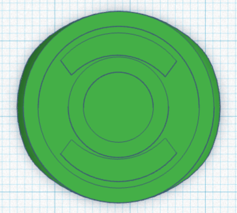

Still tinkering. Created another variant by moving away from a signet-type ring, and more toward a symbol-disc attached to a flaired ring-band, similar to the EMERALD DAWN version. This actually seems to match the reference more closely than a signet ring.
That being said, I like both styles, and may print both to compare them.

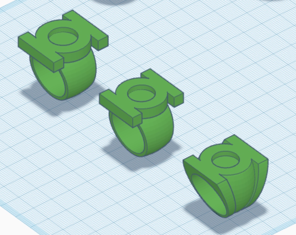

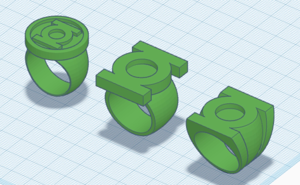

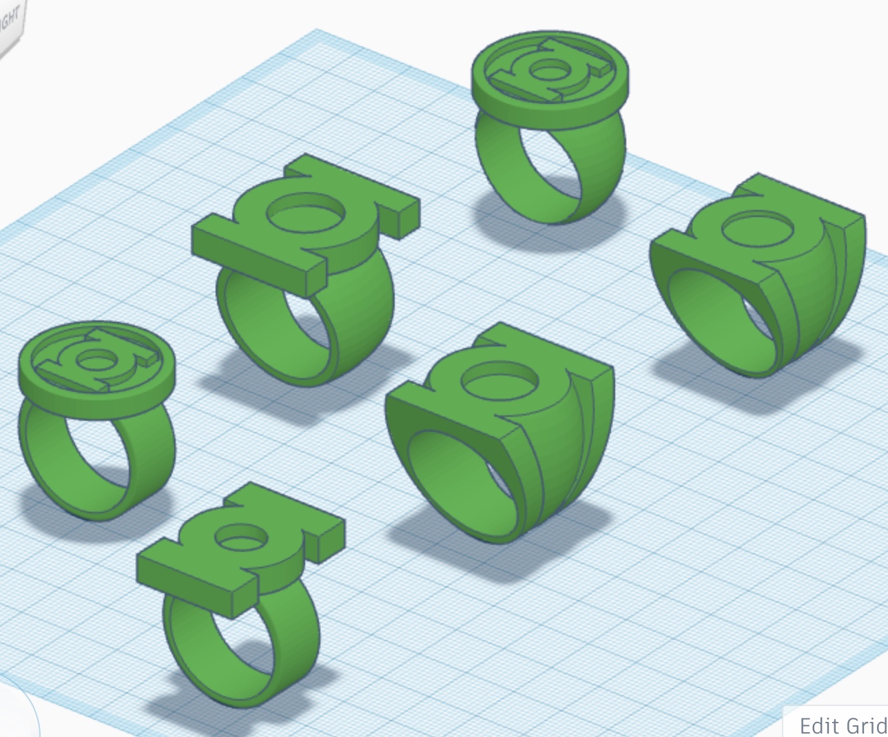

Doing a little comparison of the current versions of the three main designs, with a few variants also mixed in —the straight-band V1, the V2, the sphere-band V1, the Gibbons V2, the V3, and a new, smaller and sleeker V3 variant, with a shallower symbol-hole (to be both a little less chunky, and to represent artists who drew the design without a gem).
I’ve also slightly reworked the V3 to give the sidebars a slight taper as they run down the sides of the ring. Something was nagging me about the design for a long time, and that tweak seems to have scratched the itch. Having parallel sidebars just looks slightly... off. And looking at the reference does indicate many artists going for a tapered look (but not so much Mike Grell, so I’ll leave the model for his version as it is).

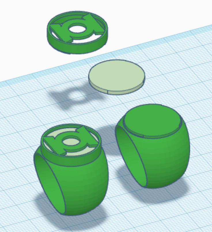

Anyway, I came up with a way to perhaps simulate the modern rings’ effect. I’ve taken my modern-era design and created a three-part variant, with the base ring, a clear (or frosted) inner disc (to be printed in plastic or cut from plexiglass), and then a cap (containing the symbol). The inner disc can be painted a clear peridot color, and backed with my go-to glow-in-the-dark paint. Still working out the tolerances (and some parts may be too thin to print), but it’s coming along. The modern design lends itself to this, but the EMERALD DAWN version would be trickier, so I’ll likely go with a painted, two-tone look. And I think I’ll leave the early rings from the 60s a monotone green, to reflect how they actually looked on the page.

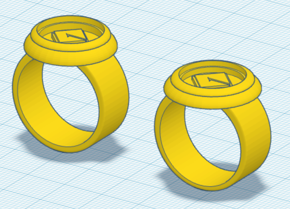

I think I’ve taken this project as far as I can in Tinkercad. Also, Tinkercad doesn’t have an “export” option for file types conducive to CNC machining (such as STEP) and whatnot, and there are limitations in regards to modeling certain shapes (such as the visible grid pattern on spheres and cones and such). With another program, I think I could get better results with things like blending the band into the symbol-disc on the EMERALD DAWN ring, for example.
So, I’m gonna start looking for a more advanced 3-D modeling program to port these models into (or recreate them), in preparation for getting some of these designs done in metal.

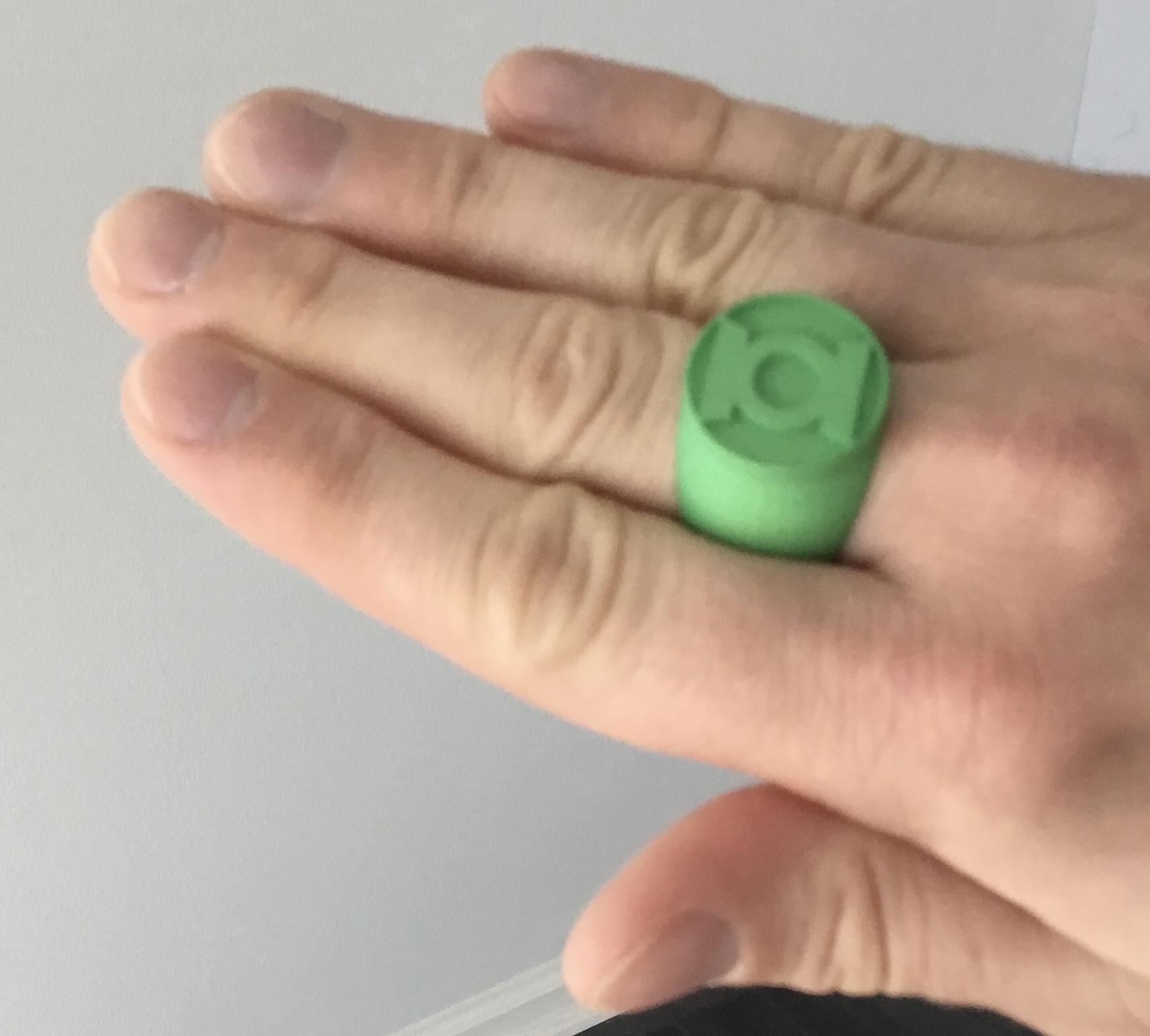

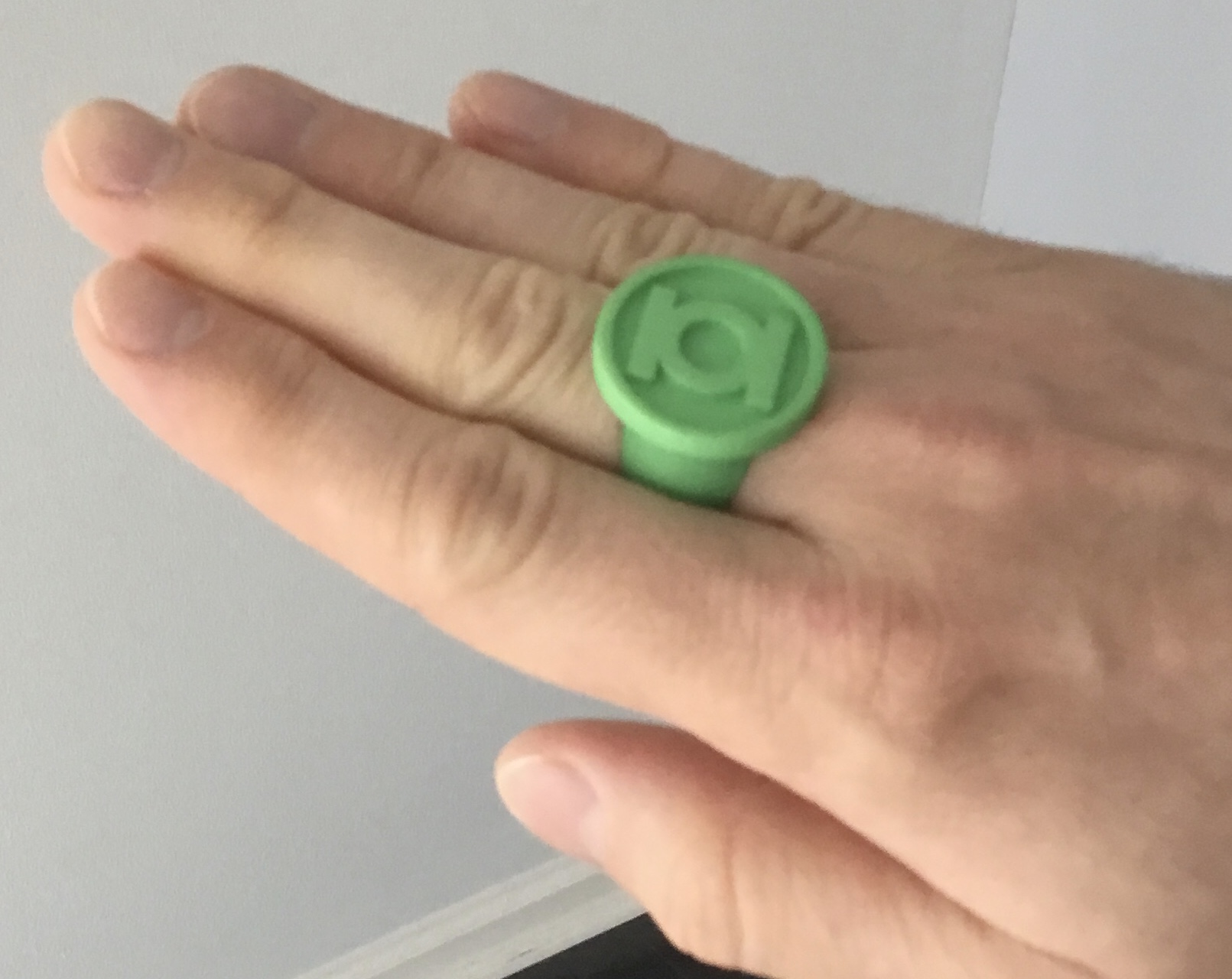

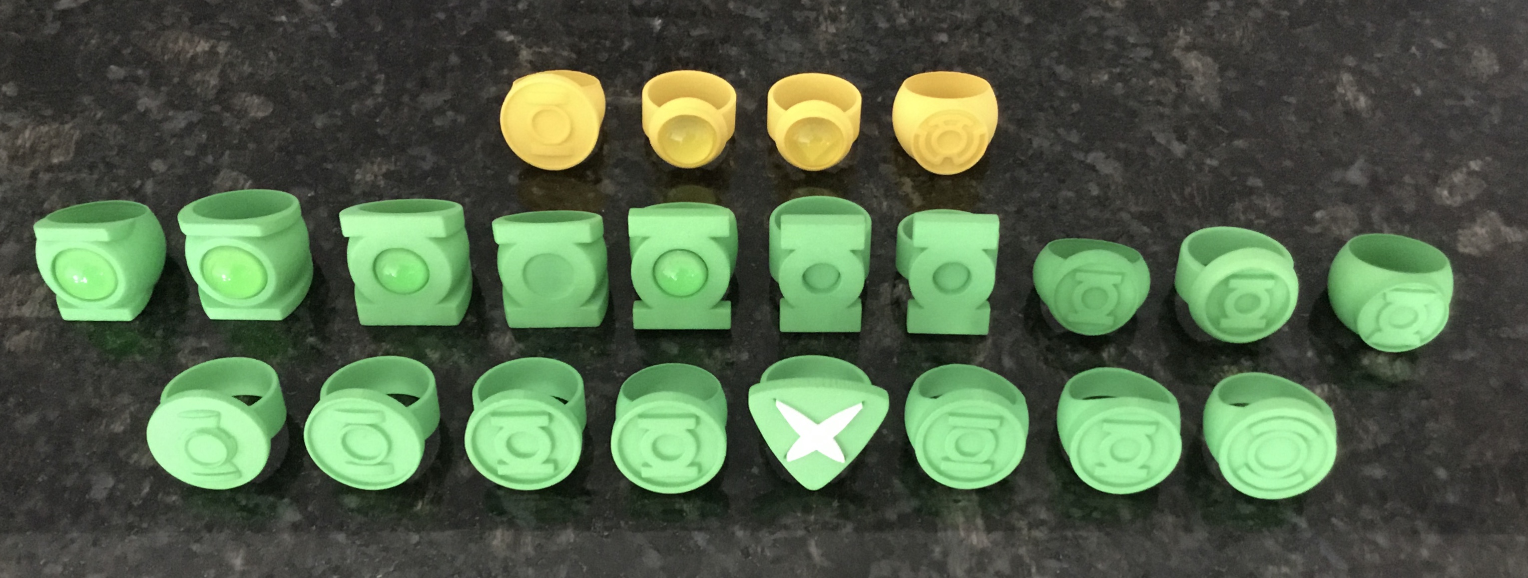

Received the latest batch of prints. A BIG batch. This batch turned out exceptionally well. Very few issues to speak of. I’m very pleased with the look and fit of the bulk of the designs.
Here are a few highlights:
Going back to the bigger (25.5mm) symbol-disc on the Gil Kane design really does give it the right look. The smaller version I had printed last time looks a little nicer and more proportioned, but the bigger disc seems to be more comic-accurate. At least I have both options to choose from for the final, metal ring.
The Neal Adams designs turned out REALLY well. Definitely a favorite style, now.
The revised version of the modern ring looks spectacular. In terms of design and fit, I’m hard-pressed to think of anything else to tweak. I might just say that this design is totally finished, aside from the previously-mentioned crystal-layer underneath the symbol.
The Power Ring...um...power ring also turned out incredibly well. Some slight improvements could be made regarding the height of the raised white symbol-piece, as well as the fit of the piece into the ring, but this first attempt looks great.
The Dave Gibbons design also turned out incredibly well.

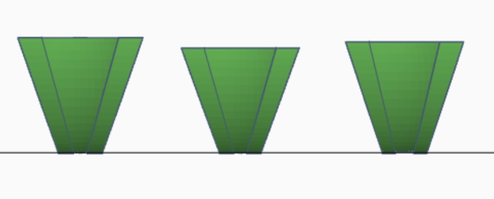

The smaller V3 has the best fit and proportions of any V3 I’ve done, and would be ideal for the final design. The problem is that the symbol-hole is far too shallow to fit a gem. That being said, I’ve experimented with raising the height of the ring, and I may actually be able to fit a 12mm gem into it. However, 12mm seems to be an uncommon size for a round, flatback cabochon. And I’m a bit leery about reducing the diameter of the 13mm glass gems I acquired for the final rings. The acrylic ones I’m using for these plastic prototypes, maybe, but not the glass. We‘ll see.

I decided to sand down a 13mm acrylic gem to fit the hole on the smaller V3 I had printed. It fits very well, despite the shallow hole. I then proceeded to tweak the design by making it a little taller (thus allowing for a deeper gem-hole), and slightly re-angling and repositioning the sidebars so that their angle isn’t quite so severe, and to give them a little more definition and thickness at the bottom of the ring.

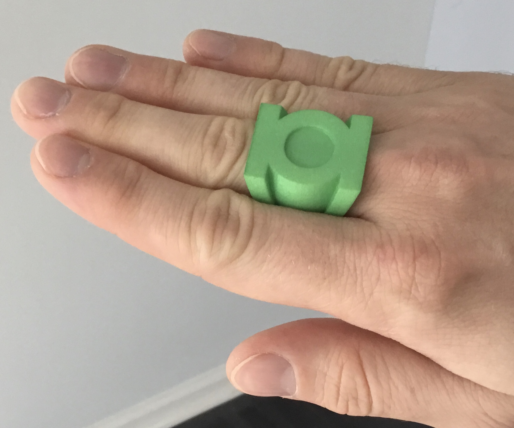

Fact of the matter is that most artists (including Mike Grell and Alex Saviuk) have drawn this design with consistently-thick, PARALLEL sidebars, which is simply not practical or comfortable to wear, when translated into a real ring. At least not at the size the ring’s design is usually drawn to be.
However, some artists, such as Darryl Banks, have indeed drawn the sidebars slightly angled in toward the bottom and with a bit of a taper, so there is a precedent for my version.
This new iteration should solve pretty much all of the size problems I’ve been having. Also, it should be noted that certain choices I’ve made with this design are a result of needing enough wall thickness for the Shapeways printed plastic to survive their polishing process. When I shift over to preparing the design for metal, I can tweak it and slim it down much more, since the strength of the walls won’t be in question. Really, the only trick now is finding an actual glass gem with the proper diameter.
From left to right: Previous V3, the smaller version I had printed in the current batch, and the new revision, which is a hybrid of the two.

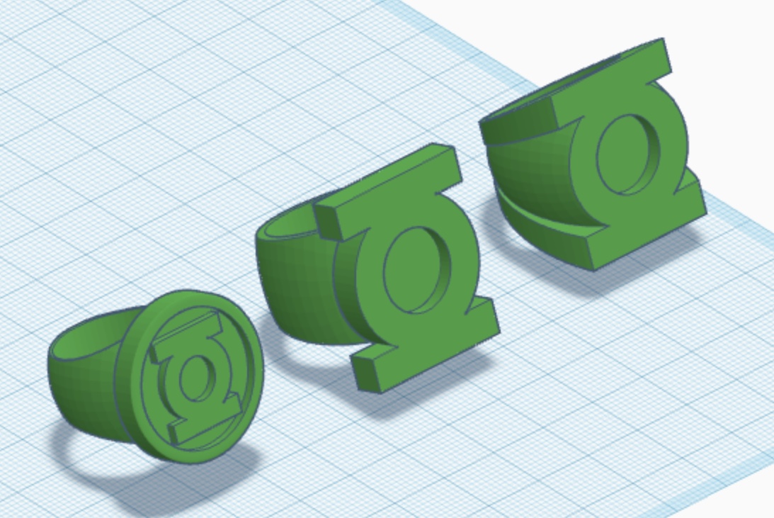

More tinkering on the V1 and V2. Really nitty-gritty stuff, at this stage. Adjusting the height of the V1 symbol-disc and V2 symbol-piece in relation to the bands by tenths of a millimeter. Giving the V1 a flat-bevel on the edge of the band and improving the overall shape and width of the band to better match the Gil Kane reference art. Tweaking the shape and width of the V2 band to make it taper a bit less sharply. Stuff like that.
All in all, these three core (Corps?) designs are very, very close to what I want them to be. And, as noted upthread, I just lucked into a smaller V3 design which actually works. I much prefer the smaller look. The symbol-face of the ring is now nearly 2mm shorter than that of the V2, whereas before, they were exactly the same size, with the only difference being the V2’s separate band vs. the V3’s integrated tri-band. With the height mod to accommodate the gem, this one might truly be THE one. We’ll see. Compromise is for quitters.
