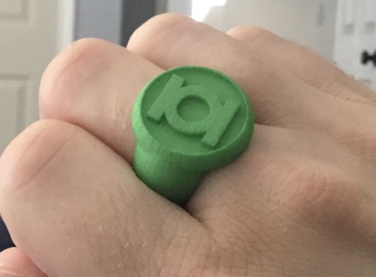

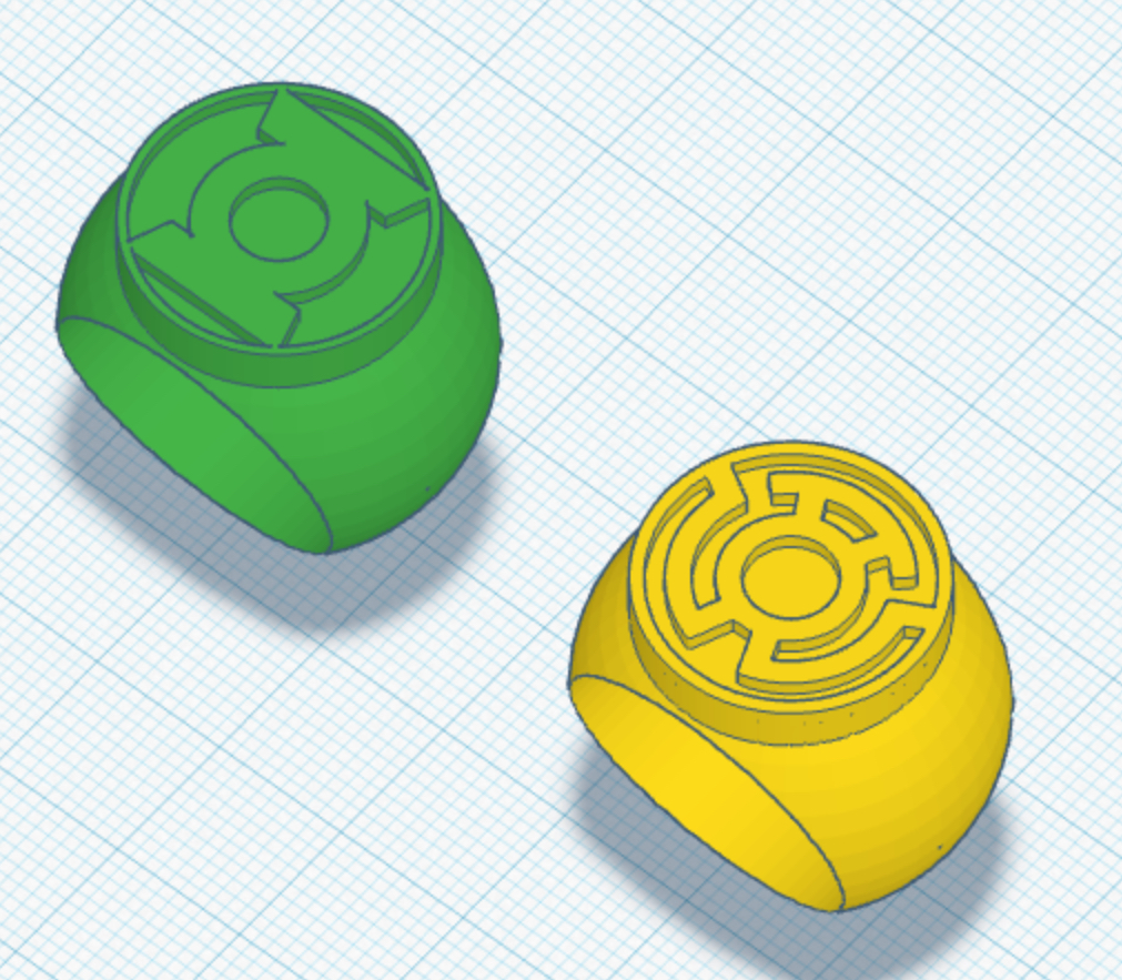

Getting into the next round of tinkering, based on the data from the new test prints. Mainly just more tweaks to improve fit and proportions.
Received the Mark Bright/EMERALD DAWN-style test print, today (which I’d ordered separately, right after I ordered the last batch of rings). Overall, I’m pleased with it.

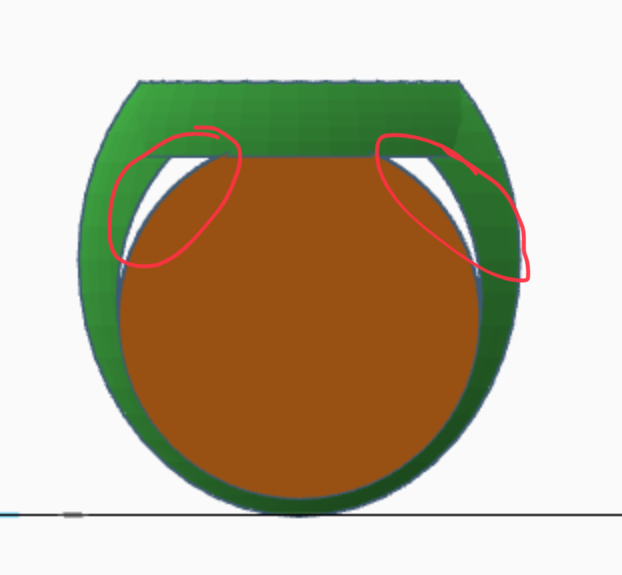

Just needs a bigger symbol-disc, and I’m still trying to figure out a way to eliminate the gap seen in the areas circled in red. The orange circle represents the finger-hole size, but getting the ring-band to blend into the symbol-disc properly leaves that gap, which causes a looser fit, and looks unsightly. There’s gotta be some trick in Tinkercad to shimming it, or something.
Working on solving this problem. The issue is that the Bright design has a tapered band which blends into the symbol- disc...but reshaping the band to surround the finger-hole (and eliminate that gap) causes the band to get wider at the top and blend less cleanly into the band.

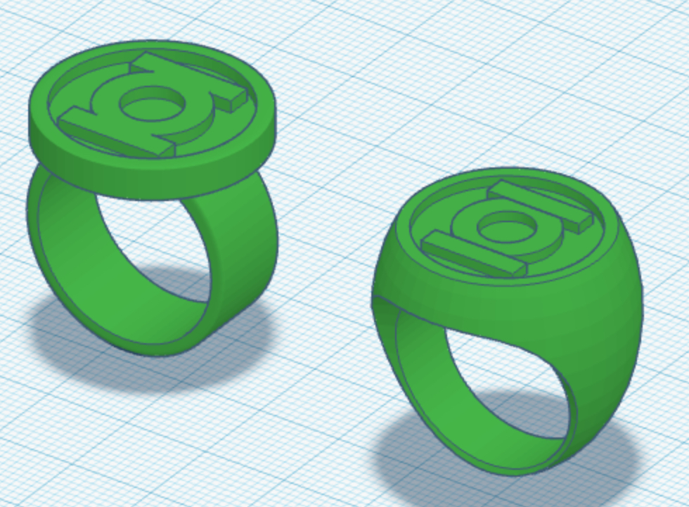

Managed to rework the V3 yet again and shave off another 2mm from the length of the bottom of the band by re-angling the sidebars (while still maintaining the proper and exacting dimensions of the GL symbol on the flat face of the ring), which will allow for a more comfy fit. Tricky and time- consuming work, but worthwhile. I’ll order a print with the next batch in a week or two, after I finish tweaking some of the other models.
Old on left, new on right.

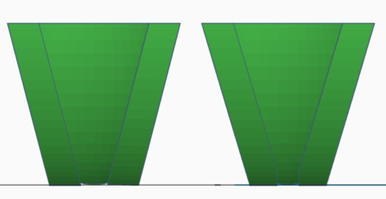

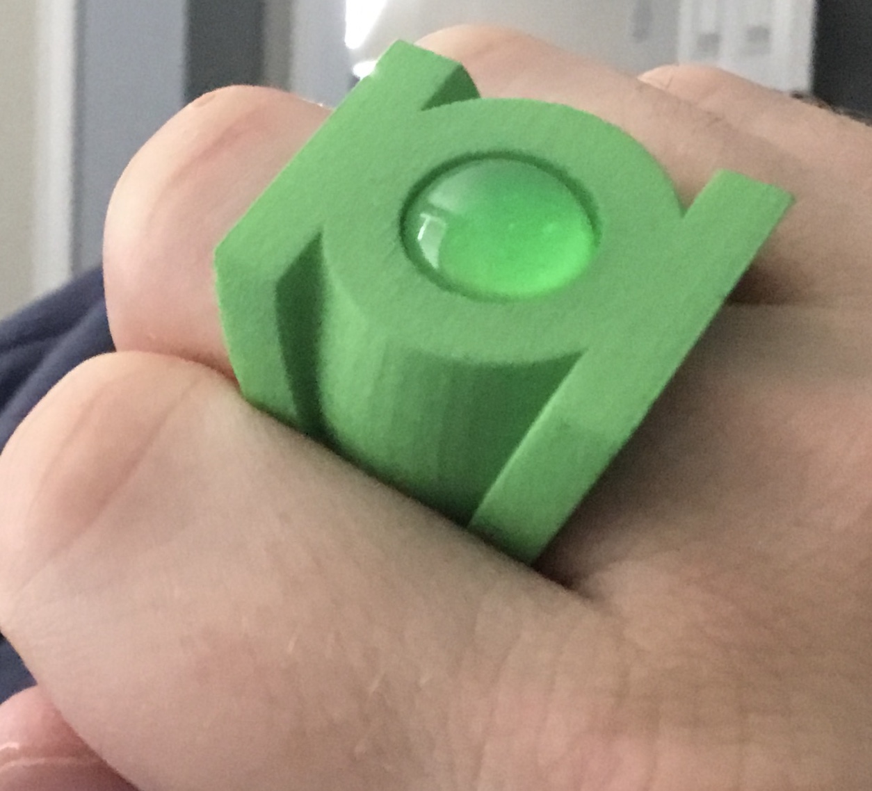

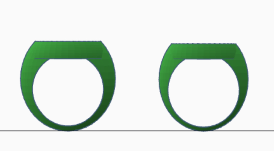

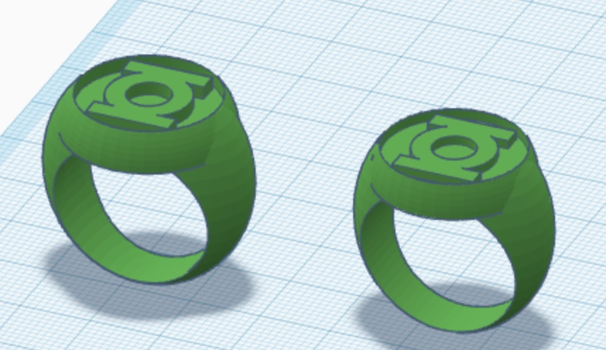

Still tweaking. The band style and width for the V2 continues to annoy me. The current version is perfectly comfy, but I’d still prefer the band to be as wide as the symbol’s central ring. I printed one which is wide enough to meet that desire in the last batch, but it overall comes across as TOO wide, and isn’t as comfy as it could be. I think I may have finally come up with something that’ll work: a sphere based band which is slightly tapered, with a flat-beveled edge (matching most of the reference).
Sphere-based, tapered band on left, cylinder-based, parallel band on right.

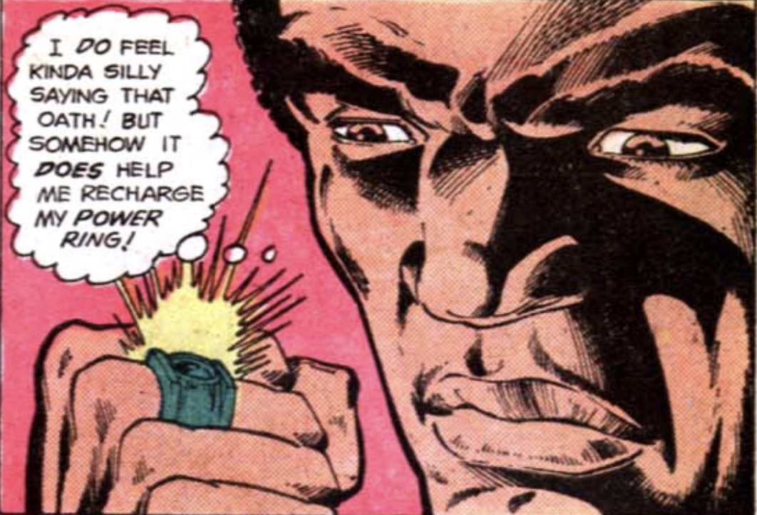

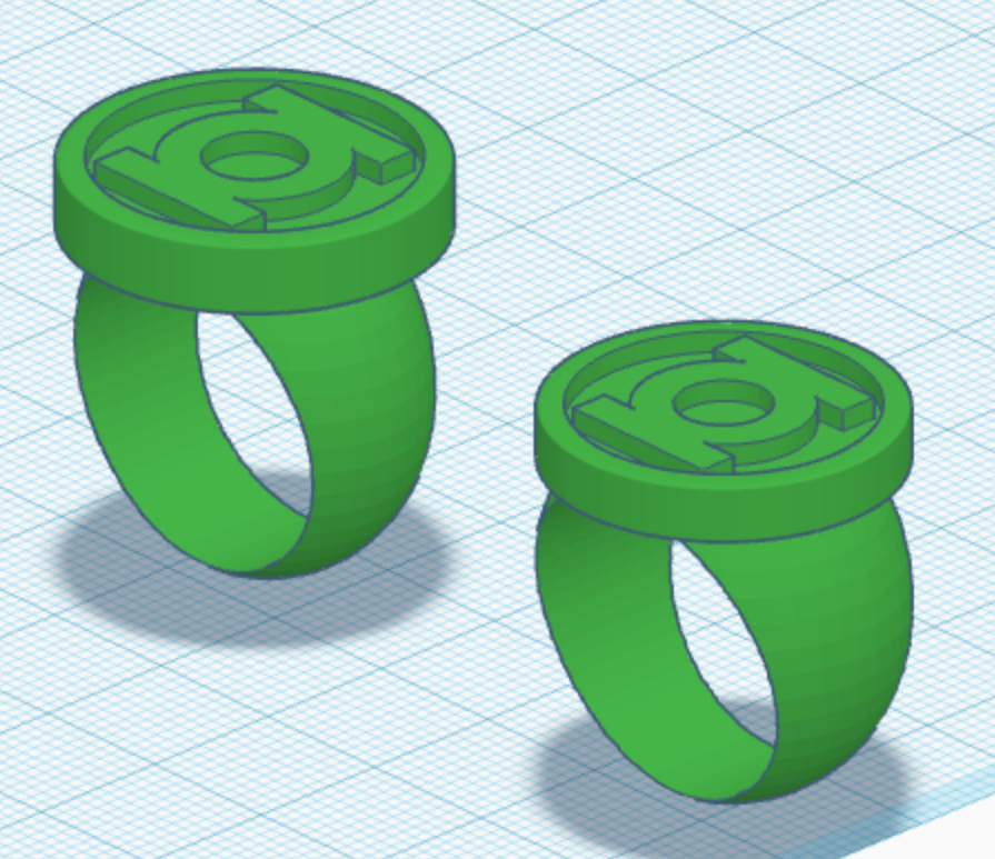

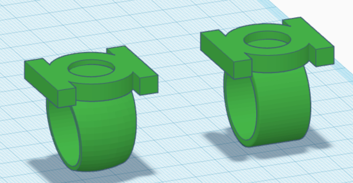

...I’ve found myself second-guessing the Mike Grell design. I’m very pleased with it (and the test-print is on its way), but I’m not entirely sure that the comic design featured the sidebars going all the way around the main body of the ring, creating the tri-band look. Some of the reference indicates that Grell was drawing a single band, with the sidebars coming up out of the central section at angles. Three pieces at the top (sidebars and central parabola) which blend into one shape as you move to the bottom of the band.
To scratch this itch I’ve modeled another variant which depicts this idea. New on left, old on right.

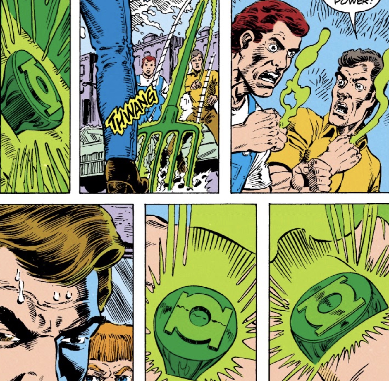

It really is hard to tell from the reference. Some art indicates the tri-band look...
...and some the blended band.
As previously noted, after only a few issues with this more complex design, Grell flattened the face of the ring to resemble the GL symbol proper. And his subsequent artwork of the refined design definitely gave us the familiar tri-band look of the V3 as we commonly know it.

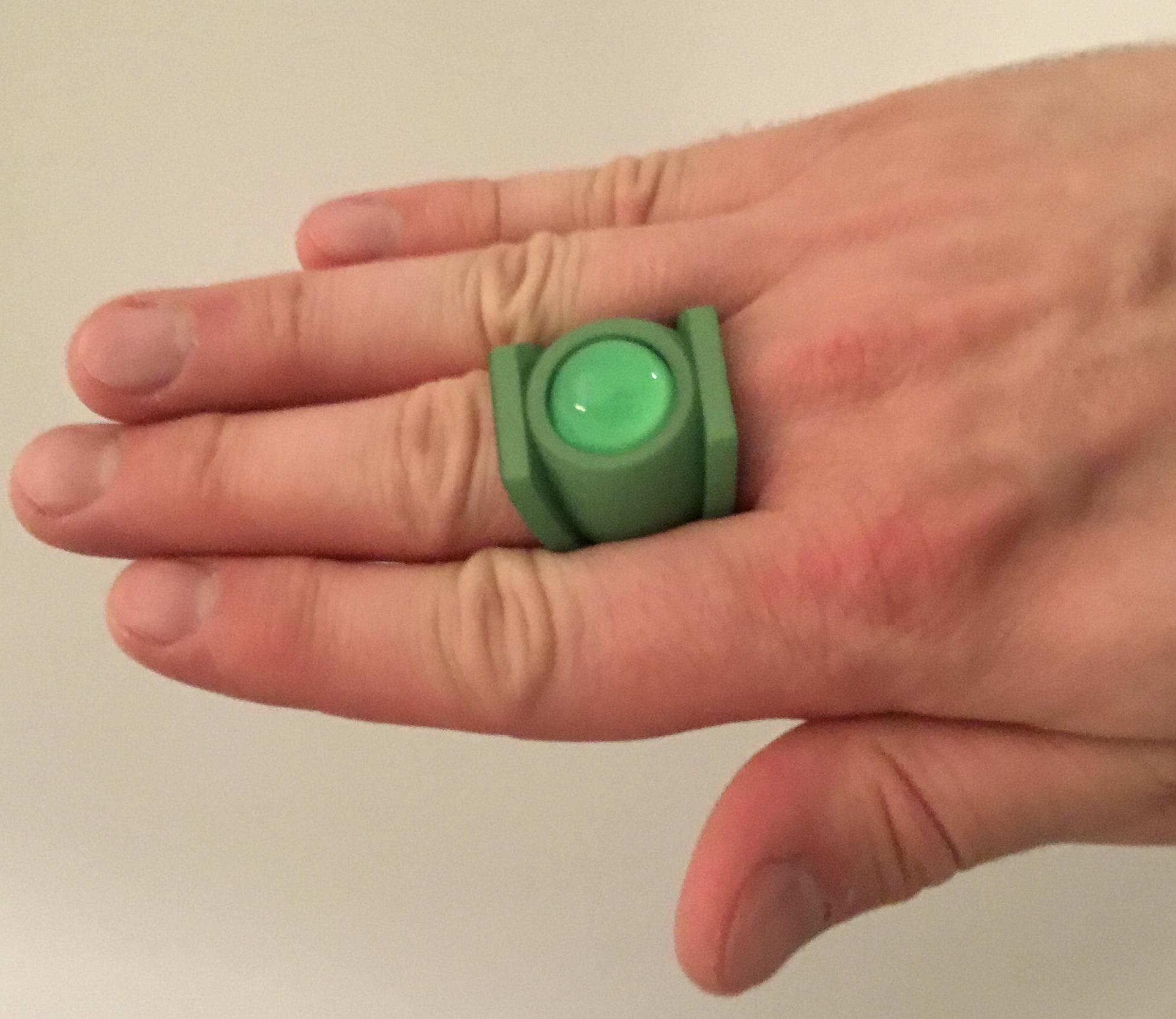

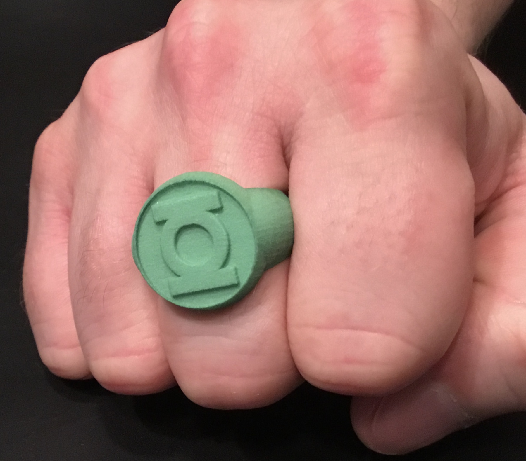

Latest batch of test prints came in. Three out of the four (Abin Sur, V1, Mark Bright) were troublesome, since the finger holes were too small. The last batch was a bit too loose, and these skewed in the opposite direction. Clearly, the middleground between the two should be the right fit.
That all being said, the one success is the Mike Grell design. Great look, great fit. Might need a tweak or two, but I’m very pleased with it.

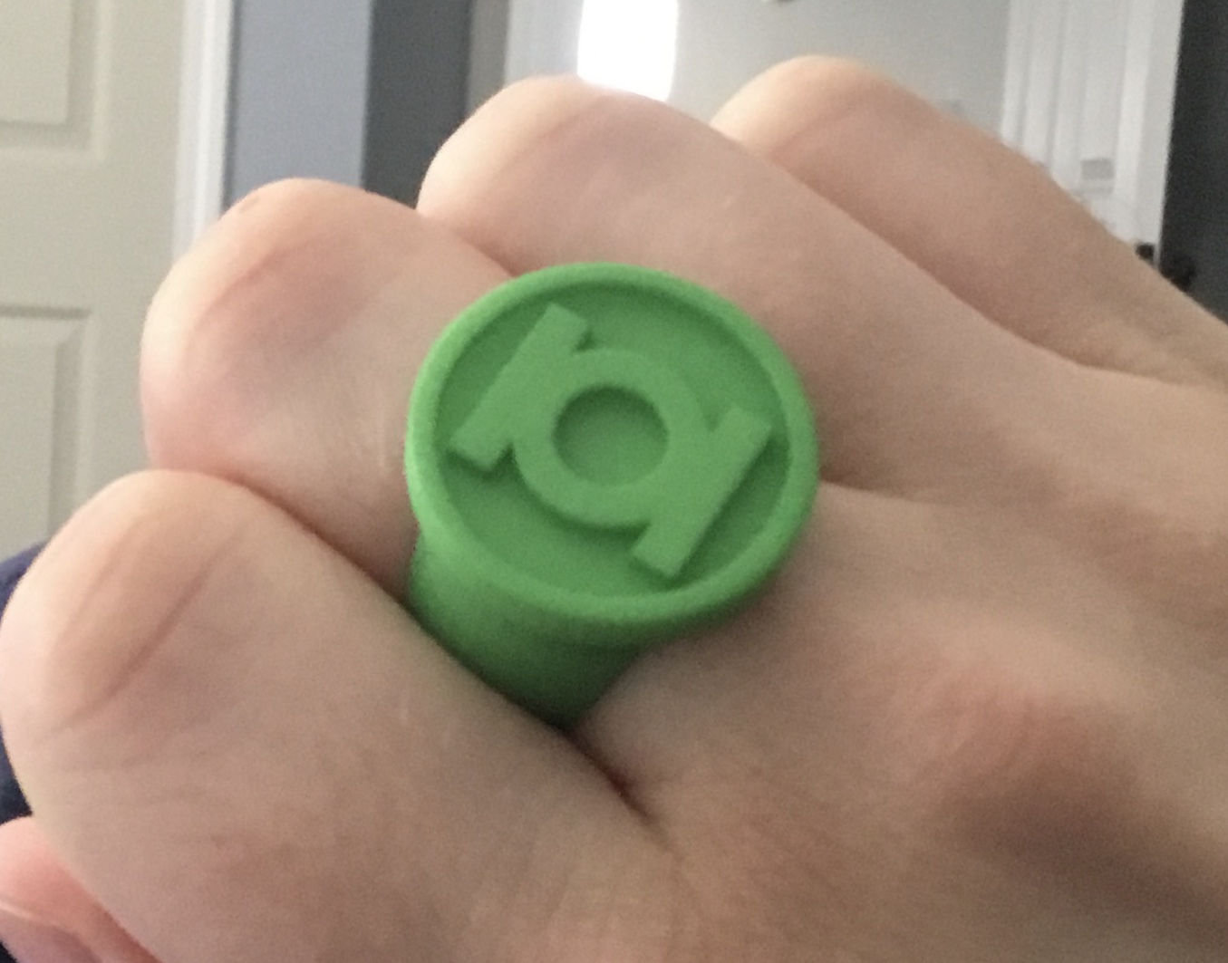

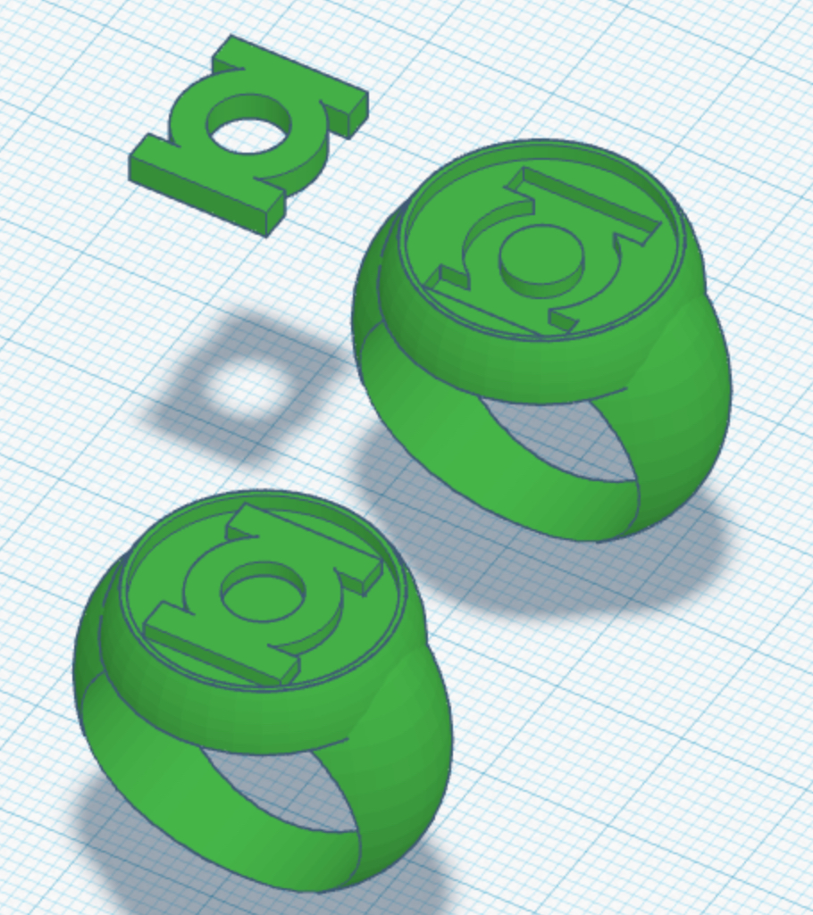

More tweaking. I’m working on the proportions of the V1 (and will pass along the changes to the other V1-type rings when I finish) to make the design more compact and aesthetically-pleasing. A slightly-smaller and thinner symbol-disc, a wider band, and the disc mounted lower on the band (for a sleeker profile).
Originally, I was going with the same diameter (25.5mm) for both the disc and the band, but a smaller and thinner disc seems to look a bit better (although sometimes it’s drawn to look rather chunky in the comics), and doesn’t “overpower” the band quite so much. It looks more balanced, in other words,
As I’ve noted, it’s tricky work taking 2-D drawings (which can wildly vary from artist to artist and drawing to drawing) and distilling them into 3-D objects which manage to capture the right look AND are proportioned both correctly and practically for real-world use.

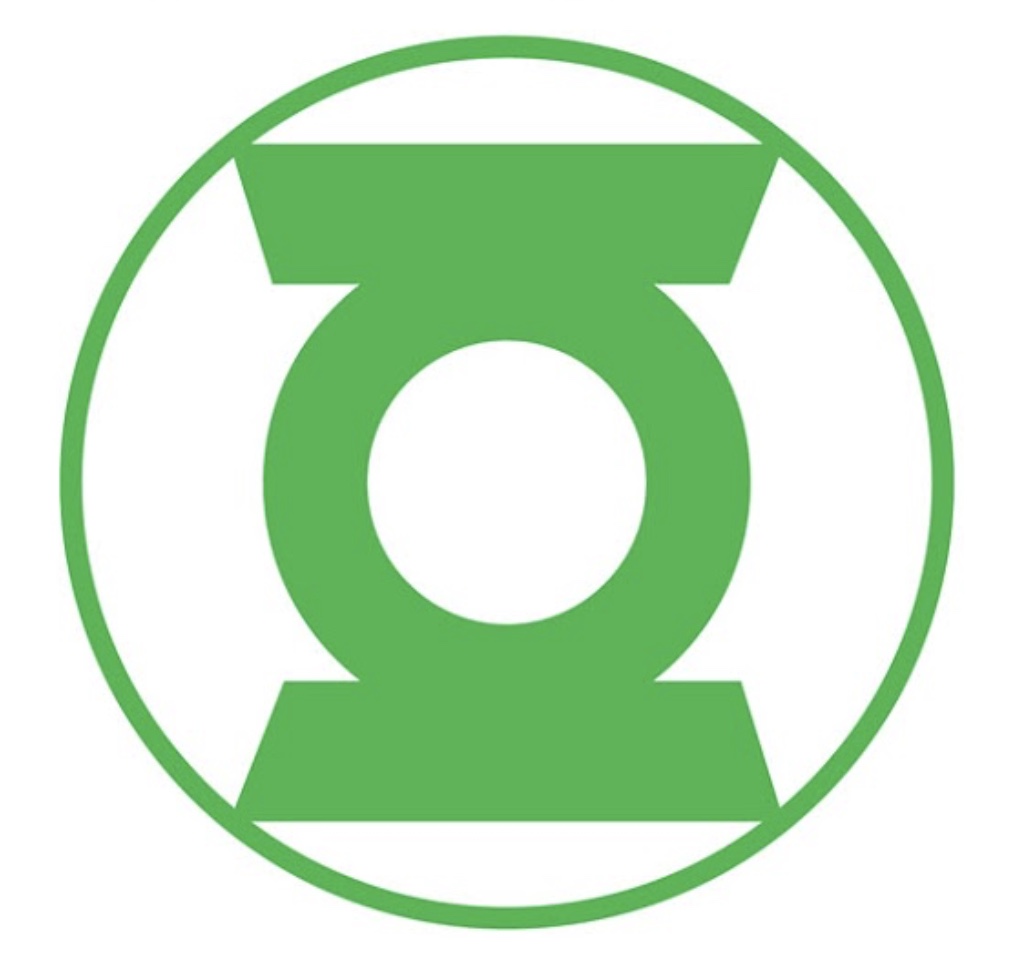

Something had been nagging me about the modern-style ring for quite some time, but I couldn’t quite put my finger on it. Carefully comparing my model to the current official GL symbol, I discovered that the proportions were slightly off. The center ring between the sidebars was too thin, even at first glance. And the sidebars themselves were too short.
I’ve now created accurate versions of the GL and Sinestro symbols and modified the models. They’ll be printed in the next batch. Looks much better!

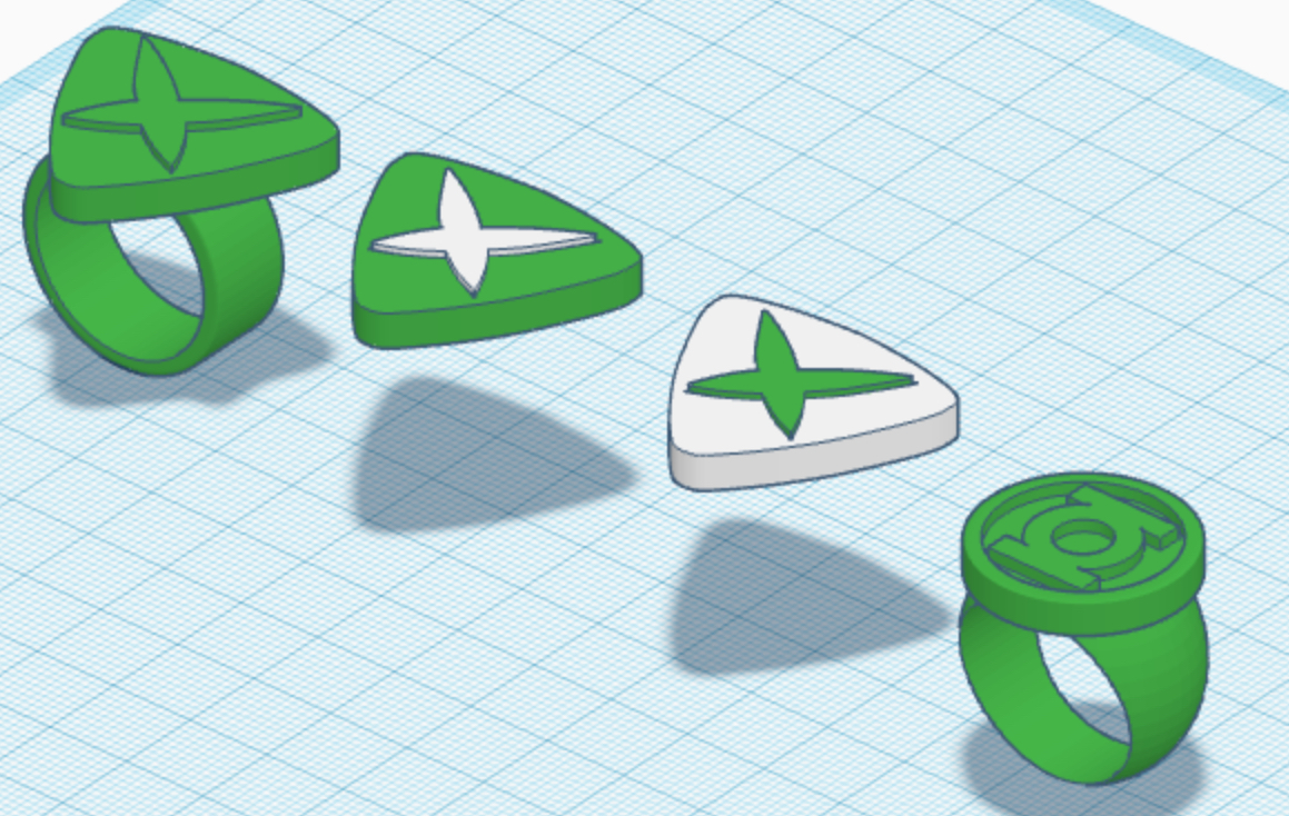

After a good number of weeks, I’ve returned to the Power Ring (Earth-3) design, and finally have something which I’m reasonably happy with. Since the character only appeared a handful of times before perishing in CRISIS ON INFINITE EARTHS, and since the reference for his symbol and ring design varies pretty notably in both look and color scheme, I’ve come up with three versions: A fully-green ring, and then twin, two-piece versions to be printed in two colors, then glued together. Still deciding which to go with.
In his initial JUSTICE LEAGUE OF AMERICA appearances, the coloring of the ring depicted both a version that matched the chest symbol ( green “X” on white triangle) and an all-green version. By his final appearance, in CRISIS, the ring was colored green with a white “X” (which is what the DC Direct replica and other modern versions tend to go with).

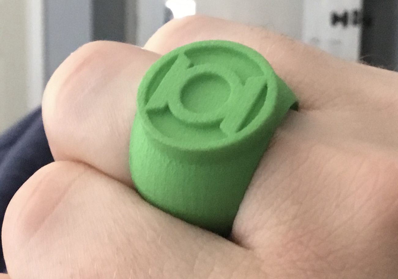

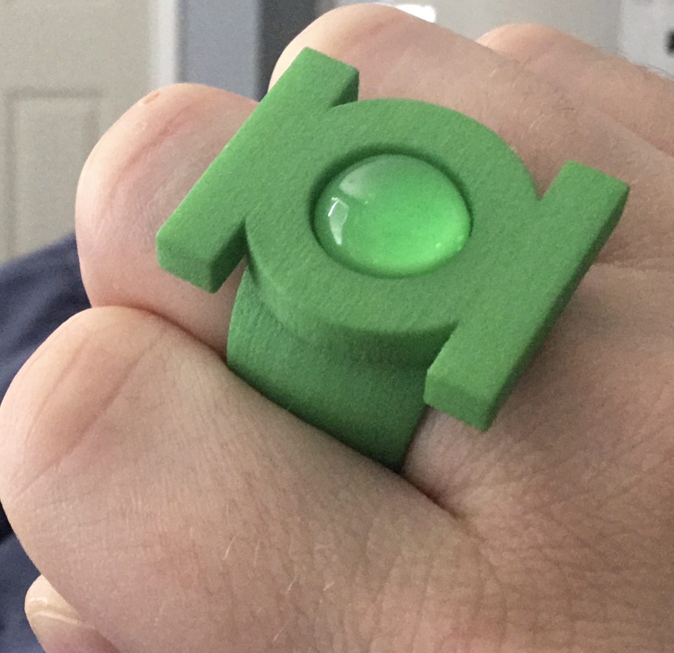

Received a big batch of new test rings. Overall, I’m very pleased. FINALLY got the V3 to a point where it’s nice and comfy, without the band being too wide. It might just be finally locked down, now, because I can’t think of any more adjustments which are needed. The V2 with sphere-based band also looks great. Maybe just a few minor tweaks. The revised V1 designs look great, although now I’m thinking that 24mm for the symbol-disc might be just a tad too SMALL. Might try 25mm, next time. As noted, the artwork varies wildly. Some panels show a ring which looks the size of this new iteration, and others depict a bigger chunkier disc. It’s just a matter of finding the right middleground between inconsistent comic art and real-world, three-dimensional aesthetics.
The early Gil Kane and Sinestro designs need a few tweaks. The EMERALD DAWN design is just about right, now. The finger-hole needs a slight reduction in size, because the ring fits a bit too loose. The Darryl Banks ring could maybe use a bigger symbol-disc. The modern/EVS-style ring is virtually perfect, but for the inaccurate GL symbol (which, as noted upthread, I’d noticed and revised just after ordering this latest print).
Tweak, tweak, tweak.
Here are a few photos.
V1 (sphere-band):
V2:
V3:
EMERALD DAWN:
Modern:
