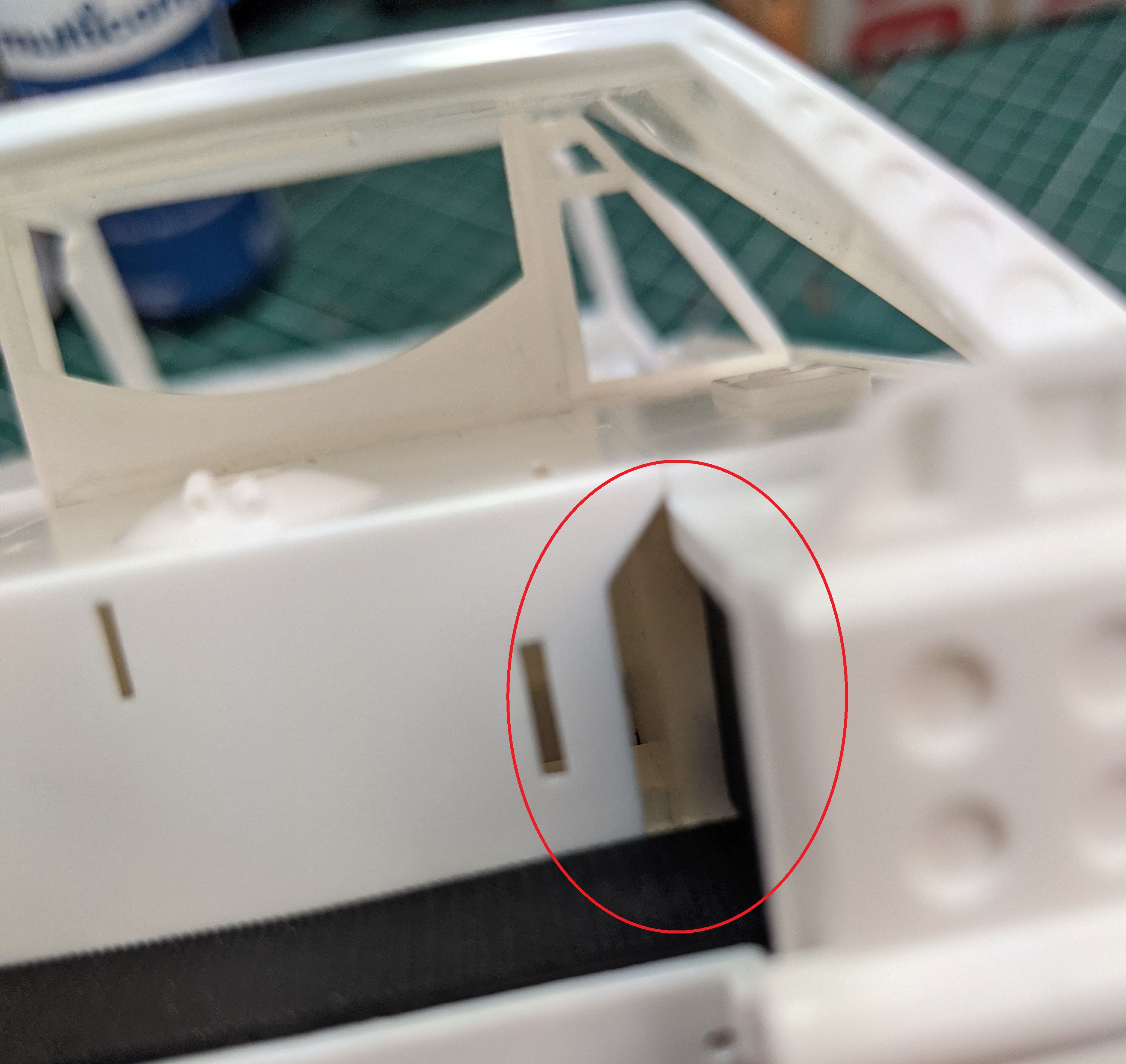

On the rear engine deck there are two large gaps either side that look into the empty internal void of the model.
This image shows the area I'm referring to and the gap on the right. You can see through to the wheel wells although it is difficult to see in the image.
There will be other parts on the outside that hide this a bit but I figured I could add some wiring in there for a bit of visual interest.

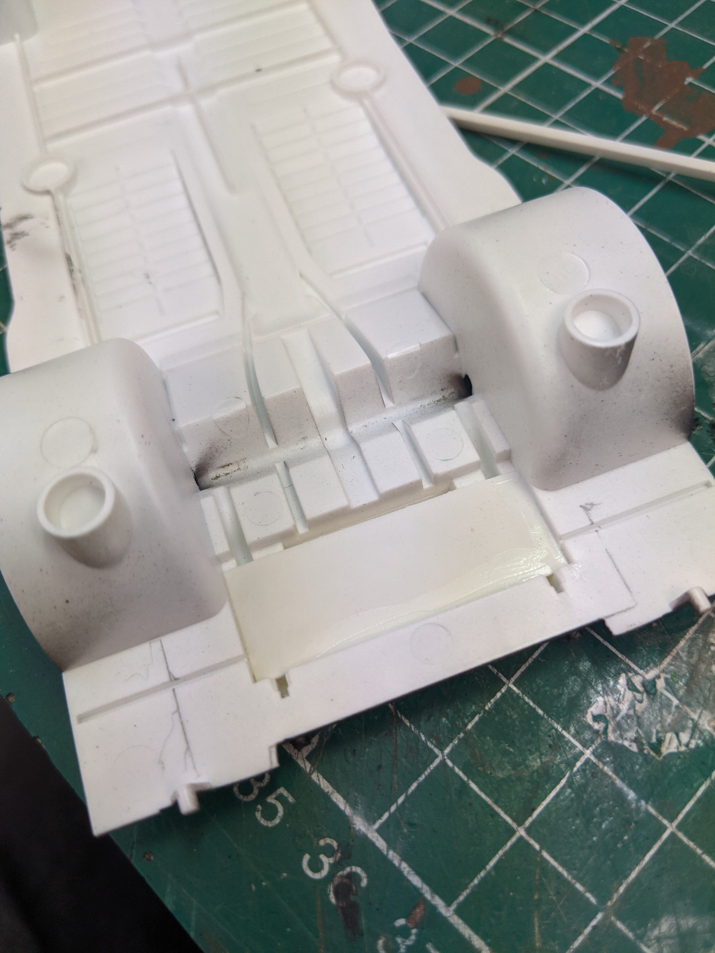

First I added a styrene plate to cover the empty voids of the exhaust moldings.

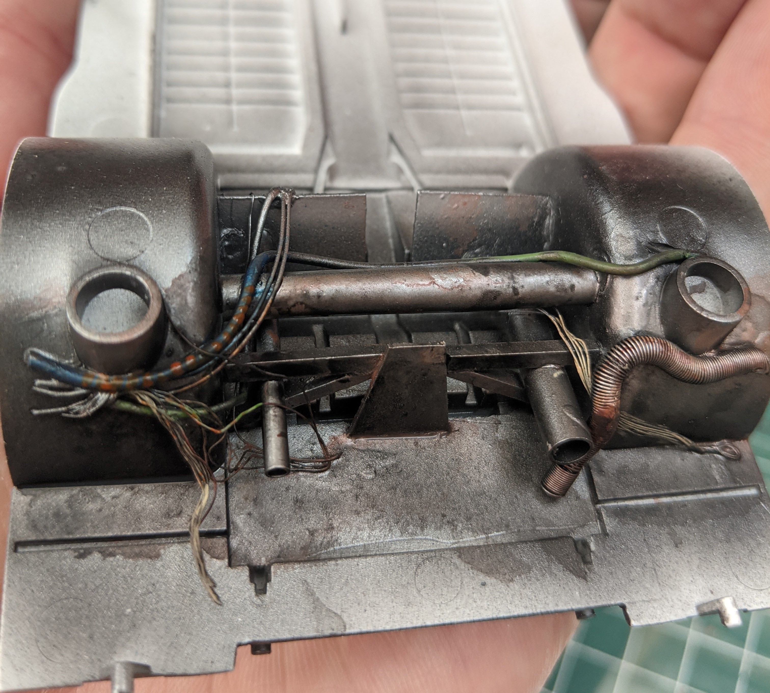

Next I just let my imagination go and added some internal structural braces and panels. Then some wiring and a bit of spring as ducting.
I used some ref pics of the outside of the rear deck for inspiration. Bundles of copper wire strands gave a similar feel. I also tried to think about where cables may be routed to link up with the lights or components of the rear deck of the car.
This was then sprayed in a metallic steel colour with hand painted details to pick out various wires and a bit of grime.
I did not spend too much time on this as it is not clearly visible, I just want to add a bit of texture.
Here's the view through the gaps, you can see a little more in person, it's tricky to get an angle with the camera.
I'm hoping this will just add to the overall feel of the finished model so it reads more like 1:1 scale than 1:24.

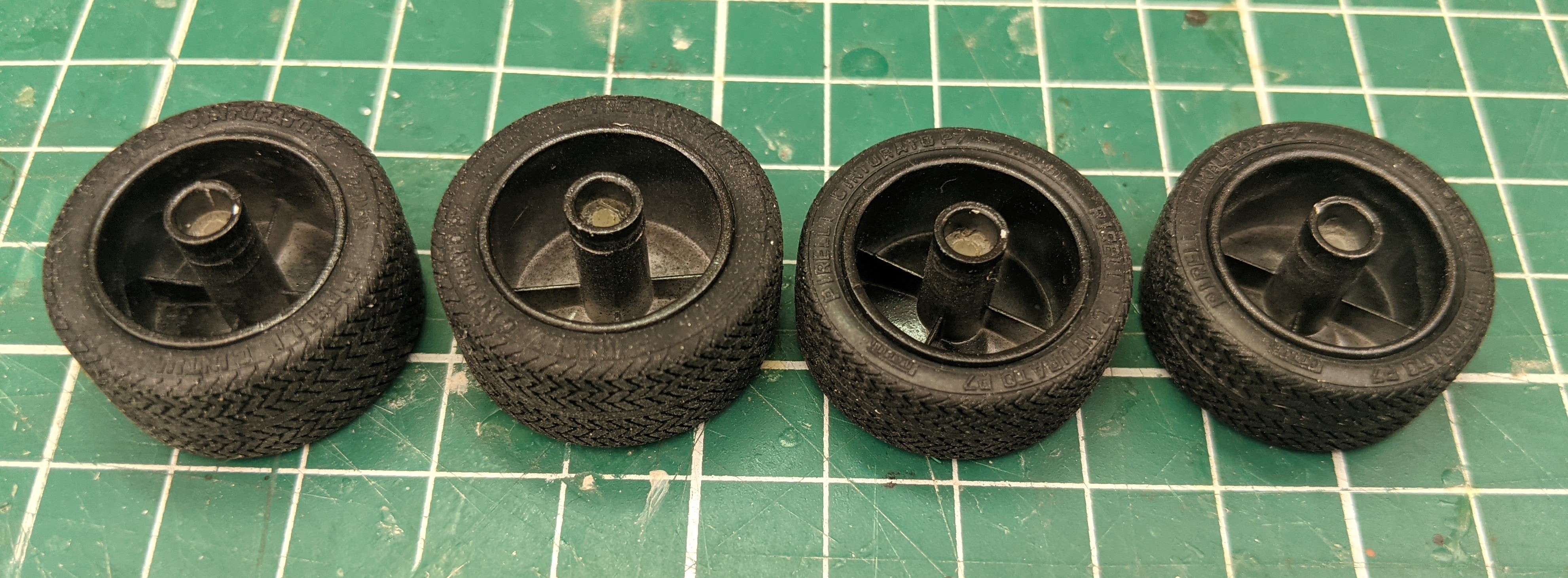

So next up I've sorted the wheels. I wasn't completely happy with the silver coating on these so I stripped it using some Mr Muscle oven cleaner.
Both the wheels and all chrome parts were coated in the cleaner, left for about 20 mins then washed off.
With the wheels back to bare plastic I used side cutters to clip off the lip at the back of the wheel rim.
This meant the wheel was deeper than the tyres so I sanded the rim until it was flush with the edge of the tyre.
Here's the wheels before paint.
The wheels were then primed with Alclad Black Base and painted with Alclad Dull Aluminium.
Here you can see the reverse side with the rim lip removed.

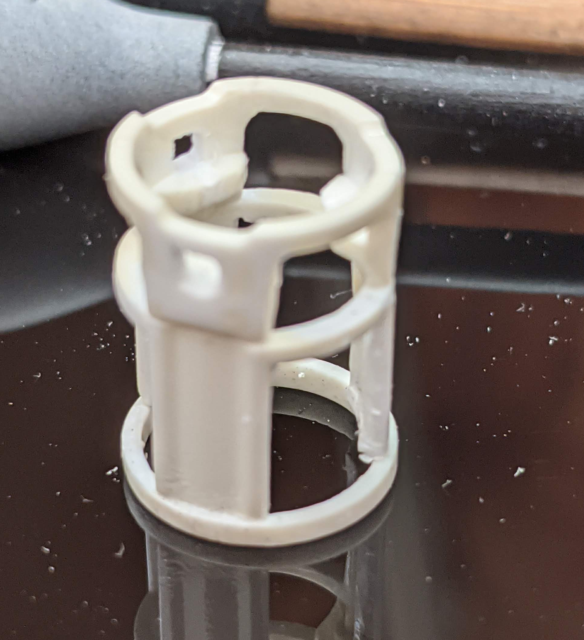

So first up is the part on the right, the cylindrical cage with a column in the centre. The kit part has this molded as one piece so first up I separated the two bits so I could mount them to the car body in the same way as the picture.
This meant that I needed to add a ring to the bottom of the 'cage' part. I cut this from a styrene tube and sanded to the right thickness. This was glued to the kit part. See that marked in blue in the image below.
Then I cut the square holes in the top part marked in green below. Also beveled the edges of the uprights a bit marked in red below.
Lastly I drilled a few 0.25mm holes as per what I could see in the reference. These don't really show yet but should once painted.

I've made a cylinder to go in the middle from a piece of the kit's sprue. I just cut to length and then rounded the top.
There is an intricate pattern on it which I'm not sure on the best way to replicate, I may just mark it on with a fine pencil.
