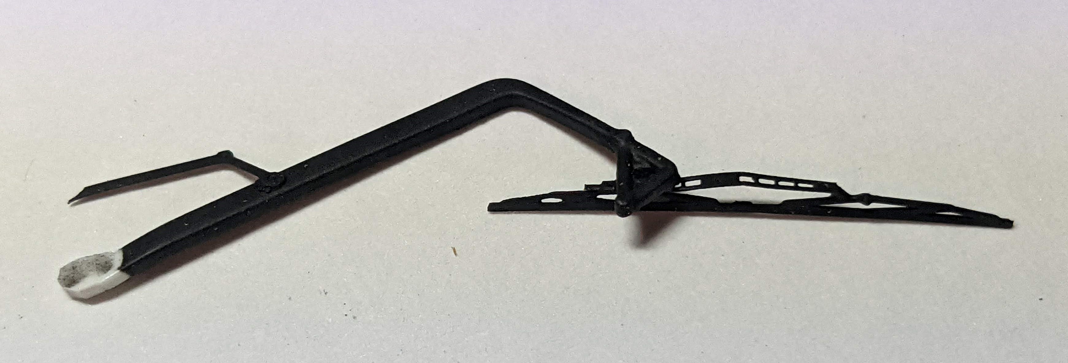

I had a break from the interior parts to work on some extra detailing. This time focusing on the windscreen wiper (a very important part in the world of Blade Runner!)
The kit part is like all car model wipers, thick and out of scale. But you can't expect too much from injection molding!
I've got a Photoetch upgrade set for wipers in my stash. I've had this for years, it was made by a company calling themselves Crazy Modeler.
I kept the arm part pretty much as is but replaced the blade with a suitably sized PE part.
Also added an actuator arm (trimmed from one of the PE wipers) to the side and reduced the mounting point to make it look more realistic.
Sprayed with primer and semi-gloss black and job done!

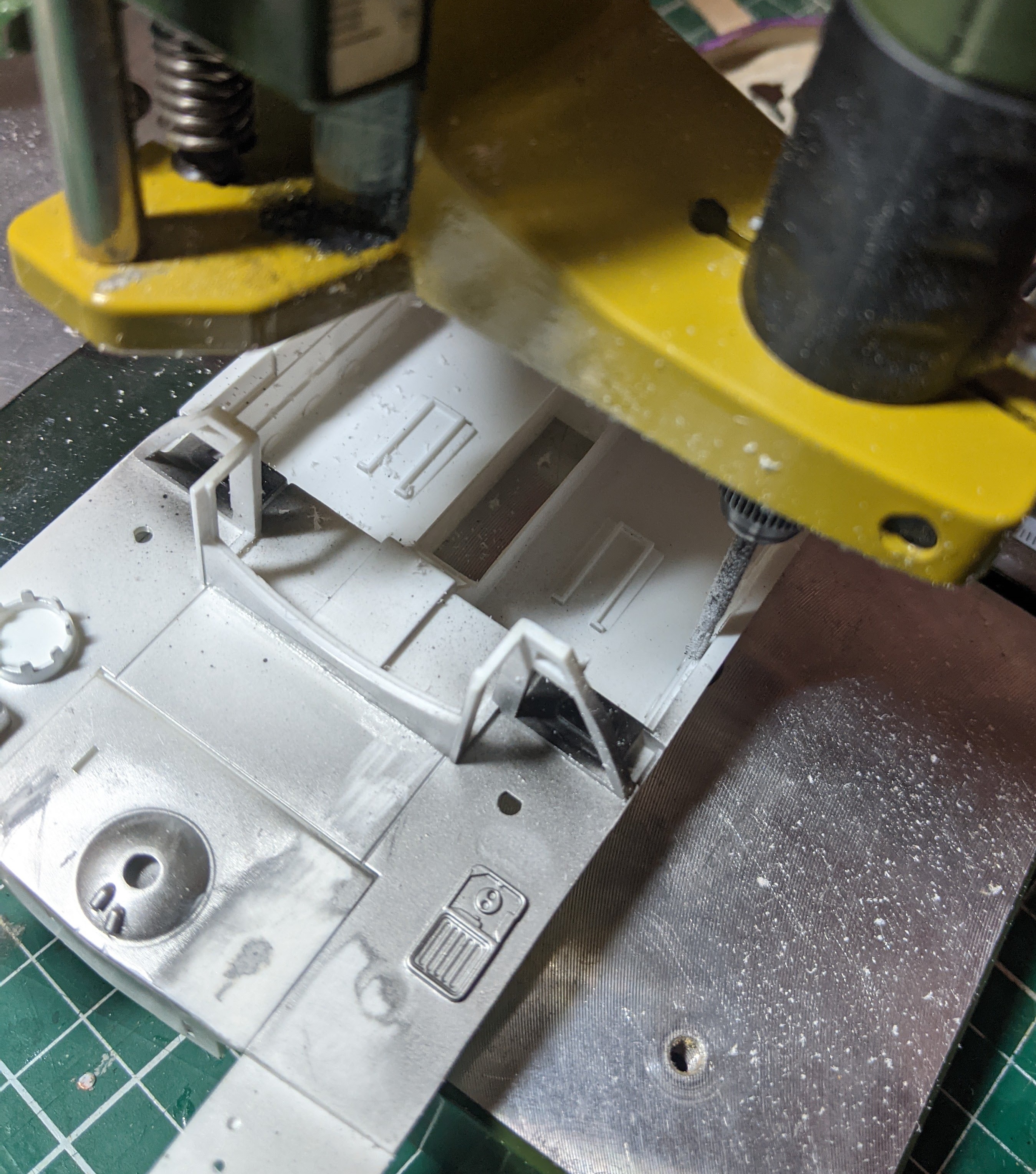

First step with the Paragrafix etch kit is to remove a bit of plastic from the tub. There are a couple of raised pieces on the inside of the doors that need to be shaved back.
I experimented in my usual way of making things way more complicated than they need to be! :rolleyes:
I've got this rotary tool drill press attachment which I envisaged I could use a little like a mill. I chucked in a milling bit and set the height so it was in line with the bottom of the area to be removed.
Then I moved the interior tub back and forth along the tools guide bar whilst running the rotary tool to carve the area away.
It worked but was a bit of a faff and not the cleanest result. I ended up having to put a strip of styrene over the area to neaten it up.
Maybe I shouldn't be watching so many YouTube videos featuring milling!
For the driver side I just used a curved (No.10) scalpel blade to carve away the majority of the raised area, then a file to finish it off.
WAY EASIER! and a better result!

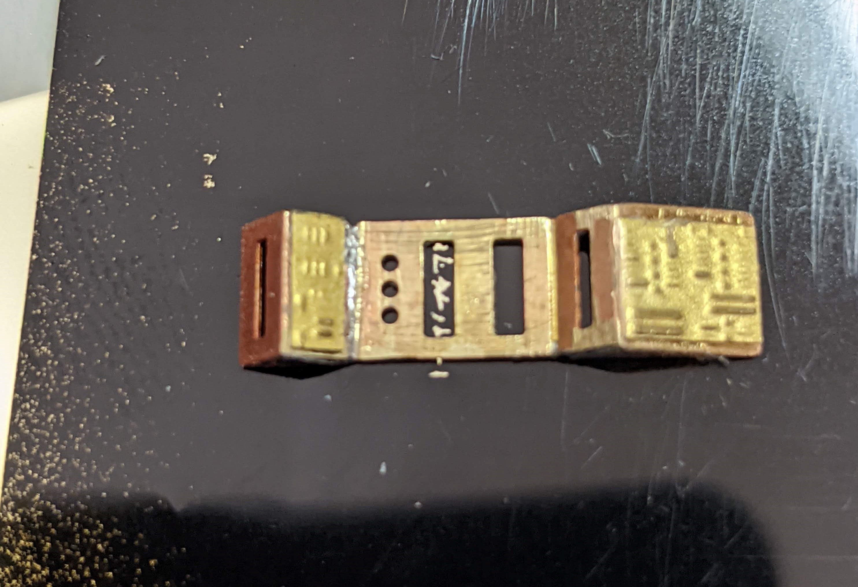

So the next step was to make up the photoetch pieces for the driver side door panel and centre console.
I decided to braise these together with solder rather than CA glue. It's much stronger, better at preventing light leak and I really wanted to get better at it after some very poor attempts several years ago.
Seems really obvious now, and I've got to admit I'm a little embarrassed to say, but the reason I failed had been that I wasn't using any FLUX!
I was using a solder with a flux core so assumed I didn't need more.
The penny dropped whilst watching one of David Damek's (PLASMO - plastic models) tutorial videos on YouTube. Highly recommended by the way, I've learnt a lot from these. Really like his approach to the hobby. Here's a link to his tutorial if you're interested
I just use a soldering iron as I don't have a torch, brush the joints with a little liquid flux. Press the iron against the brass to heat for a few seconds then touch the solder to it. It works like a dream now.
For anyone as clueless as me, the flux helps the heat spread and the solder to flow into and stick to the joints. It's painful if you don't use it as the solder won't melt as easily and blobs on the surface rather than flowing. Liquid Rosin Flux seems like the best way to go. The parts just need a bit of clean up from the flux and filing of excess solder.

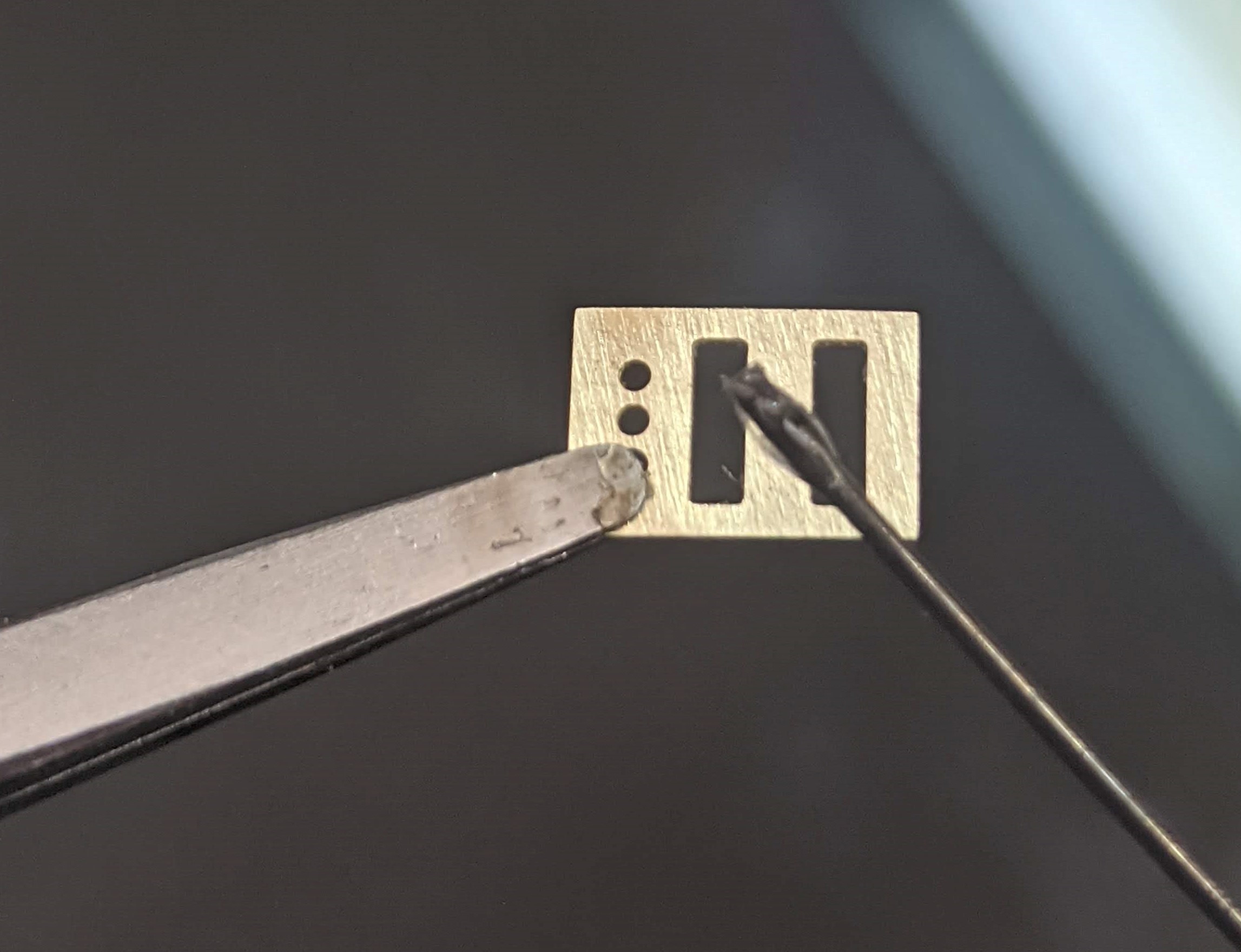

Next up was adding the detail panels to the centre and door console etch parts.
First they are cut from the photo etch fret. I use a scalpel or razor blade pushing down on the part against a solid surface like an acrylic sheet.
You get a nice clean cut this way.
The nub that is left on the part is then carefully filed away. As with plastic, it's better to leave a bit to file than cut into the part in error.
I then lightly coat the back with CA glue applied with a bit of thin wire before attaching the part.
I'm holding the part with tweezers as it just ends up stuck to my finger otherwise! ;)
Here's the centre console with it's detail panels glued in place (the darker pieces on the raised box part).

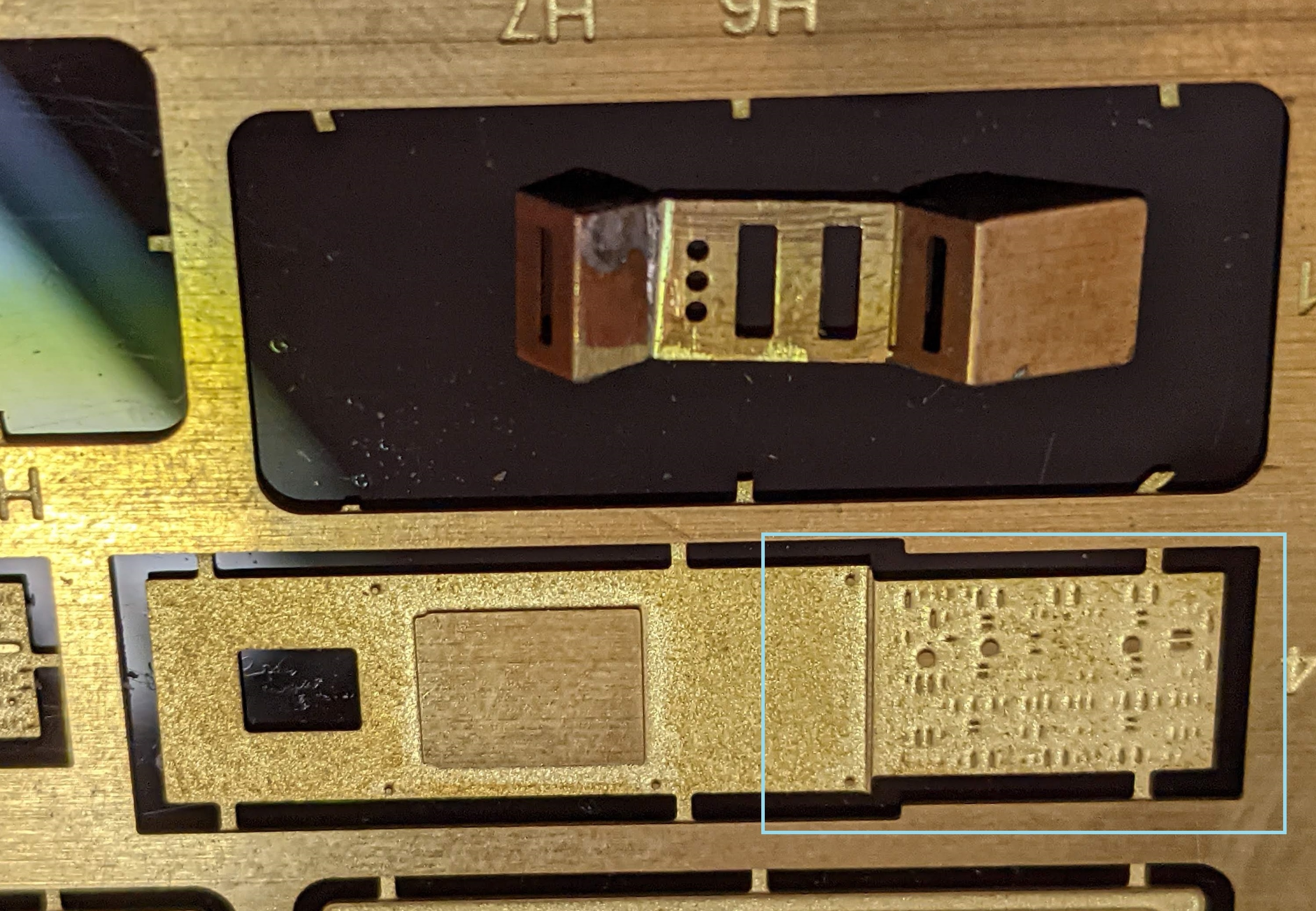

For the drivers side door console I wanted to add a little more detail than is present in the paragrafix set.
I've circled the area I'm referring to in this screen grab.
The Paragrafix part is just smooth in this area so I wanted to find something to go there with the right look.
There is a part supplied in the etch set to model the centre console of the prop car. It has similar detailing so I decided to try this.
Here you can see the part I'm referring to and the pre-details door console.
The area from the donor part is very thin so cuts easily with a few light passes of a scalpel against a metal rule.
I cut three panels and then glued them with CA to the console.
Looks pretty messy at the moment so hoping they'll look better when painted!

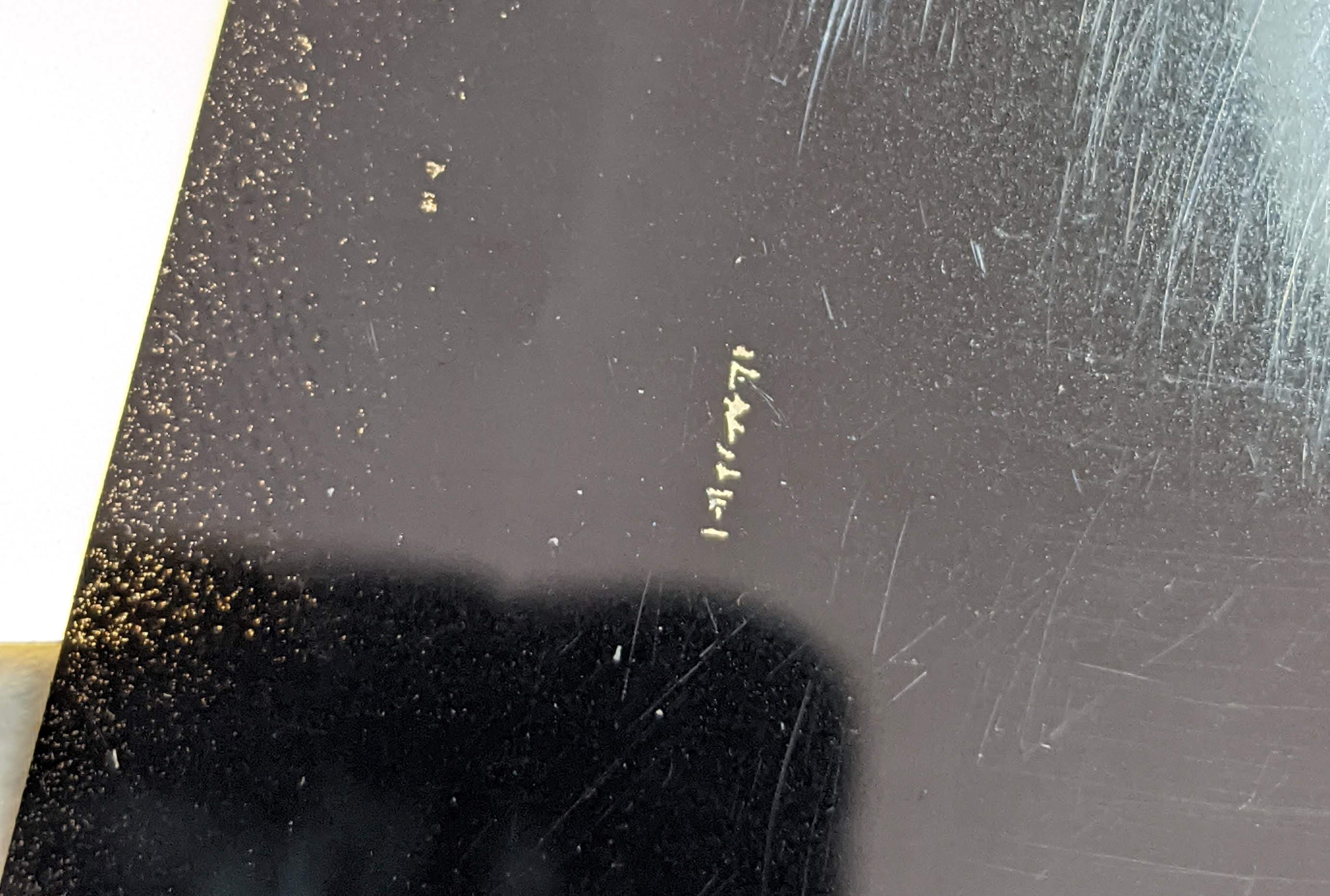

Looking at the screen grabs got me thinking about how to recreate the lit panels in the door console (circled below).
They look like rows of digits or characters. I'll be backlighting these consoles with a micropanel so I'm thinking I can sandwich a piece of film between that and the etch part.
I've done a little experiment with a piece of thin acetate taken from some food packaging. This piece came from the window on a box of Tunnock's Teacakes.... oh, how I love their marshmallowy centre!
I spayed one side with some semi-gloss black Tamiya Acrylic. Then scratched a similar pattern of marks into the paint with an old airbrush needle.
The shot below shows the result with a micropanel as a backlight.
And here it is with the etch part over the top.
I think this should work nicely with slightly smaller marks and a second spray over the etched black paint with some clear blue/green!
