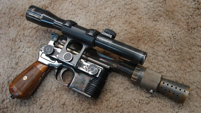

I really like the look of this build. Not sure how accurate it is but I like the finish on the Denix/MCG/Real Mauser/whatever he used.
Any idea how to get that finish? It almost has a burned rainbow-ish look to it.
