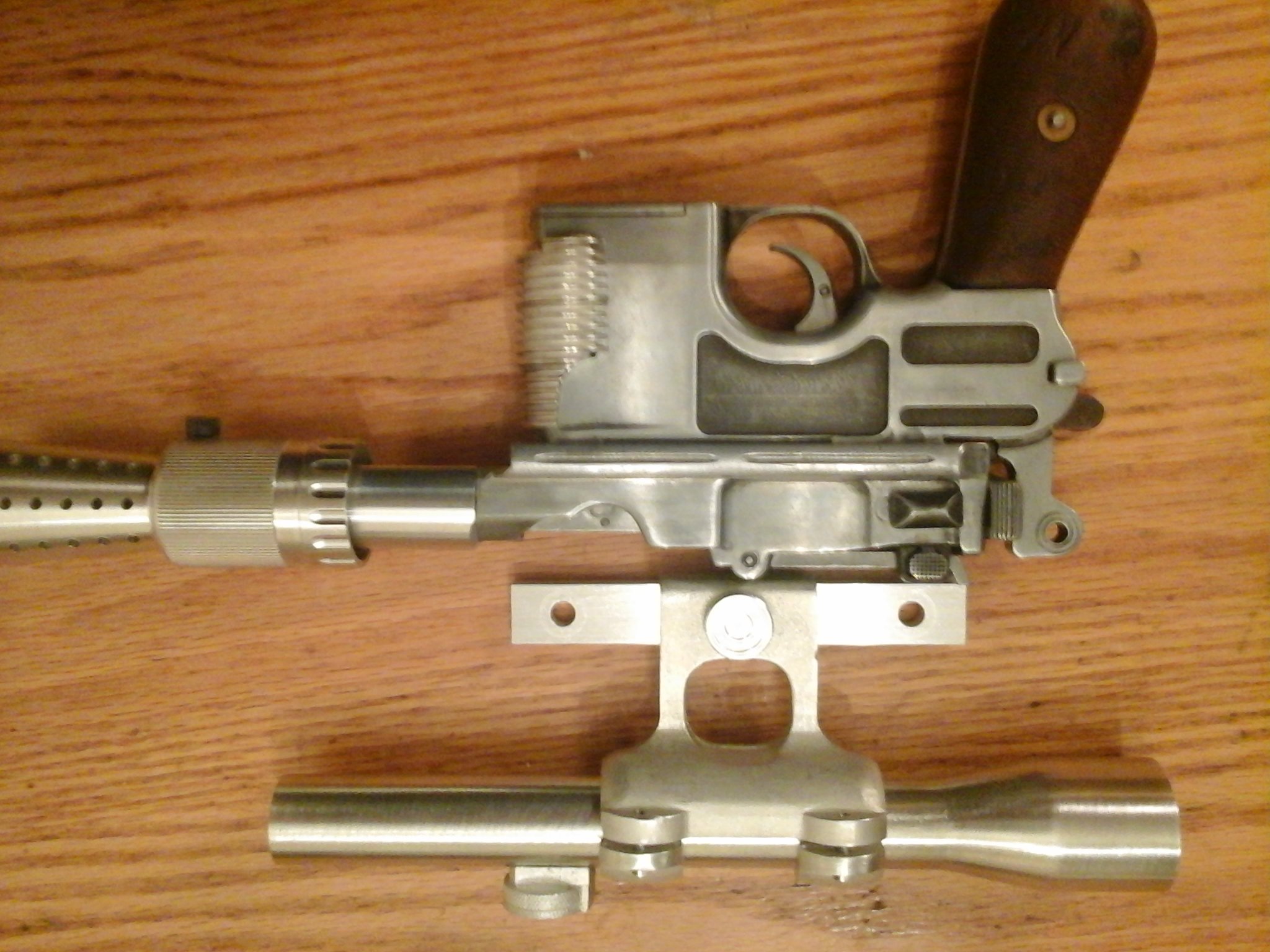

Umm Just doing a dry fit before I attempt this beast, & have come across this. Have I fitted them correctly, I have only hand tightened the screws. View attachment 338018
I noticed this too. I understand how scope rings work, however it is much more pronounced than I would like. I have at least 1/8 inch gap on both sides of each ring. I think I will be doing some sanding to try and reduce this.
Also, I was wondering how people were planning on painting the inside of the scope tube.

My current blaster progress with this run's parts:
I'm holding off drilling and tapping, as I'm absolutely certain that if I did, I'd somehow manage to mount it crooked, which would kill it for me. So, for now, that'll be on Kpax (Pat's) plate.
A pic of the fitted grill:
Still needs to be lowered a little bit, but that's still to come.

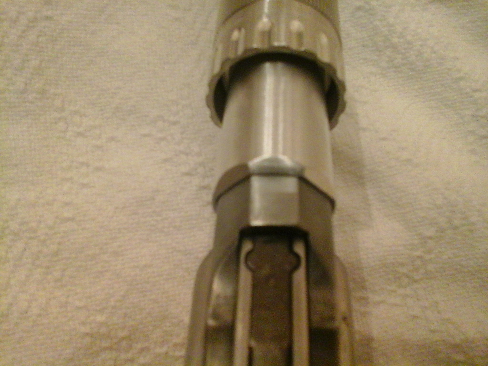

The bull barrel joining point and Chamfering:
Still needs a little more filing to get a proper fit (there's a little gap still, and more bevel will be added as well.) I managed to knick a few little sopte on the hexanon port during filing, but those will be filled in and sanded smooth before bluing.
Finally, a pic of the scope and scope mount assembly:
Please keep in mind that although I've polished the scope itself up a bit, I've yet to touch the cast finish of the scope mount itself, so there's still plenty of work to be done. I'm still totally jazzed about getting these parts, even though there's a LONG way to go.
~But, as they say, it's a long, strange journey.~

Smart idea on the drilling and tapping. Remember to be very careful everyone. I drilled and tapped today (first time ever doing this) Worked out pretty well! I could have drilled the holes about 1/16-1/8 inch higher on the gun. So make sure to measure twice... no measure 5 times and drill once :).
Also, whats the best way to get the bull barrel to sit flush up against the Denix? I'm assuming I need to sand and file the Denix a bit.
Schbingo. The Denix barrel point need to be WAY filed down. Here's a link of one of Scottjua's Denix builds, and in it, he shows a pic of about how much fling needs to be done: http://www.therpf.com/f79/another-h...-accurate-parts-denix-210271/?highlight=dl-44 He did an AWESOME job.

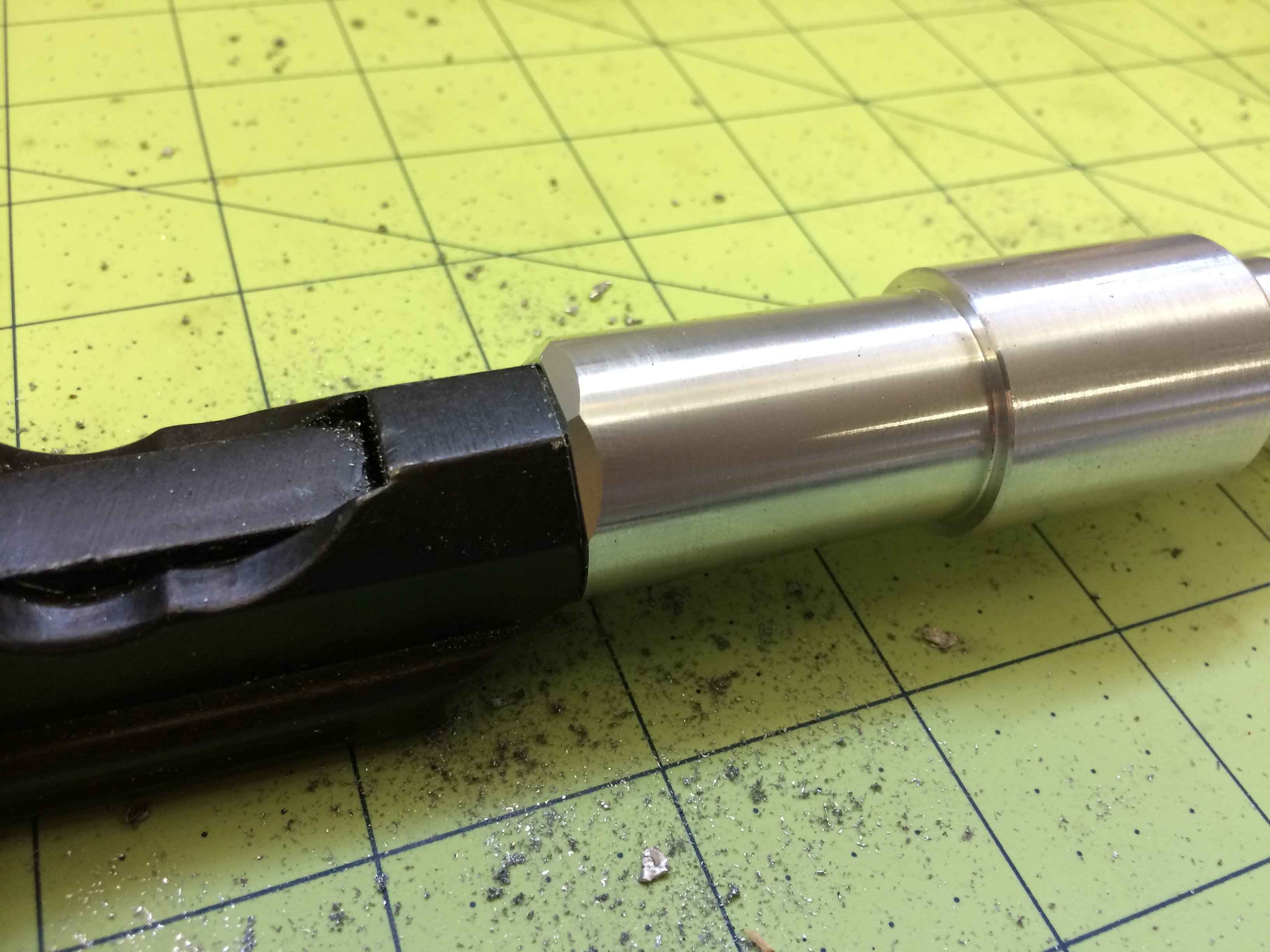

Today is all about grinding for the barrel to fit properly... oh and soccer. ;)
Edit: no clue why this pics are upside down. sorry for cramping your neck.
