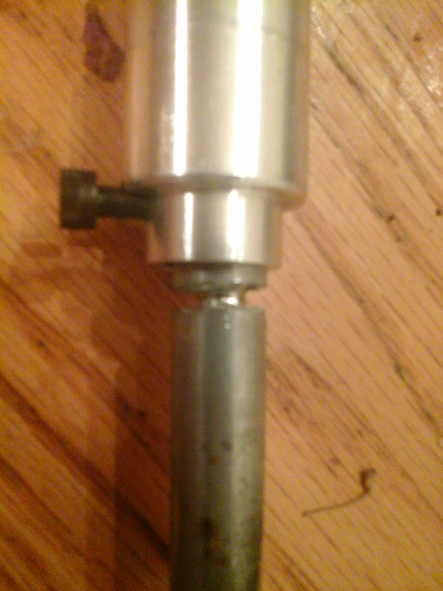

I've got the sleeve barrel and flash hider mostly fitted but I've had a LOT of difficulty cutting down the MGC barrel, more specifically, the steel rod at the barrel's center. The outer zamak shell my jigsaw cut through with little trouble, but the inner steel is giving me serious ulcers. Any thoughts/ideas please?

^^ hacksaw blade or dremel with cut off wheel.
Wear eye protection!
file or grind flat.
Measure once..cut twice...
Wait A Minute. ,,,,
Reverse it...
measure twice... Cut once!
make sure you cut the barrel long enough to allow the Flash Hider thumb/set screw will tighten against the cut off barrel!
as Dave said.
Dry fit all first.
Have fun!

Vanitas, that rod is HARD... Hacksaw will cut it though.
KPax, is right, definitely leave more than less. Adam Savage looks to have cut too much and in the video you see them do some rigging to get around it.

Don't worry, I made sure to leave enough barrel for the sleeve barrel to fit:
This is with the sleeve barrel all the way back, but that steel rod is one tough SOB... And with my dremel out of commission, I'm stick... My jigsaw is a pretty good one, but it stood no chance. So, for now, I'm at an impasse.
