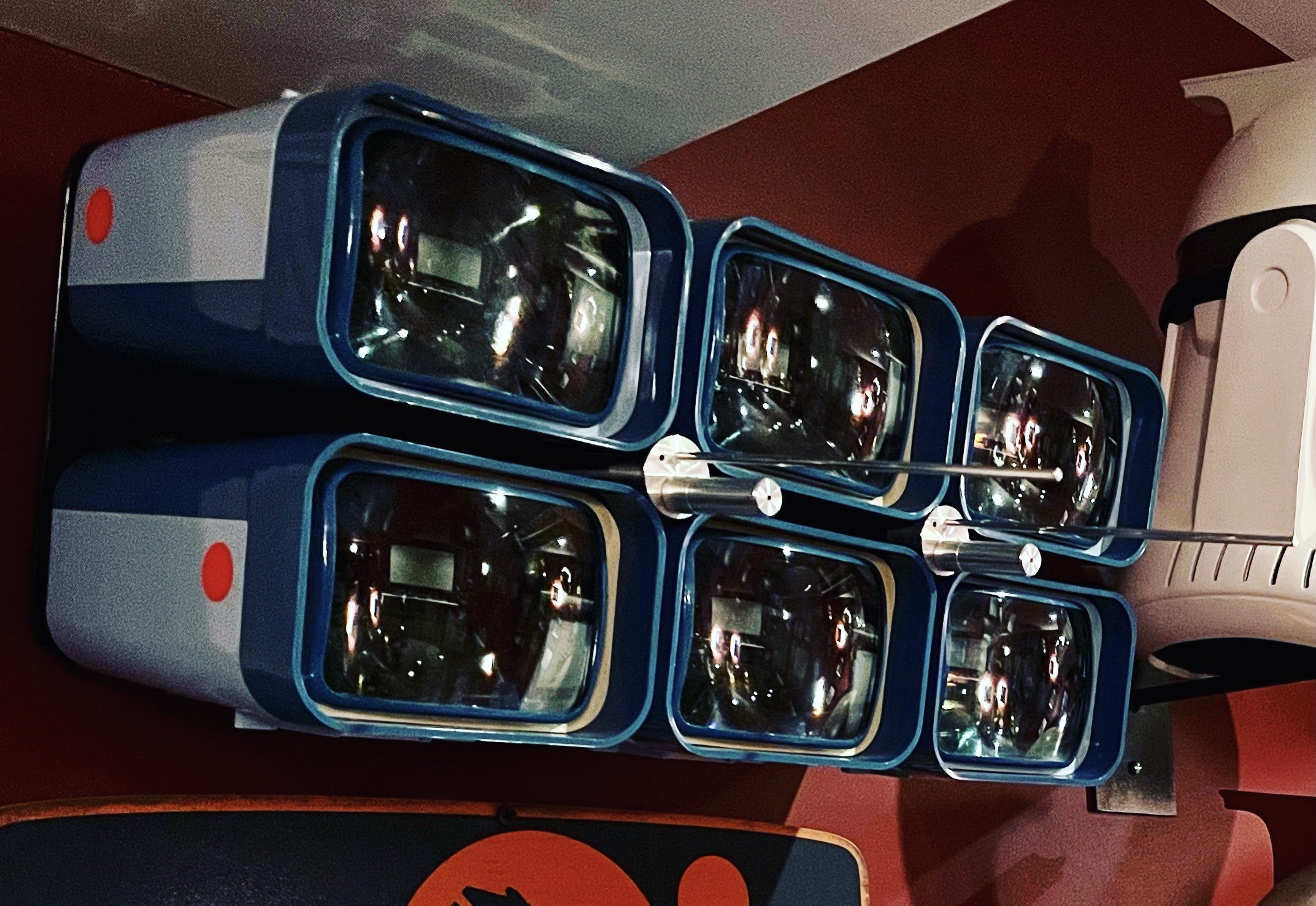

They look awesome! I will be needing a set for sure to go with my setup I put together thanks to you!
