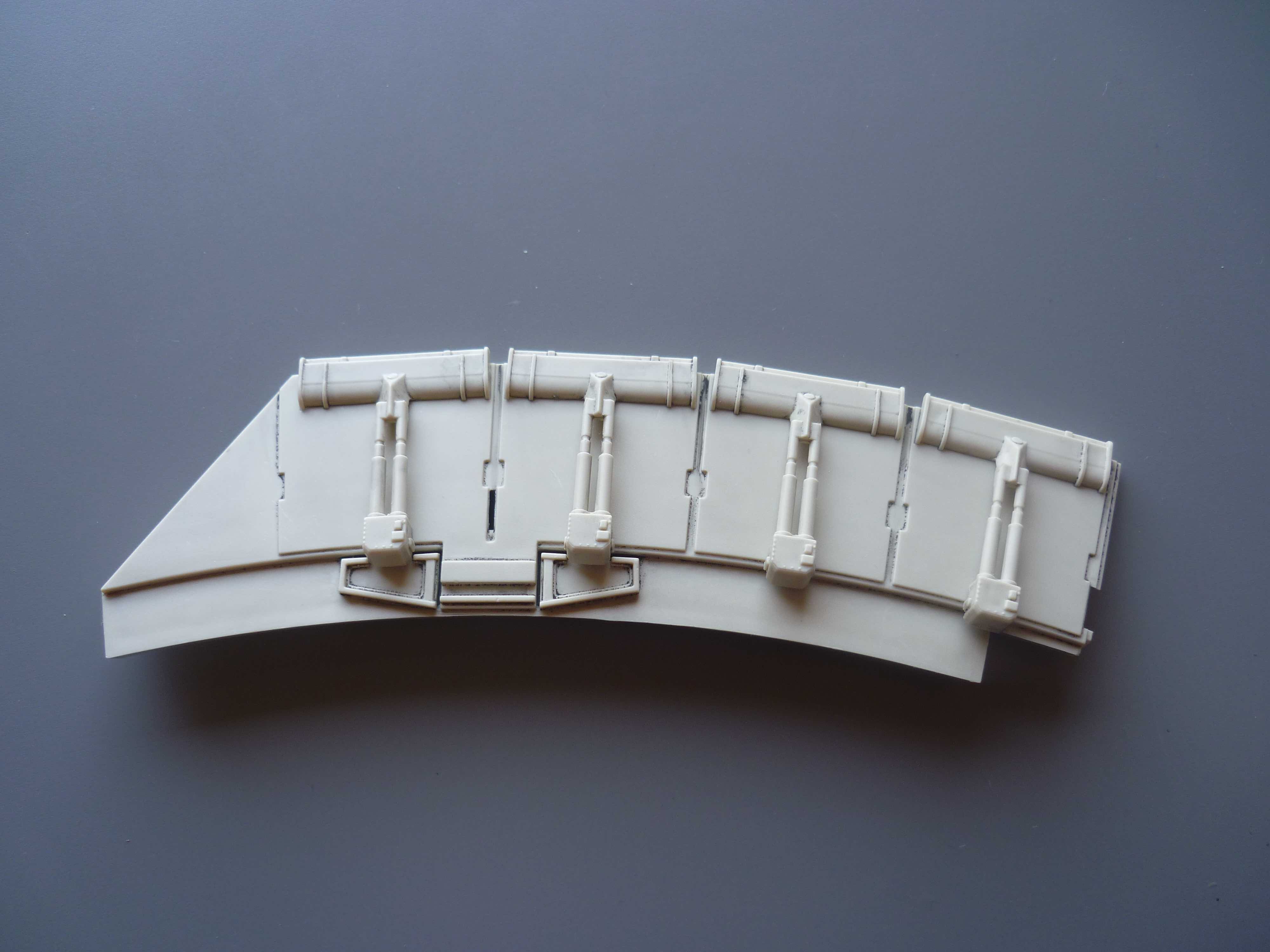

Just picked up issue 32 from the newsagent this morning, the quality of the moldings of the engine flap actuator pieces is superb! Crisp edges and nice rivet detail. Not sure how accurate they are though, some of you here will know much better than me!
I am treading water somewhat at the moment with my build however, as my newsagent did not receive from DeAgo any of their subscriber ordered copies of issue 29. This is the only issue that I have had a problem with though, and it is on back order, so hopefully it will be here soon!
