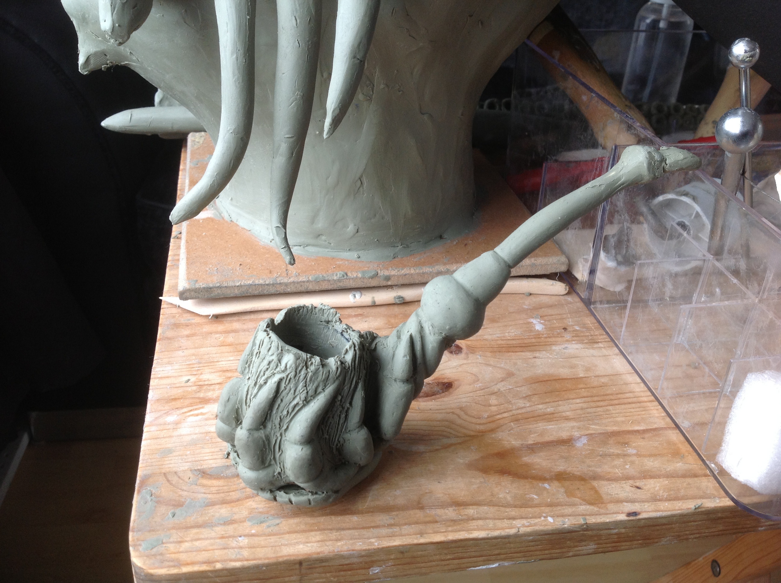

To tie in with my Davy Jones mask, at http://www.therpf.com/f62/davy-jones-mask-continues-180888/
I'm making a crab claw pipe.
Ive had a look at various references, but the main one was right here on the RPF sculpted by Hotshot. See http://www.therpf.com/f9/potc-davy-jones-pipe-reduxe-finished-143565/
For the purposes I need (quick costume) I'm keeping it simple, however, I may use it later as a basis for a more detailed model, for cast/ sell.
i did however like the idea of the " glowing embers" idea that hotshot used, so I'm gonna utilise something similar.
The photo shows the first rough sculpt. This is ready for final detailing, then moulding.
Comments & suggestions welcome:D

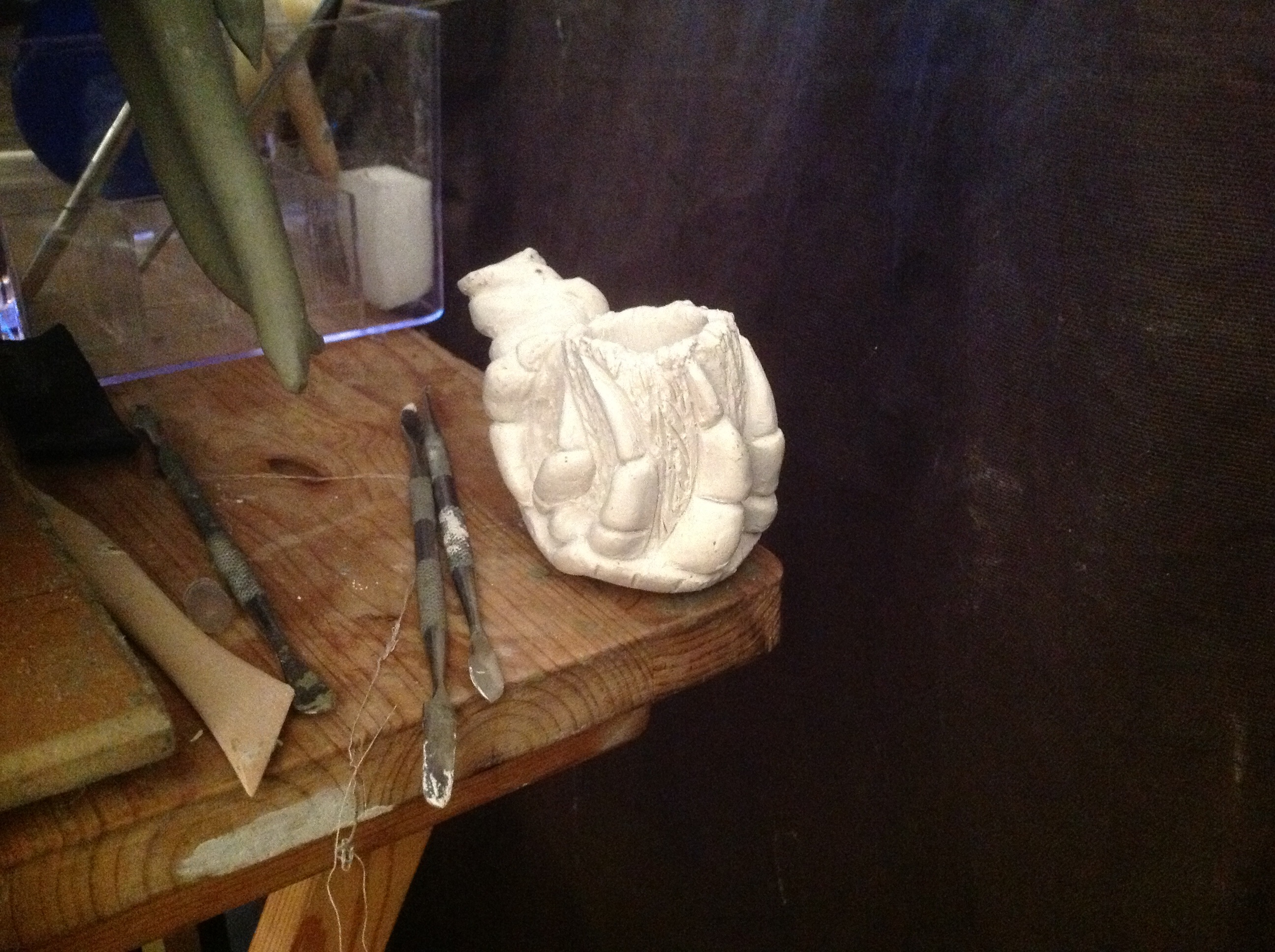

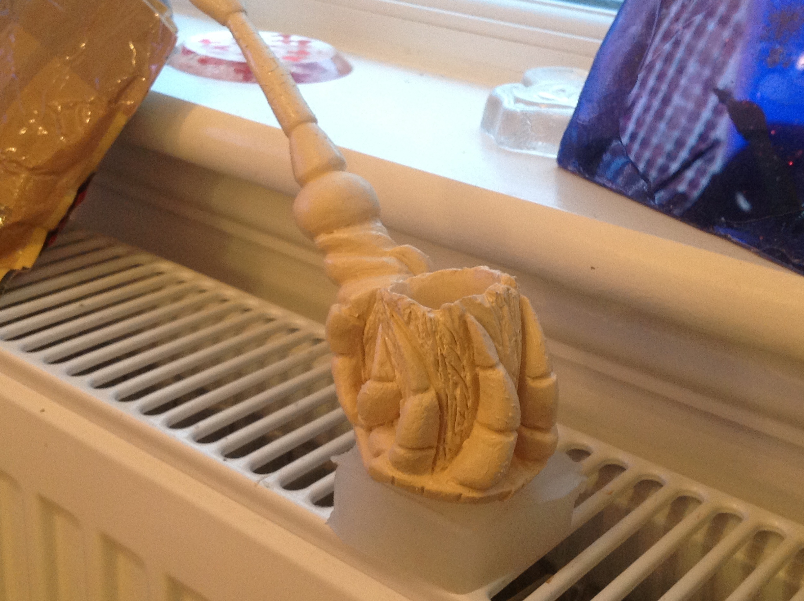

First cast!
Having watched some videos on Tony Cipriano, I noticed he makes a quick mould, then casts a plaster " master "
He then uses that plaster cast for final finishing then uses that mould for his final casting of his maquettes.
So this photo is the first stage plaster casting.
I'll scrape away at this for final detailing, then make the final mould. Hopefully, this will give me a highly detailed finished product.

how come you decided to not finish the detail in Chavant clay.?
I would of thought the plaster would be harder to get fine detail on.

the reason for the 1st plaster cast method, was watching the Tony Cipriano videos- he seemed to get a great deal of fine detail into the models, so i thought I'd give it a go on a small project. it takes a bit longer, bit initially it looks like working out. theres also the added cost of the extra silicon mould, but ..... you hasta pays for quality lol:facepalm
if it works out well, i'll maybe make the DJ locker key too. im thinking of making some Aztec "gold" coins, to give to kids on the cruise - it is Disney after all.
I'll put another pipe piccy up later tonight when ive scraped off some plaster detail.
Google tonys videos, he makes maquettes for Marvel & Disney et al , and theyre pretty cool
First cast!

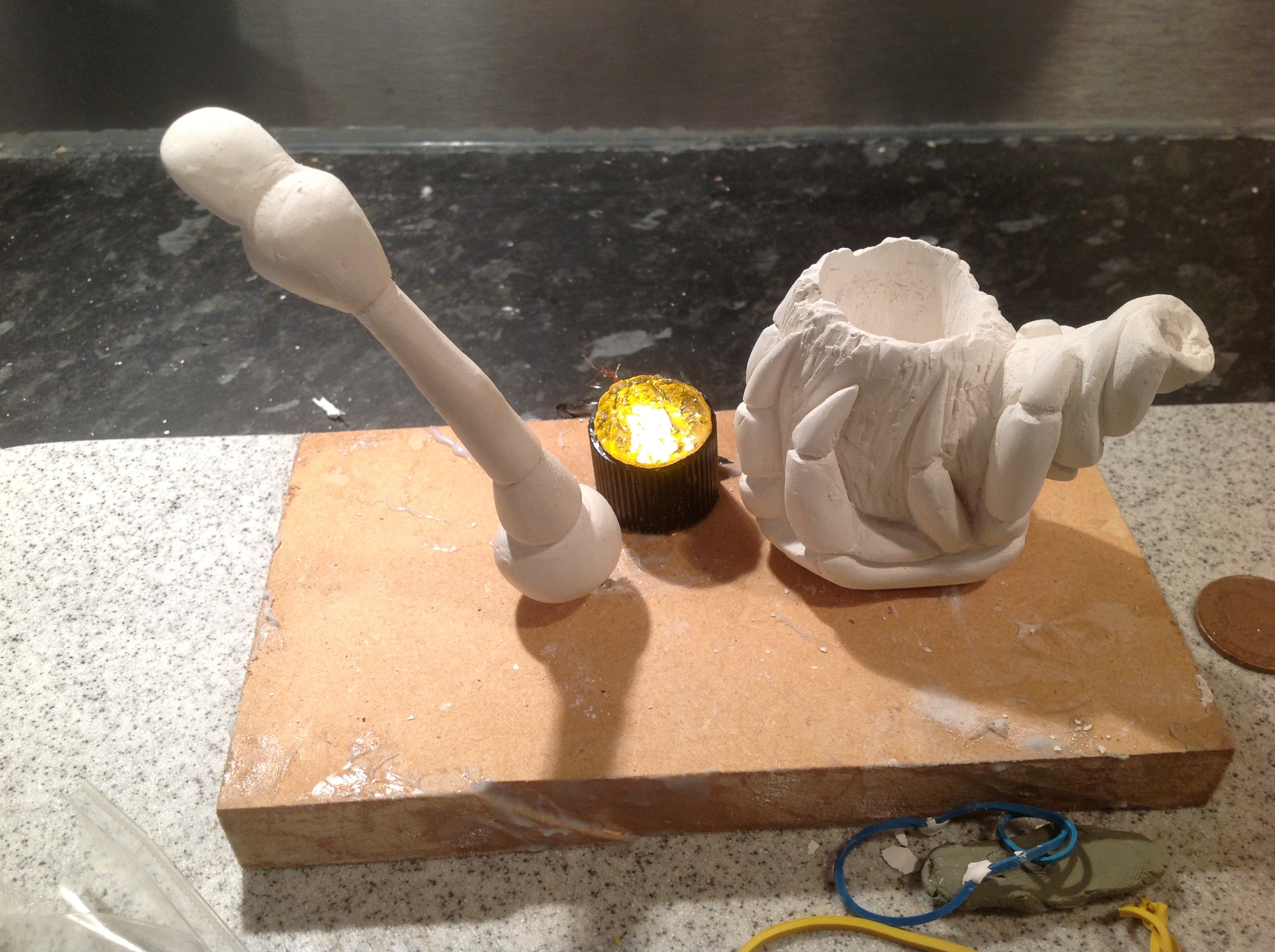

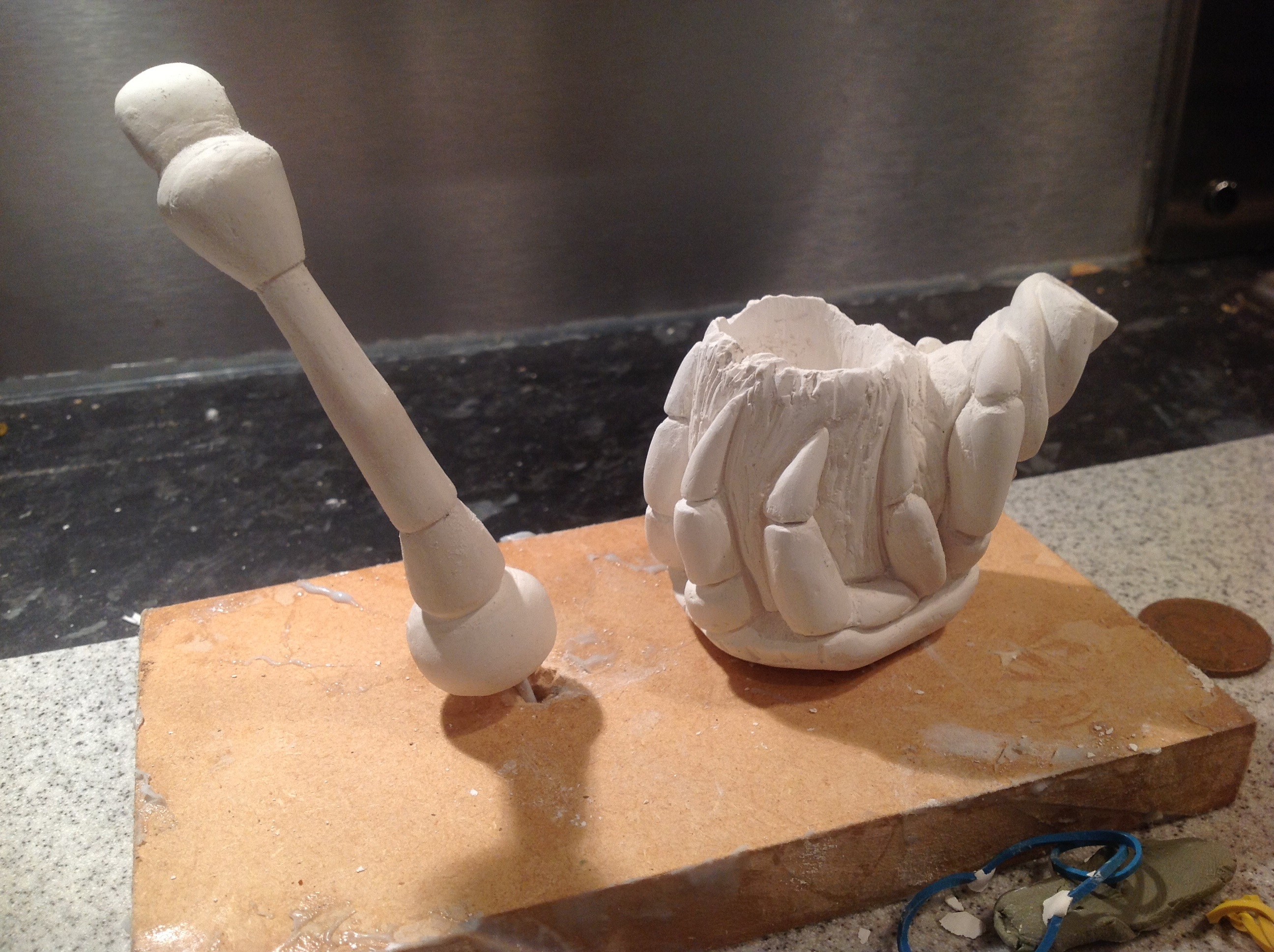

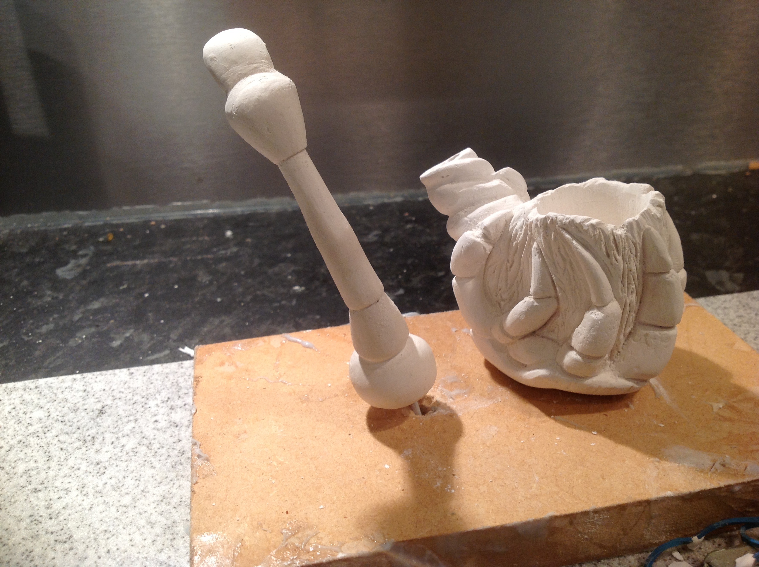

Hi guys,
As promised, here's the plaster master.
At this stage the bowl is almost finished, for making the mould.
The stem has been changed slightly, as I thought it might be a nice idea to " carve" something at the top, near the mouth, so I built up some plaster and shaped it into a "blank". I don't know what I'll do there yet, but we'll see.
The photos show both sides of the bowl, and I've also shown the bowl glowing insert with the resin cap. The LED came from an electronic tea light. Looking at the photo, the glow is slightly too yellow, so I'll paint the resin down a bit for a more tobaccoish glow.
Comments welcome as usual.

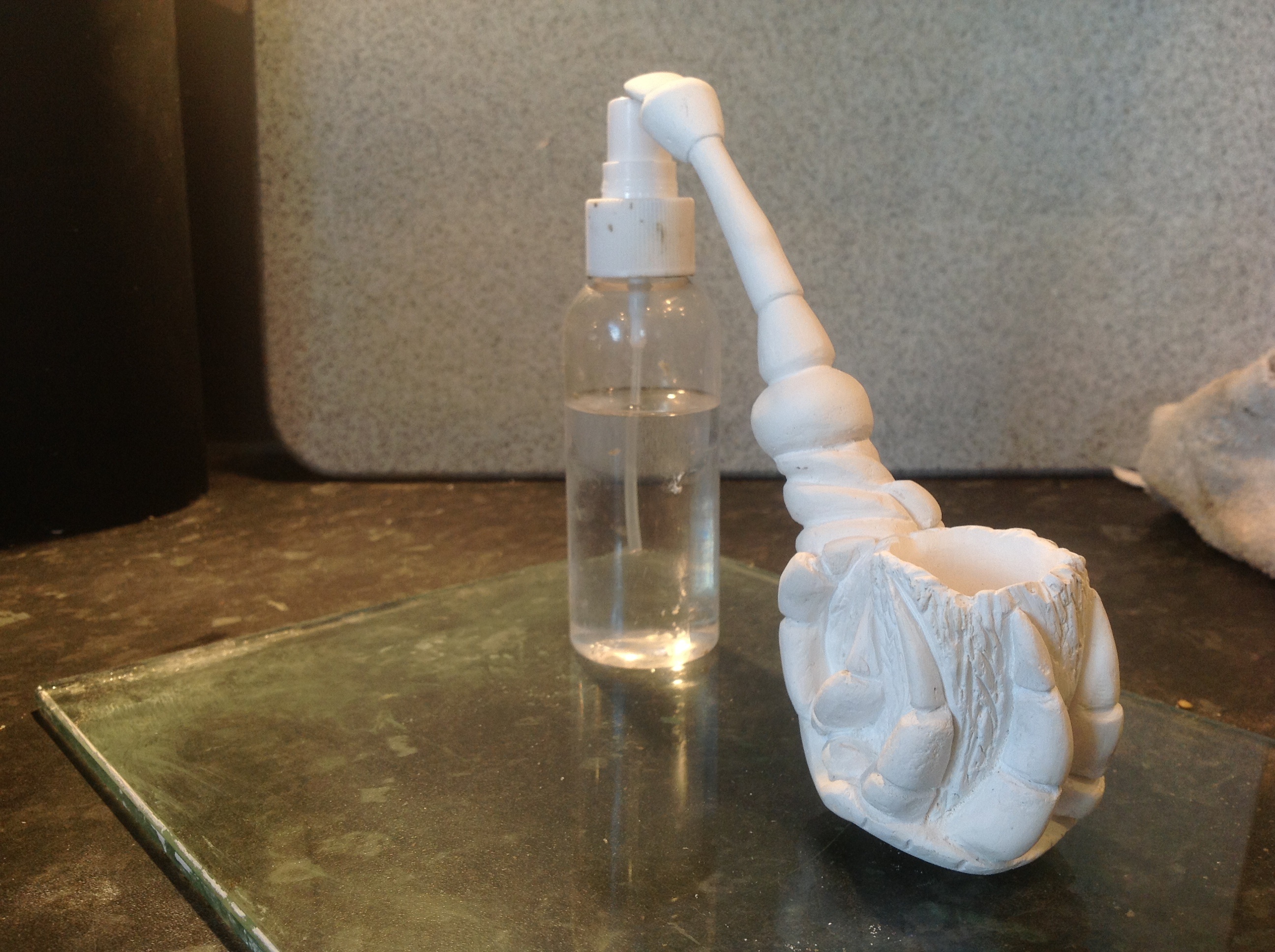

I just thought I'd put a wee photo of the finished plaster master, before making up the final mould

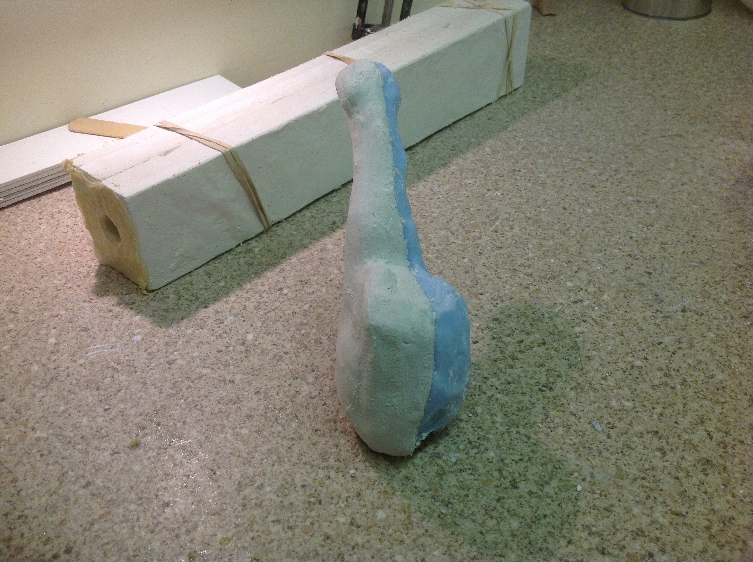

Just a wee update of the mould stage.
The pic shows the silicon mould, and the first half of the plaster bandage support jacket.
When it's all mad and hard, I'll use a scalpel to open the silicon around key areas, to reduce the flash removal and prepaint dressing.......
I hope :facepalm
I won't post the rest of the process, as most of you will be familiar with it, so hopefully the next post I put up should be the first cast
