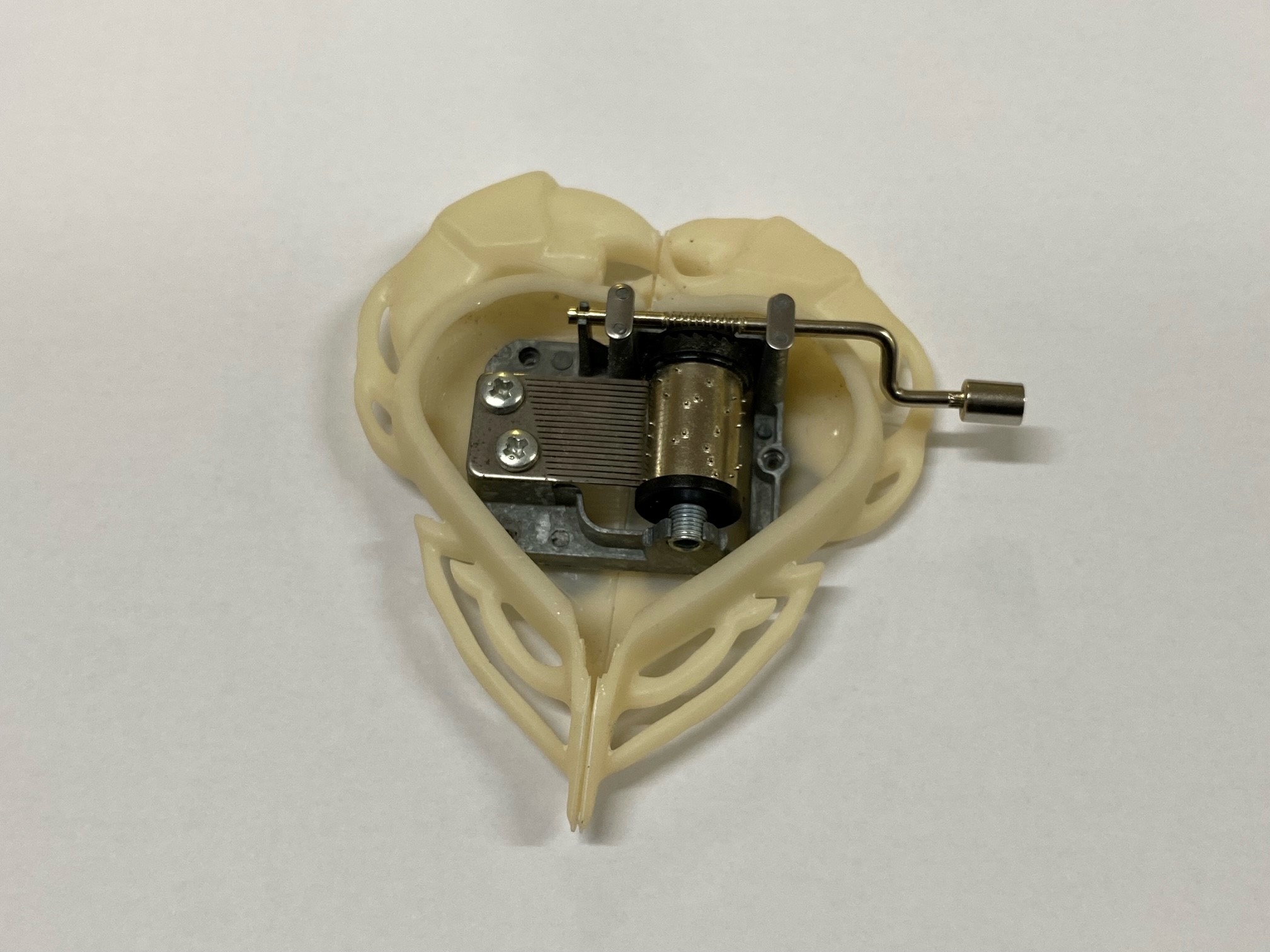

Once I'd freed the mechanism from its tiny plywood bonds, I got to measuring and found that my mechanism was way too large for a direct recast of my Tia Dalma locket, but after looking at reference I noticed that the Davy and Dalma locket props were actually different sizes, This image from user Purgatori on DeviantArt shows a few screen used props from Dead Mans Chest on display, and two different sized pendants, with Jones' being significant larger. This was fantastic to see as that meant i could still keep it relatively accurate to the screen prop.
I'd originally intended to sculpt this locket from scratch using the MR one as reference, but after a little searching online, I found an STL for sale for a couple of bucks, and bought that instead. An hour or so of dicking about in 3D builder and I had the file tweaked, hollowed and split, ready to print a prototype on my Photon S. 4 hours later, some superglue and sanding, and I can get to the good bits! PROGRESS PHOTOS

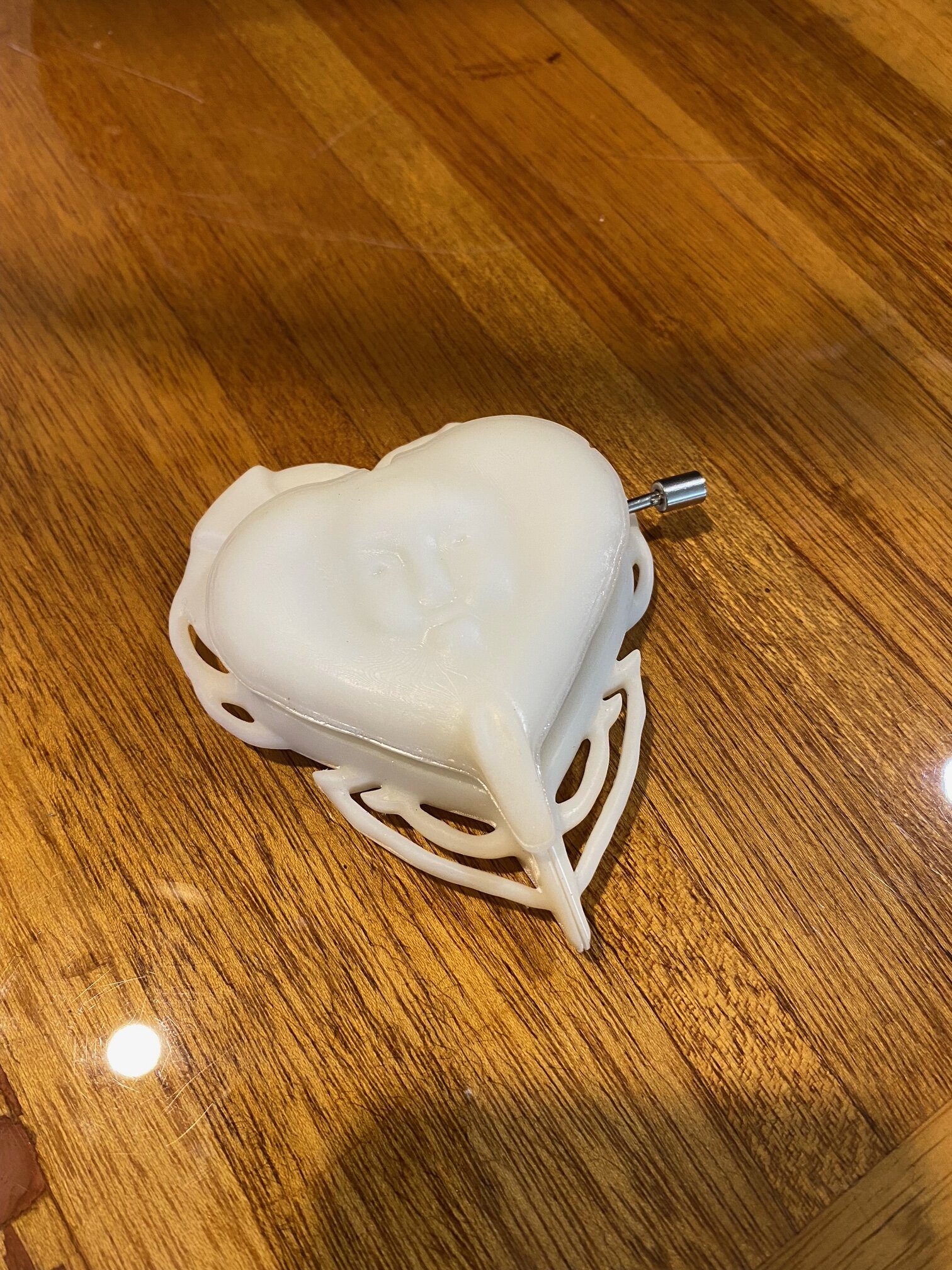

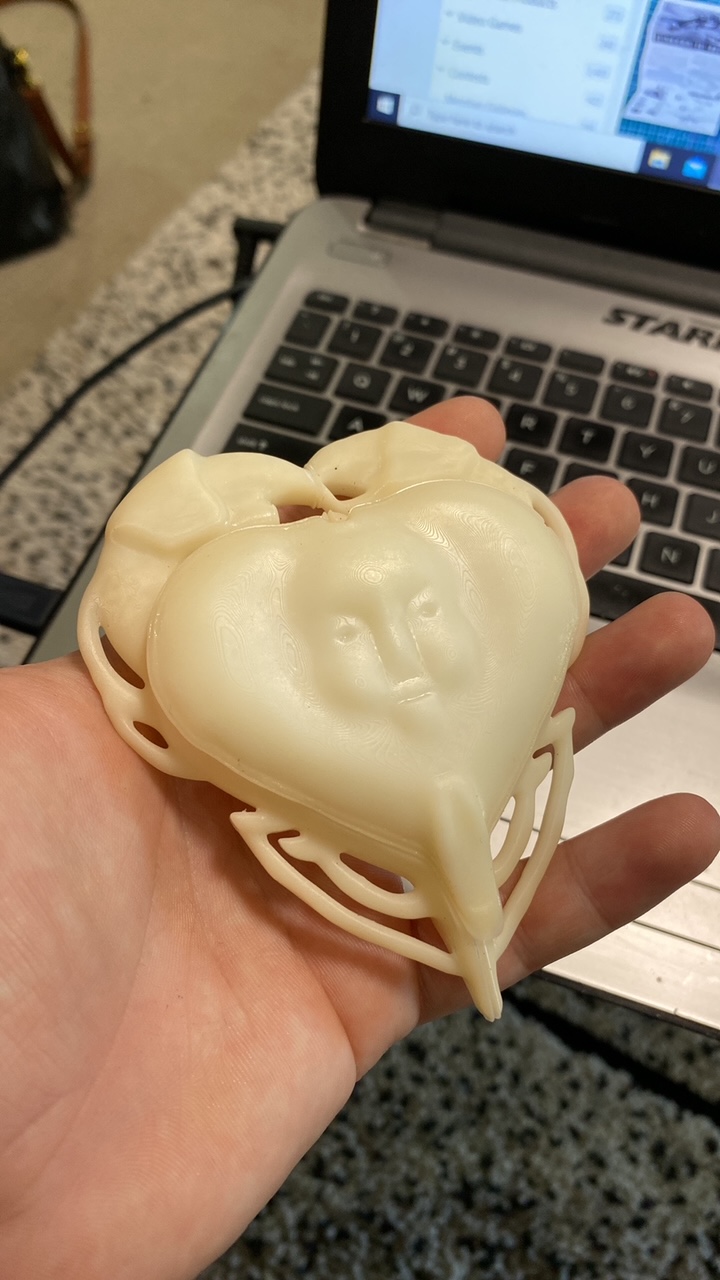

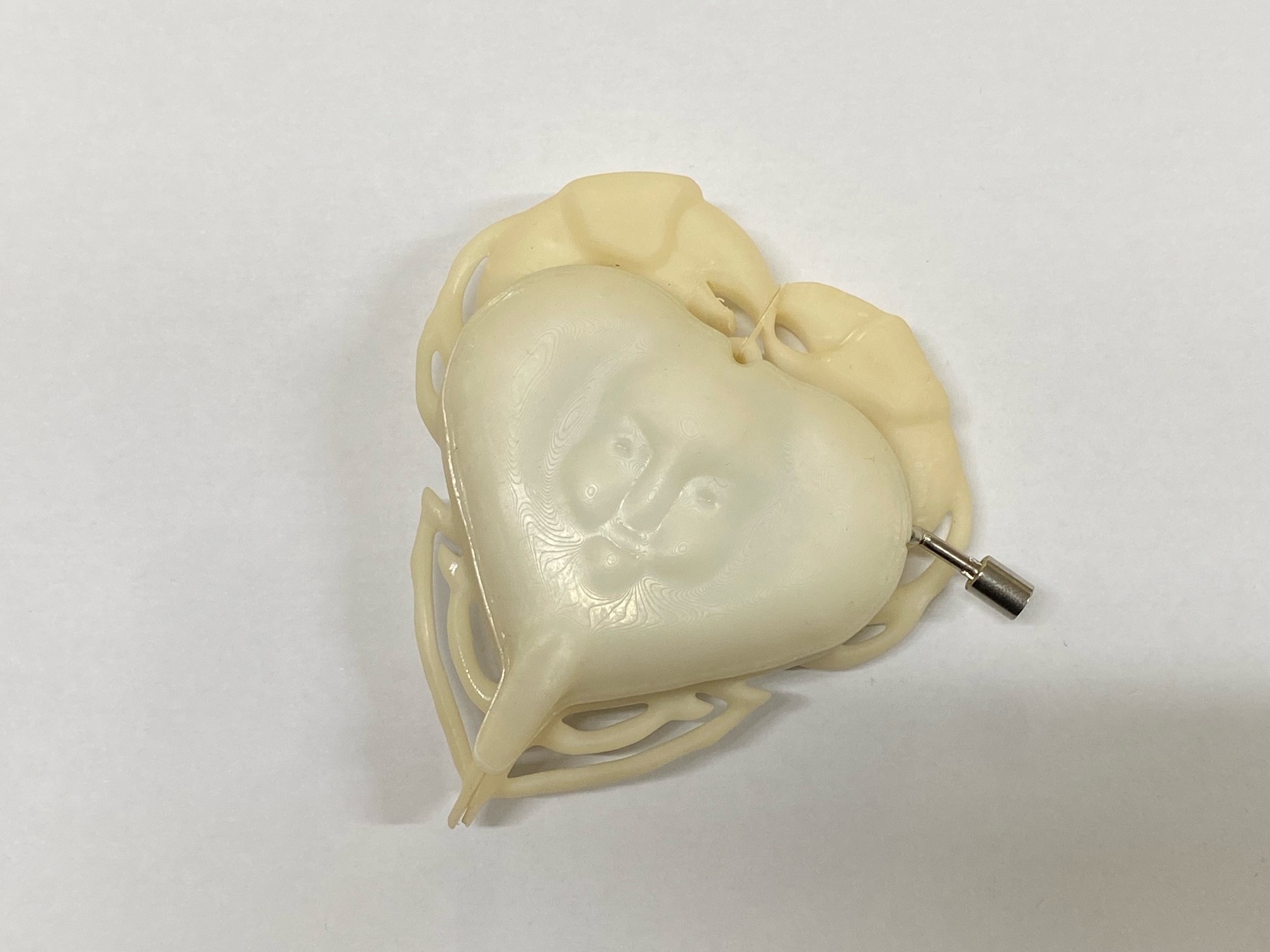

I had a small print failure on one of the crab claws, but this model still needs a little tweaking so no harm,no foul on that. Overall the size is roughly 135% of the MR locket, but most importantly, the mechanism fits! It'll need slight tweaking and shaping to fit flawlessly, but this is a huge win. One thing I didn't account for on this first prototype was the depth of the locket, which needs to be increased another 10mm or so to allow the lid to close, thankfully that's an easy fix
Here's a comparison to the MR Locket, and a shot of it in all its empty glory. Up next is printing the updated prototype, and then the really fun part begins, Casting a silicone mold to run my final pieces in pewter. That's right, this music box is gonna be Heavy Metal Baby!
And finally, just because I can..... here's a video of the resin locket, playing the tune like it should. This makes me incredibly happy.

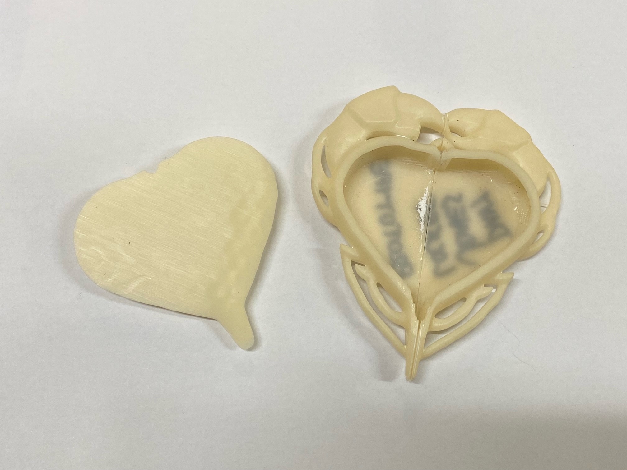

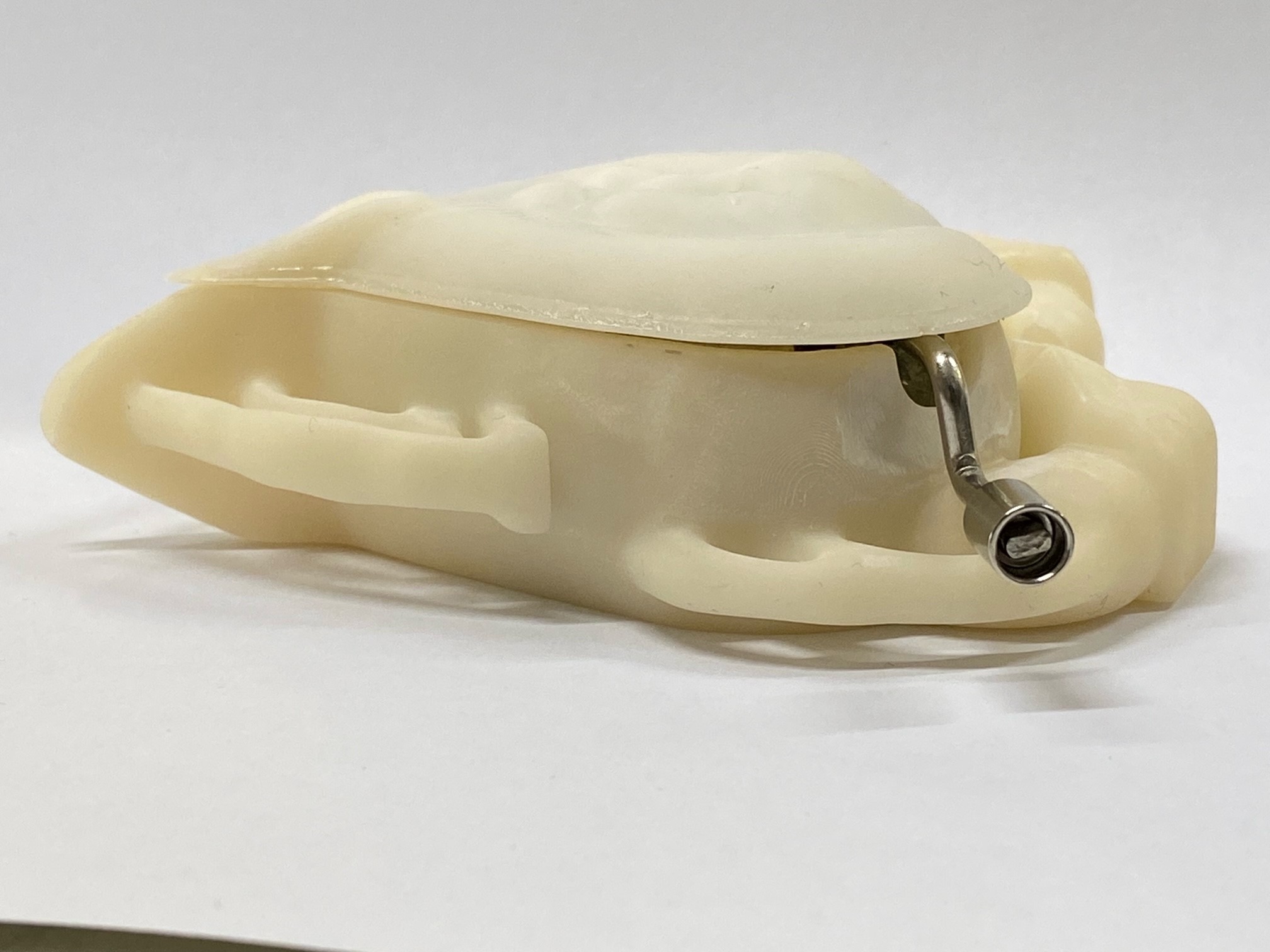

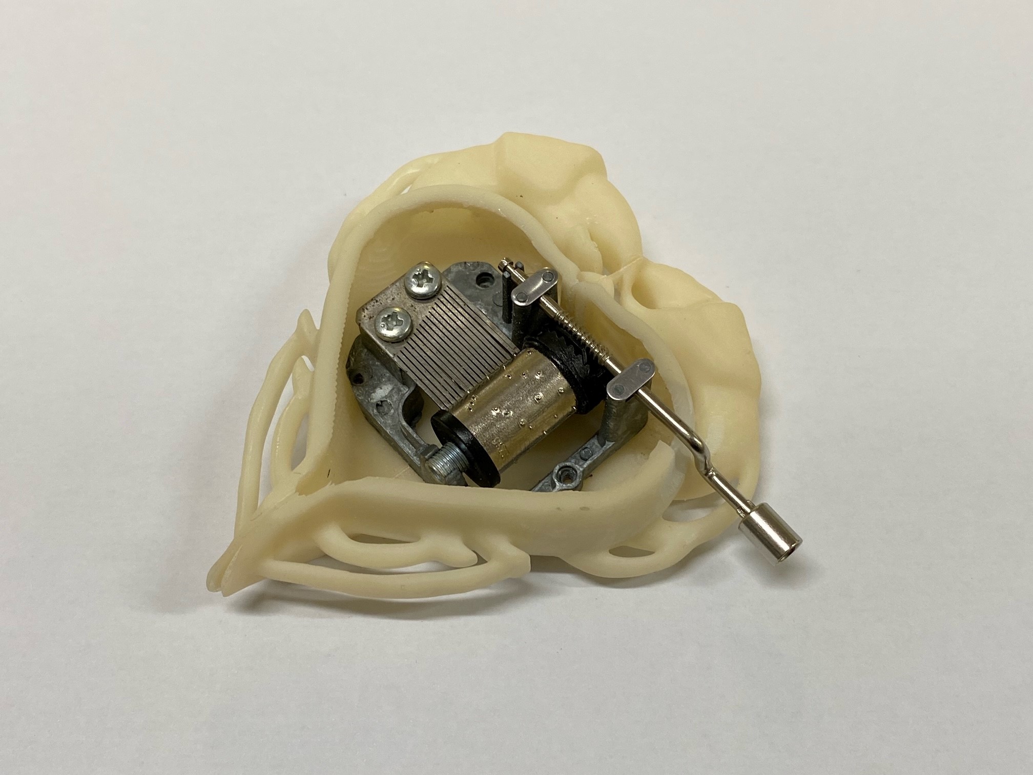

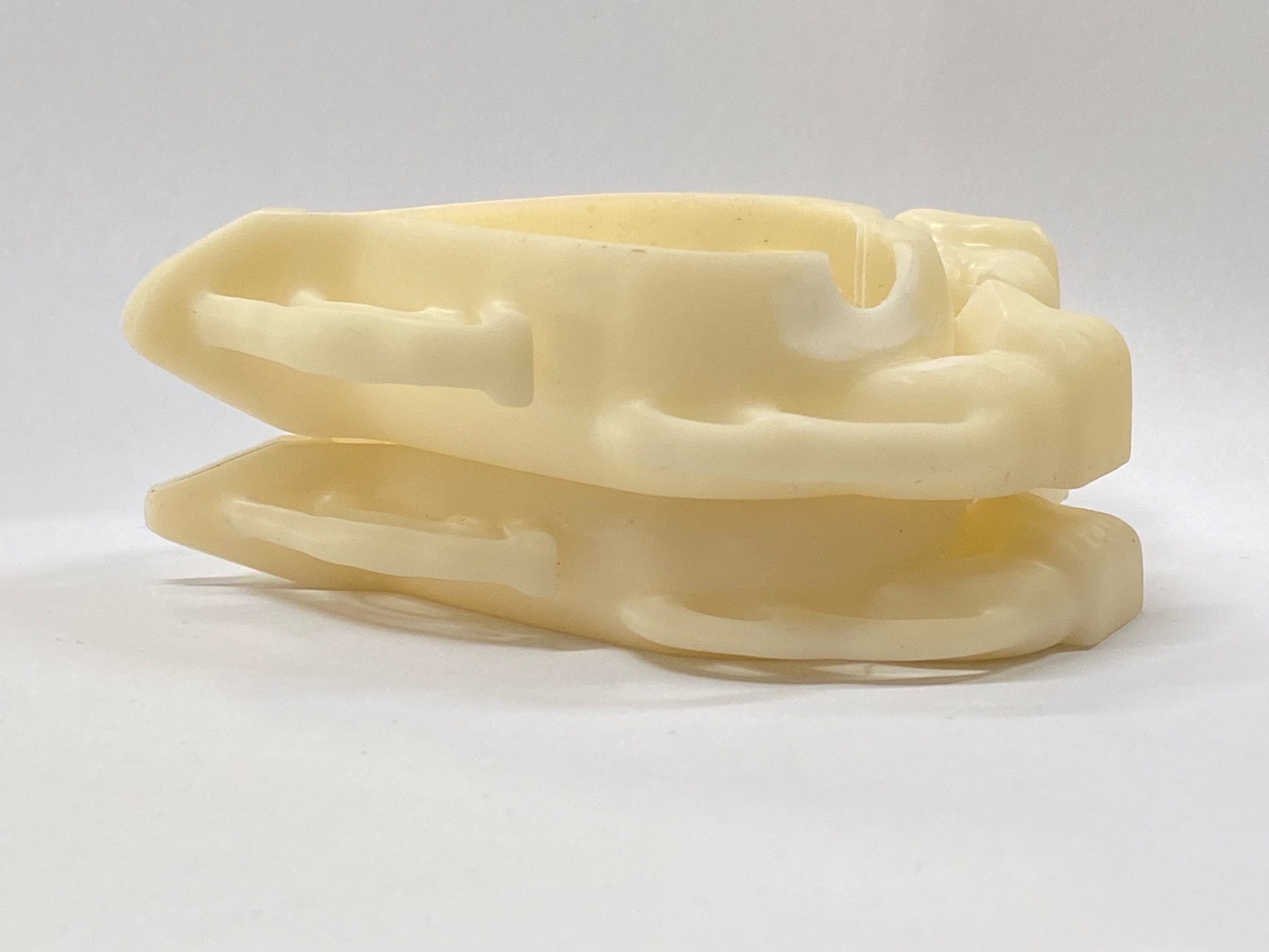

Well, after spending some time with a pair of digital calipers, and making my robot print an altered set of parts, I had one chonky locket base. I'd decided that instead of increasing the overall dimensions, i'd just beef out the thickness to accomodate for the mechanism. This test print os a little flawed, but it gives me a chance to test some ideas and work out some kinks!
Holy balls, it fits! Now, a downside to this, it has made the body of this locket feel significantly thicker. The original body was just a hair under 15mm thick, but to compensate for the mech its now 22mm thick. 7mm isn't much but I can't help but think it makes it feel a little boxy as opposed to lockety. Here's a bit of a comparison, original body vs the thicker one.
Now, I've got a couple of directions I can go....
1. Do nothing and use this "as is"
Two. Use this thicker body, but shave down the crab legs to appear thinner (Height wise) as well as contouring the underside of the body to make it FEEL thinner in the hand
C. Rework the 3D file from scratch to adjust for these issues. (I'm not a 3D modeler, so this is way less desirable an option for me)
Option 2 is my current choice, as I'm going to be sanding this body back in places prior to molding it. While it's messier and a bunch of work I feel it could also add to the "hand made" feel all of the POTC props have, plus I can continue with my original plan of attack for molding.
Thoughts? Comments? how am I doing guys?

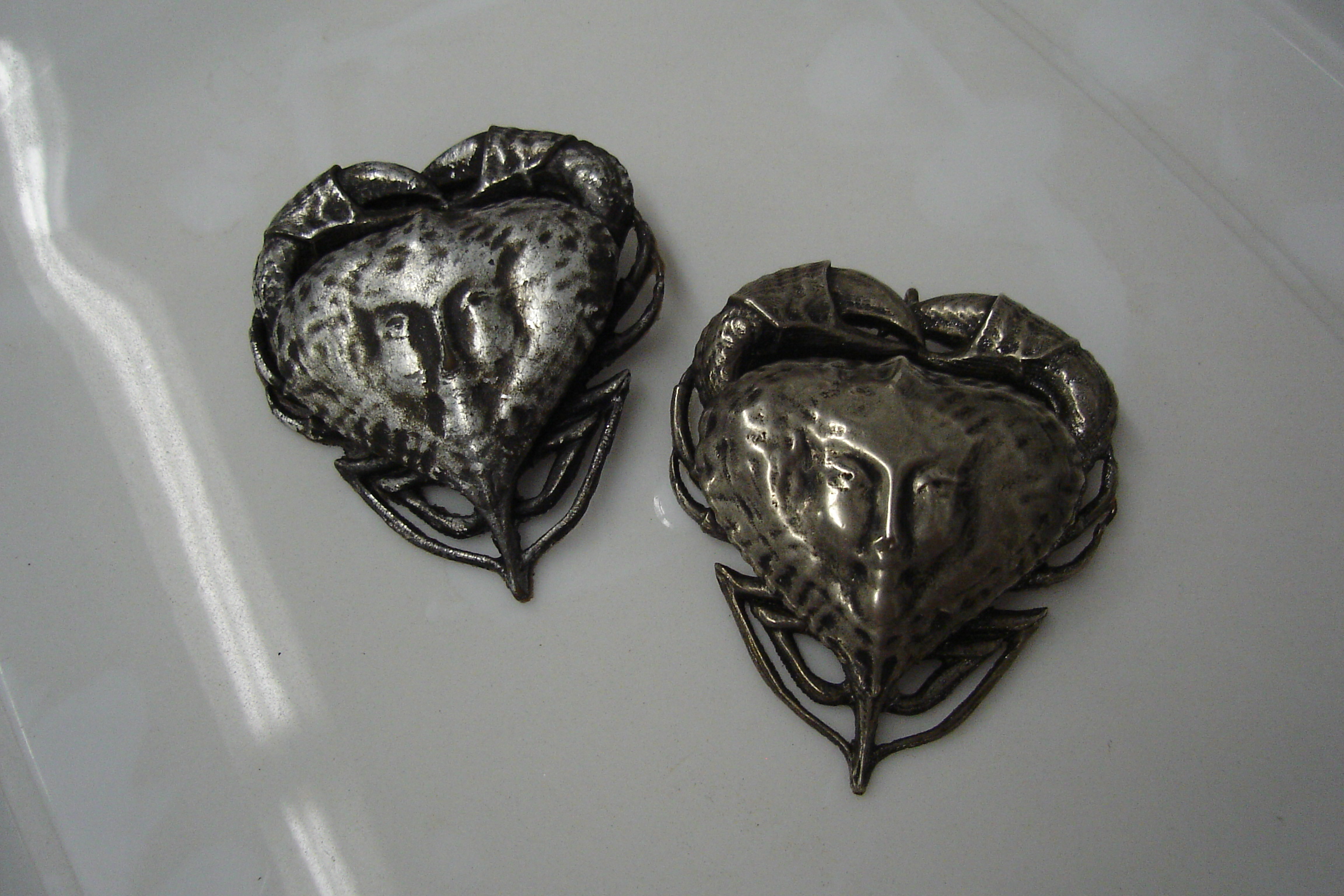

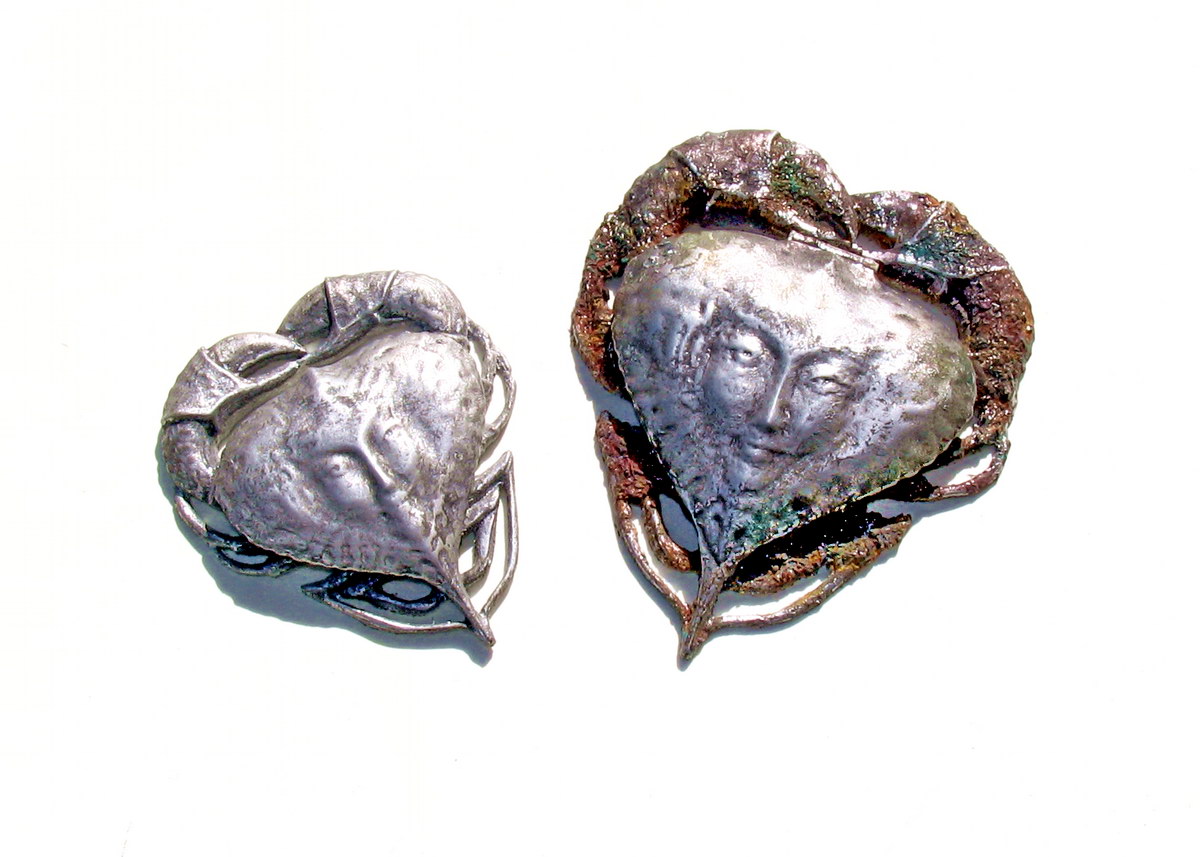

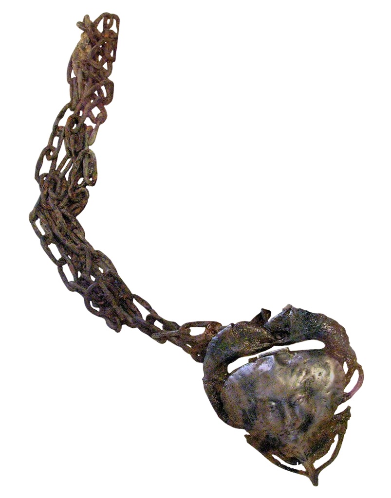

The metal cast lockets had unique markings due to the metal casting method itself. For the master used to make all other lockets some imperfections were smoothed, cleaned or filled where needed. Not noticeable really unless you eyeballed them close up in hand. There was also a unique way to attach the chains to those cast lockets which only original pieces have or retain remnants of. This was intentionally done to twart potential future fakes or pulls from those moulds being passed off as screen used items. Even the cast metal lockets had unique chain attachment methods that wouldnt be easy to fake.
The picture showing the Davey Jones locket on the slab of MDF board was when it was being moulded for the plastic castings. The picture of the Tia Dalma lockets shows the metal casting next to a plastic casting. For an idea of wear from on set water and multiple wash of doom dunkings that plastic casting was originally very shiny. In the end they were muted silver, near flat in sheen.
Lastly the photo showing both lockets together are plastic castings for a better idea of the color and sheen they had as fresh pieces.

Well damn, in a single post you've given me clearer better reference than I've seen in a decade or more. I cannot thank you enough for sharing your insight with this. The washes really give me some leeway with aging and finishing of these pieces so that's a big relief, its stunning to see how much detail was actually in these pieces. SO much that either didn't translate on screen or just was totally muddied by grime and weathering
