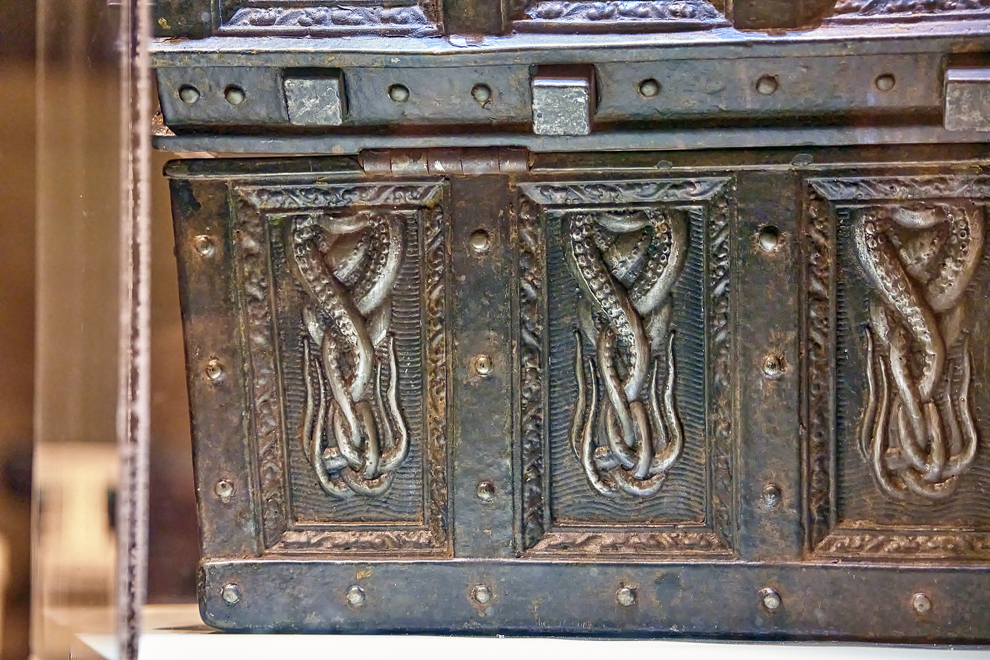

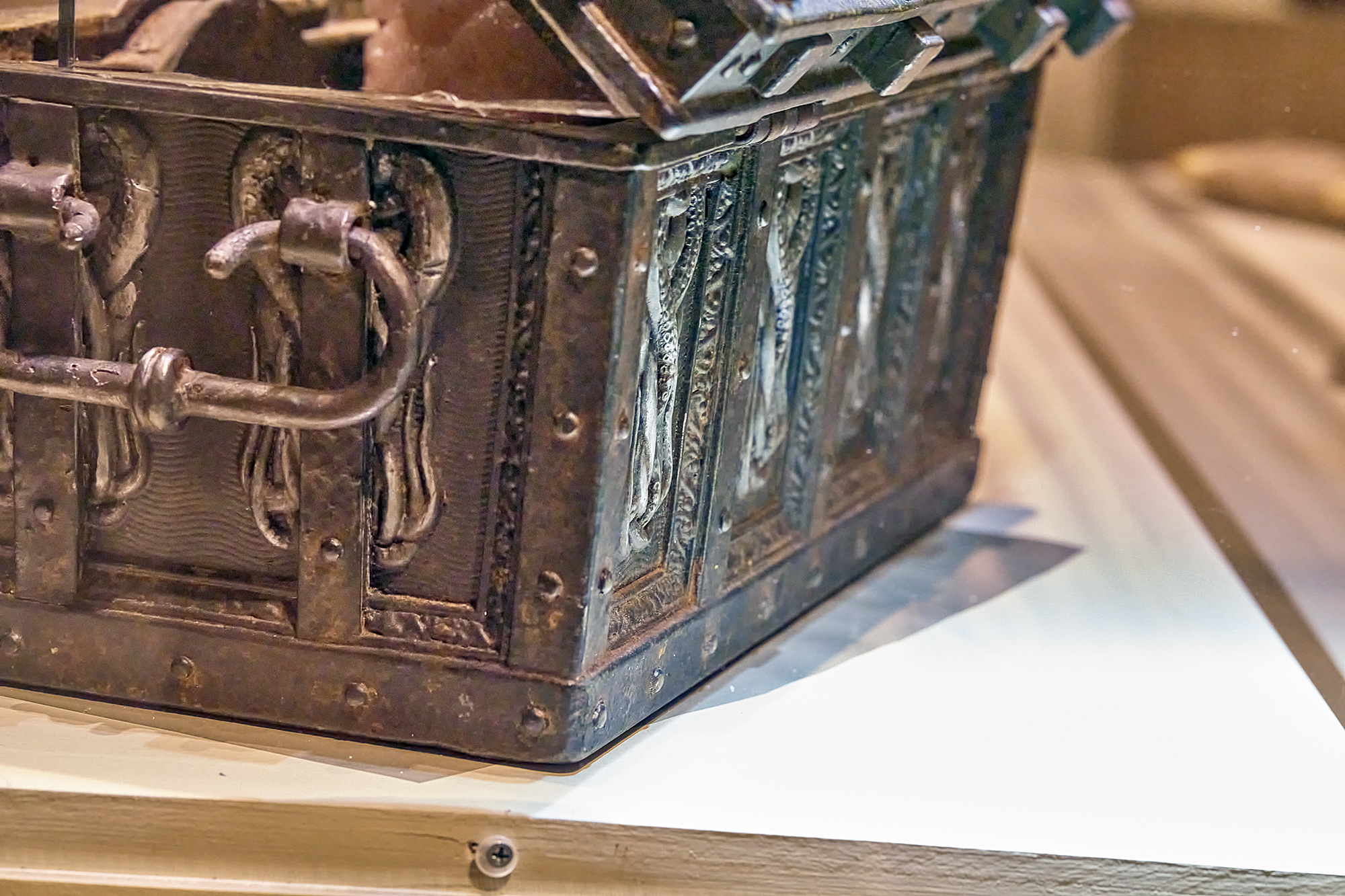

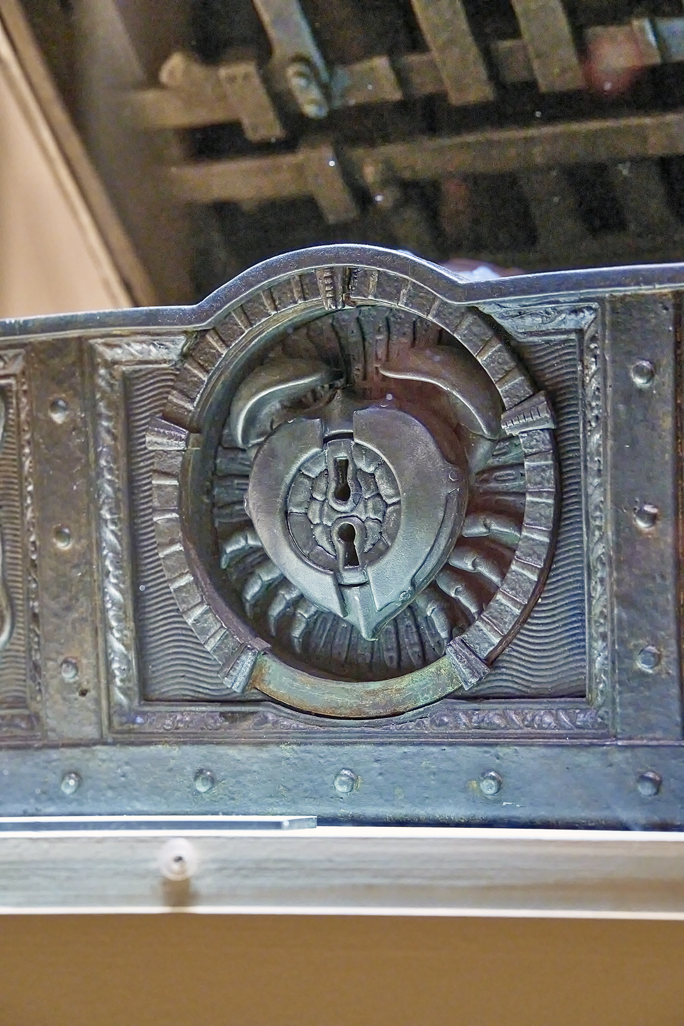

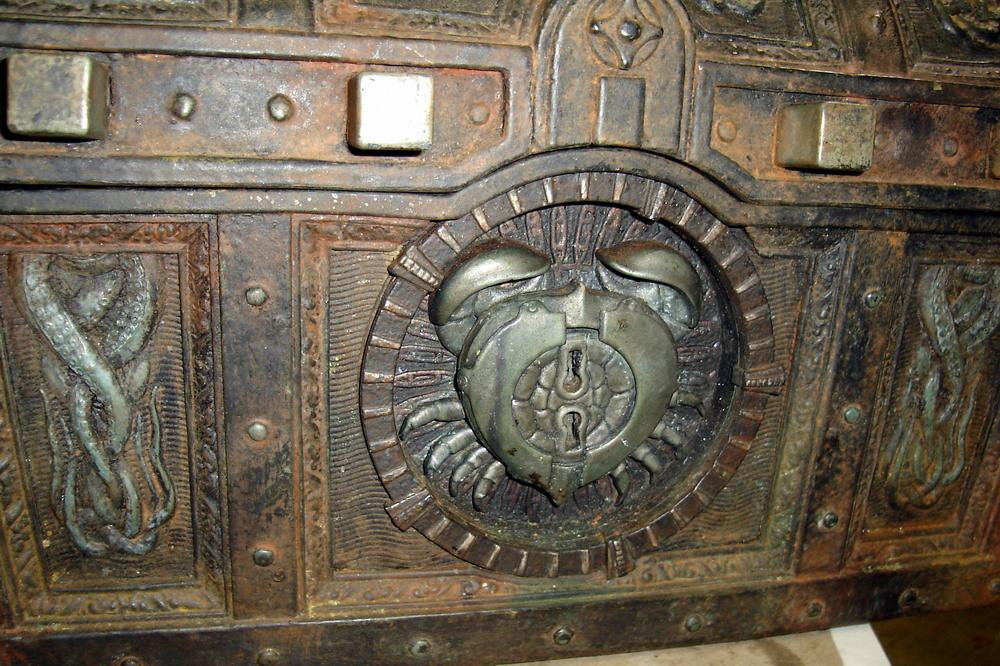

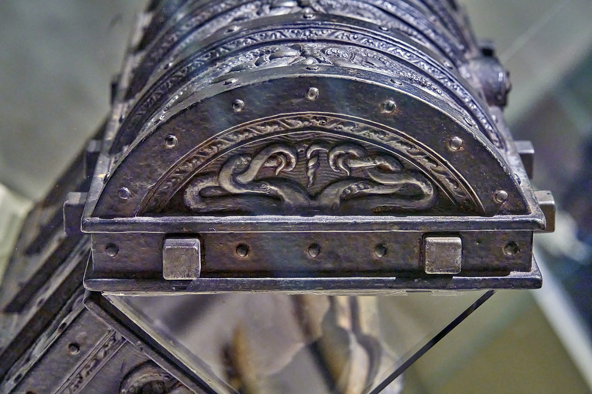

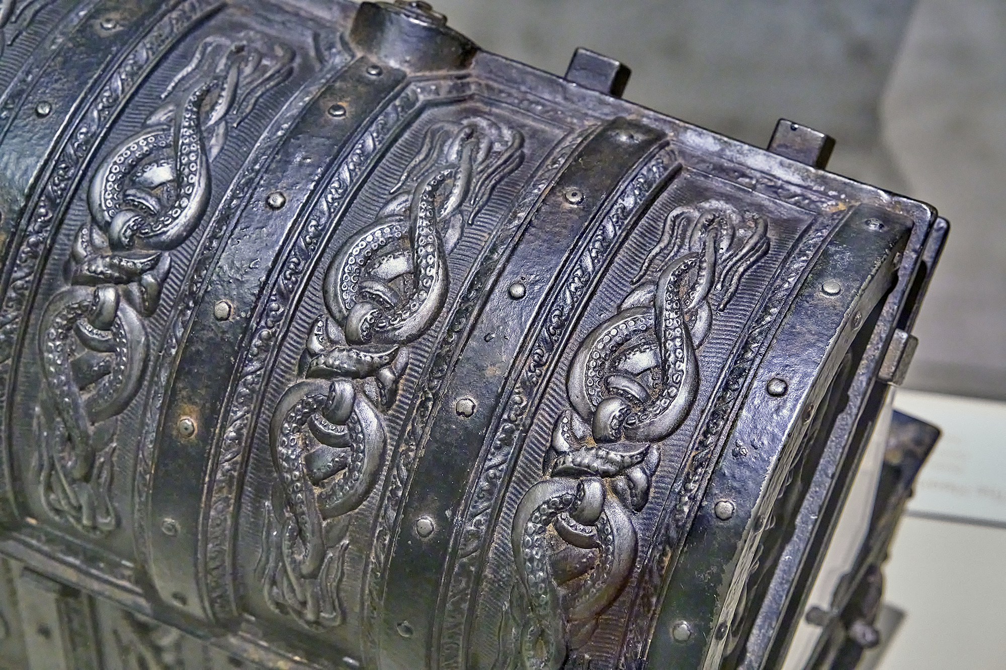

As luck would have it I took a bunch of pics of the chest on display as well, with an eye to one day modeling it. I doubt I'll ever get to it so hopefully these are helpful.

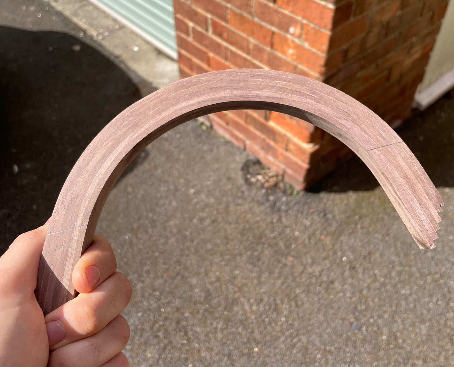

I want to make it in as 'traditional' a way as possible. Here is my very successful laminating result. This will of course be the top of the chest.

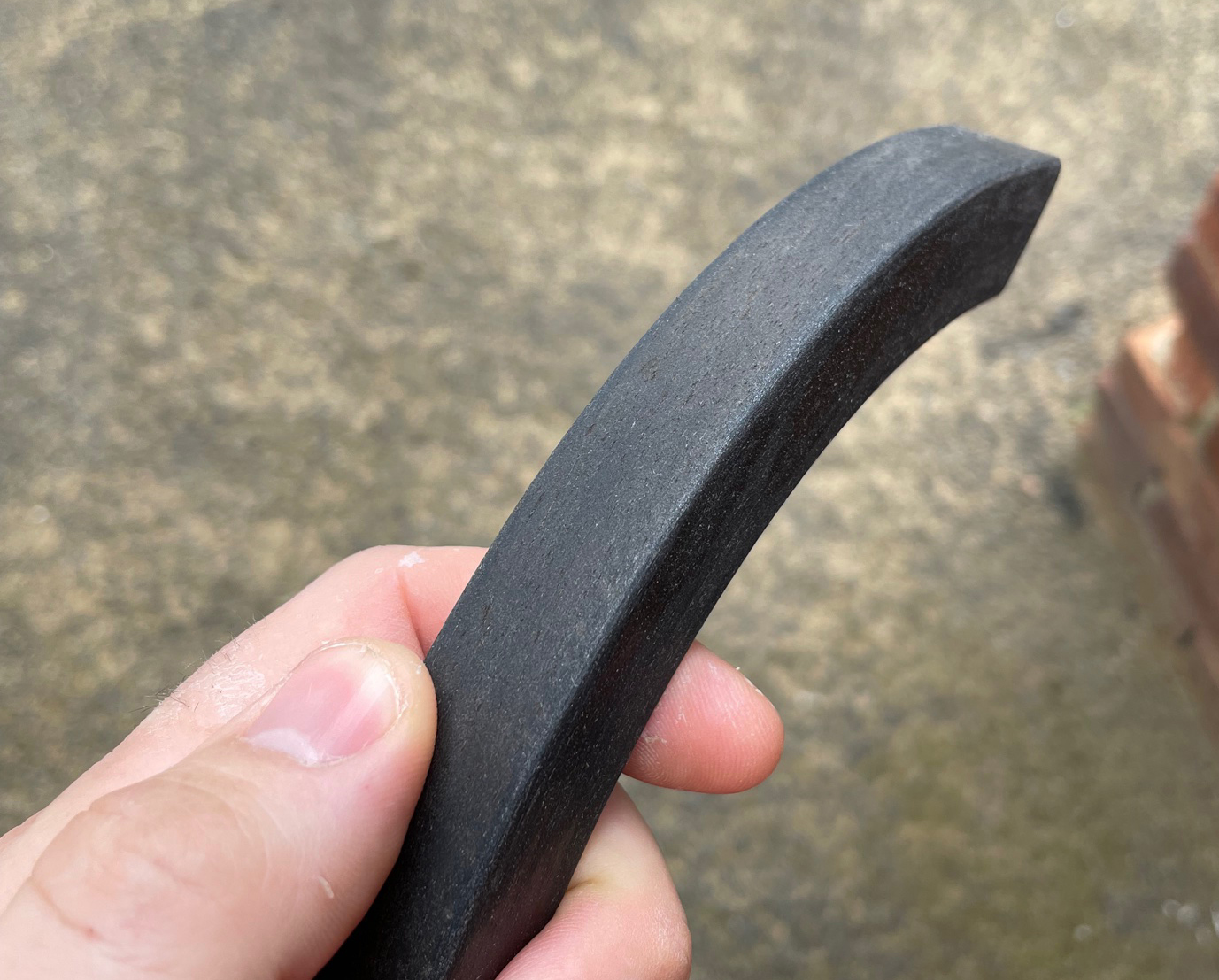

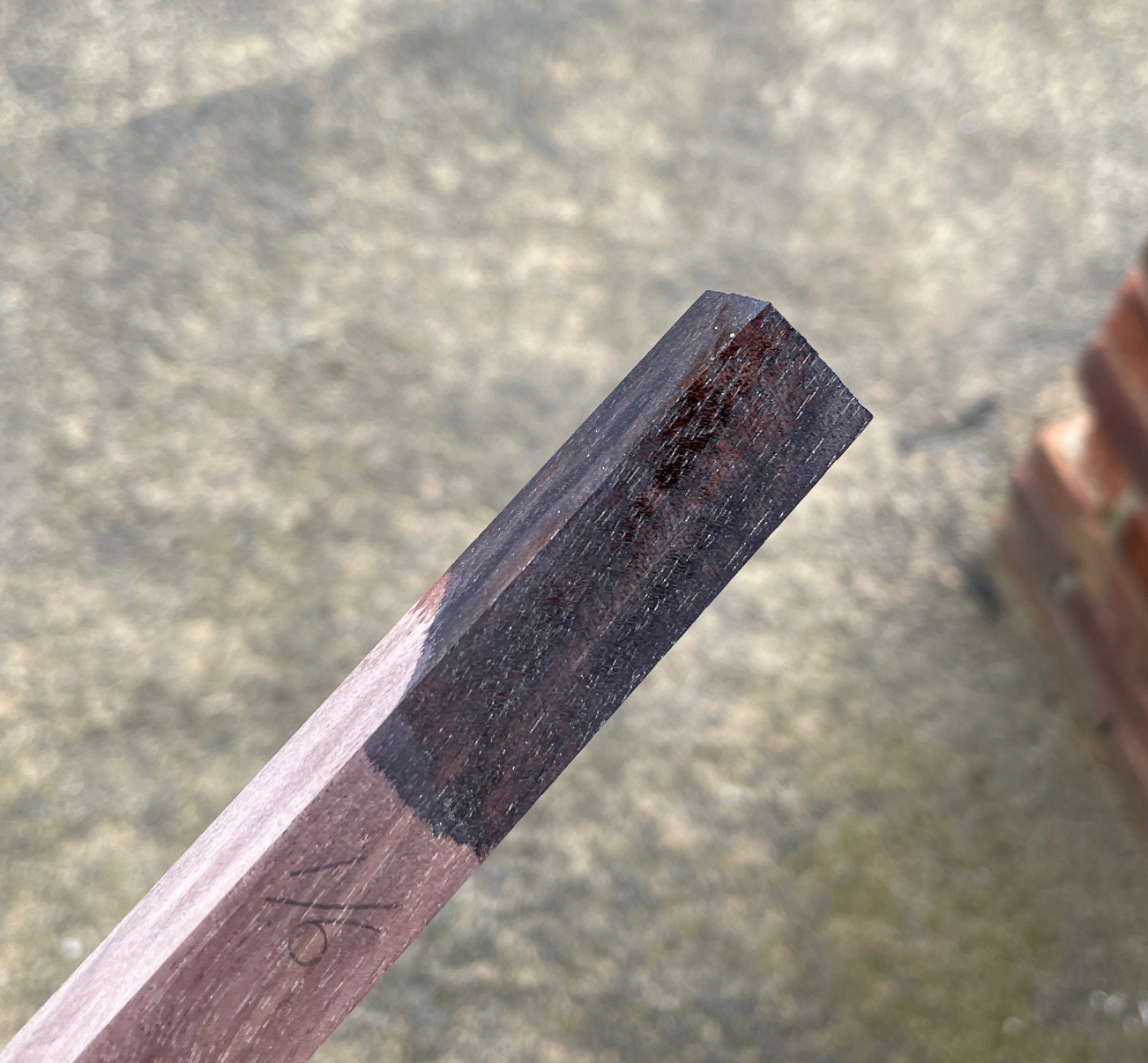

Once ebonized it looks really lovely... very hard to capture how nice it looks in photos annoyingly.
It is very black. Very black.. watching the film again and indeed looking at logan74ks pictures there are hints of brown showing through. Its not just completely black so I've been experimenting with my ebonizing liquid and I've round a ratio of 1/6 to water gives the wood that lovely black look but allows hints of brown to be seen at various angles. Again very hard to capture on photos.
Seeing it in person it gives the wood more life, more interest.

awesome results with the laminating! congrats! really excited about your work on that!
I love the lighter ebonizing :)
good luck with the next steps :)

Hmm, that looks surprisingly, (disappointingly) low quality up close. Maybe that's a 'stunt' version?? It makes my Master Replicas version look pretty close to the real thing. And it makes me very excited to see what Sevv can come up with.
To each their own - I'm a hardcore perfectionist and I don't see anything wrong with it quality-wise. On one hand yes, the MR version appears to be partially molded (or scanned) directly from the screen used. Otherwise, details on the suckers and frame filagree elements are definitely softer on the MR castings. Their textured flat elements are thicker and more heavily distressted - looks almost like deteriorating leather. They did some adjustment to the crab shapes probably for ease of draft in molding. And course it will never look right 'open' because the bolts can't pop out...

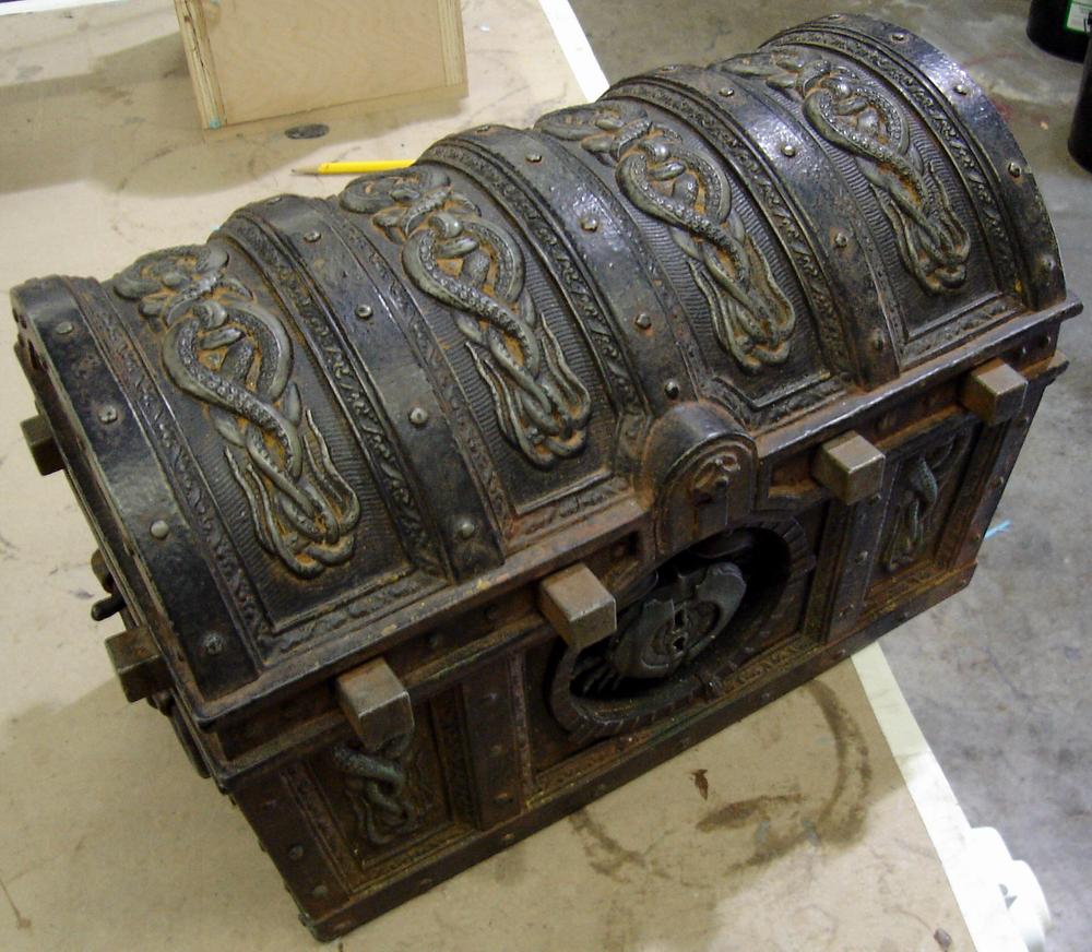

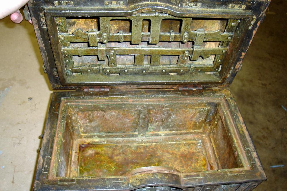

This is the hero Disney made chest the others were cast off. The one that had the heart in it, for close ups and opening. Not unlocking but being opened by hand.
