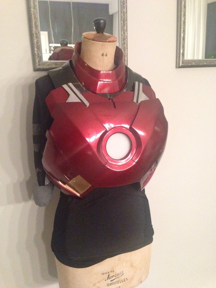

My second is directed towards JayCVenlo, what did you use to model your upper chest/neck piece for the mk 7? Did you use a pep file or did you just do that from scratch?

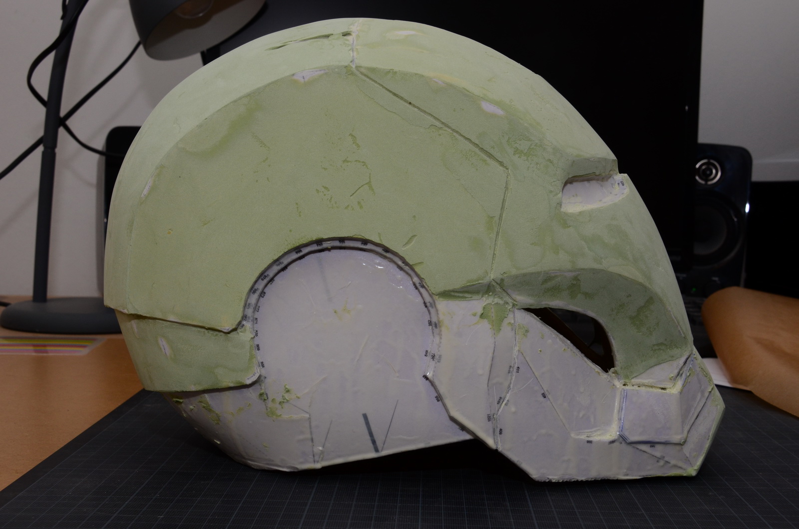

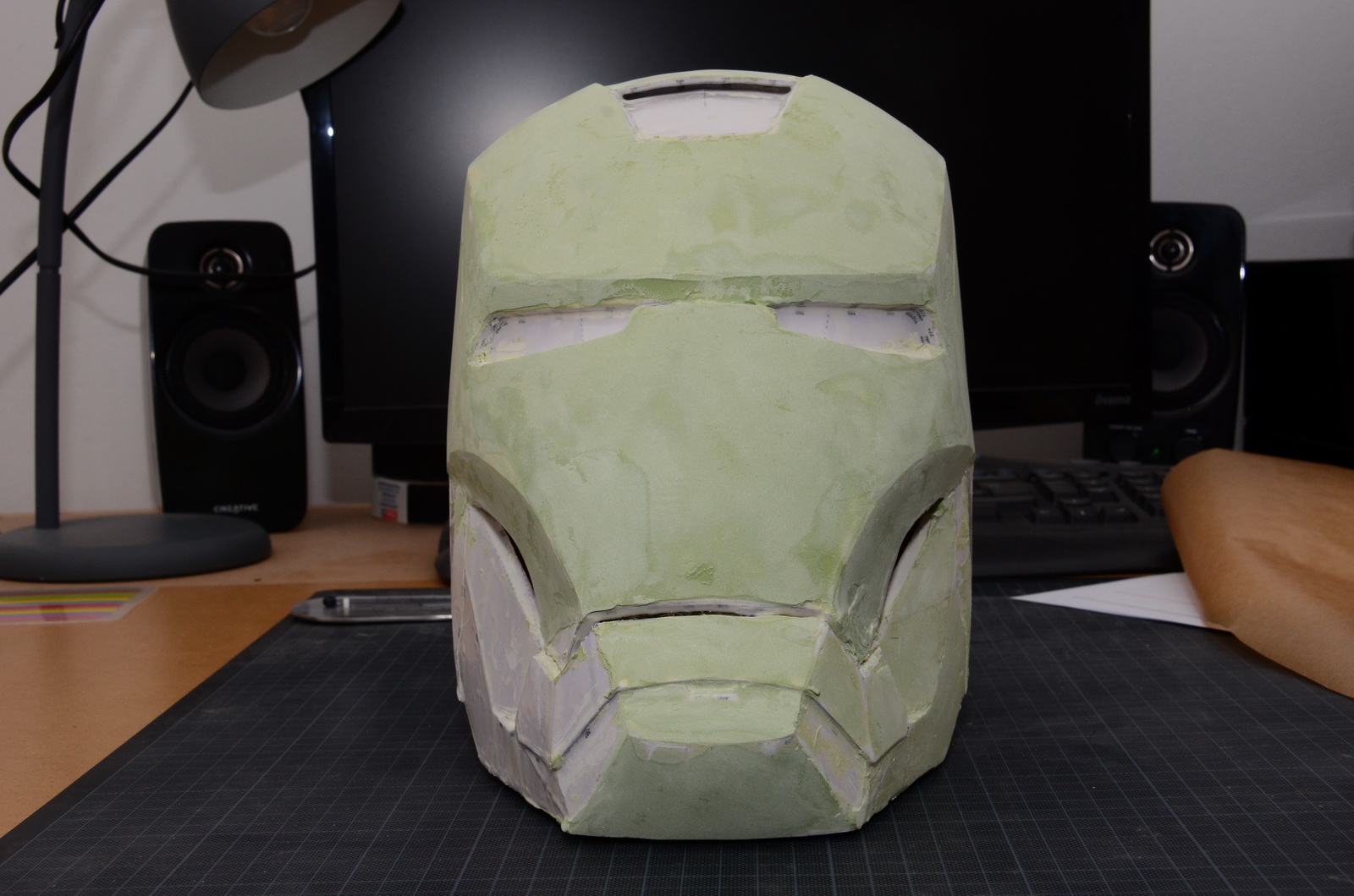

Long time I haven't posted here! I'm working on the helmet and I'm going through it smoothly.
Its mostly Omarbous. But i did a lot of slicing and customizing to get it the way i wanted.
I made the black part (brace) completly from scratch.
The trick is to first make a frame out of aluminum strips 1cm wide, 1 a 2 mm thick. Bend 2 stripes (left/right) that fit over the curve of your shouldes from front to back. Then connect those 2 with a horizontal strip.
Hope this helps a little.
