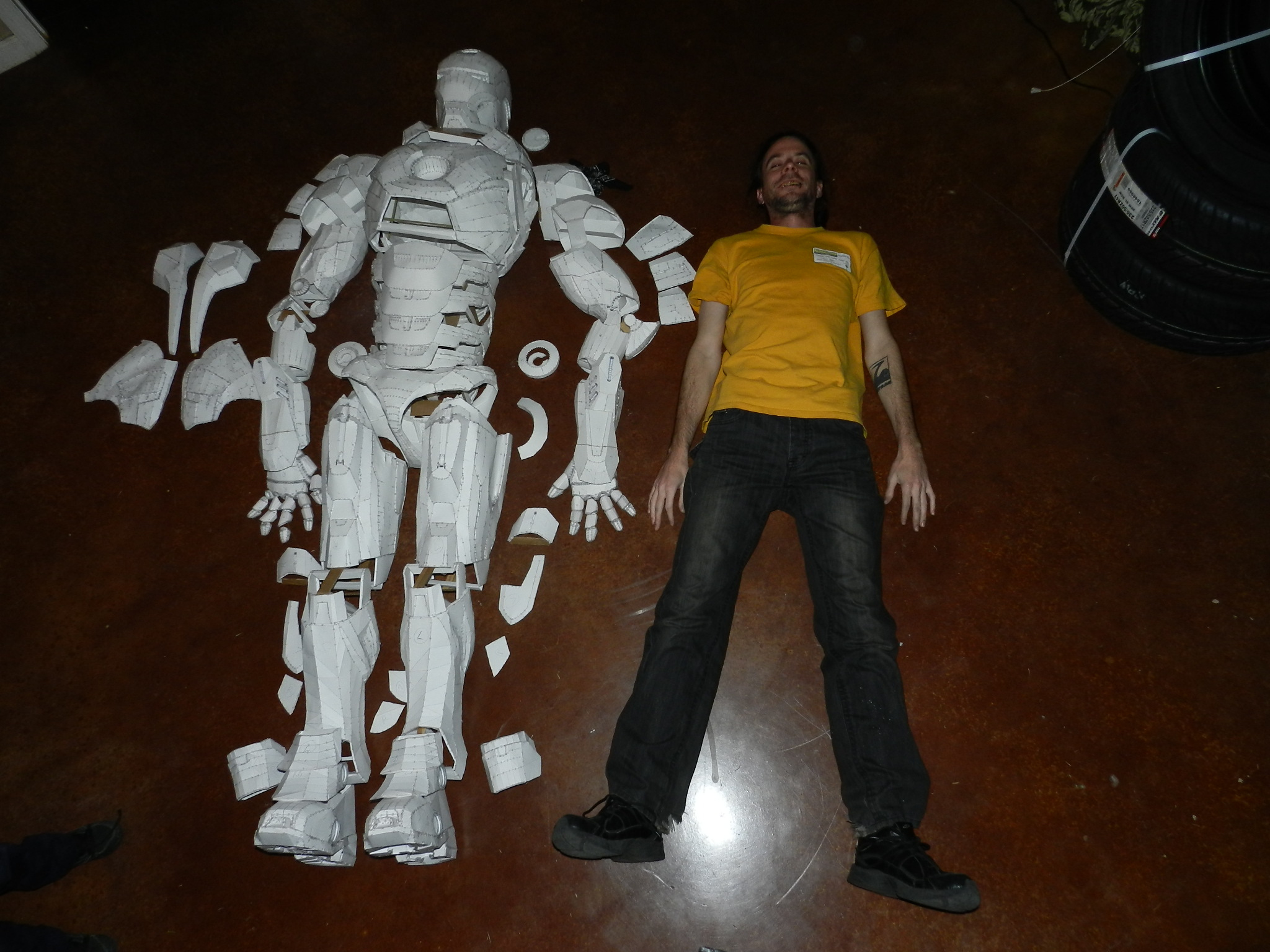

Finished with Pep, working on fiberglassing now, figured I would show and update... DSCN9693.JPG
I've been documenting everything, down to the time...have to add it all up, but here's the link to pictures of the entire process from start to present...if anyone's interested....

Finished with Pep, working on fiberglassing now, figured I would show and update... View attachment 290112
I've been documenting everything, down to the time...have to add it all up, but here's the pictures of the entire process if anyone's interested....
