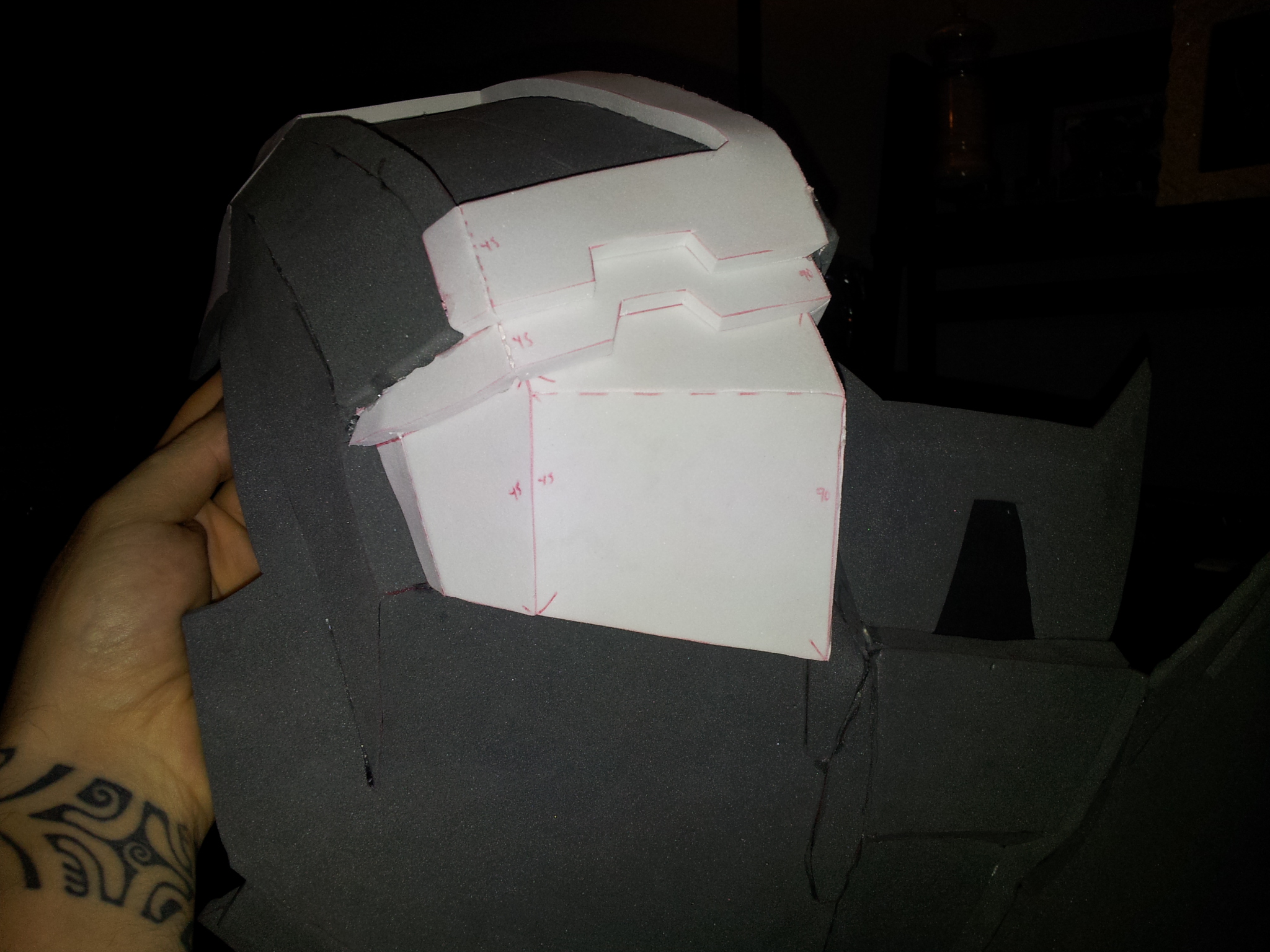

Left shoulder is done. Recessed the top so I can make missile warheads.
