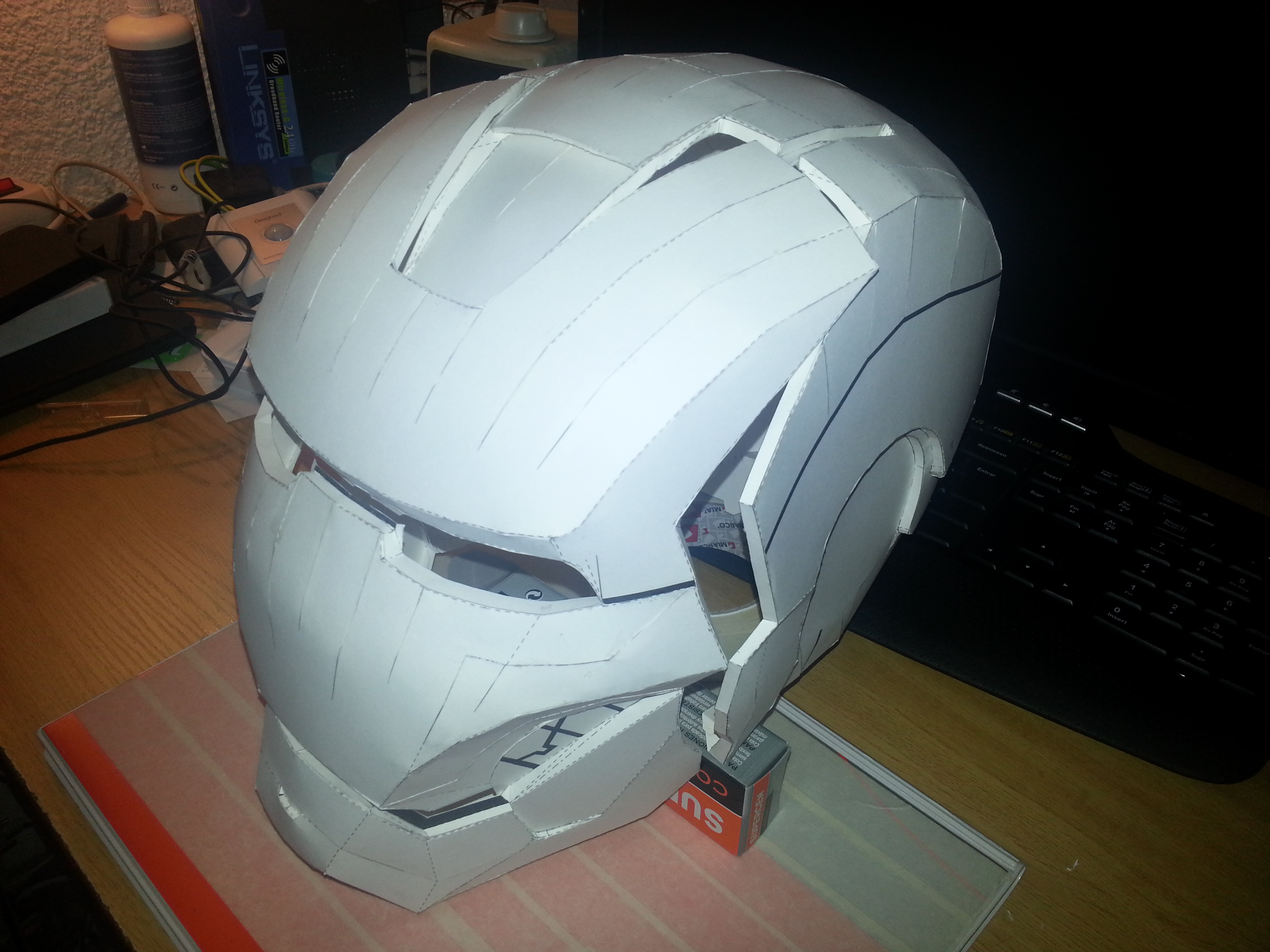

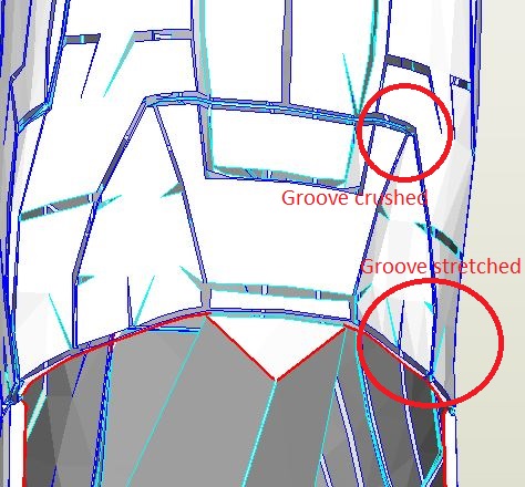

Damn...those thighs give me nightmares...The second I throw away. I can't align the pieces correctly, the grooves mess up everything, I'm too short on a side and too long on the other side. I stop for today, too pissed to do anything good anyway.

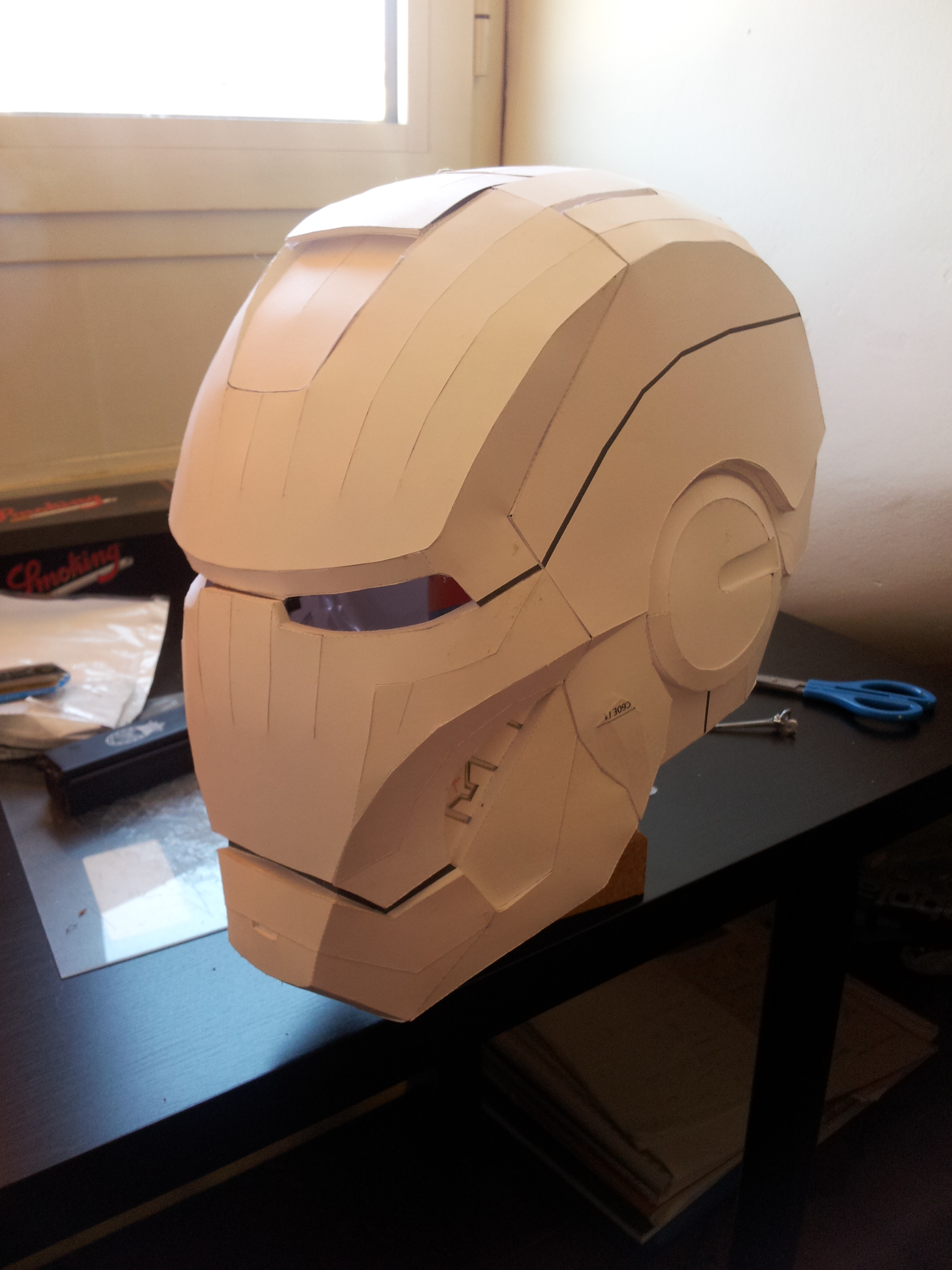

Just completed the helmet, i used the tabless method and it really is much much smoother already! I think it's worth it because even if it takes longer to pep, is going to save a lot of time in the filling/sanding stage!
I also decided to make the "teeth" out of cardboard
Anyway here's the pics
Going to fiberglass it now
Thanks again Darkside!

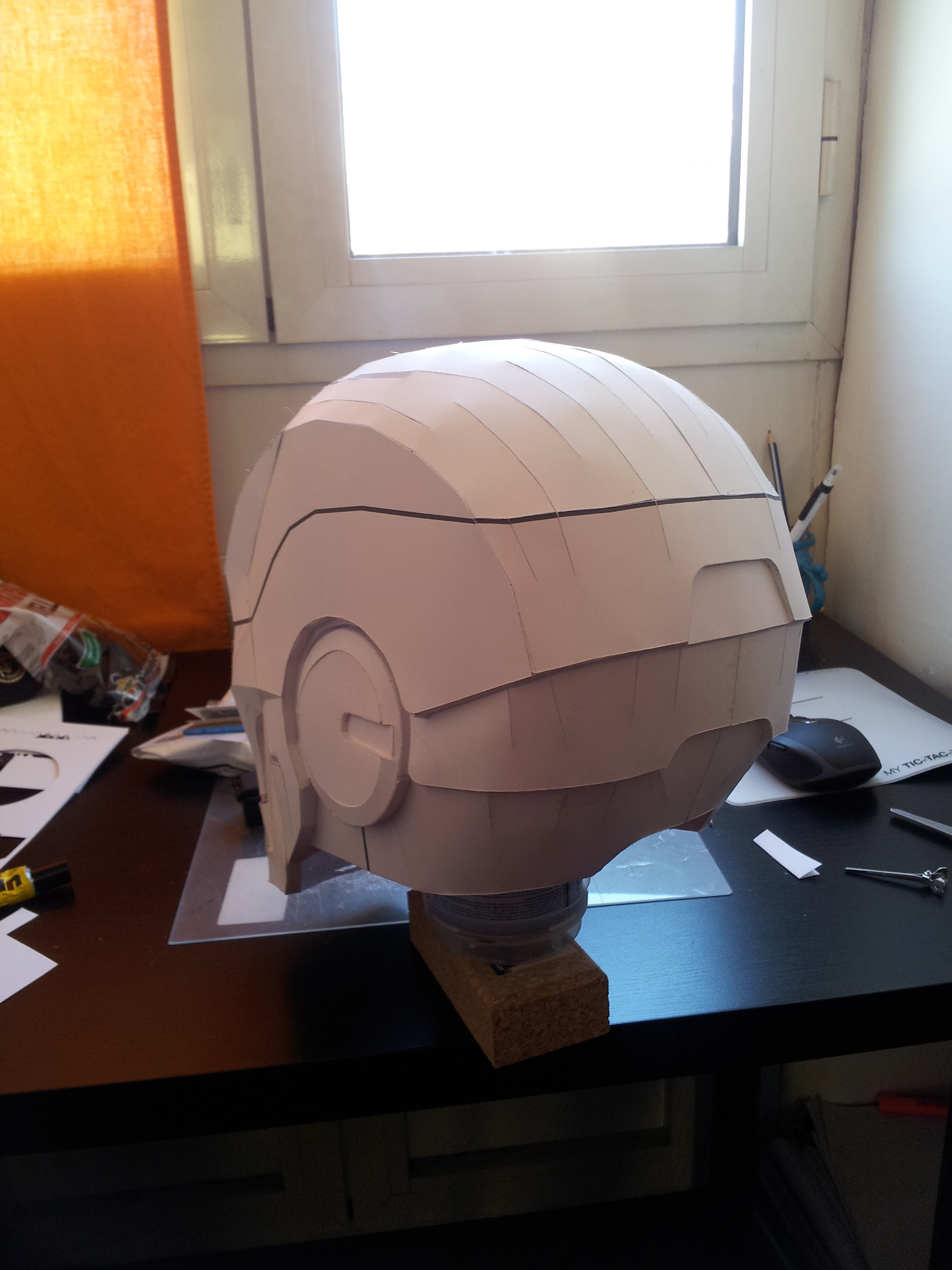

much cleaner than mine!
I still have to join the three parts of the helmet, but I plan to leave it without ears until the bondo part.
So, is this the best way to built the helmet?:
  1. Glue all the pieces of the helmet (except the ears, so you can apply fiberglass to them in the inside)
  2. Apply the resin on the outside
  3. Apply resin and fiberglass in the inside
  4. Sand
  5. Glue the ears
  6. Apply bondo on the outside
  7. Sand
  8. Cut again the three pieces of the helmet
  9. Sand
  10. Correct this cuts with bondo so they are clean and nice
  11. Sand
  12. Apply the primer
  13. Sand
  14. Paint
Is this right? or have I missed something??
Thanks!
EDIT: I also plan to put a strap of paper (folded in a "V" shape) on the inside of the helmet, following the black line where later you have to cut a groove with the dremel, so the fiberglass won't be cut... I don't know if I'm explaining myself, but I will put some pictures later :D
View attachment 185223View attachment 185224View attachment 185225
Looks great! Good job.
  4. Sand
  5. Glue the ears
  7. Sand
  9. Sand
  11. Sand
  13. Sand
  14. Paint
Thanks!
Yours looks good too... you just have to clip the separate parts together. You have the right idea with the process but you have to insert a whole lot more of the 'Apply Bondo' and 'Sand' steps. lol
I wouldn't bother with the cardstock folded in a v shape. You have the right idea though. I would just lay down a couple extra layers of fiberglass cloth cut into strips along the line. Once you build up the bondo you will barely go through the cardstock anyways.
Wow it looks awesome :) Can i ask what you mean with tabless method ?
And what gram paper did you use ?
Thank you!
The tabless method was discussed in this thread some pages ago, and Dakside as a video explaining it very well on his youtube, however basically it means the you don't use the tabs from the pepakura model (just don't cut them and instead cut on the folding lines) and then connectthe parts using a strip of cardstock applied behind the two pieces. It is very useful when dealing with smooth surfaces like in the faceplate for example or any other part where the two faces you are connecting are basically standing on an almost flat plane. When dealing with sharp corners is instead not very much of any help so you need to decide before cutting which faces you are doing with this method and which won't. And i was using standard 200 gsm paper :)

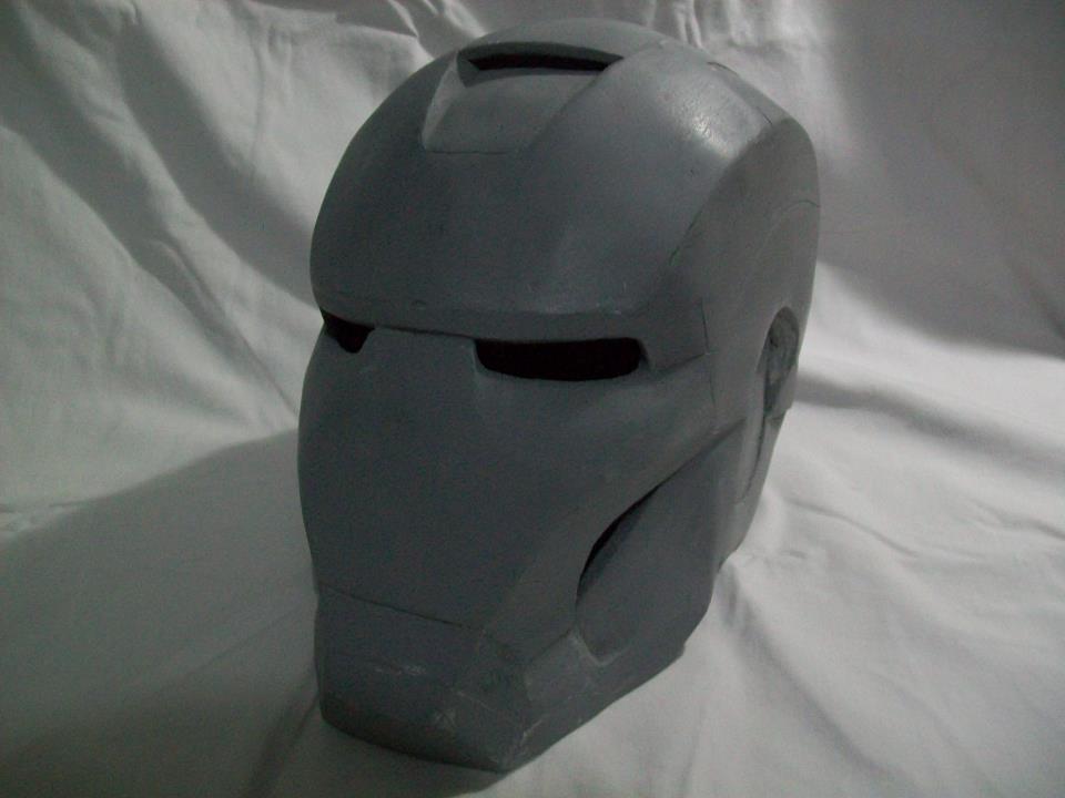

Here's my progress on the helmet. :) My first full helmet. Well, almost full it just needs paint and some modifications to make it wearable. Sorry, the lighting's bad in this pic.
Pretty good so far. Do you plan on cleaning it up some more? I know it is a lot of work.
Yeah, I will repeat the sanding until my hands bleed! :lol:lol
but why do you say to clip the parts? isn't it better to just glue them all? They will stick together anyways with the resin... or maybe is just my bad English and I didn't understand you well... :unsure
And many thanks for the tips!!
