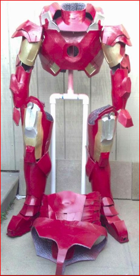

Hey Darkside501st,
I wanted to post a picture of the finished MkVII suit to show you what your templates could do, as well as offer some insight on some edits I had to make.
All in all, there were only a few hiccups, mostly the placement of the forearm vents. The pep file calls for indentations on the sides, but they don't show up in the movies' versions of the suit. They're also a bit low on the forearms and should be moved up closer to the joint for the elbow. The spine is a little off, but that was most likely my error, not yours.
I'm not sure if you were planning on updating/ editing these files further, but you're welcome to accept or reject my advice however you choose. I'm actually starting plans on my Mk XL (Shotgun) that I may not be able to finish for some time, so if you have any 3d modeling advice I would love to hear from you. Thanks again for letting me use your templates; the suit made a ton of kids happy at the premier opening weekend, and made an excellent addition to my cosplay room. Iron Man snip.JPG
Here's another with a better look at the front of the suit.
I can get more photos if you want a better look at other pieces, too.
