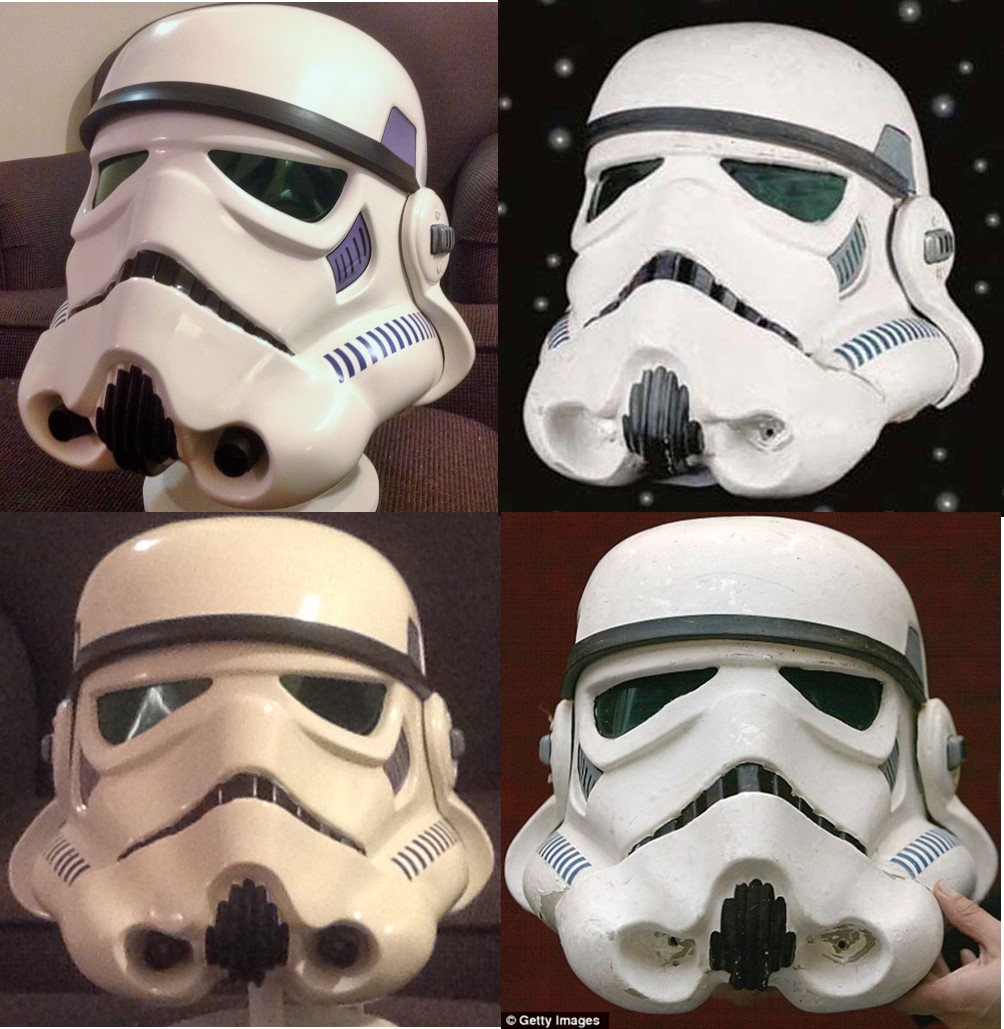

    Just about finished with this helmet. Just need to work on the hovi mic tips. Decided to post a couple comparison photos to see what everyone thinks so far. I based this off one of the ESB buckets auctioned off by Christies in 2003. I wasn't going for an exact replication but more of an interpretation.
    This is one of Dan's tan HDPE helmet kits. I really like these kits. The details are really sharp and the kits are great to work with. I used Dupli-Color Adhesion Promoter as a base layer after sanding the entire helmet with "3M Between Coats Finishing Pads." I then sprayed it with Krylon Fusion "gloss" white. The Krylon finish was less desirable so I gave it a couple coats of gloss white Rustoleum Automotive Paint. It was a vast improvement especially when wet sanded with 2000 grit wet/dry sandpaper followed up by rubbing compound. I used Testors enamel paint (gloss gray #1138 and and semi-gloss black #1139) for the details. I find Testors easier to work with. The stripes, teardrops and polygons are from the ESB decal set sold by Trooper Bay.

    This looks real good! I wish there was a way to mimick the lighting used in the auction shots on the right. Regardless, the paint work you've done is very impressive.

    Very nice work. A lesson for the rest of us is a great paint job is a combination of choosing the right paint and using the right techniques.
