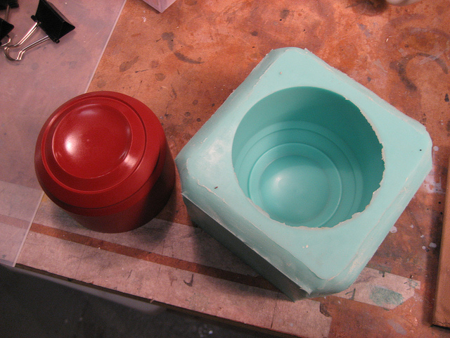

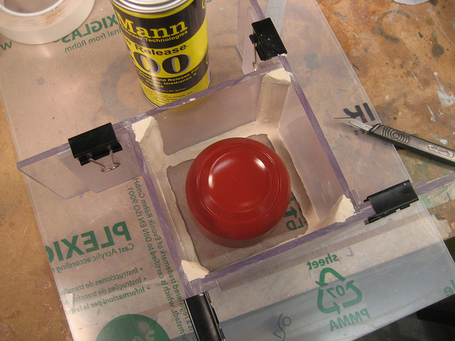

First, Thomas needed a seam line. I got the positioning of the seam using a fine piece of thread, when pulled tight it gave a perfect straight line. This was then marked on the dome. I then positioned 2 pieces of tape along the line with a 1mm gap between them. I then used a fine tooth saw to cut into the dome, just about a 1mm though, the same as the height of the saw teeth.
Then it was on to wet sanding, starting with about a 24o grit, working my way down to a 1200. Once sanded, a clay dam was placed around the dome, to split the silicone. I reckon I could have got away with a 1 part mold, but chickened out at the last minute. Only had enough silicone in stock to do it once (plus, i didn't fancy wasting it either)
Liberal coating of mold release then its on with the silicone. Smooth On Rebound 25, as usual. Thinned down layer to start then several layers at normal viscosity. Thena thickened layer to build up a ridge around the seam and to attach the registration key.
Once it set, the clay dam is removed and all the clay carefully cleaned away from the silicone. You can see the registration keys that were imprinted into the clay are now part of the mold. It is important that the silicone is properly coated with a barrier so that the 2nd part to the mold doesn't bond to the first half. I used a paint brush and some petroleum jelly, then some mold release aerosol.
Then its on with the second half of the silicone, same as before.

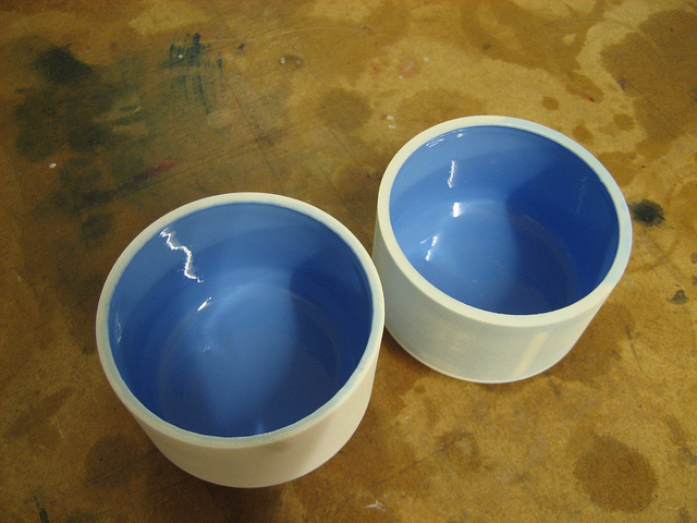

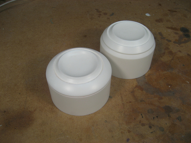

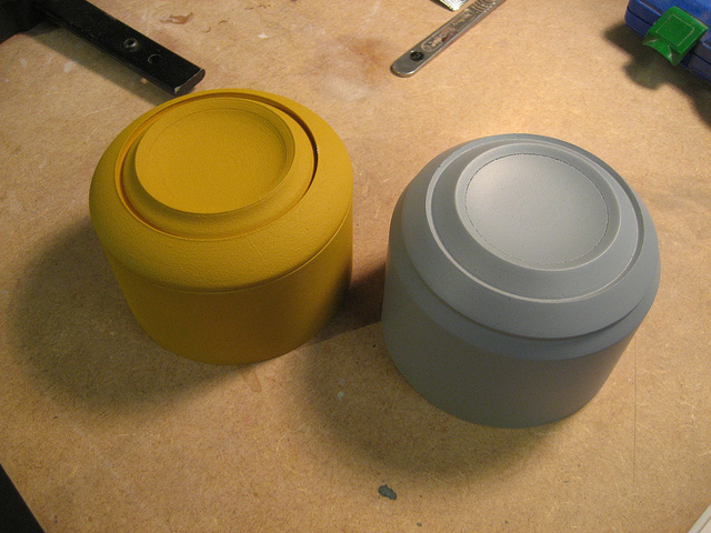

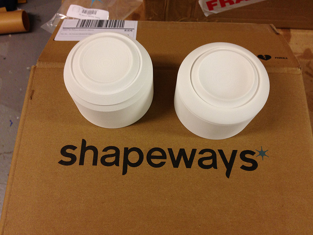

I did turn my own ear pucks in the lathe, but I wasn't happy with them at all. so I commissioned jtm to CAD up a couple of versions and had them printed with Shapeways. First time I'd used Shapeways, was very surprised with the affordablity of these pieces, made a lot more sense to have them printed accurately then to spend a day or so on the lathe, with the risk of messing it up.
Walls were only 1mm thick, so i slushed them with some PU resin to give them some rigidity.
They clean up really well, plenty of filler primer and a bit of patience got them done in a couple of hours.

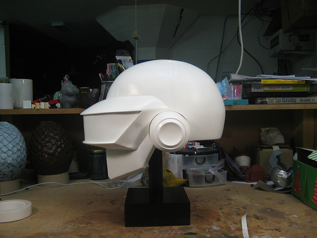

Blah blah blah, wet sand, box mold, cast, perfect results.
All was successful, all molds were near enough perfect, and the cast were clean and crisp.
Next on to the finishing.
