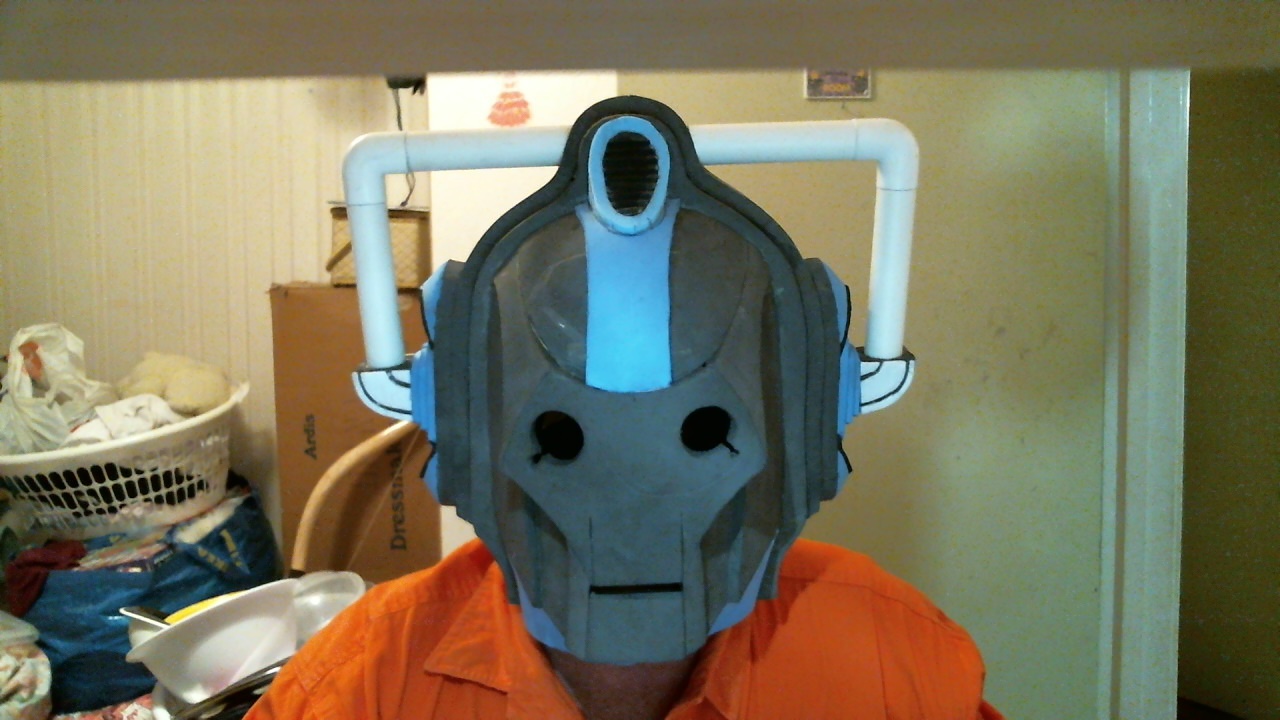

Cyberman in FOAM!!! - WITH PATTERNS!!
I'm hooked on Foam Building now. My Diving Helmet was a hit for Halloween. I'm ready to start a more serious piece now.

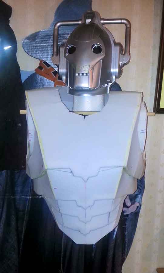

Would you believe me if I told you this is my first build with EVA foam.Never used it before starting this. I started with the boots and worked up from there. My skill level and confidence rose as I got further into the build. I still have a bit of finishing to do before I seal it for painting.I would at this point like to thank Wondersquid for making these patterns available for us to use.

My first real suit build. Getting there.
UPDATE! - Finished the suit! Had an Event and had to quickly get the parts together. I realized I have to do some more adjustments, but I have time now to refine.
