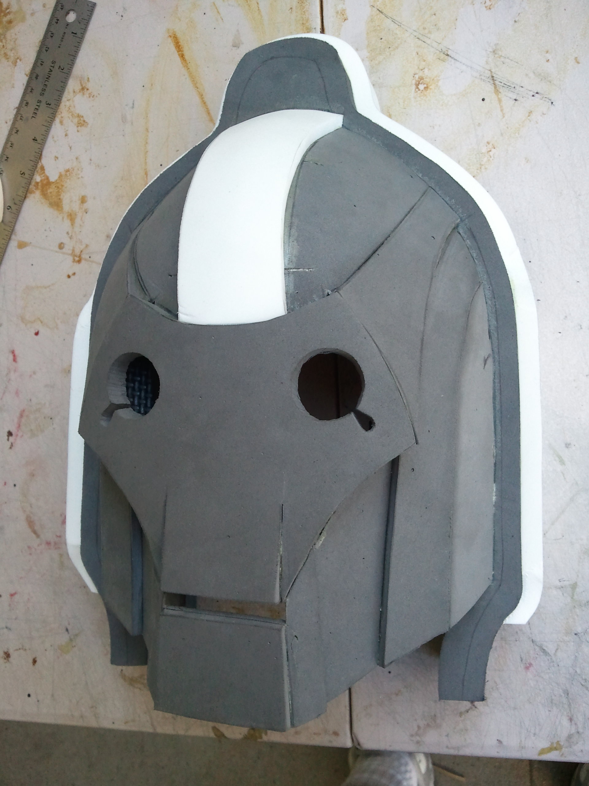

Face coming together

To get the ridge along the center I stacked and glued 6 pieces of 3/8" foam and then bandsawed them into the shape. I'm using foam mats from Harbor Freight, they claim they are 1/2" thick, but if you sand down the tread on the backside it actually comes down 1/8". These are great and take the Barge glue really well.

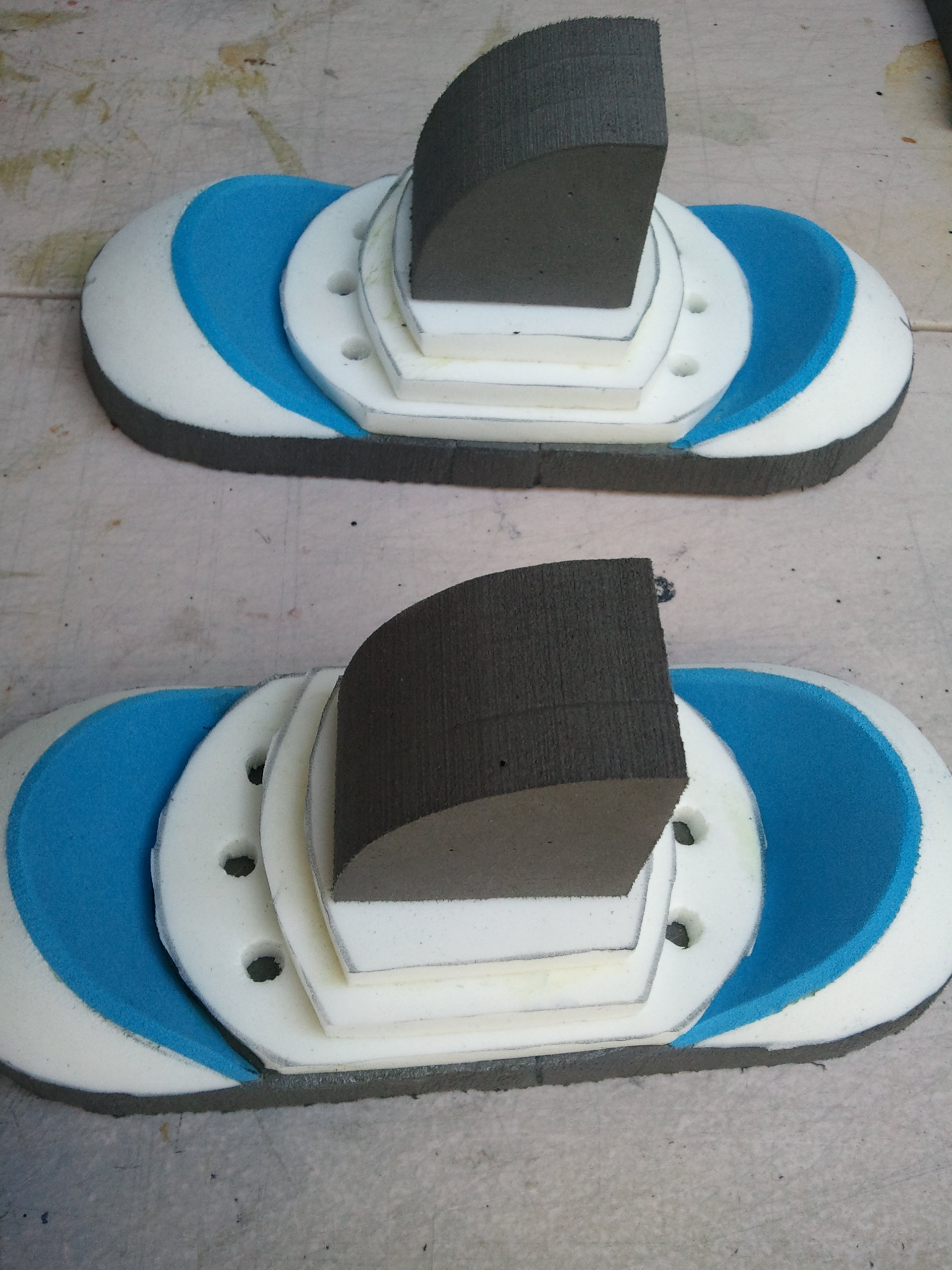

Ear Muffs as I call them, I am using 1/4" L-200 for some of the detail and I needed some 1/16" so I used those craft foam sheets from Micheals craft stores.

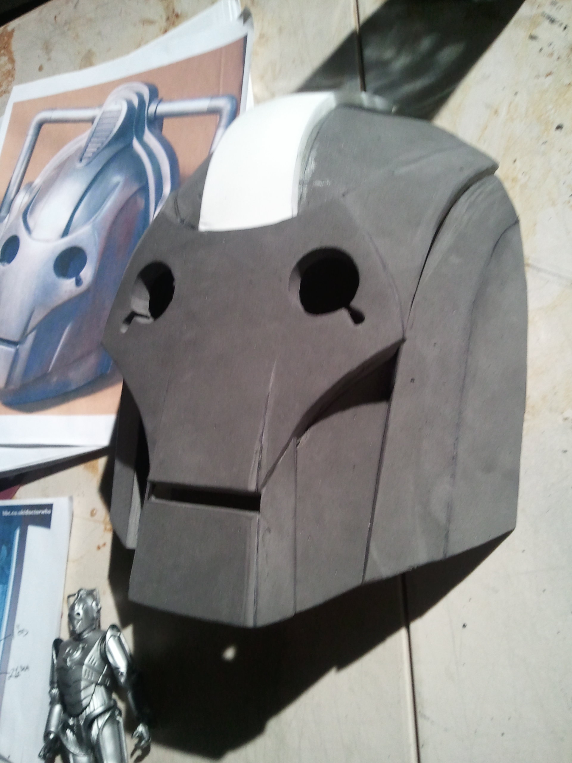

And this is where I ran into all sorts of issues. I actually put on the back of the helmet and then noticed a lot of inconsistencies and then my wife pointed out how uneven the ears are and suddenly I hit a panic mode. The entire days work shot. I took a deep breath and stopped taking progress pictures (sorry) and Burned thru a reworking of the entire face and ears over a 7 hour period. It looks SO MUCH BETTER! It was totally worth the pain and redo.

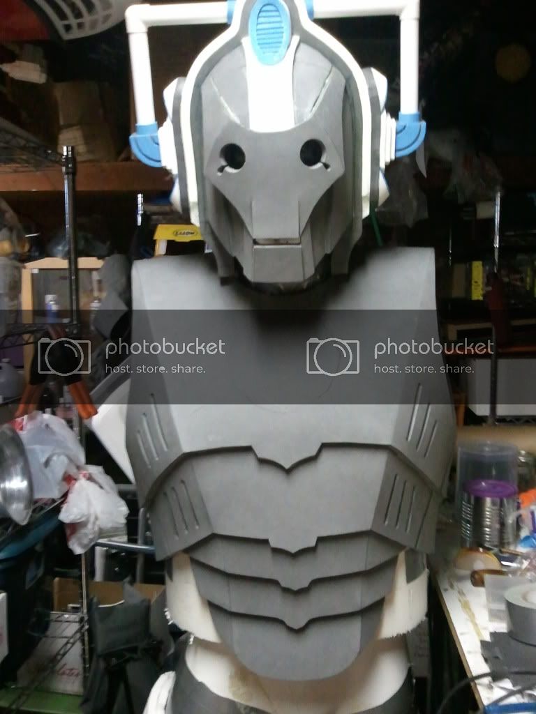

UPDATE! So with some diligence I finished out the helmet. (still needs the neck, but I'll get to that later)

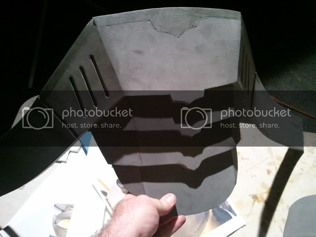

As promised I got around to the chest. These are my patterns. UNHEARD, I actually tried to used the Pep files but they are not working at all for me, so from this point no pep files!
As usual I'm moving so fast I don't take many pictures.
All done! I just need to make the detail stuff for the back and the cyber symbol on the front. On to the Arms next!
