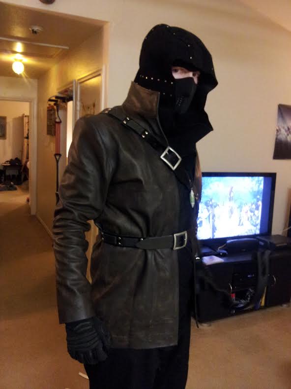

I've gotten a LOT of inquiries as to where I got the jacket, so I figured posting it up here could help some folk.
Originally, I searched for a *similar* coat online, finding a fairly close match from a company on eBay called "Flesh and Hide Inc."
Noticing that they did custom and replica work, I contacted them via their listed email and exchanged photos with a representative until we landed on something that worked.
This is the coat in question: http://www.ebay.com/itm/Genuine-Leather-Classic-Long-Coat-in-Distressed-Brown-/321374287238
That style, made to my measurements, with a funnel collar, no pockets, no zipper, no buttons/buttonholes in a distressed brown leather ran me ~$200 shipped.
The only part I'm not 100% satisfied with is the collar, simply because the LoA collar has a very particular cut to it, but that's something I'm working on fixing.

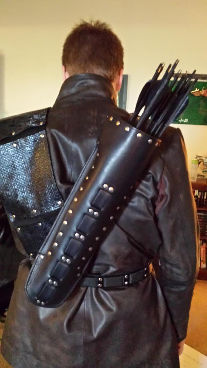

I just realized that, despite having put a LOT of work into my leather quiver... I NEVER POSTED PICS OF IT!

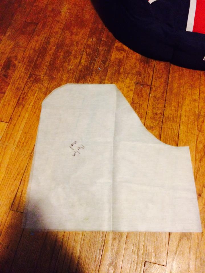

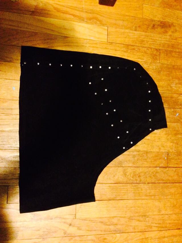

Okay, here we go. First off, the size of the hood will vary depending on the size of your head. The hood itself is only 2 pieces of black suede. Do NOT get the really thick stuff, or it doesn't drape properly.

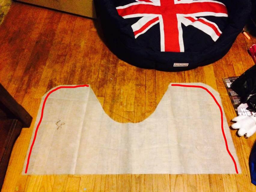

Pic #1 shows the main hood piece folded in half. #2 it's spread out to full size. So yes... that's one big piece of suede.
#3 shows where your rectangular piece of fabric attaches. The rectangle should be the same length as the red lines.
#4 finished hood, folded flat in half. Note that the side rivets are NOT in a straight line from front to back. They start higher and angle down lower when you reach the back to account for how the hood drapes when worn. When you're wearing it, the lines give the appearance of running straight around the hood.

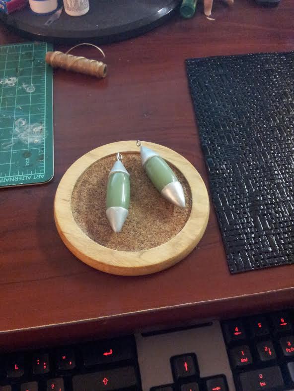

In some downtime used an artificial jade barrel bead and some apoxie sculpt to make his pendant, finishing it off with some silver "Rub n buff" wax.

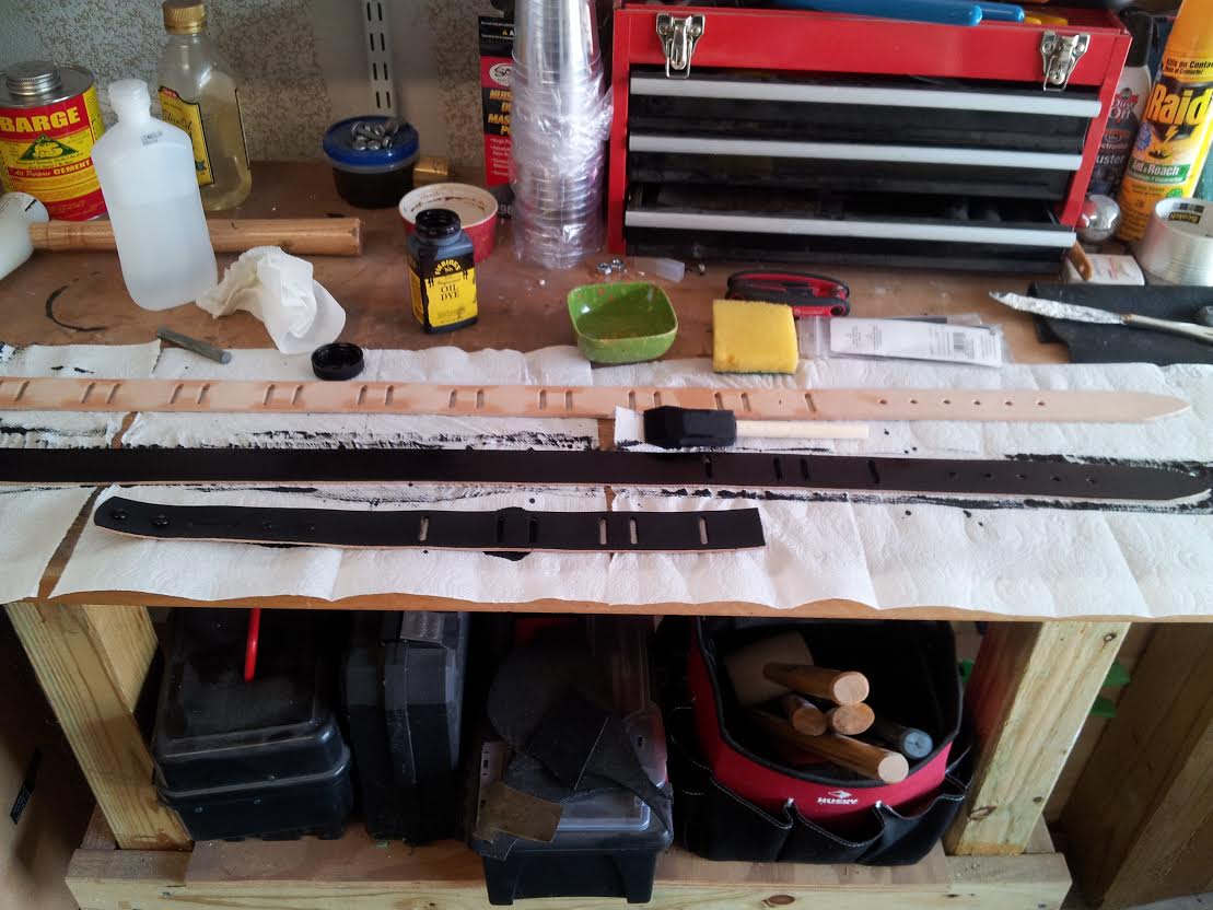

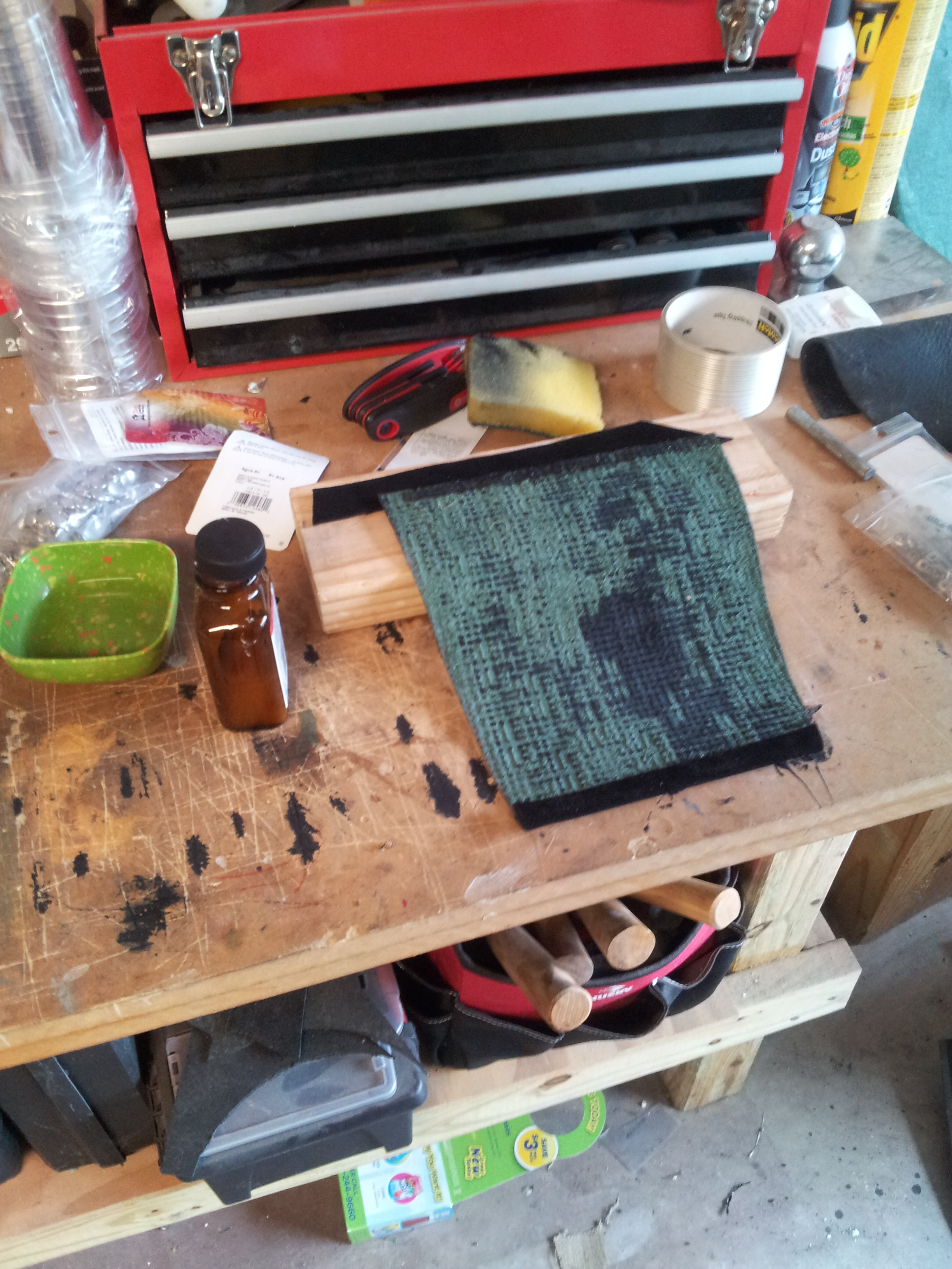

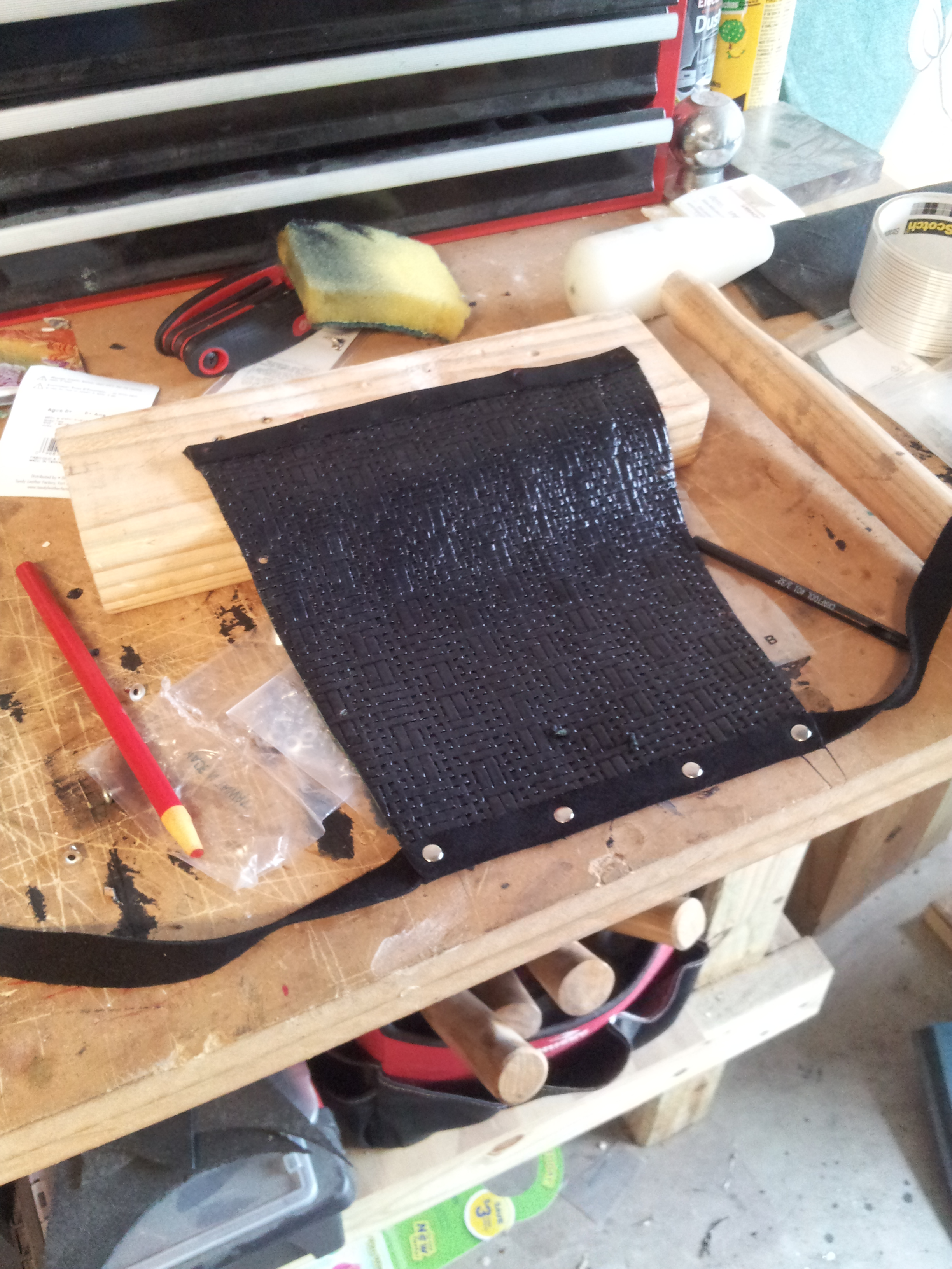

While I was at Tandy I grabbed some belt blanks and a few punches when they were on sale to make the belts, and while I was doing the dyeing I did some basketweave leather for Malcolm's bracer. Using a little scrap suede from the hood project and some rivets, I think it pretty much looks the business.
View attachment 339648View attachment 339952View attachment 339951
