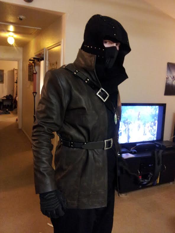

Started off by finishing up the hood. After prototyping it in scrap fabric and then microsuede I went to tandy and picked up some thicker suede. Many hours of hand stitching and riveting, then cutting all those rivets and re-riveting later...

Still missing the quiver, arrows, and leather panels on the coat's chest/shoulder/back, but went ahead with a test fit. I couldn't be happier with how it is coming together.

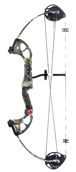

The Bow:
We've identified the bow as the PSE X-Force Super Short Short Draw (2008 model). Unfortunately it's a royal pain to find.
If you want something nearly identical though, you can go with any of the PSE X-Force SS models, or even the X-Force Treestand (grip is different, but easily removed and you can put the other grips on since they're sticky pads). They pop up on Ebay ranging from roughly $400+

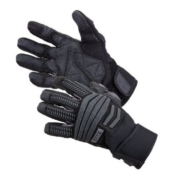

The Gloves:
Much easier to find! The gloves are made by 5.11 and are their Tactical ATAC gloves. You can pick up a pair on Amazon for about $50. Only thing they did to them for the show was to remove the small rubber 5.11 logo.

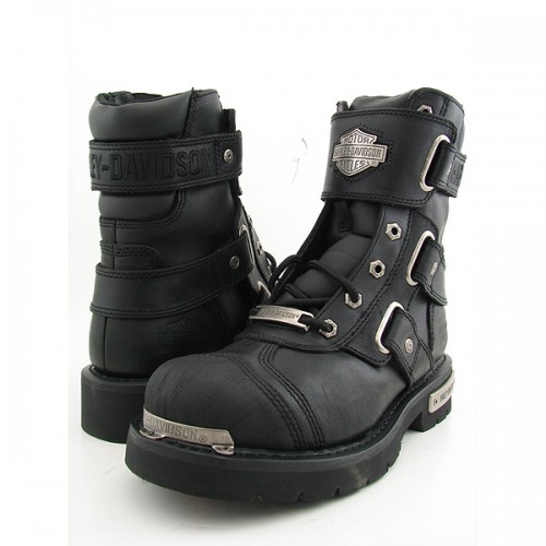

The Boots:
Here's another part of the costume that's going to have you looking for a while. The boots they use are made by Harley Davidson and the model is called Choker. Unfortunately, these are also an older model (2011) and were supposedly a Harley dealer exclusive. They retailed for $130. So far, the only pair I've come across were the ones I bought for myself on Ebay (which thankfully, were the right size!).
For the show, they covered up the silver Harley logo on the top strap, and buffed off the Harley Davidson name on the side and front metal bits. I'm pretty sure they covered up the Harley Davidson name on the back/side of the top strap too.

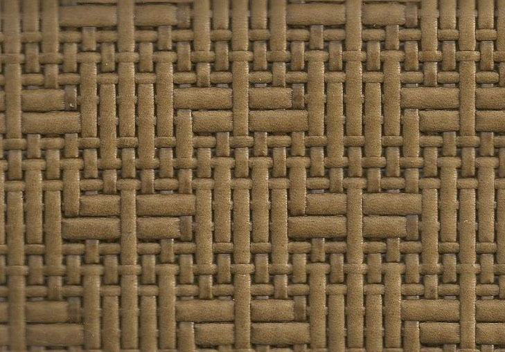

The arm guard and the panels on the jacket use the same material/pattern. It's embossed leather in a basket weave pattern that's been dyed black. This stuff was harder to find that anticipated and we couldn't find a place to order it in small amounts. However, it does turn up on Ebay from time to time.
