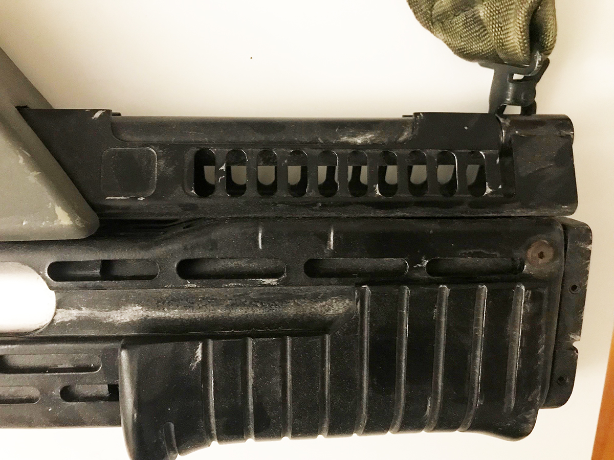

Close up of barrel vent

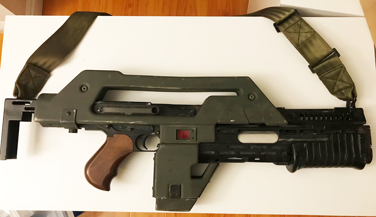

Sling attached

I can’t remember who made the cast resin shrouds but I made all the smaller plates and fittings from sheet aluminum. Painted everything Brown Bess, weathered the aluminum parts by beating them up a little and some silver paint here and there for the shrouds. The whole gun was weathered basically with some gun oil and dirty hands grabbing it around the magazine well and carry handle, etc. I finished it off with black and stainless hardware. I feels good to see it the correct color after it being OD green for many years.
