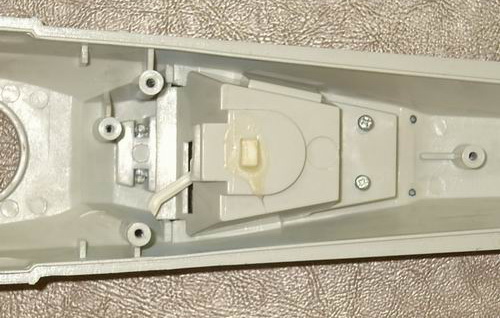

I initially planned on shimming it, but I ended up removing the spring and the button/lever. At tat poing the two sets wings of wings are very loose, and just flop open and closed on the metal cotter pin (not really a "cotter" but a pin nonetheless).
I then just superglued the wings to the fuselae (after final assembly) at the points where they made contact with the fuse...
Make any sense or do I need another beer?
I think I understand....
you removed the mechanism, but kept the pin inside the two main sections that formed the wings, then just glued the flat wing surfaces directly to the fuselage?
sound about right, or do I need a beer?
You got it! And we both need to grab a beer!
n the pic you can see where I axed off the large buttun that - IIRC - contained the spring.
And yeah, I just (rather crudely) jabbed the glue tip for my CA glue (can't recall if it was Gap-Filling thickness or Water Thin) into the wing recess right at the point where the wing root exits the main fuse, and globbed on a bit of glue (nicely hidden in there so sloppiness wasn't a big deal) at all contact points.

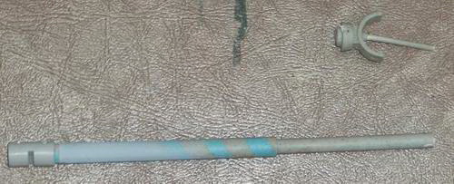

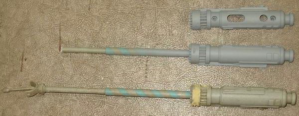

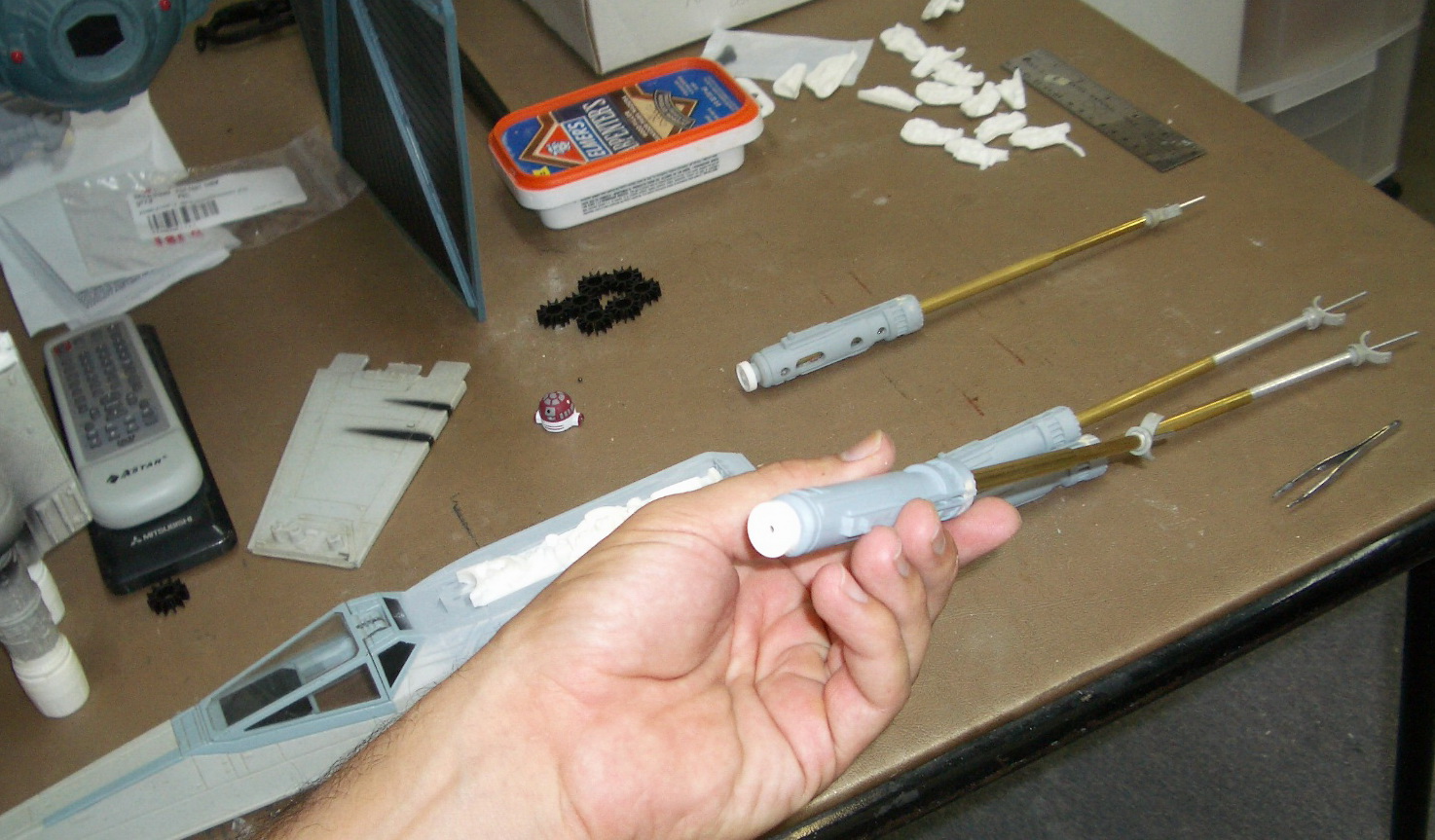

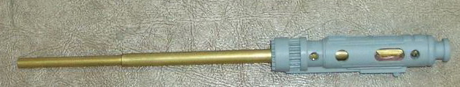

I decided to post batches. I have the various parts of the build separated into separate photo folders. Up to YOU to associate these pics with my ten-year-old posts!

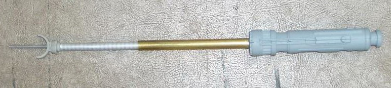

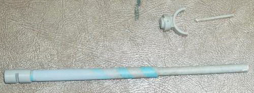

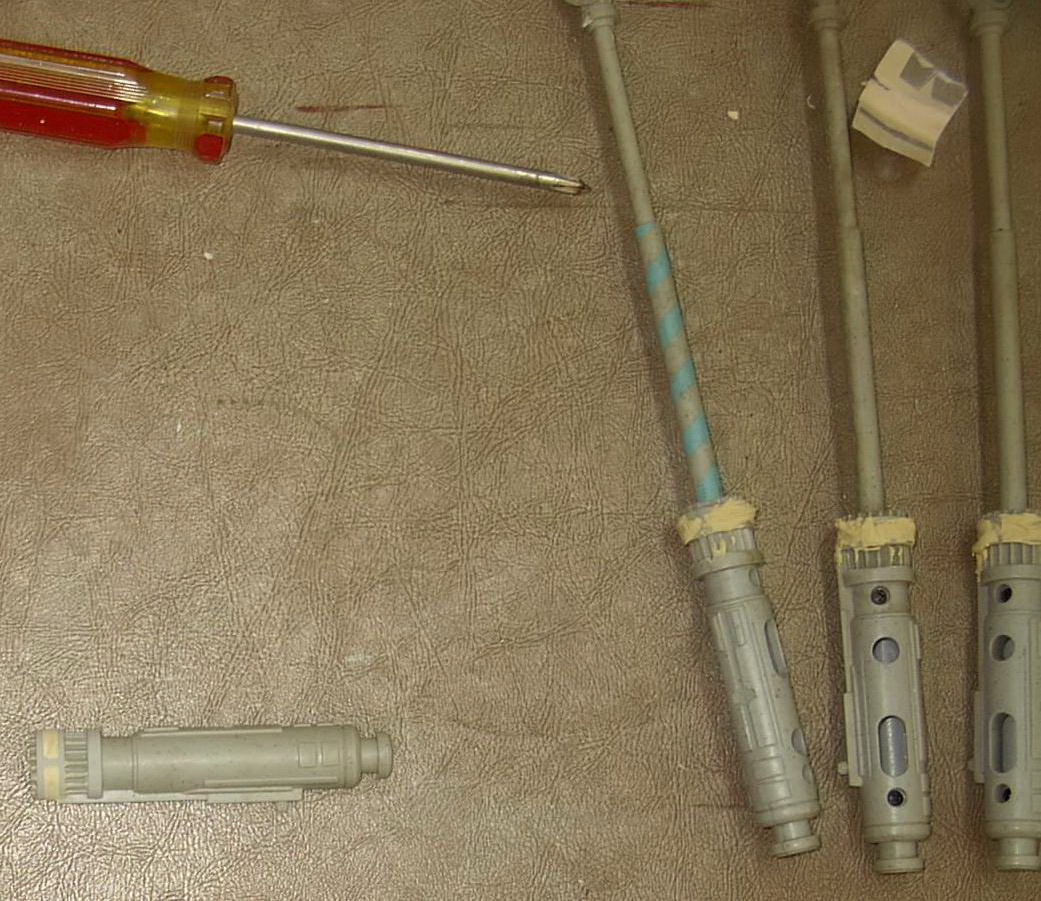

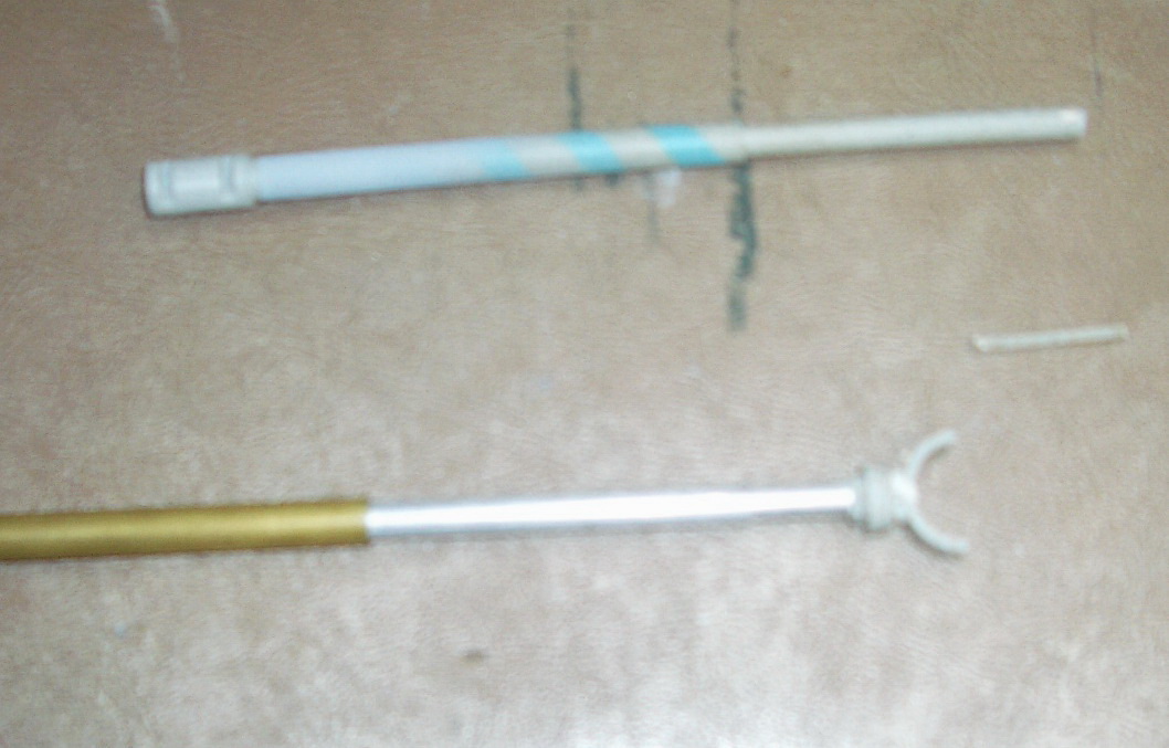

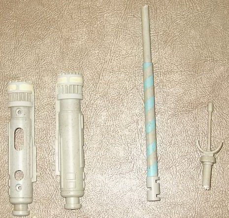

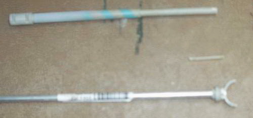

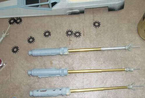

Beginning with the cannons...
More...
More...
