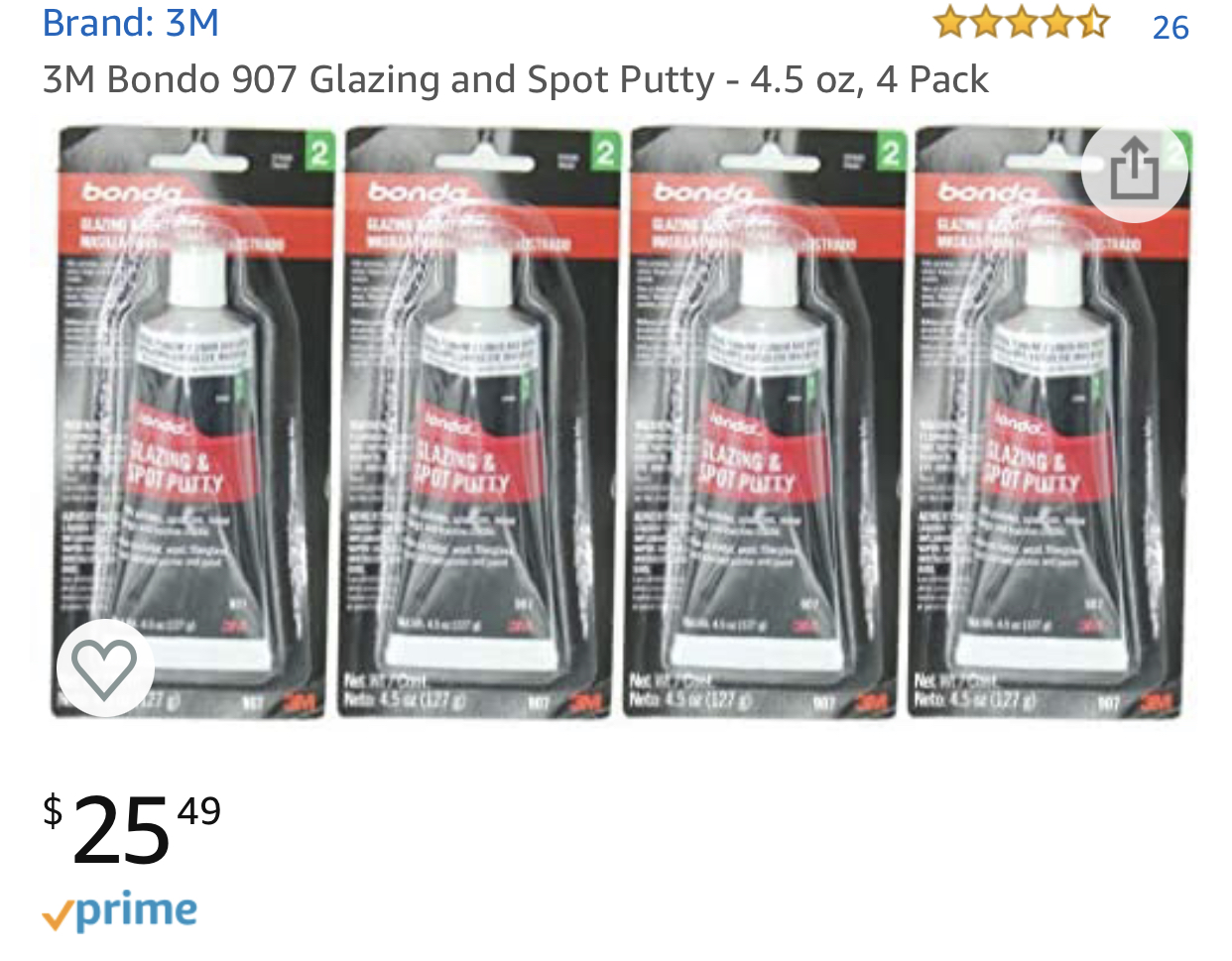

So I've got a structure I've recently built from foam board and was wondering what you guys use to coat it to add some durability? I've used a fast setting resin like onyx fast and it worked great but was extremely thin and cracks after too much sanding. I've heard a million things from plasti-dip to watered down Elmer's glue. The end goal is to have a sandable surface that can be primed, painted, and molded.
This works well...
I'll give it a shot, ive got plenty of it at the house.. I was looking for something that could sort of soak into the foam to apply a layer of rigidness rather than a thin layer of hardness over the foam like this or bondo would.
Maybe do the watered down Elmer's Glue to soak in, or Gesso to soak in. Once dry, add this Bondo layer on that for added rigidness? Just a thought.
