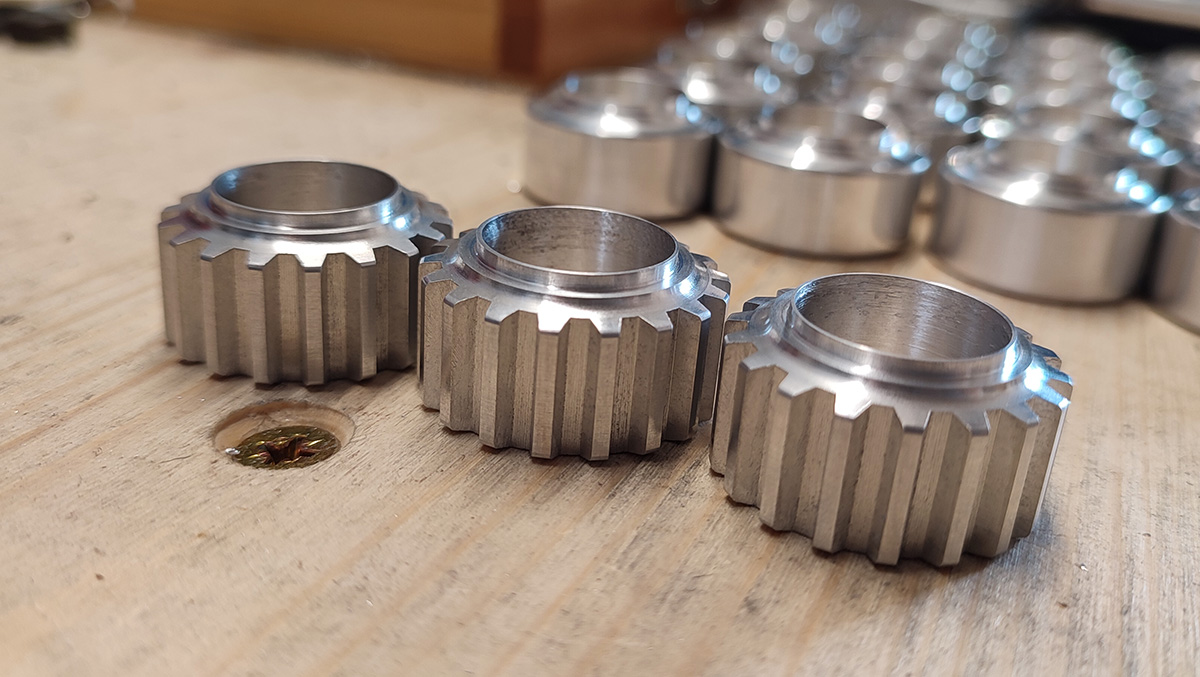

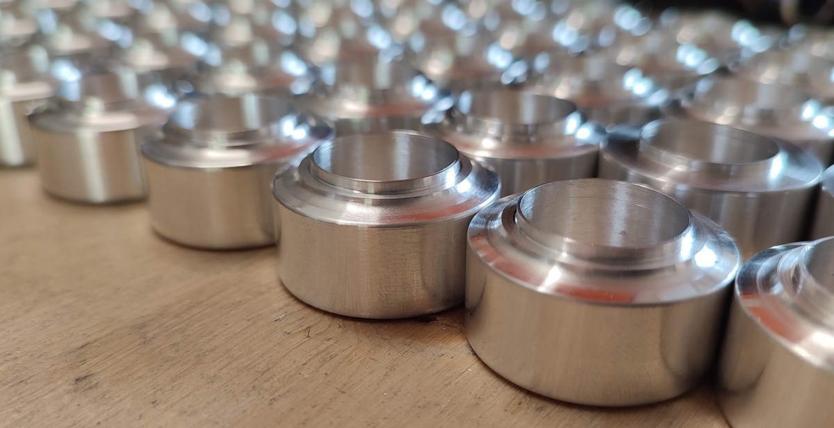

Hello guys,
I have finished all the preparation stages on the gears, "just" need to cut the teeth on the mill now. Still 5 or 6 days of work for that, that is the biggest step!

As someone that has never run a metal lathe or mill, are these cuts done in one go? That means you have to roll sideways, at whatever feed rate leaves a smooth cut, like 18 times or whatever!
hey Tom,
this is a bit of a complex process that I tried to explain in the WIP thread last time:
but let me try to explain more now,
first of all, I'm doing the teeth on my milling machine, not on the lathe. Idealy they would be done on a CNC combined lathe and mill.
for parts like that, either you have a 300k$ CNC machine, it will take a couple minutes to do them and you'll pay for the machine cost mostly, or, you have a 2k$ machine like mine, it will take 40 minutes to do them step by step by hand and you'll pay for my time mostly.
I think those type of gears in the industry are normaly done with a large circular blade that will carve each valey in one go mostly.
since I have a small manual machine, like I explained in the linked post, I calculated in my 3D software where to position my 45° triangle end mill and I have to mill each valey progressively in 20 passes. This is the tool and setup I use:
The part is held on a rotating chuck. First, I'll do 6 passes at the same angle but going slightly deeper each time until I reach the final depth of my valey, when this is done, I'll rotate the part 0.5° each time and do back and forths with the tool for each rotation, 14 times. then I move to the next valey, 17 times. That is 340 back and forth with the machine all operated by hand for each gear, hence the big workout. It takes me 40 minutes per gear to do the teeth.
I tried to capture a video in real time for one valey. it's a pretty boring video and it vibrates a bit in some places but I think you can fully see how it works if you watch it :)
I hope this clears up a bit the process on that part :)
cheers

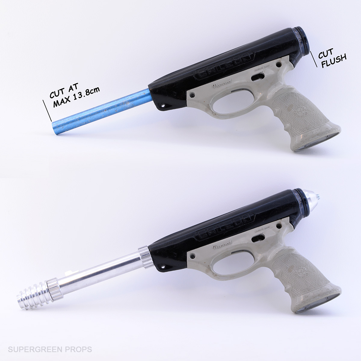

alright, now, the kits are very easy to put together, I have writen a small explaination directly on the website page, but, here is a more detailled explanation with photos :)
First thing is, you need to disassemble your speargun as basically explained here:
After the back of the speargun is removed, the (blue) barrel tube should be cut flush in the back and at a max length of 13.8cm in the front.
now, two things can happen if by any weird chance, you have a crazy variation. we never know with vintage stuff.
1- Check if the gears fit around your barrel.
maybe you got a weird version with a slightly larger barrel tube, in this case, the gears might not fit on it, no worries, the kit will still work perfectly if you cut the front barrel completely!
2- check if the small cylinder at the back of the muzzle fit inside your barrel.
In the hypothetical case that you have a thinner barrel, the muzzle base might not fit inside your barrel tube, you can cut the barrel a bit shorter in a way it can still be used to guide the back gear and a portion of the front gear, do not cut it completely if the gears fit around the original barrel.
alright, this was just for the weird Nemrods out here. let's hope that the kits will fit on all of your pistols. But again, if they don't, no worries, the kits will still work well!
Alright, now, here is everything you should have:
I have cut the bolt on the front of the threaded rod shorter (inside) as this blaster is a bit front heavy by detault. Take the end of the threaded rod that is longer, it can be recognized also by the small portion of untreaded bolt visible:
slide the cone part on the bolt and thread the washer to the bolt, they will stop at a proper depth with some threads visible in the back.
Insert that assembly into the barrel from the back of the gun.
Now, you'll see that one of the gears has a small recess in the front, this one goes in the front of the barrel, it assembles with the muzzle:
Dry fit together the two gears and the barrel and slide them on the speargun's cut barrel.
Then, just thread the muzzle to secure everything together. Make sure to align all the parts to your liking when the assembly is almost tightened. The front sight needs to be glued on the barrel in the appropiate flat spot milled in the front.
and here we go!
