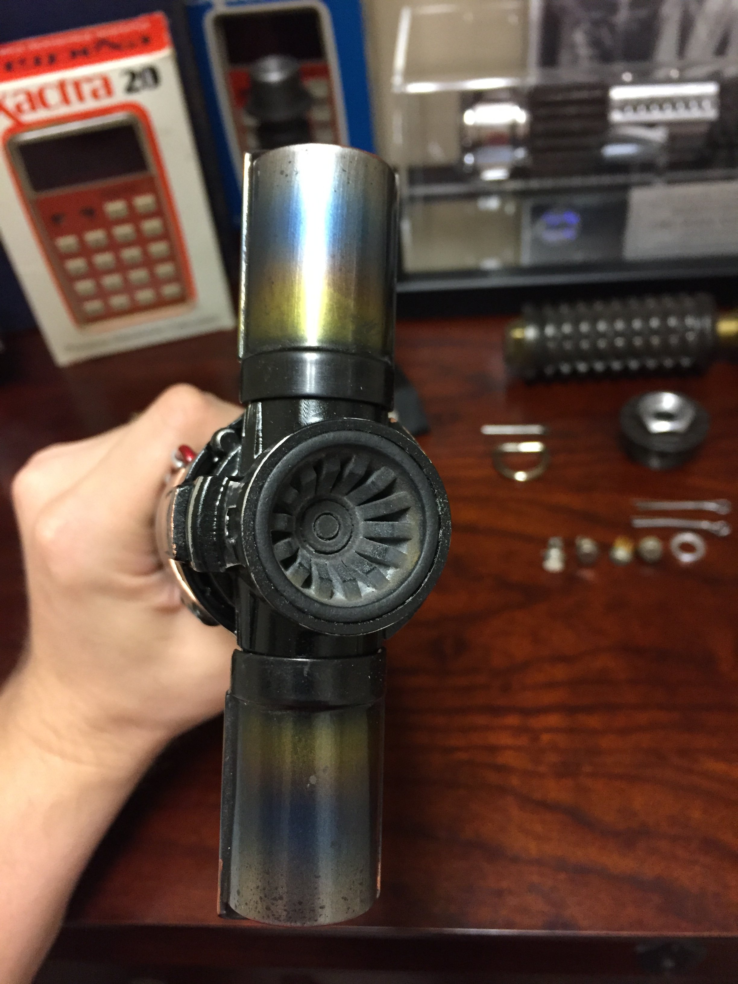

Does anyone have leads on the side blades? 1" main and 7/8" side correct?
Are the blade plugs that are up on Shapeways the best currently available? I'm not too keen on using those parts on an all metal hilt.

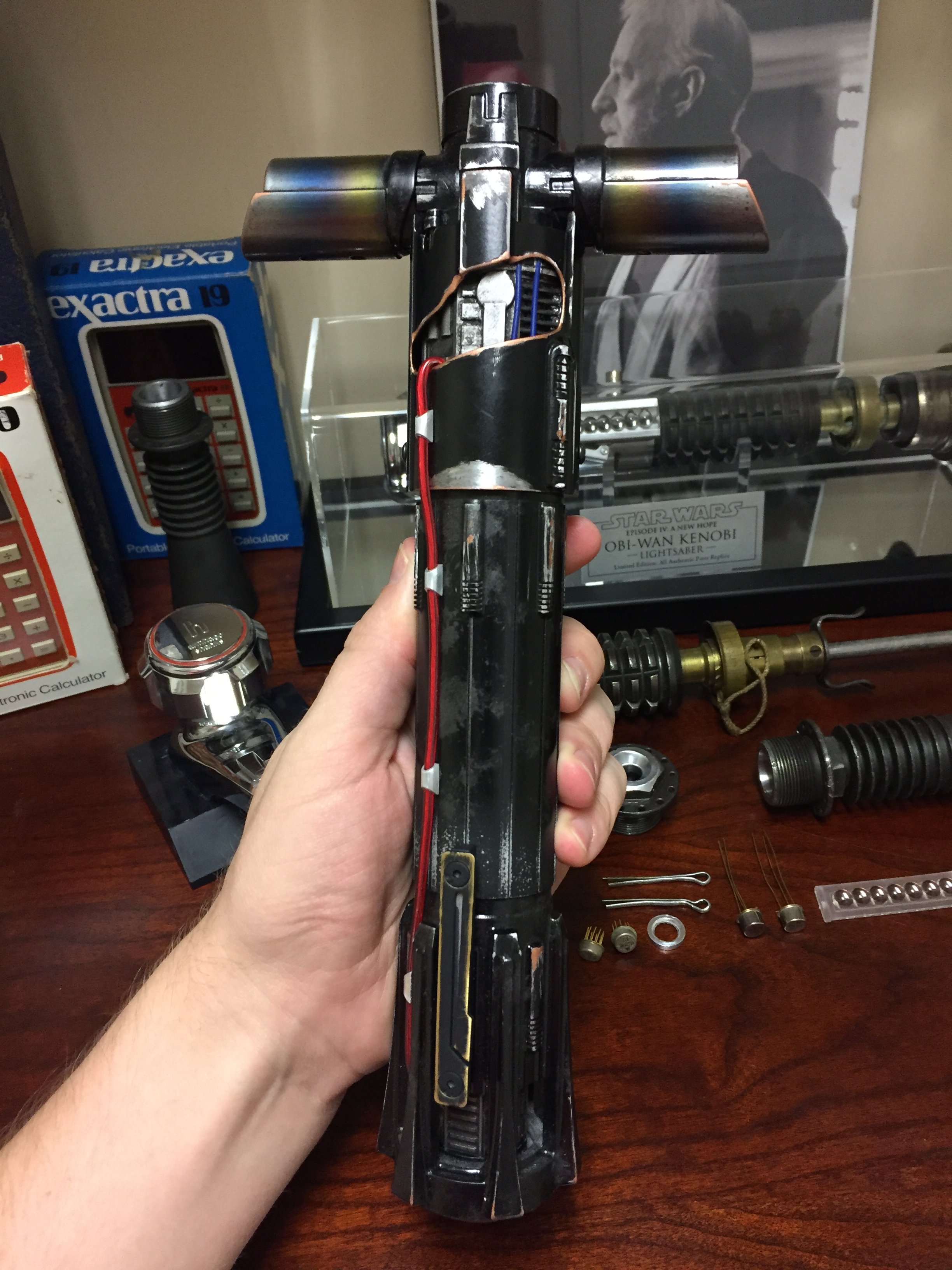

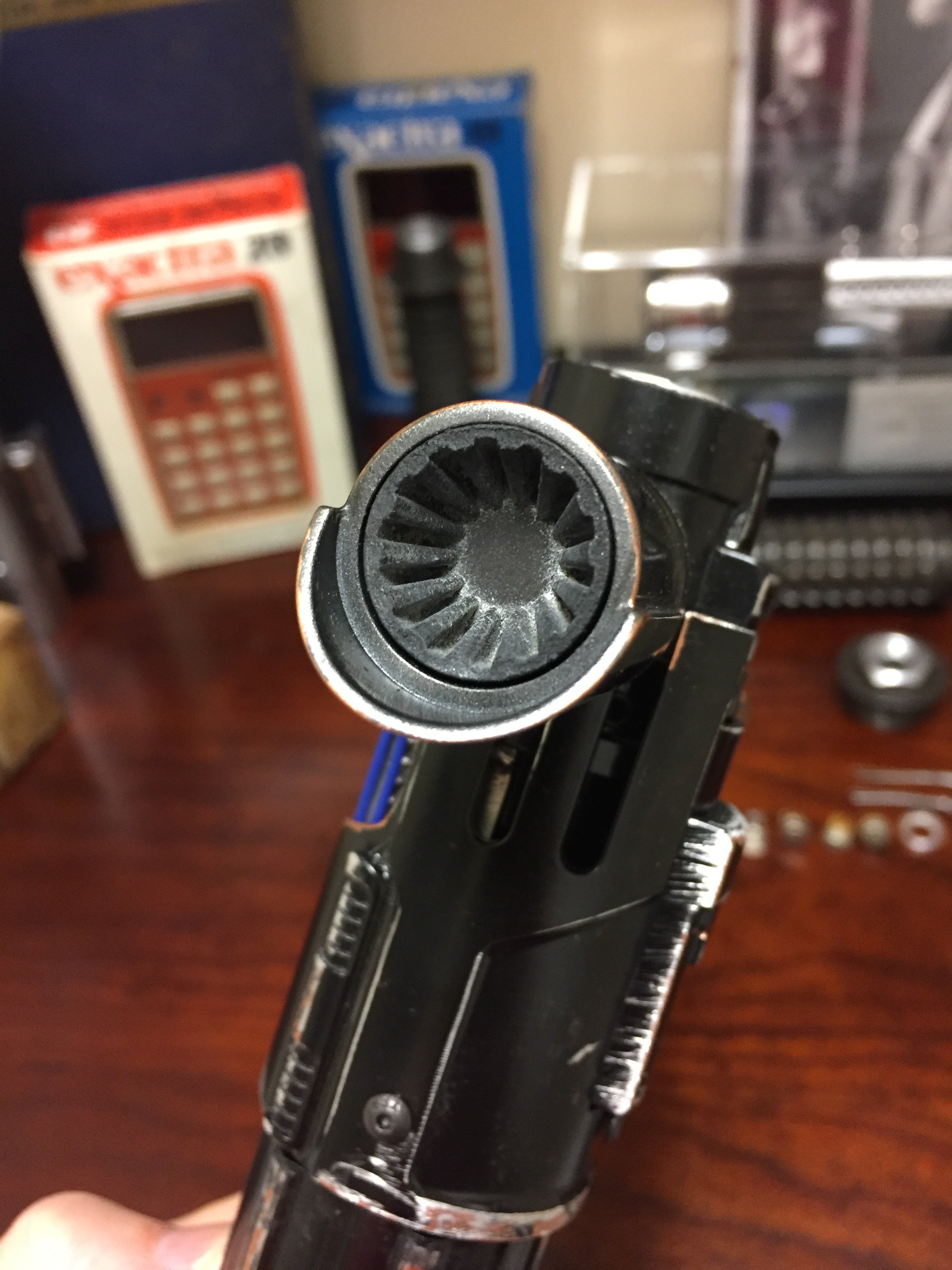

Mine was all metal also, and I bought the metallic blade plugs. They get painted darker also, and they look just fine. I'll try to go take a picture.
pics added.

Thanks for the pics Teecrooz. Still not sold on those,but if those are my only option...:unsure
I'll be printing my blade plugs on an SLA machine in clear resin, then painting lightly so some light still comes through
