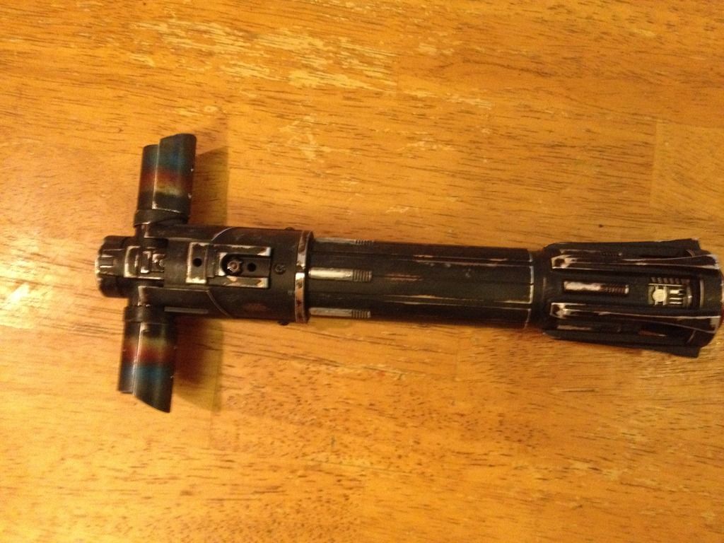

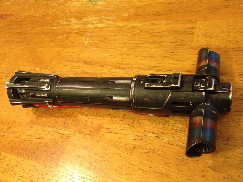

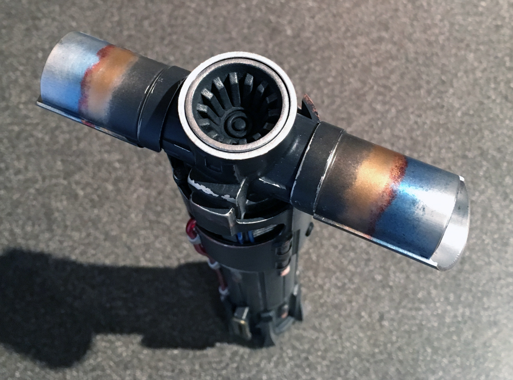

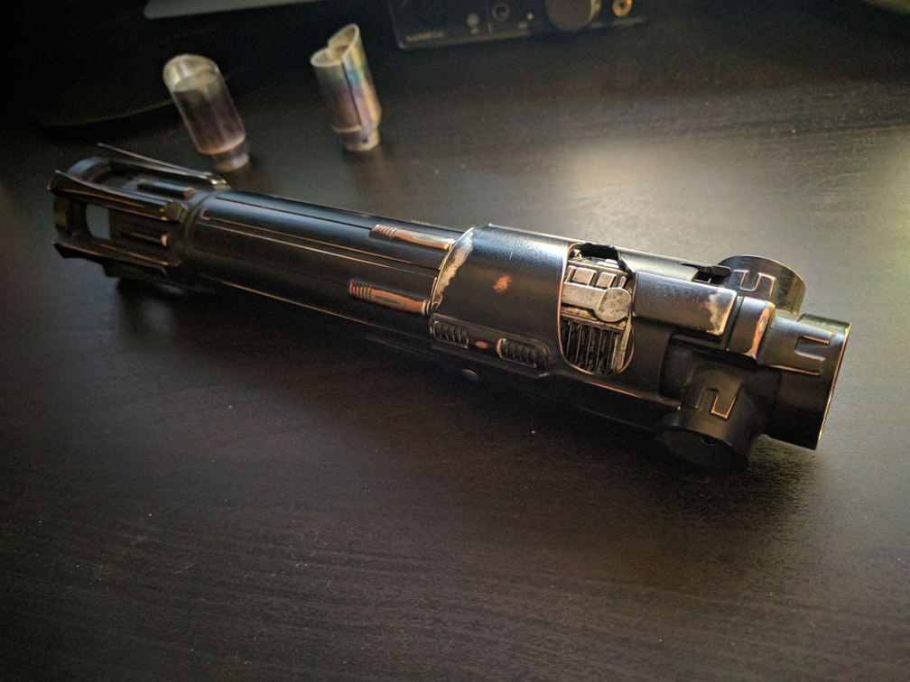

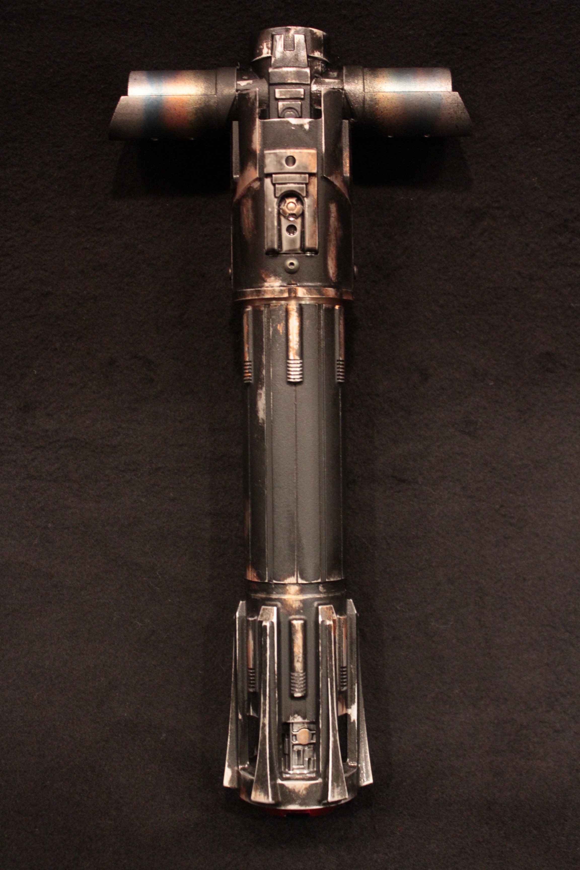

I was gonna wait until It's finished but I've impressed myself so much I thought I'd post some progress pics. I've never painted anything before so I'm amazed at how well this is coming along. Think I might remake the resin insert too to add some extra detail to it.
Love this saber!
Sorry for the poor pics, was very dark when I took them.
What kind of paint did you use to get the copper effect in the weathered areas?
Please post some painting tips. Are there any issues with painting metal?
The photos of the painted sabers look great!

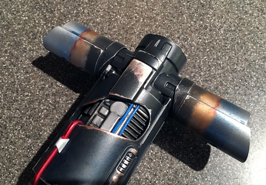

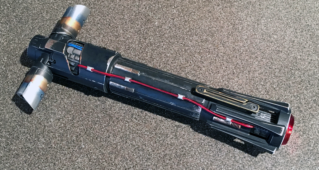

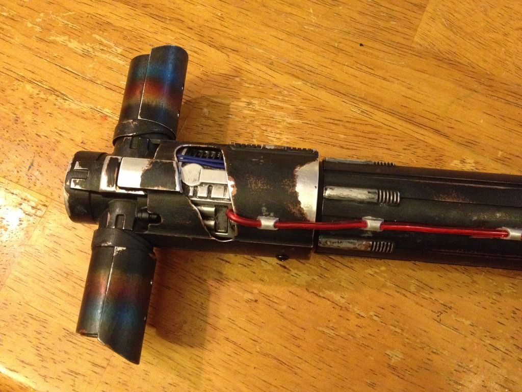

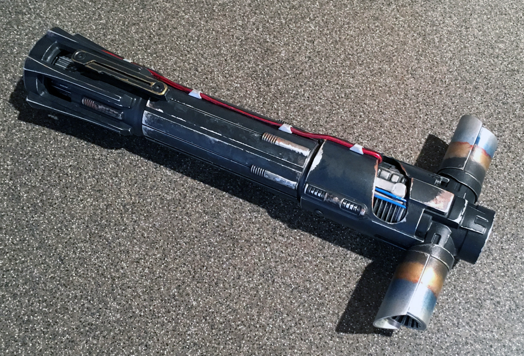

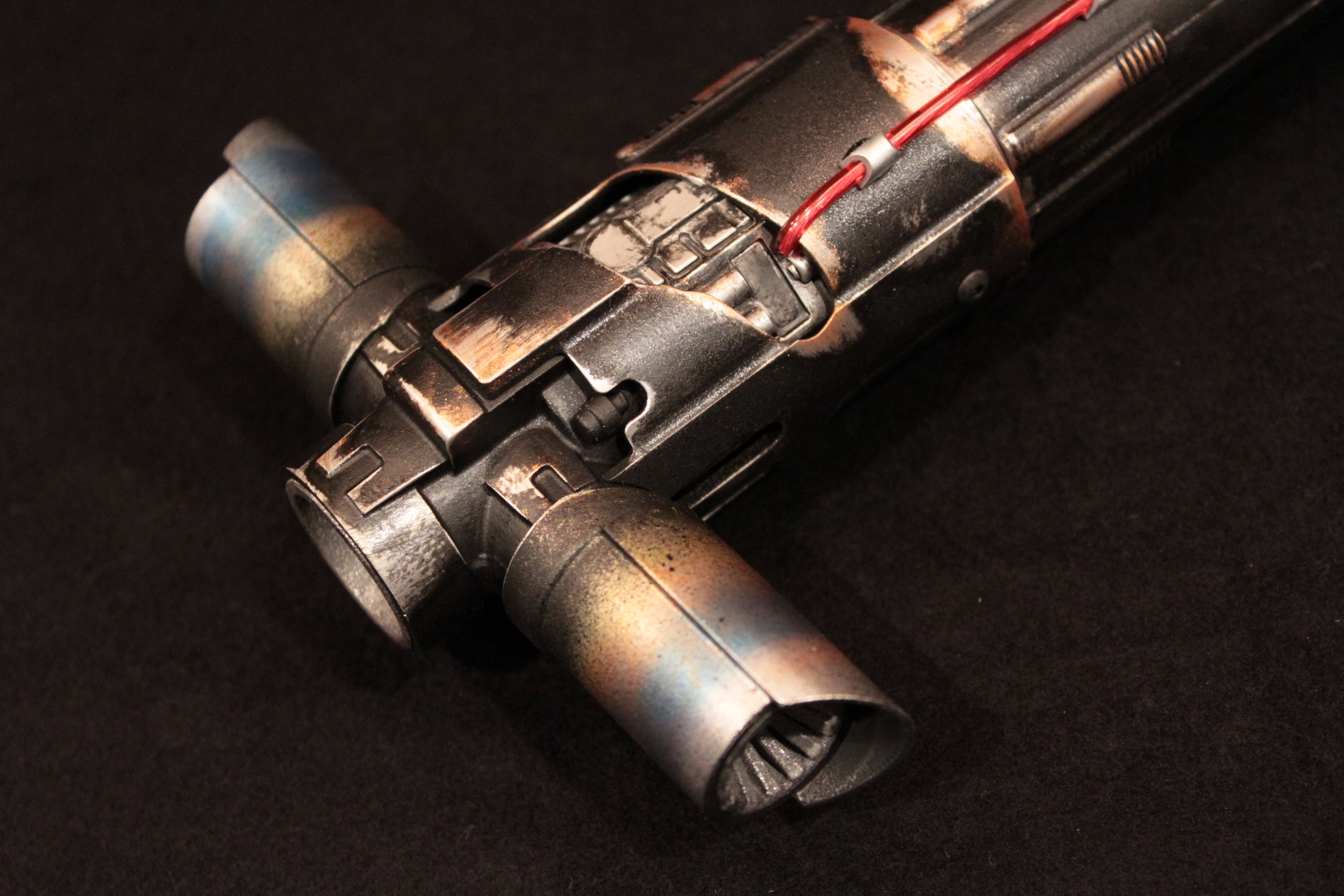

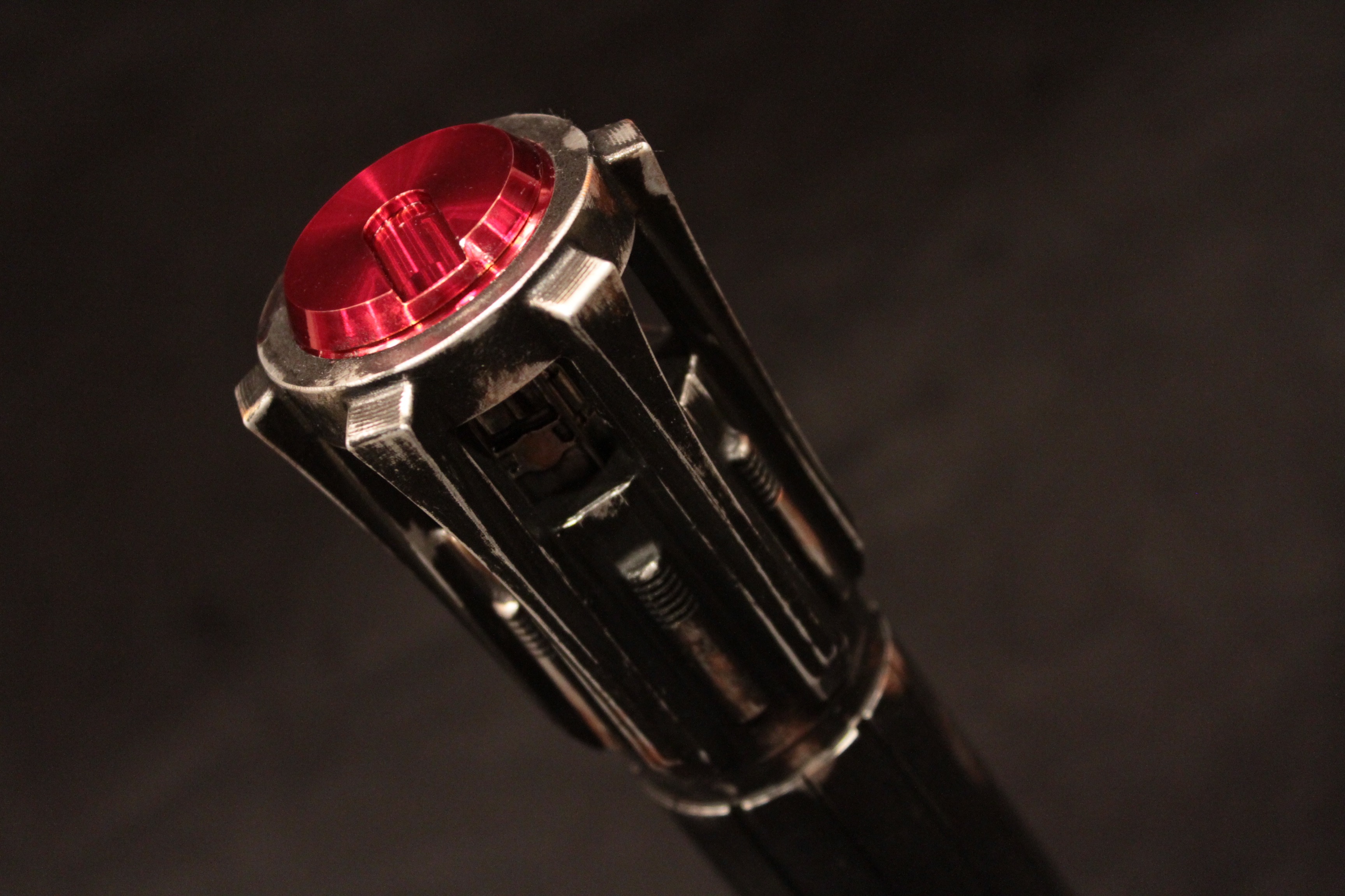

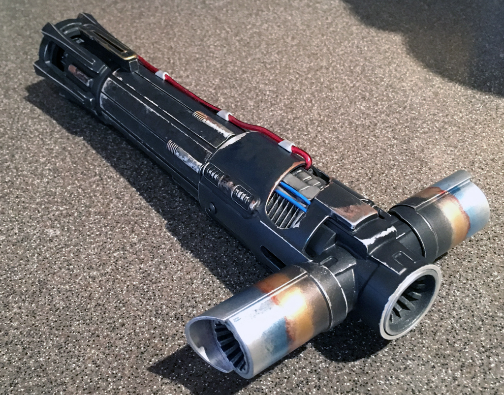

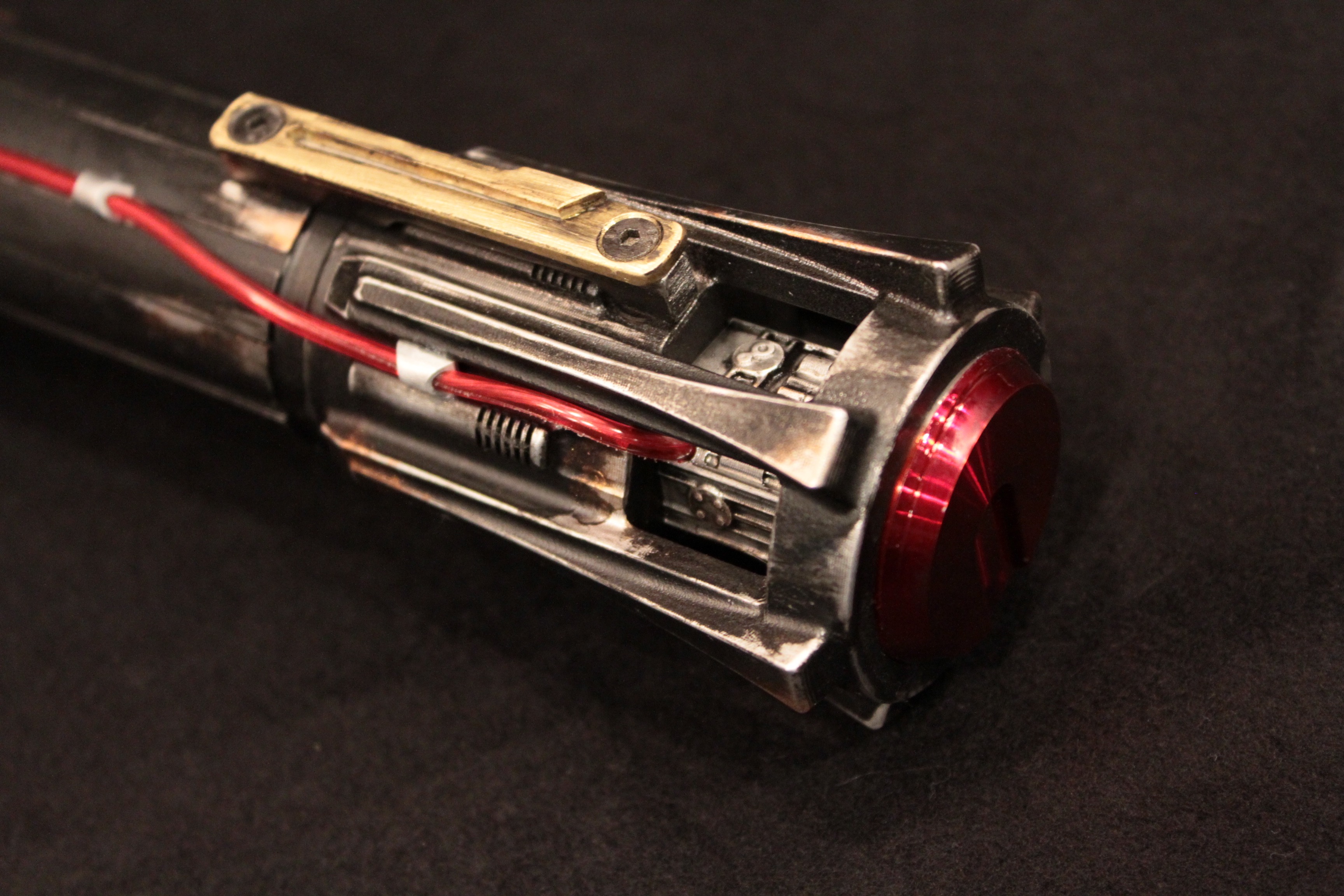

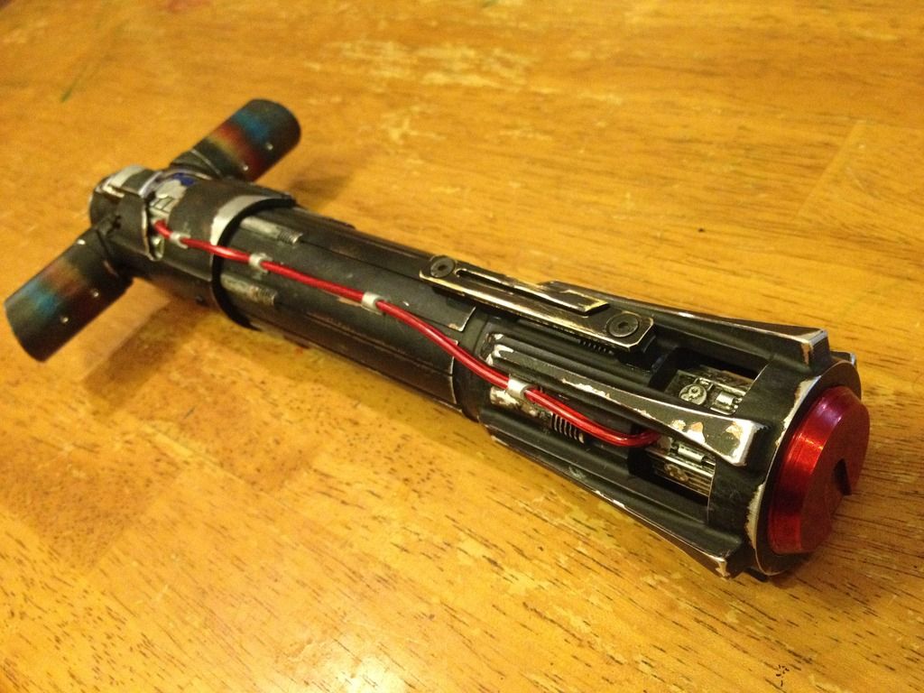

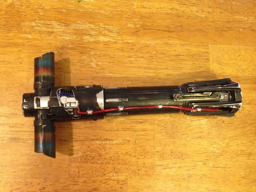

OK Pretty close to finished still need to add the Blue wires, I did get a cheap air brush to do the emitters. Never used an air brush before , totally understand getting a good one, because the cheap one was a pain, hardly no adjustments, Hope you guys like it.
AL
Ren Saber 1.jpgRen Saber 2.jpgRen Saber 3.jpgRen saber 4.jpgRen saber 5.jpgRen Saber 6.jpgRen Saber 7.jpgRen Saber 8.jpgRen Saber 9.jpgRen Saber 10.jpg

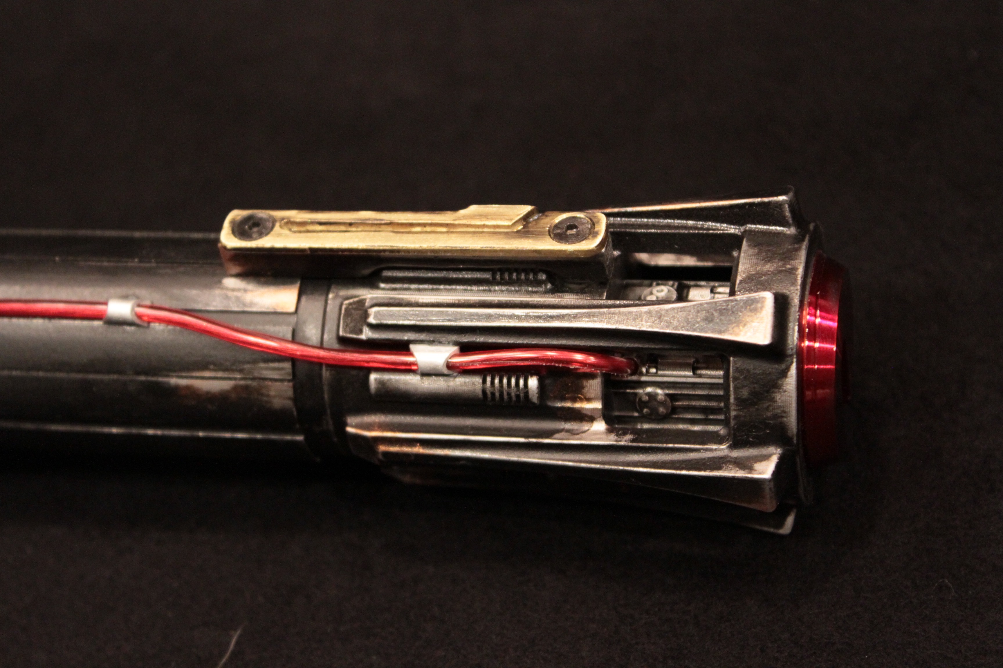

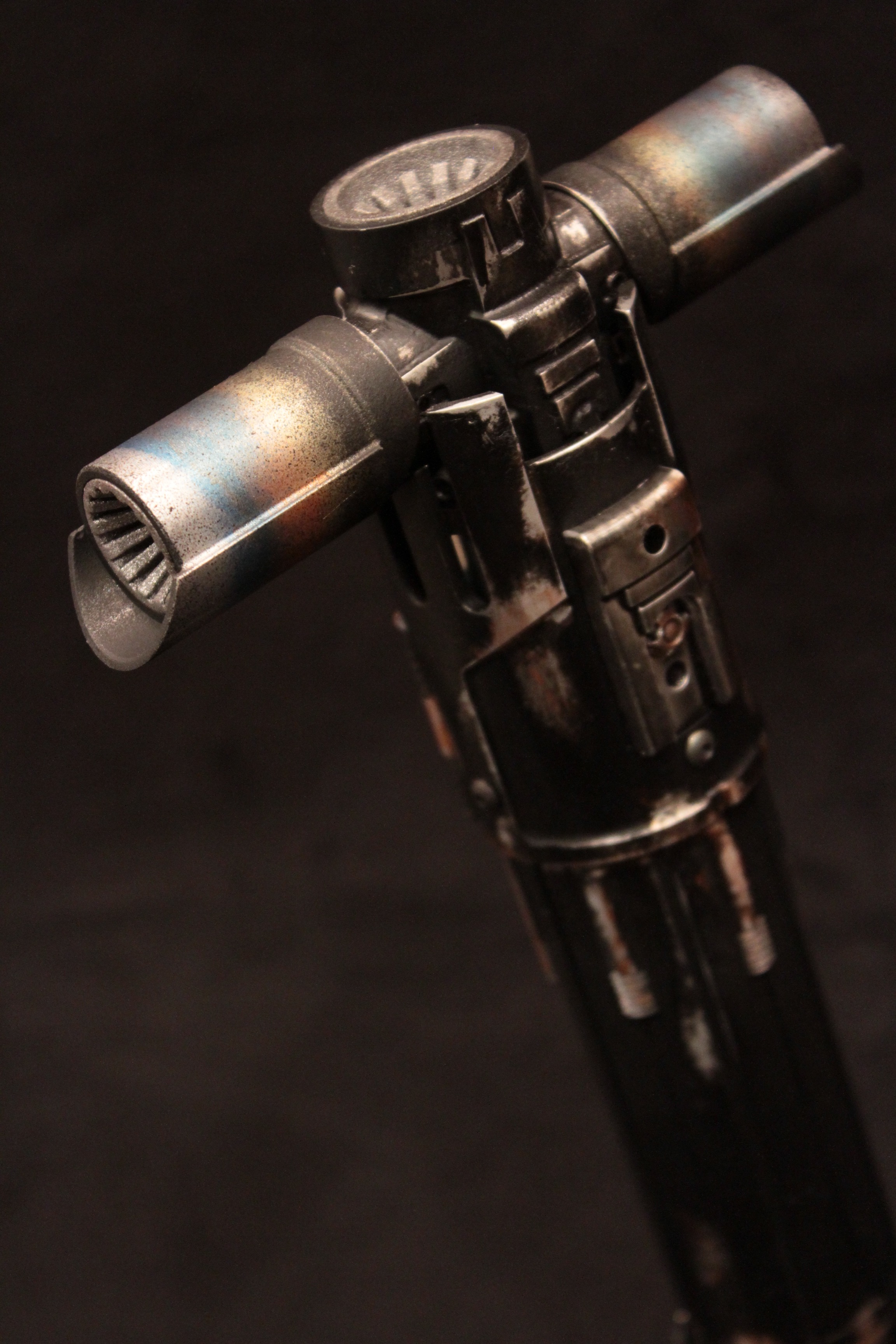

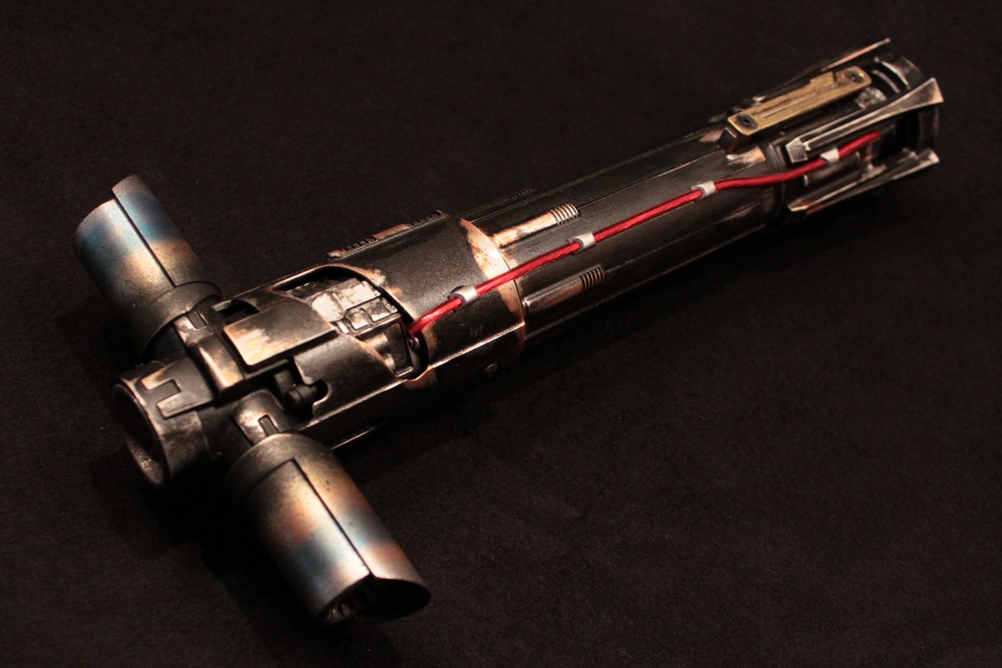

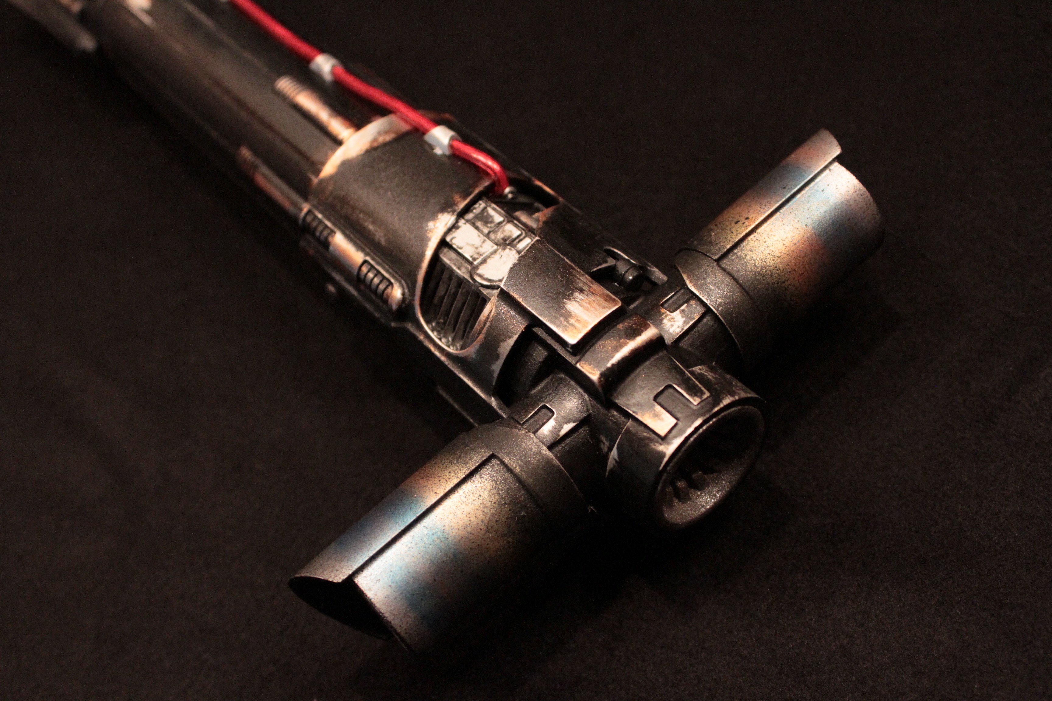

It's all enamel spray paint. I primed it, hit it with a few coats of metallic copper and then a few coats of matt black. I then rubbed down the areas I wanted with wire wool to expose the copper and bare metal. I weathered all the exposed metal with aluminium black, and then lightly polished the entire thing with some turtle wax to give it more of a satin look, sounds pointless but I think polishing the matt paint gives it more depth, it looks like its been buffed by being in someones hand and the deep areas that wouldn't come into contact with you are still slightly more dull.
What kind of primer did you use? Does rubbing a little expose the copper and rubbing more expose the primer?
Was the aluminum black done after all the paint layers and rubbing?
Sent from my Nexus 10 using Tapatalk
Just a grey enamel primer, same as the paint. Yeah, rubbing with wire wool exposes the copper, and if you keep going you'll go through to the primer. I tried to keep the primer coat as thin as possible though as I just wanted to go down to the metal. The copper coat was the thickest so that I wouldn't rub straight through it and then I just gave it good coverage with the black.
The aluminum black was done after the rubbing (doesn't effect the paint luckily)
I used it on all of the exposed metal to make it look more like steel rather than bright aluminum and then I polished over everything including the aluminum black.

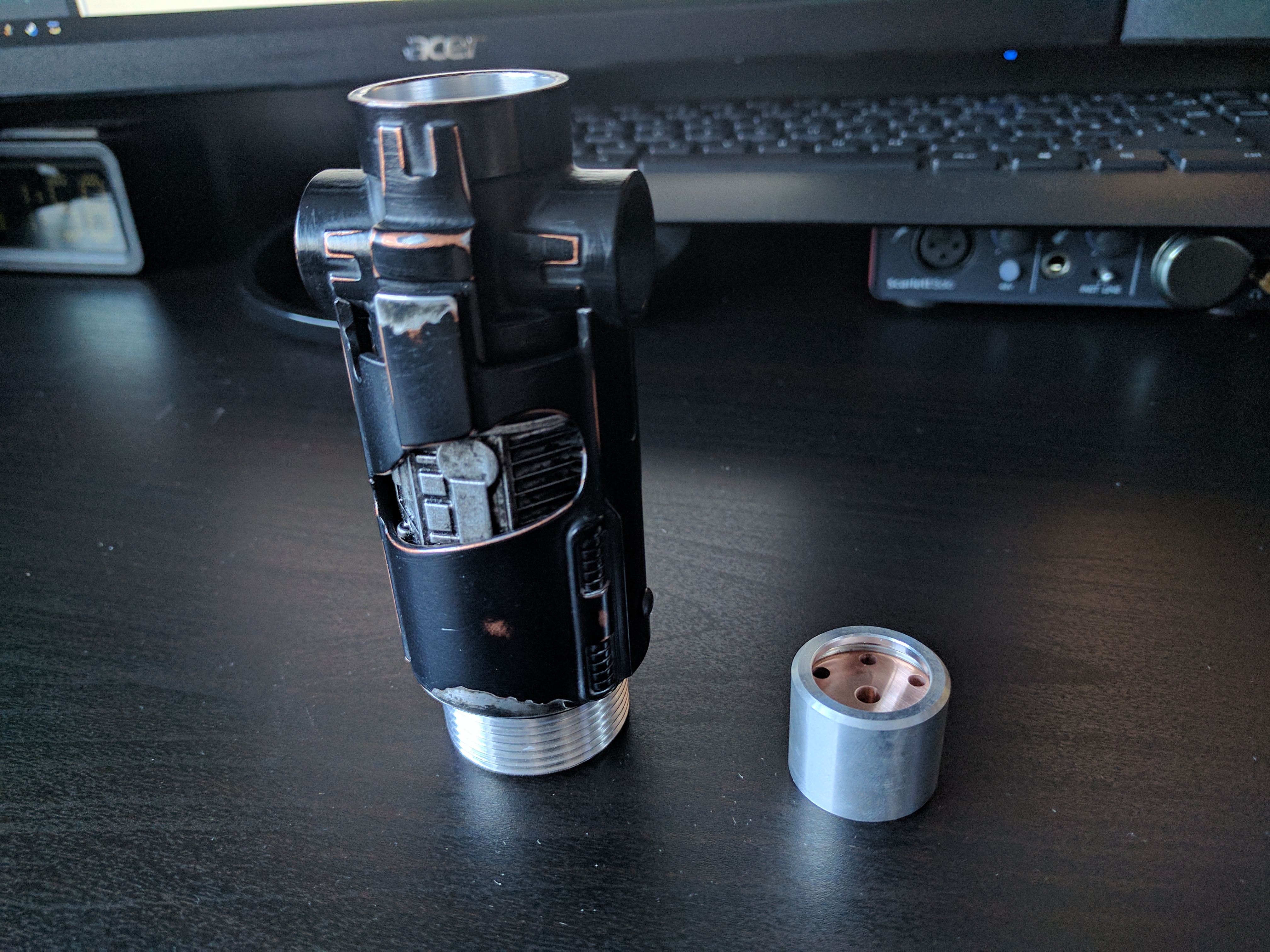

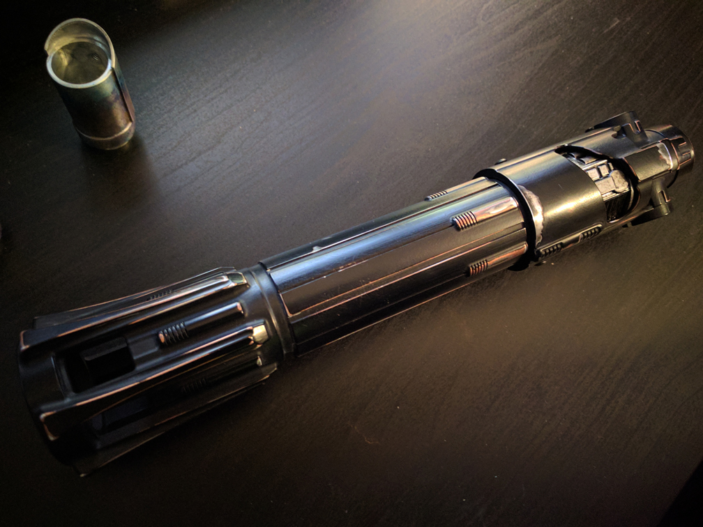

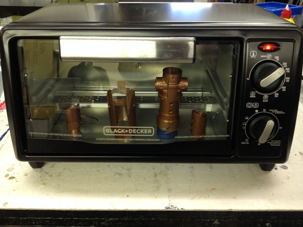

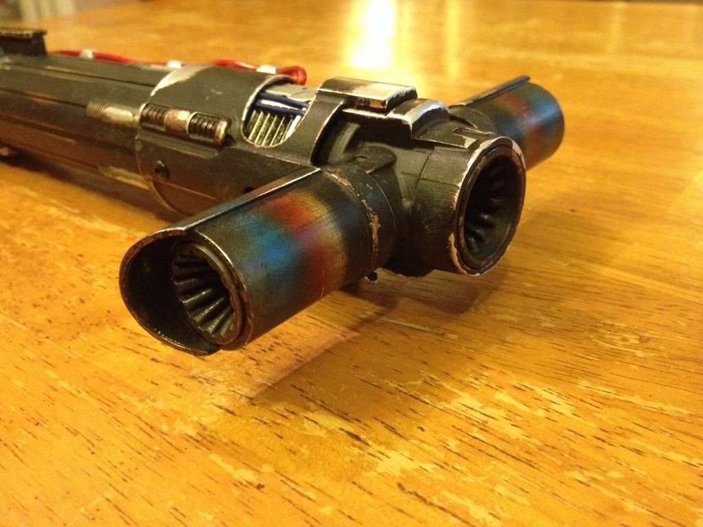

I finally got around to finishing mine. I used copper and black enamel paint, and used a toaster oven to bake each layer to make it dry faster, and adhere better.
I used toothpaste to mask off certain scratch marks, and after all of that painting was done, I did some extra weathering with some fine grit sand paper. I think it turned out pretty good.
