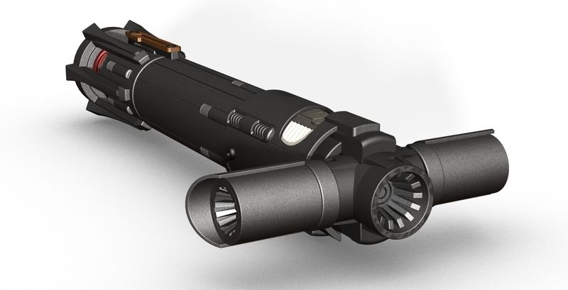

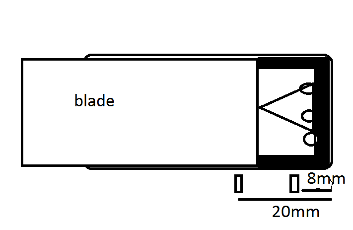

The saber is designed for side LED's. Ambient light won't be enough to do anything since the upper LED will shoot light directly into the top blade.
We have designed a small heatsink for the quillion. It will work with the 20mm Cree-Tri LED boards that are 20mm. You will need to shave off about 3mm from the edge of the board to get it to fit. This heatsink will go inside the quillion (not in the main body) and the quillion blade with insert on top of this and be held in with a setscrew.
Another way would be to use 3 normal LED's but the difference in the light is noticeable and not very nice.
These LED heatsinks will be a machined part and offered as a last option for those who don't want to design/figure out their own solution.
It will work like this, with the hole in the center of the "LED cup" for the wiring.
Also, the holes are sized at 3.2mm meant to be tapped with an M4 grub/set screw.

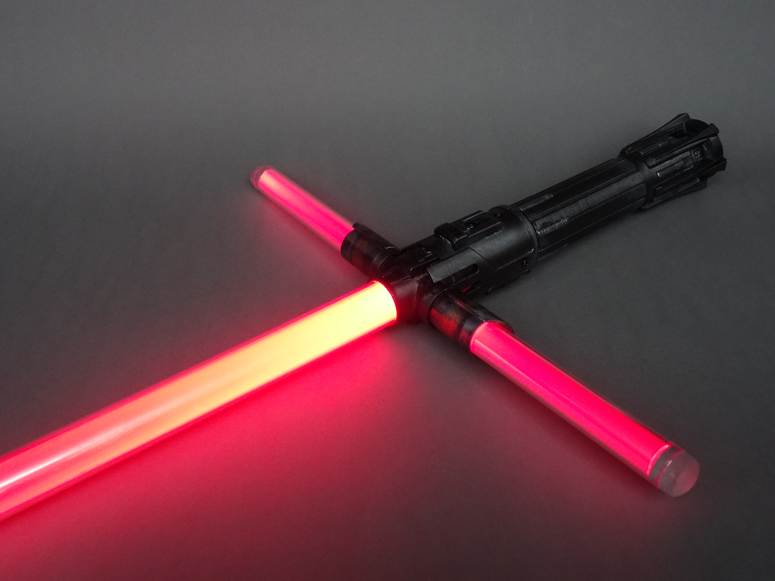

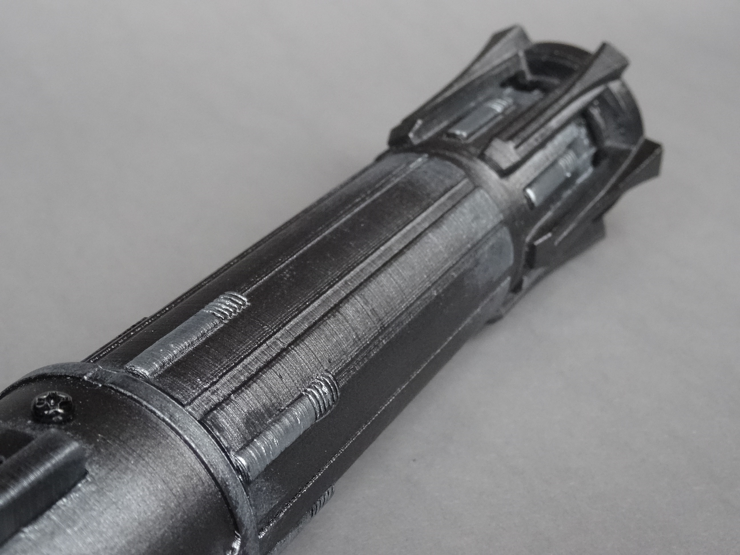

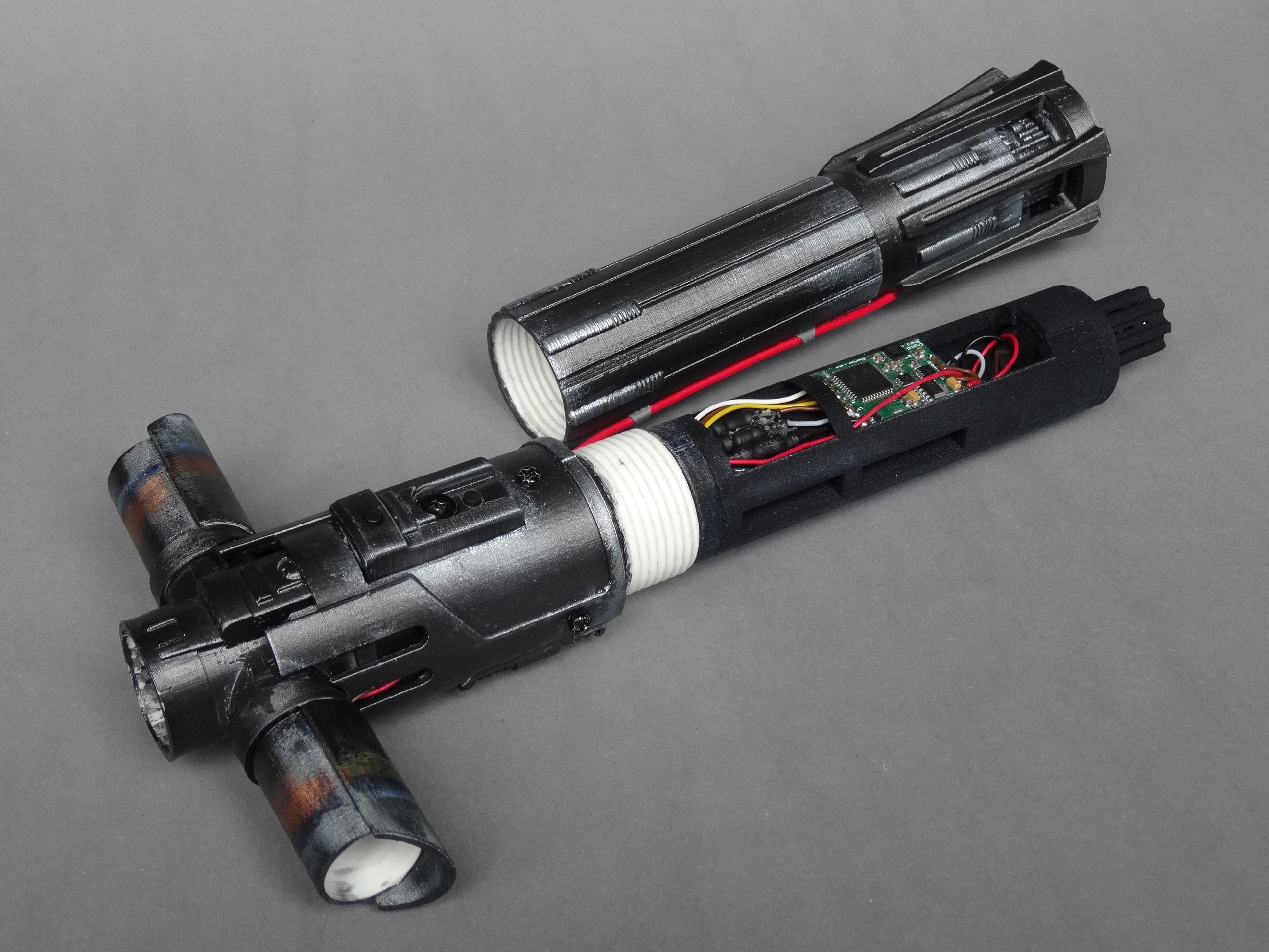

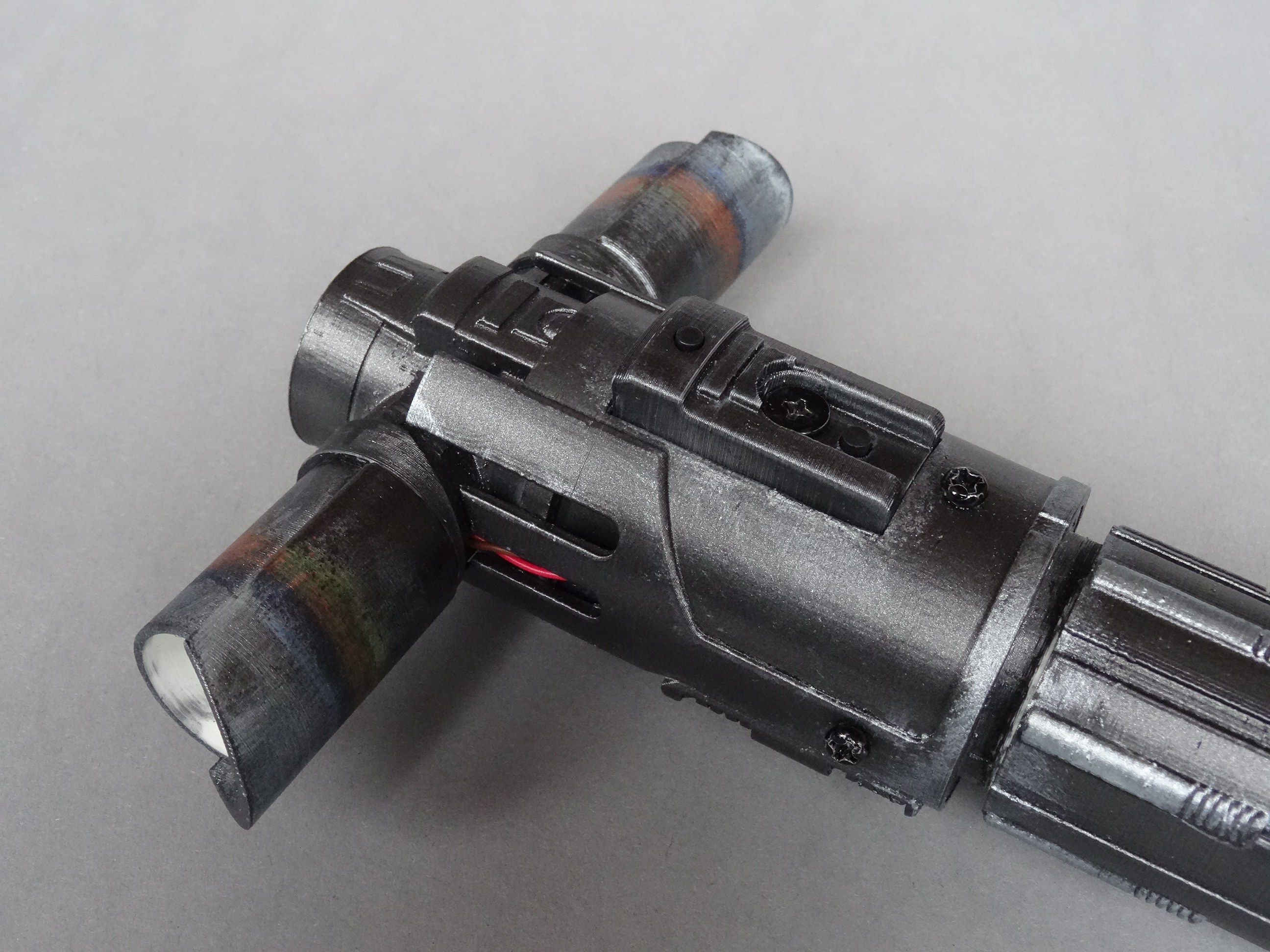

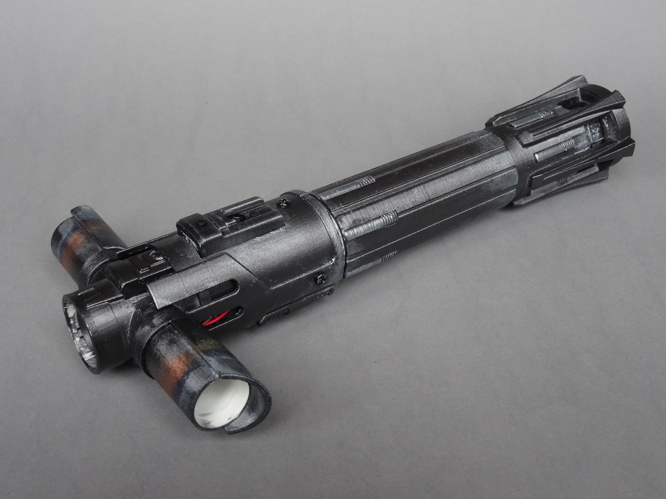

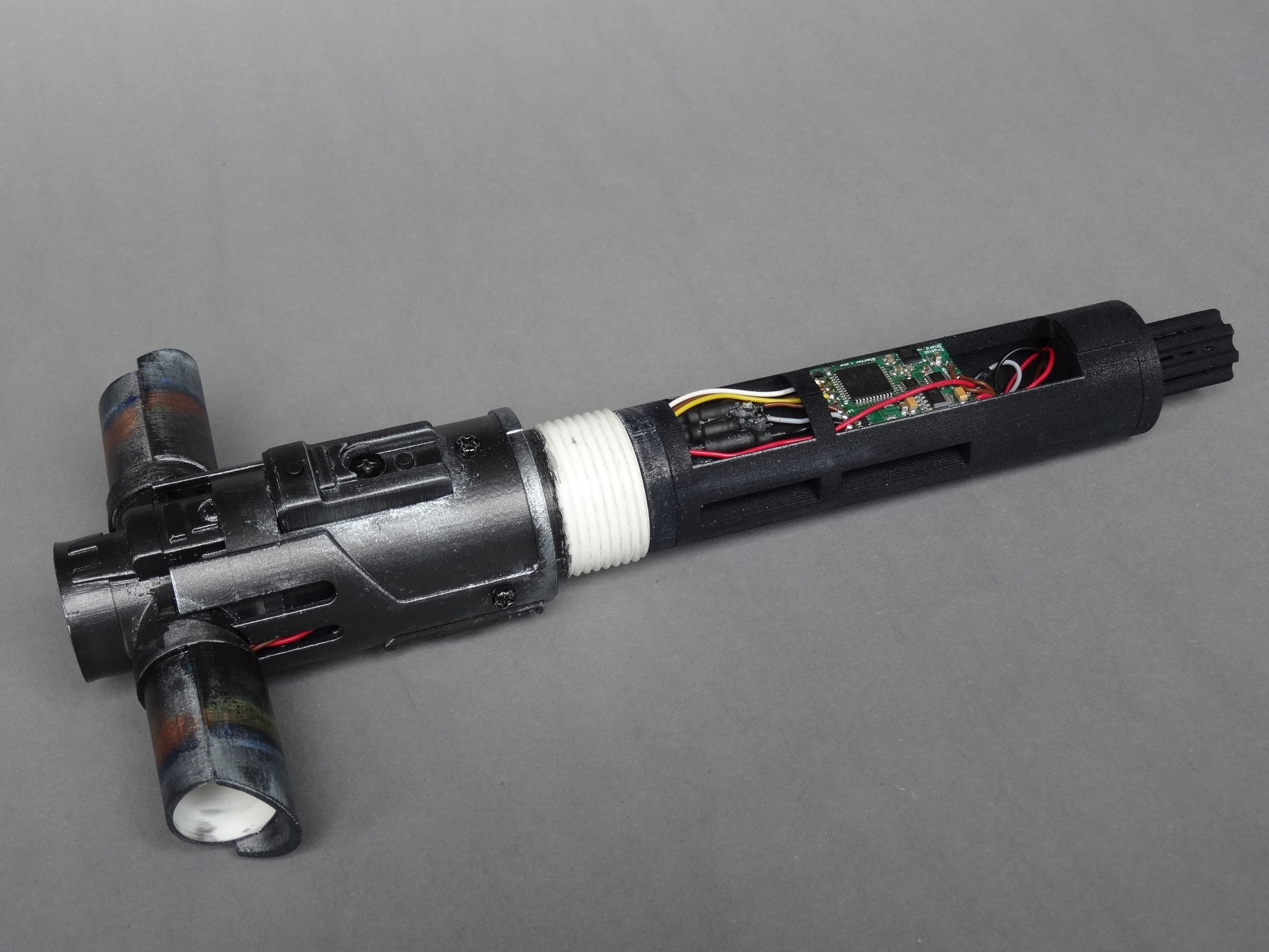

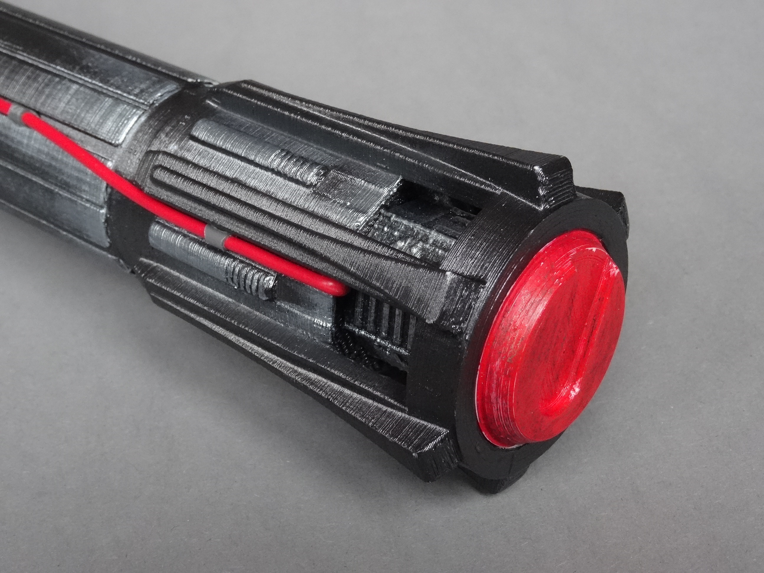

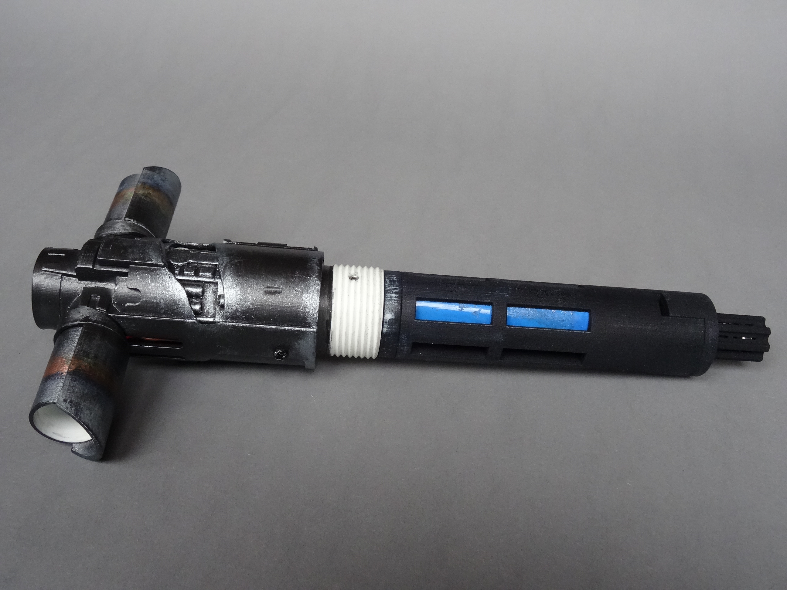

Hi there,

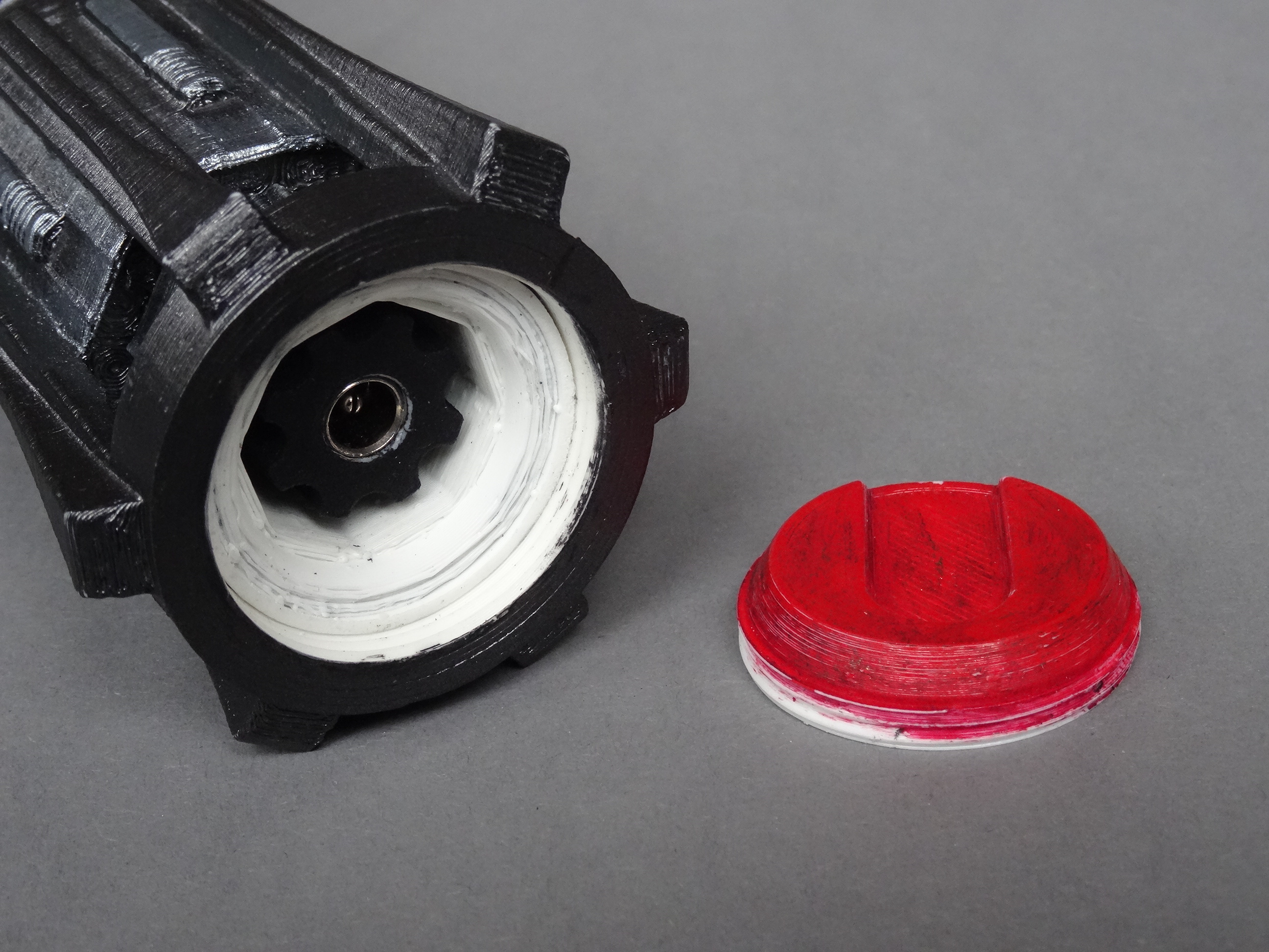

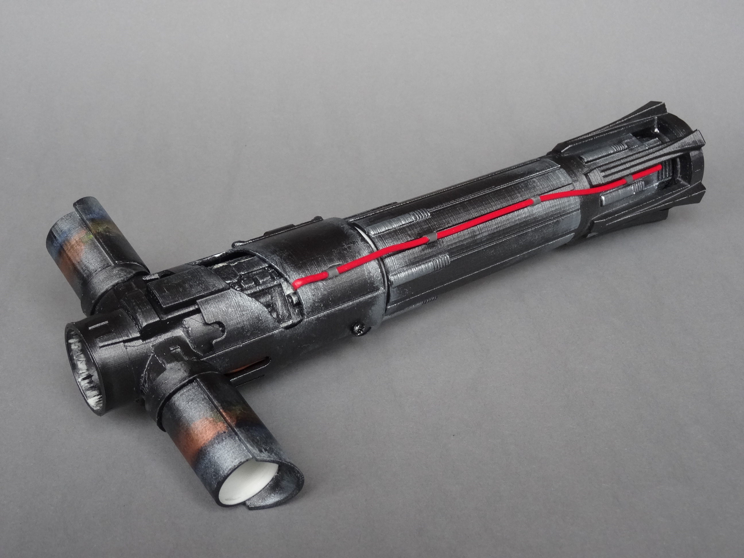

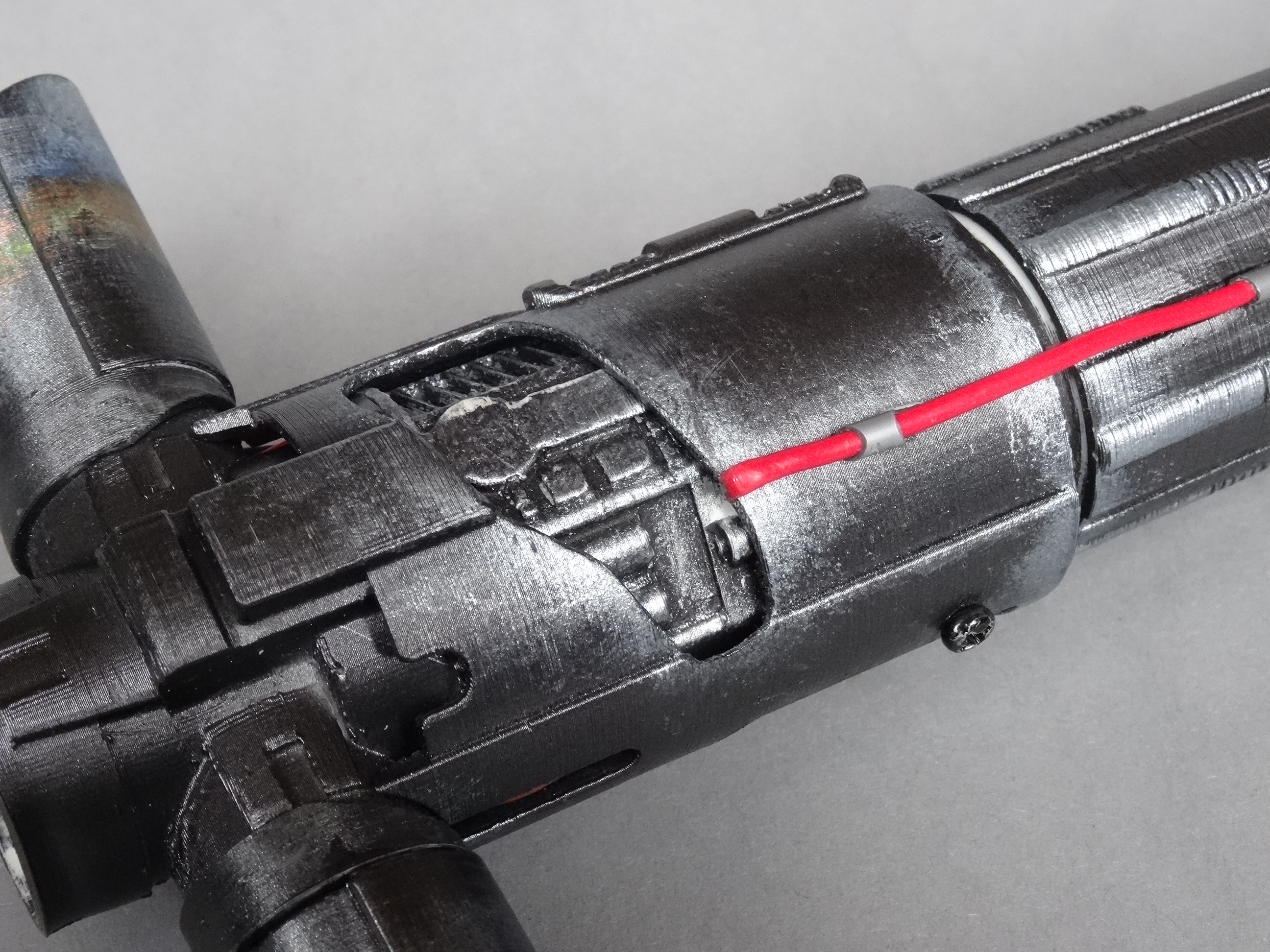

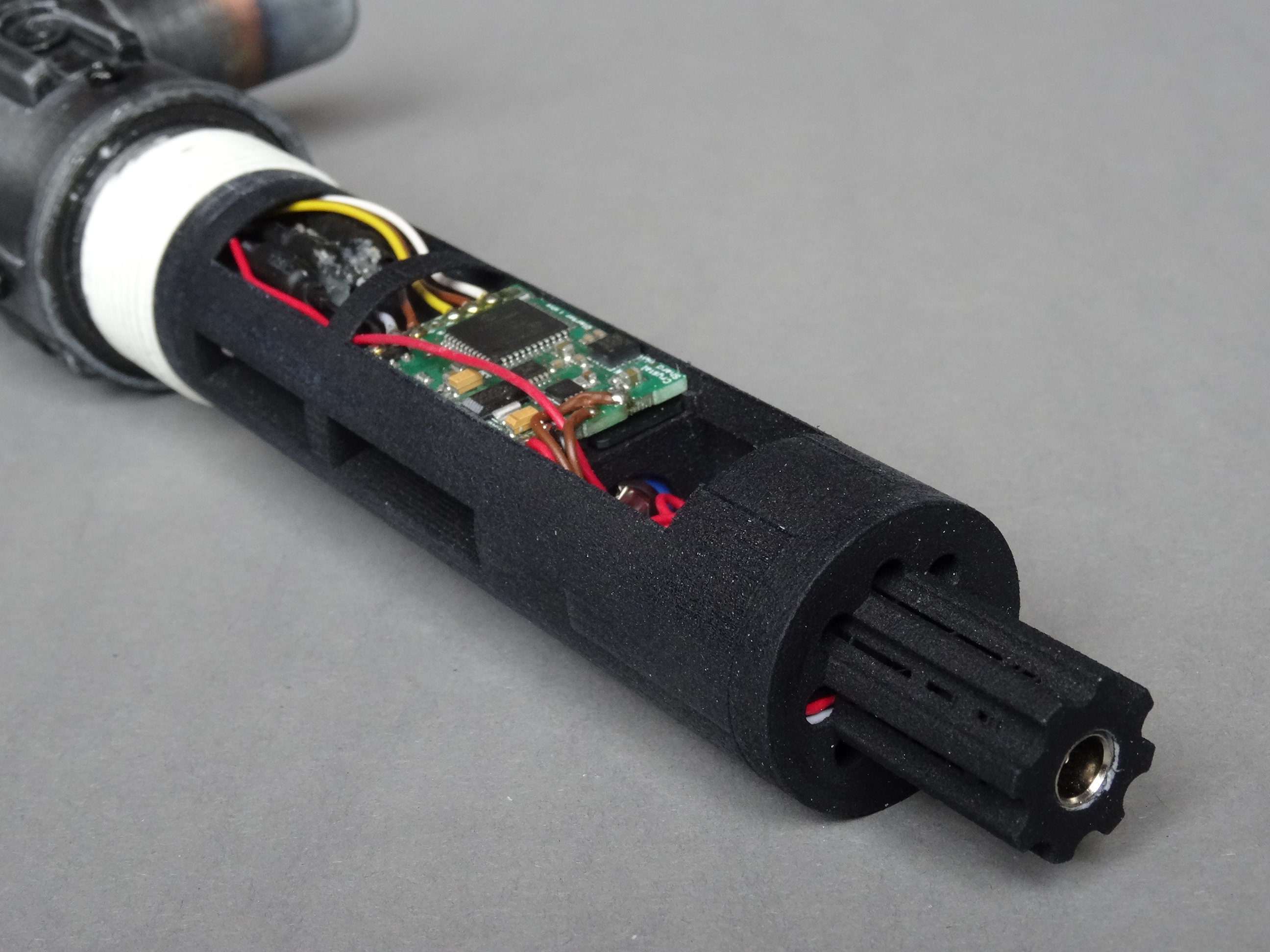

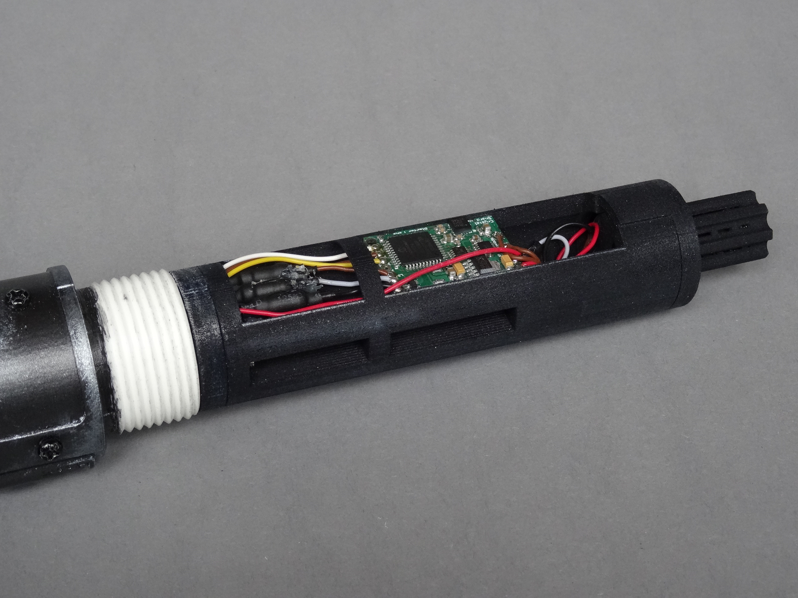

I’d like to show you my install job on a 3D-printed Kylo Saber. You have surely seen some of them before but this might be interesting for all those who participate in the run from Scott Baker and Derrek Day as I will be offering my install service for this saber. This 3D-printed saber served as a prototype so I could test my install and also gave some hopefully good input to the development of the saber too.
The used Plecter Labs Crystal Shard soundboard supports trident to control the side blades individually from the main blade. It is the board of choice for that install as you have all the stuff you need (can also be seen in the video). I will most probably also offer an install for a Crystal Focus or Petit Crouton.
More information about the Crystal Shard 3.0 can be found here: http://www.fx-sabers.com/forum/index.php?topic=48220.0
Manual: http://www.plecterlabs.com/Media/CrystalShard/CrystalShard-v3.0-GB.pdf
Using 3 x 5 mm LEDs in the side emitters doesn’t lead to a satisfying result in brightness so there will be heat sinks for a Tri-Cree available. Due to the tight space of ¾” in diameter the circuit board of the LED and the lense will have to be sanded down from 20 to 18 mm (which is possible at least with the LEDs I use) to fit into the heat sink. This will allow you to have brighter side blades and also Flash on Clash in the side blades too. If you want your saber have installed by me you need to provide these heat sinks too.
I would also recommend having done the painting job before the install as I wouldn’t recommend taking the saber apart again after, except for the bottom part.
The specifications for the CS-Version will be:
  • Plecter Labs Crystal Shard 3.0
  • 3D-printed chassis
  • 3 x RRW Tri-Cree LED
  • 18650 Panasonic 3400 mAh li-ion battery
  • 2 W bass speaker
  • 2,1 mm recharge port
  • SP kill key
You must provide the empty saber and both side blade emitters. I provide everything else (sound board, chassis, main blade heat sink, LEDs, battery, speaker, recharge port, kill key, wires and all the other small stuff).
The most interesting part for most of you: how much will all that be?
The price of the complete install is 460€. I can provide the fitting set of blades (1 x 1”, 2 x ¾”) for 50€ additionally. The main blade is a “thin walled” blade (7/8 inner diameter) but nevertheless we use these blades in our shows, they are definitely duel-worthy.
I can also offer li-ion chargers for 2.1 mm recharge ports for one cell for about 20€ here in Germany. It should be possible to install a R.I.C.E.-port if you want to.

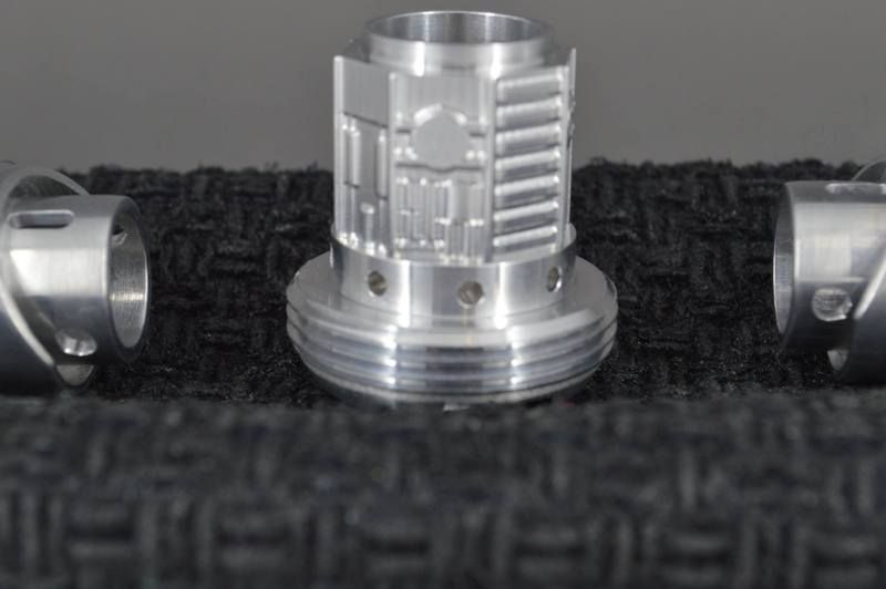

The entire structure and every part that you will touch regularly is CNC aluminium, and a few detail parts are resin. Everything that gives the saber it's structural integrity to allow for a weighty hilt you can smash against other sabers is made from aluminium and will hold up to heavy dueling.
The run is already in progress and the prototype is in production. Expected completion by the machinist is 3 weeks from now.
Here are some of the prototypes parts that are done now:

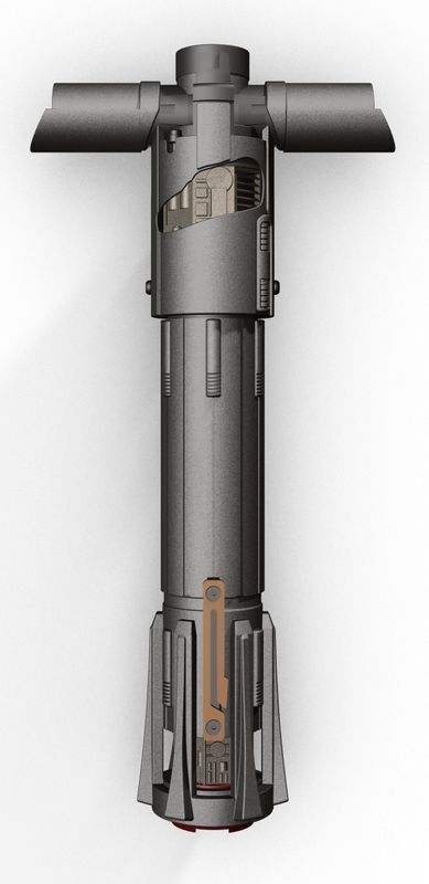

Renders of the model that were sent to the machinist.

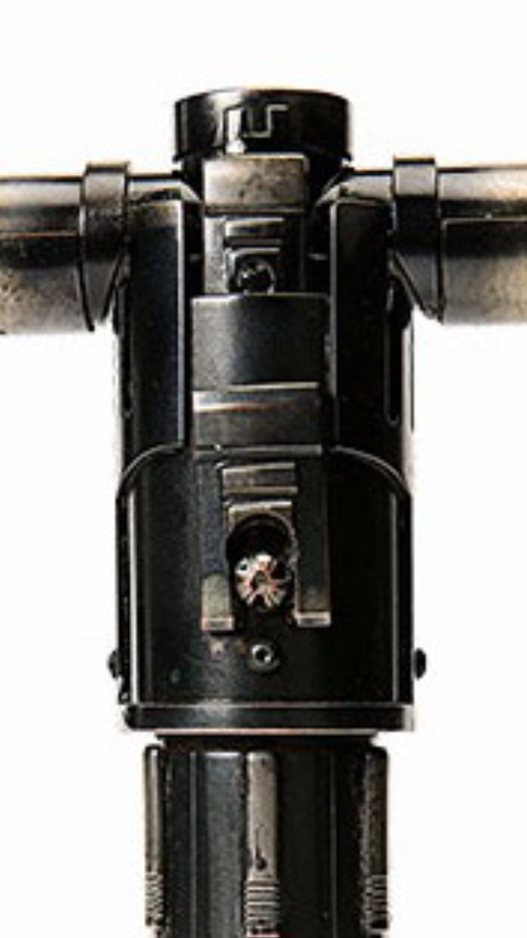

Don't know how I missed this...count me in. Just let me know where to send the deposit. Did the Google signup thing already...all metal parts please :)
I do have a question. The greeblie opposite side of the cut side, should it be in more of the center of the opening instead of at the top?
The original:

those parts are beautiful!!
