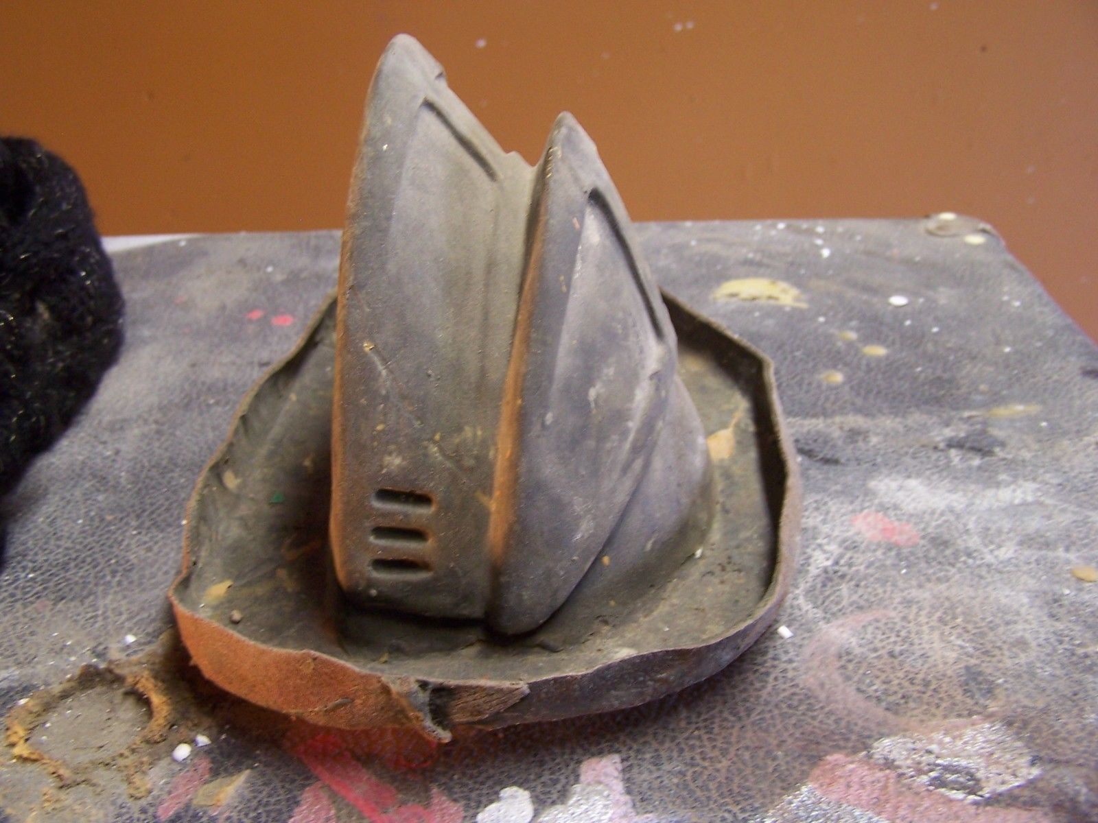

I currently have a mould which I am going to make a cast out of. It's the shoulder armour. I think that's where the first experience will come from. With the whole 'plaster' thing. Since the steps of producing the item has already been done this specific piece just needs a mould. I need to create a mould. I have Paris Plaster it should be a good start right?
