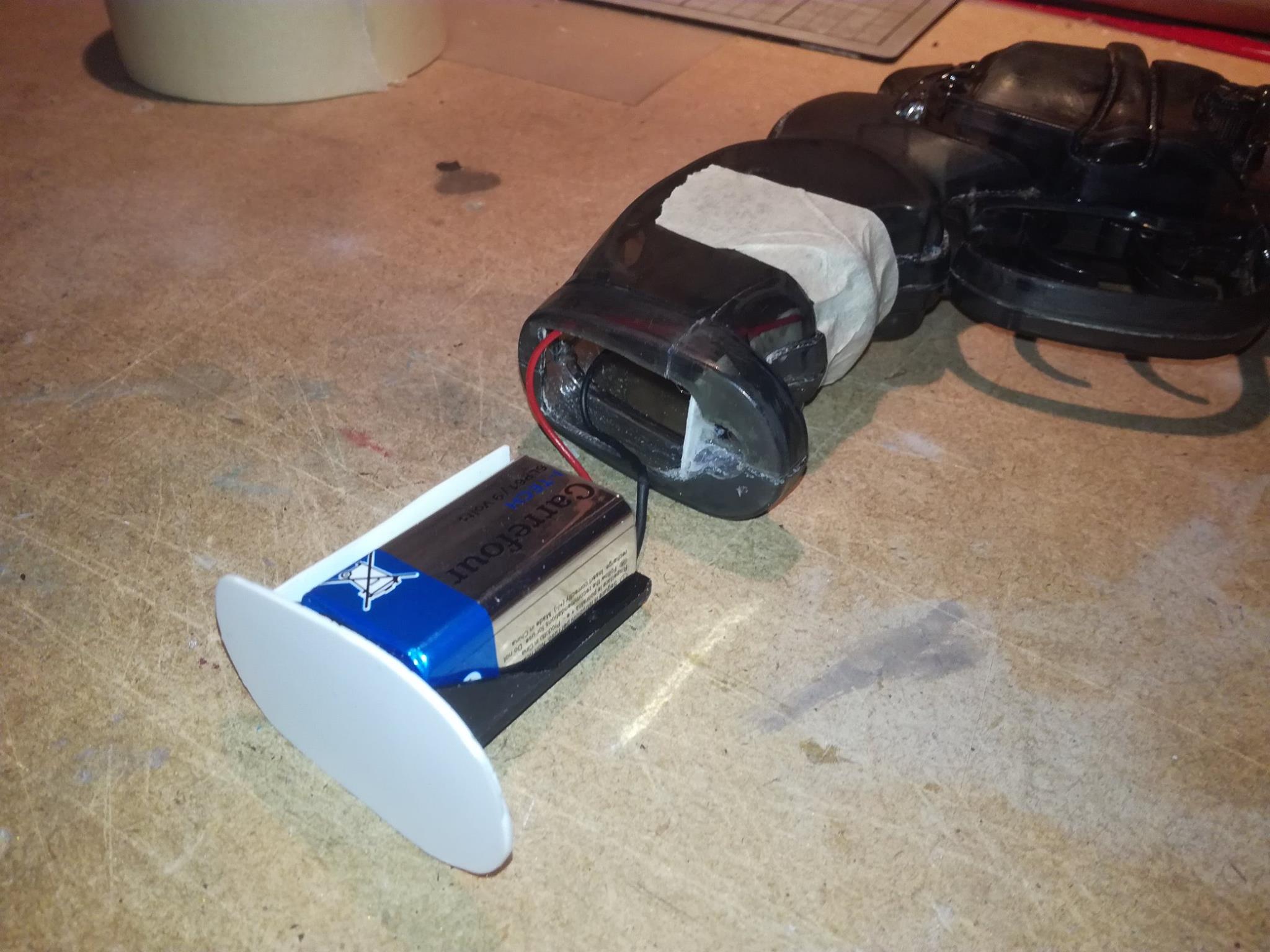

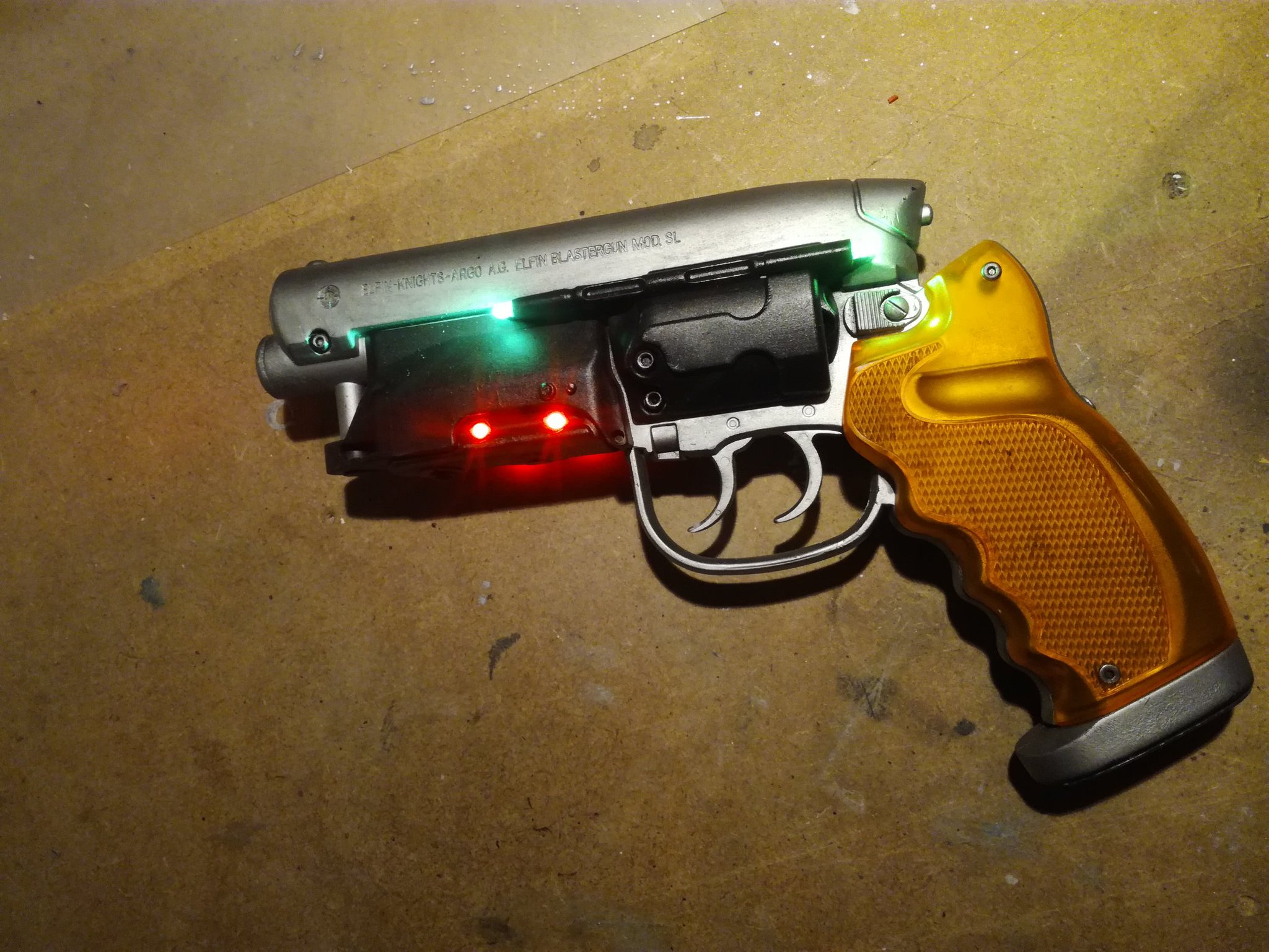

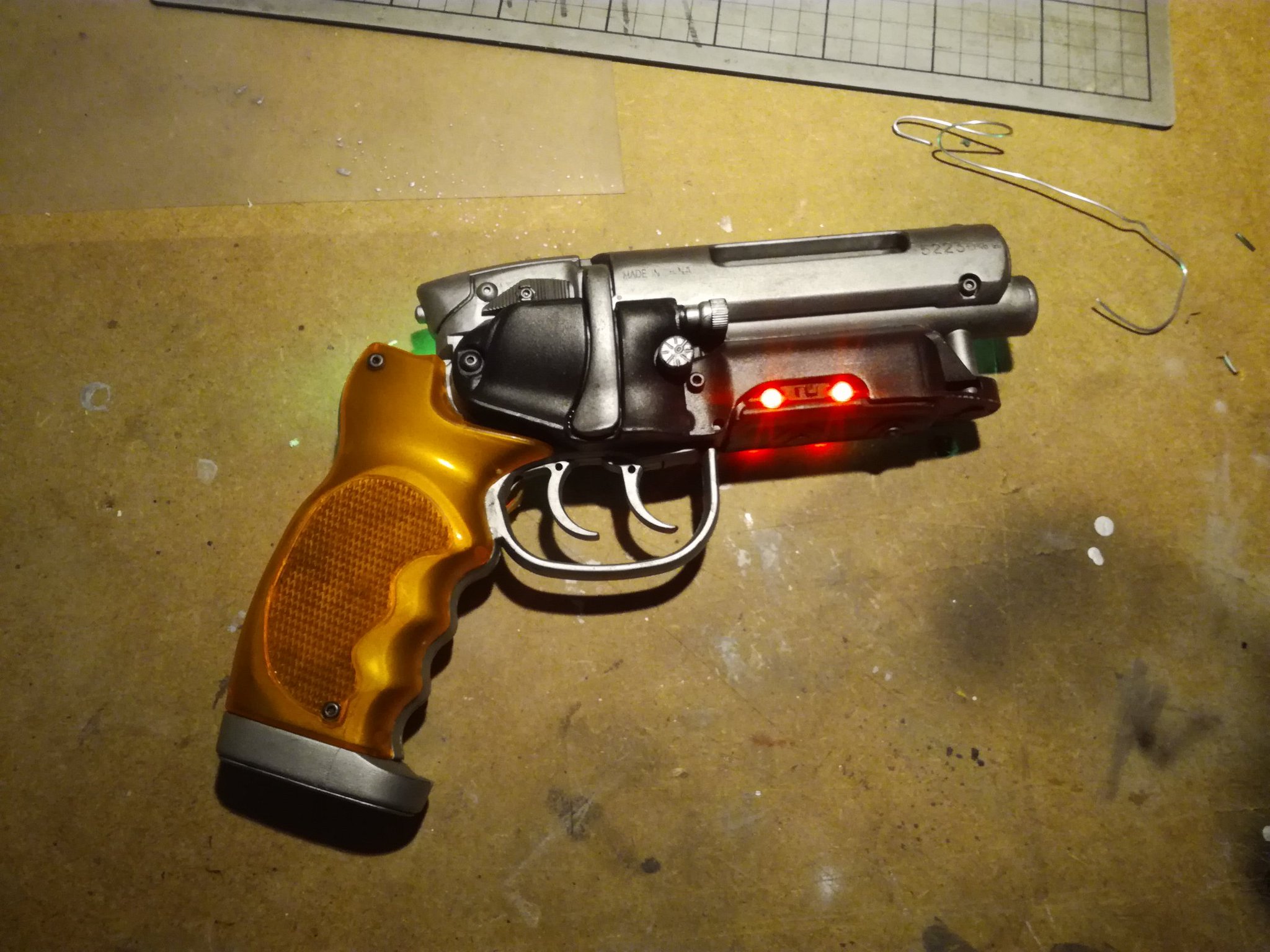

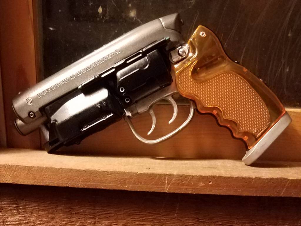

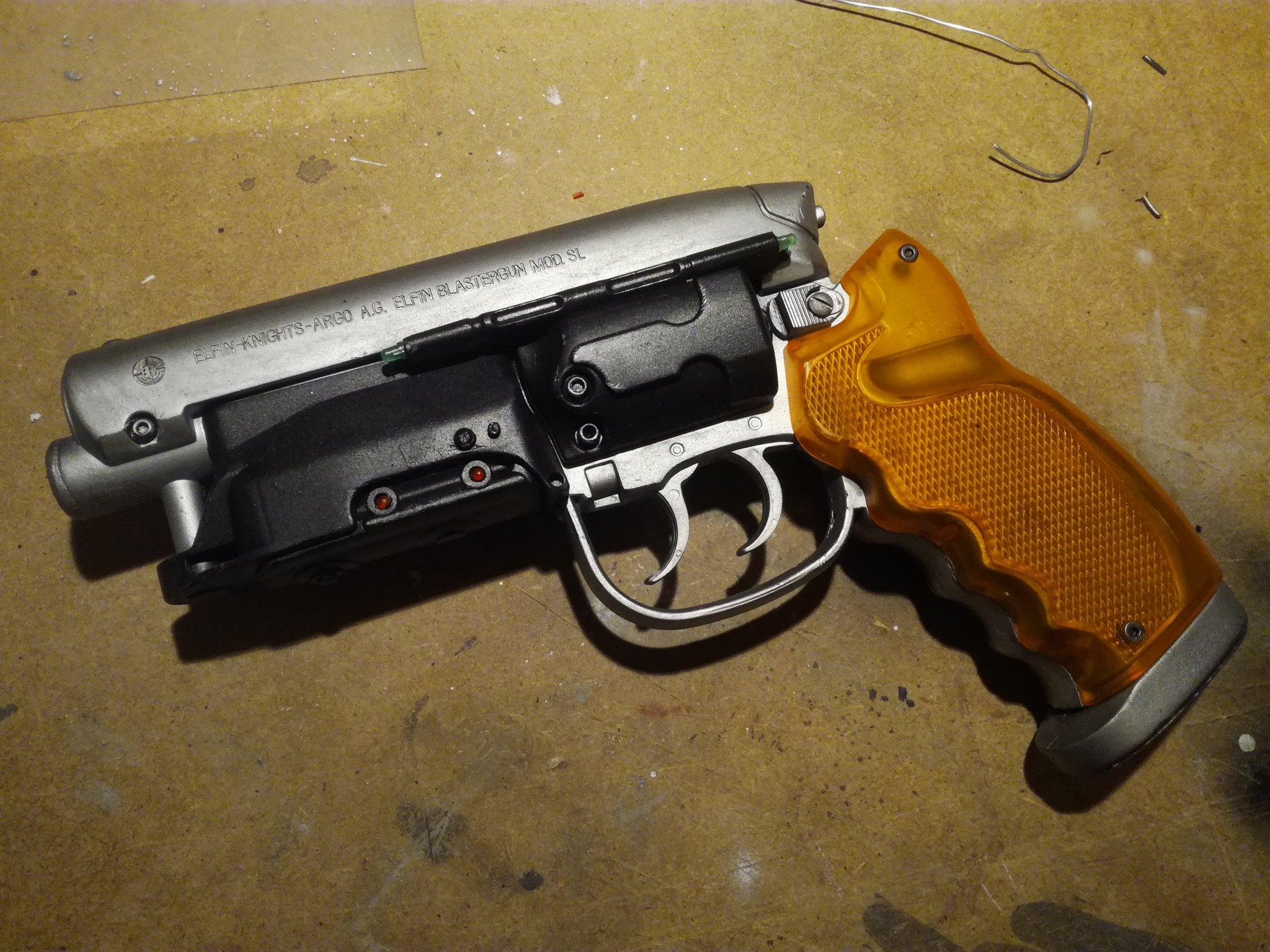

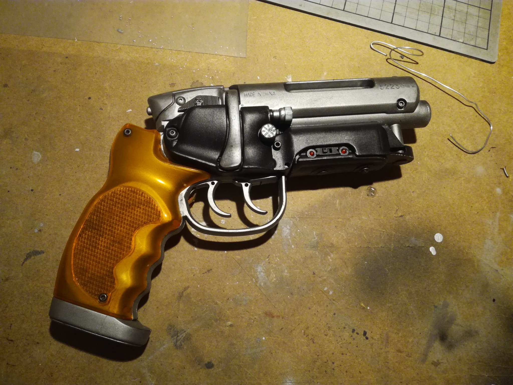

Long time not posting. I moved and was able to set up a "stuff making corner" again, so I finally took time to work on the PKD Watergun I got from 829Japan (big thanks to him again!)! Here's the result, I'm really happy with how it turned out. Battery is in the handle, holding with magnet. Let me know what you think :)
I used Vallejo Gloss Black Primer, Metal Steel, Metal Chrome and Metal Gloss Varnish.

Amazing build. This is exactly what I want to do for mine. Were the LED bits a kit or something you scratch-built?
Oh total scratch built. It's pretty easy stuff, using prewired 3mm led, simple soldering, and heat shrink tube. I might add a potentiometer cause the leds are way too bright.
Cool. Yeah, you want some kind of series resistor to limit the current to the LEDs. Thanks for the info. I'll dig around my LED collection to see if I have enough 3mm red and green ones. I might wind up using lithium coin cells, as those can be run without a series current limiting resistor. I used that in a Star Trek "The Cage" laser pistol prop build (that used to be linked in my signature).
I'd love to know your technique; I've been wanting to snag another one of these with my tax return and give it a proper go.
I don't know if I'm the best to give you advice since it's my first "real" airbrushed (had it for two/three years now, never used it for this kind of stuff (mostly for the props I made for short movies, webseries and stuff). I trained before by doing some repaint job on a K2SO Big Figure (I may post it soon too, but not now since it's a gift for my wife :p).
Basically to sum up :
- I opened the gun in two separated parts (that was SO tricky since they're glued/melted, just so I can work on the basic electronics, remove the "water pistol" part. Put the trigger on a spring so it can still be used. I've painted everything at ~20PSI (after looking at some advice here and youtube).
- Closed it and glue it back together, using Plastic Cement I usually use for styrene. And it worked pretty damn well!
- Closed any gaps and the filling hole with plastic puddy (again, from Vallejo... I have no parts in the company, it's just the easiest thing to get in uk :p)
- Gave the entire gun a good sanding (@220 mostly). I forgot that step in my first go and the primer wouldn't stay (of course...). You really have to sand it entirely and not miss any part.
- I used 4 or 5 layers of primer. Since the gun is transparent and I wanted to add LEDs, I really wanted it as opaque as possible. Vallejo recommend their Gloss Black in the Metal range. And of course, if you're doing metal, I tried on a grey and gloss black, gloss black is definitely the best.
- After masking the black part of the PKD, I added the steel paint. Chrome was giving me pretty much the same result though, didn't saw massive difference. And it was too light for my taste, so I gave it a really thin layer of gunmetal, airbrushing from a greater distance, just to give the dark grey I wanted, without being gunmetal.
The extra metallic part (screw, etc...) were hand painted with a fine brush. For the weathering, I couldn't wait. And even though oil paint is better for it, I used acryllic with a lot of water, brushed it over the gun and removed the excess with a paper towel, gently, letting the brown and black paint set in creases. Did some dry brush thingy too. And even used a metal/silver paint pen on so part, to do scratch.
I decided to stick with the primer for the black part of the gun... which is not a thing to do I guess... but as I was adding a varnish (metal gloss) I though it wouldn't harm. I couldn't find any black metal available around me. And removing the masking tape created some holes (that's why I insist on sanding). Nothing a good brush couldn't fix.
So here it is... nothing really fancy, just "noobie" stuff here I guess. But had a lot of fun and learned a lot. Took me about 2/3 days. If I had to do it again, I would try to get it smoother and shiny on the black part. Here it's a bit too rough compared to the OG prop. I'm gonna try putting more paint next time, I saw people using puddles in their advantage... the main thing I learned to avoid :).
