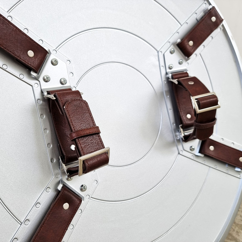

Last year I attempted to acquire a raw shield from two of the leading metal shield makers in the US, but they refused to ship to Singapore. So I resorted to ordering one from a maker in Shenzhen, China and it was sufficiently acceptable as a canvas. It's made out of aluminium alloy and weighs 5kg!

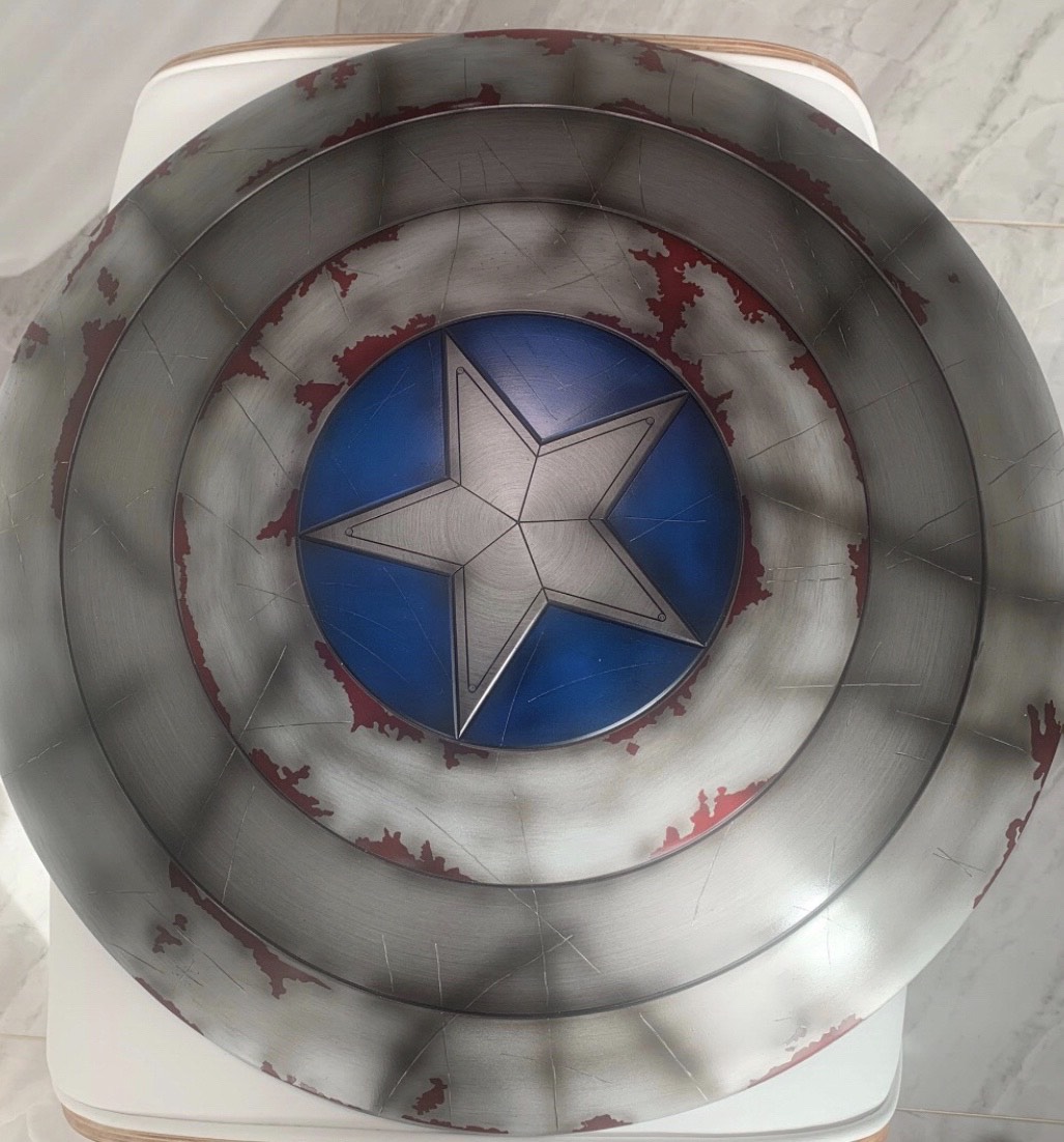

A great deal of masking was employed in varying stages to achieve the base colors and chipped paint effect.
To achieve the chipped red paint, I used tape to mask off the broad areas and refined the shapes with latex mask.
This was followed by layers of weathering passes with water-based acrylics and oils. The end result is (I hope) a shield wielded by the leader of The Avengers and that has endured countless battles against nefarious foes.

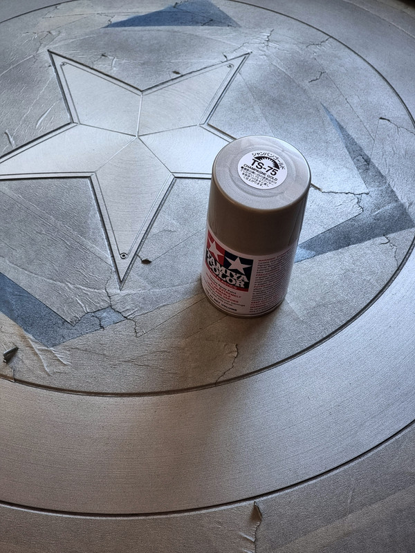

What did you use on the area that is supposed to be bare metal? I love the difference between that & the areas that are supposed to be red.
Seriously trying to talk myself out of doing the same thing.
I used Tamiya TS-75 Champagne Gold and brush over with graphite powder to tone down the saturation.
